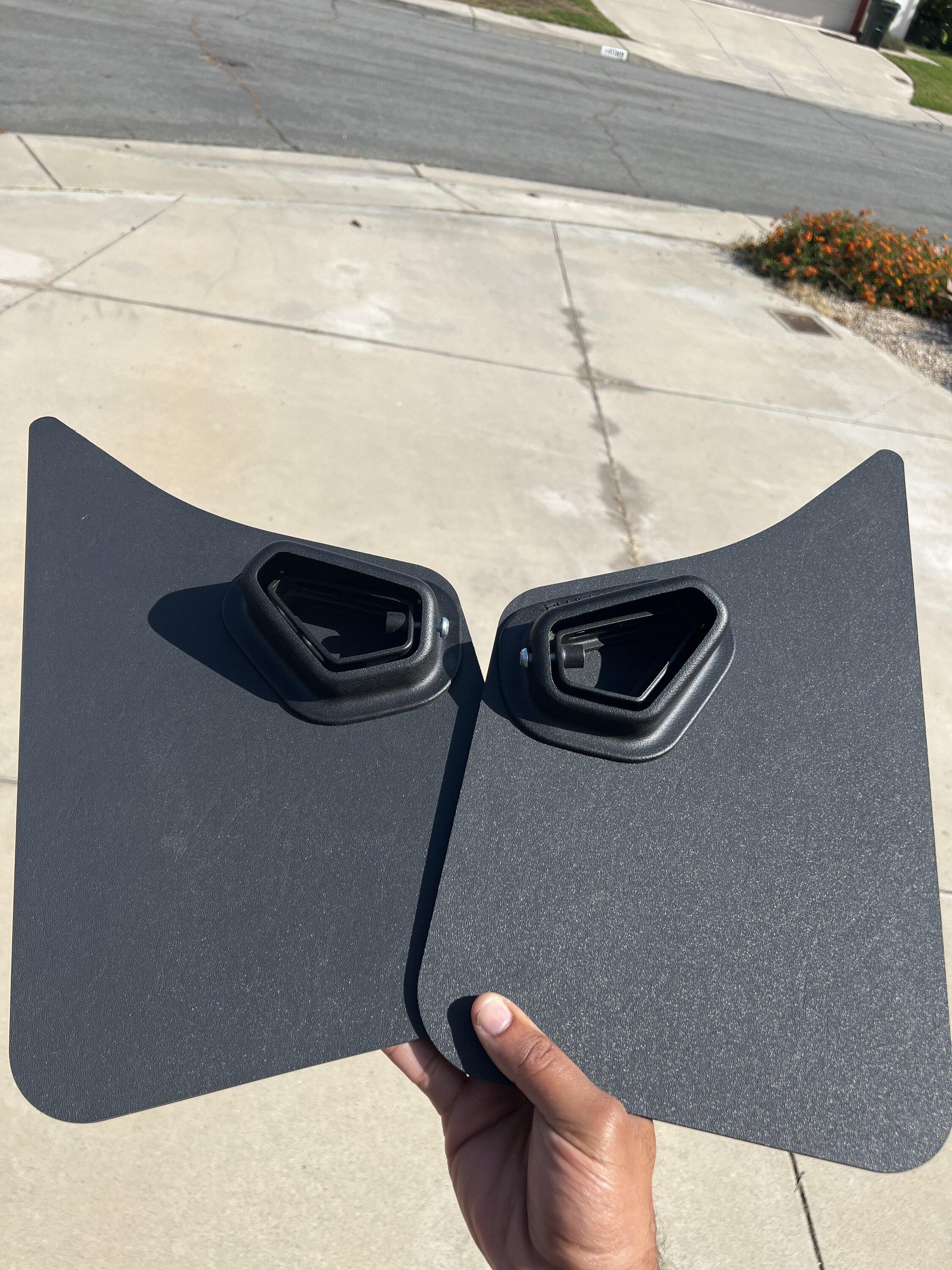

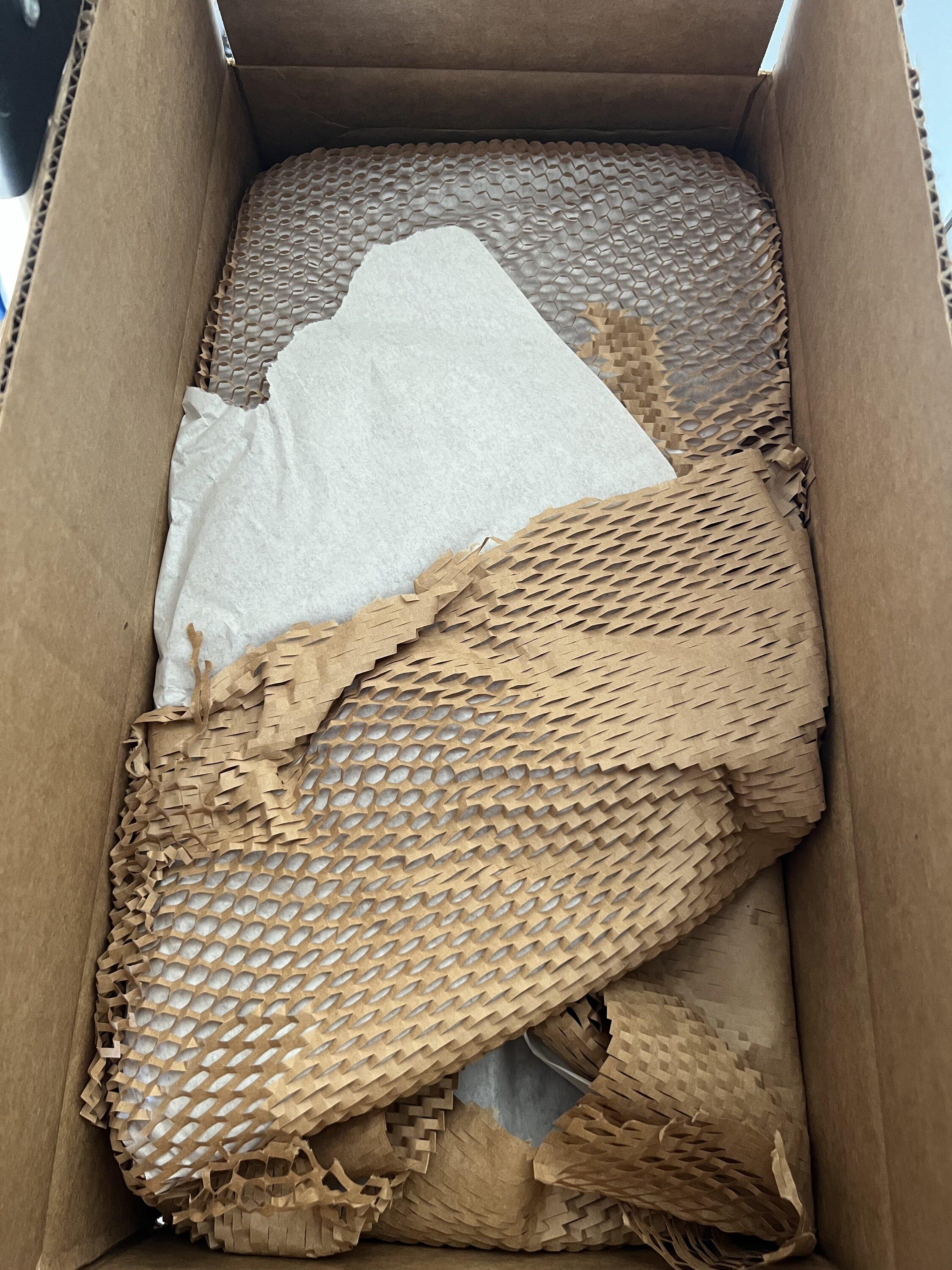

It came well packaged with instructions:

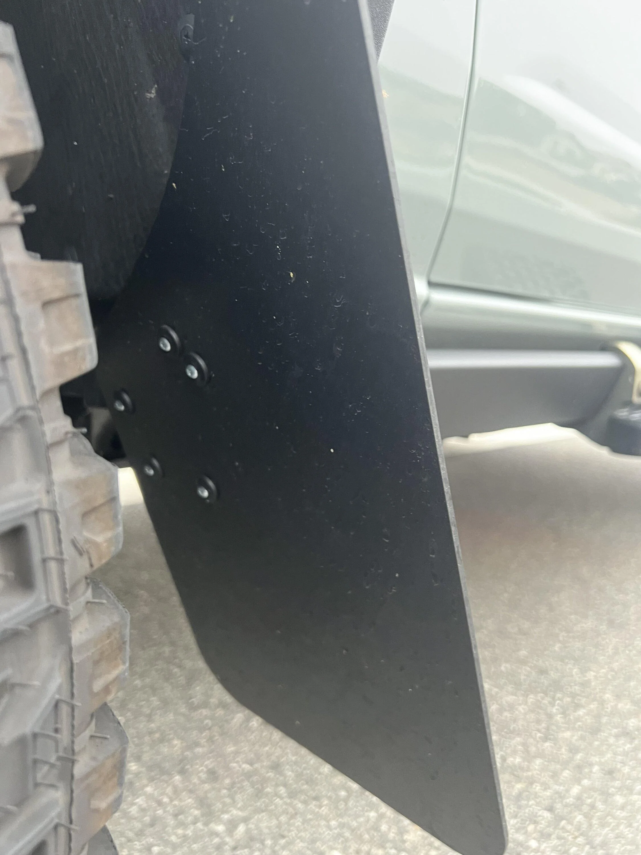

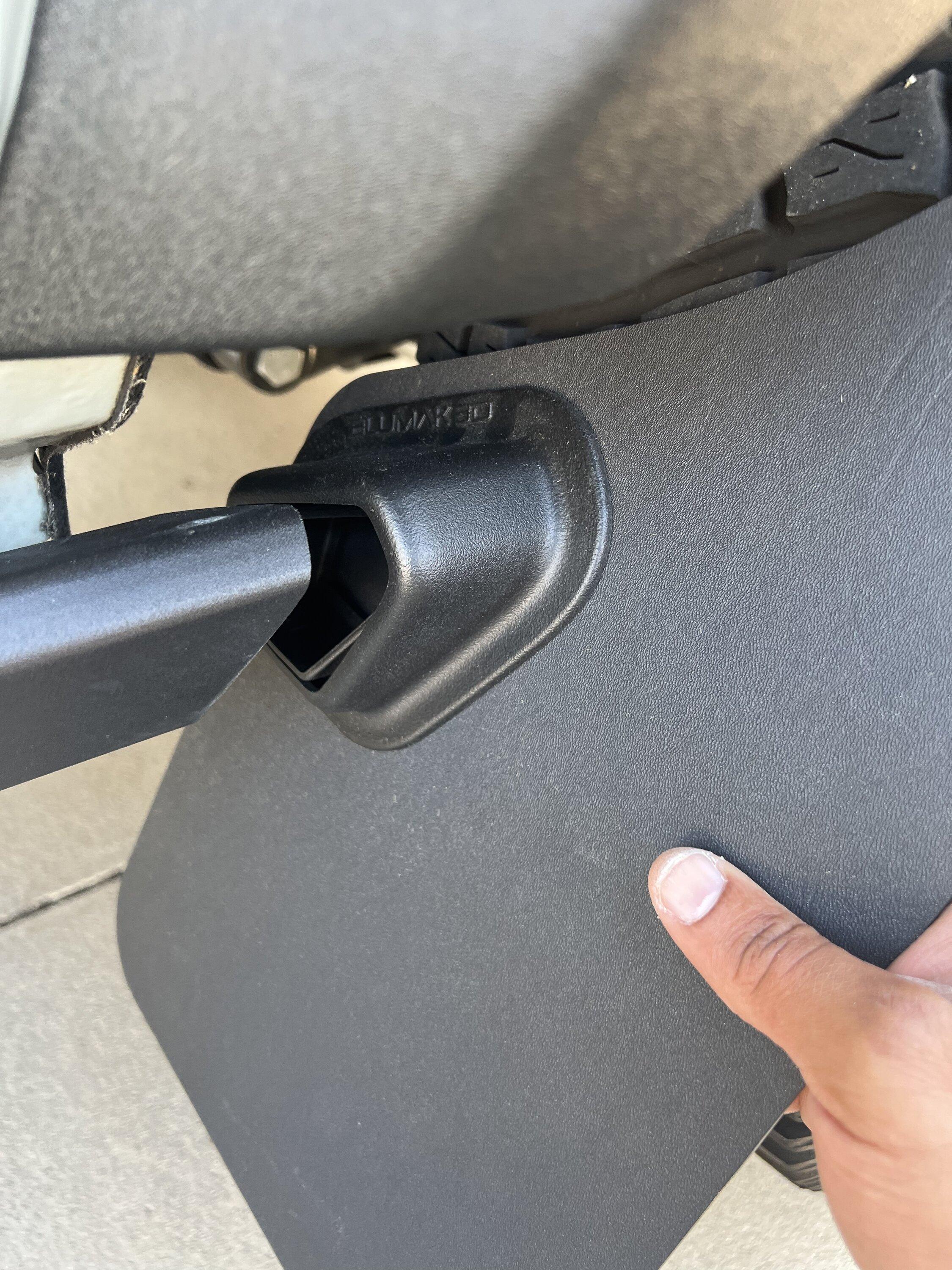

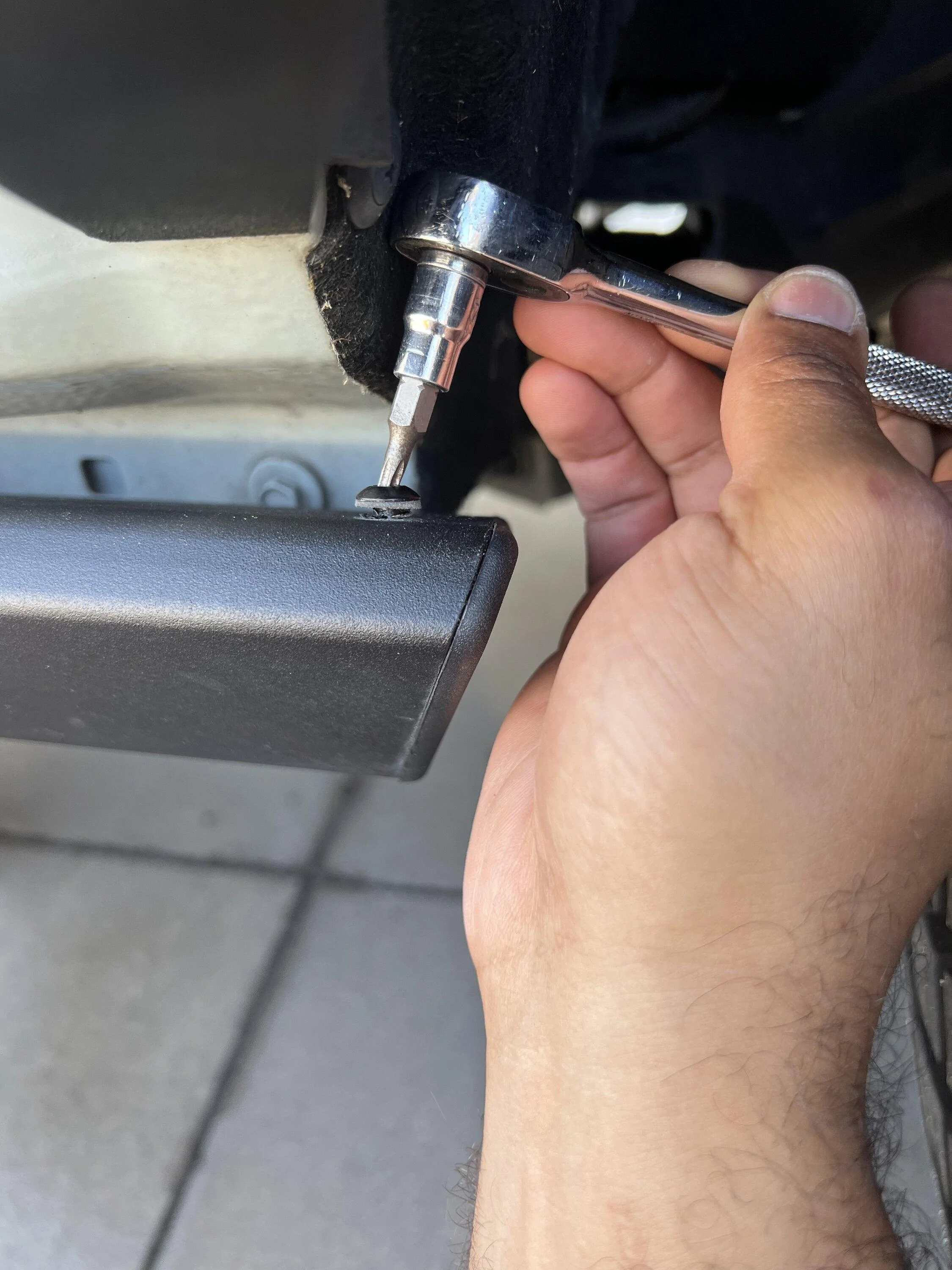

For Sasquatch Broncos all you need to do is remove 1 push pin, 1 T25 screw, and the end cap on each rock rail. Then slide mud flap on and hand tighten the T30 screw.

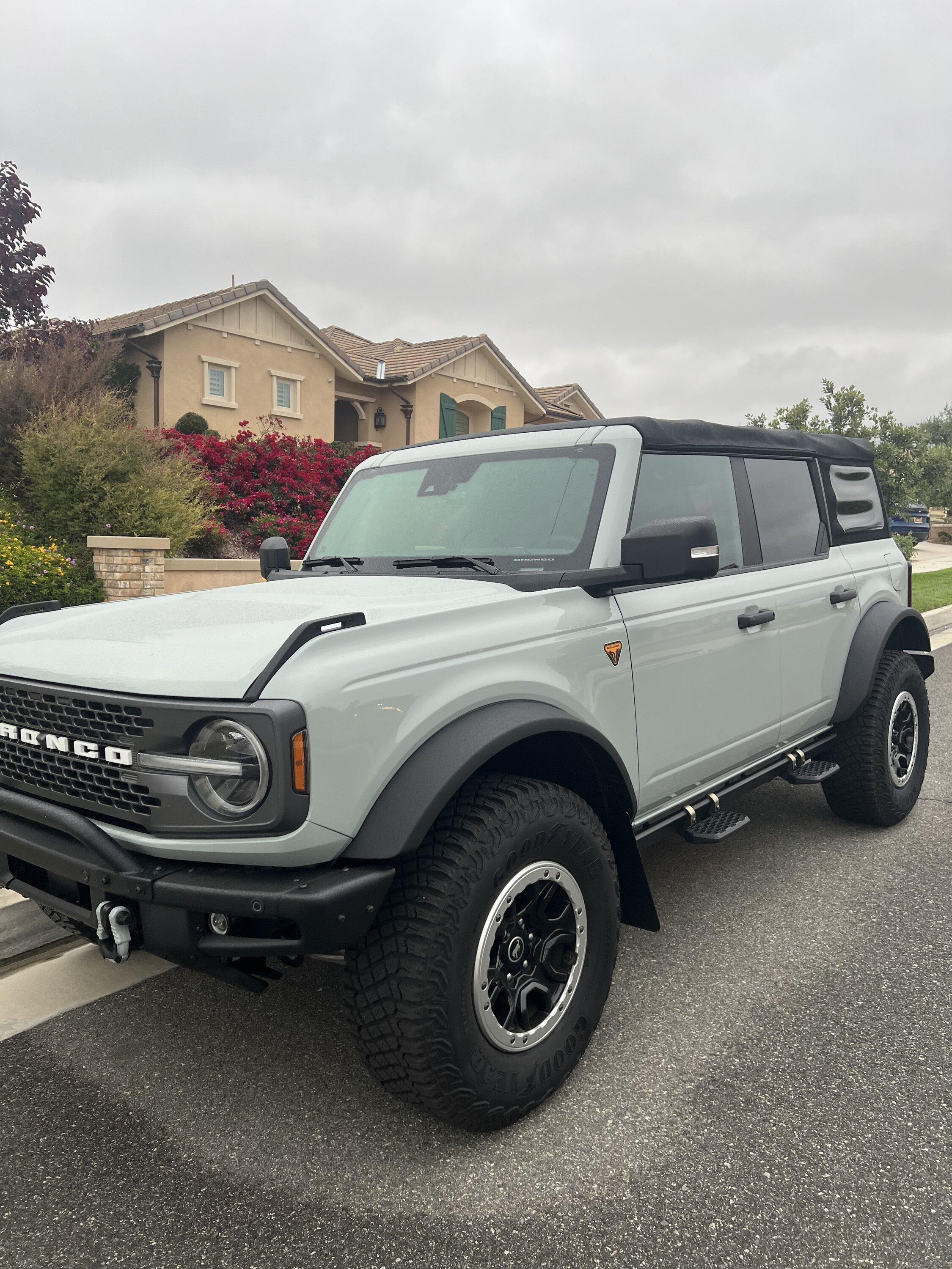

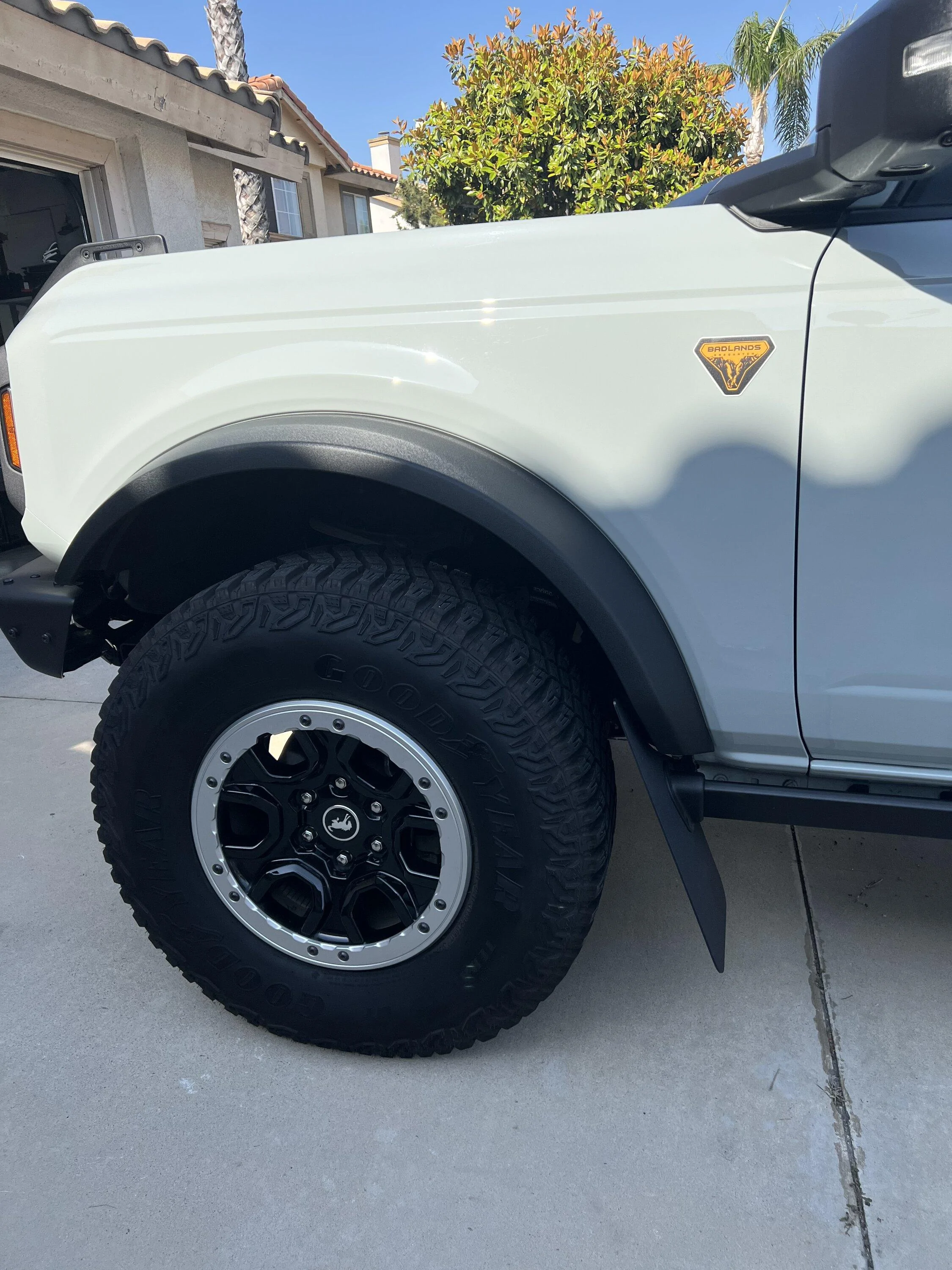

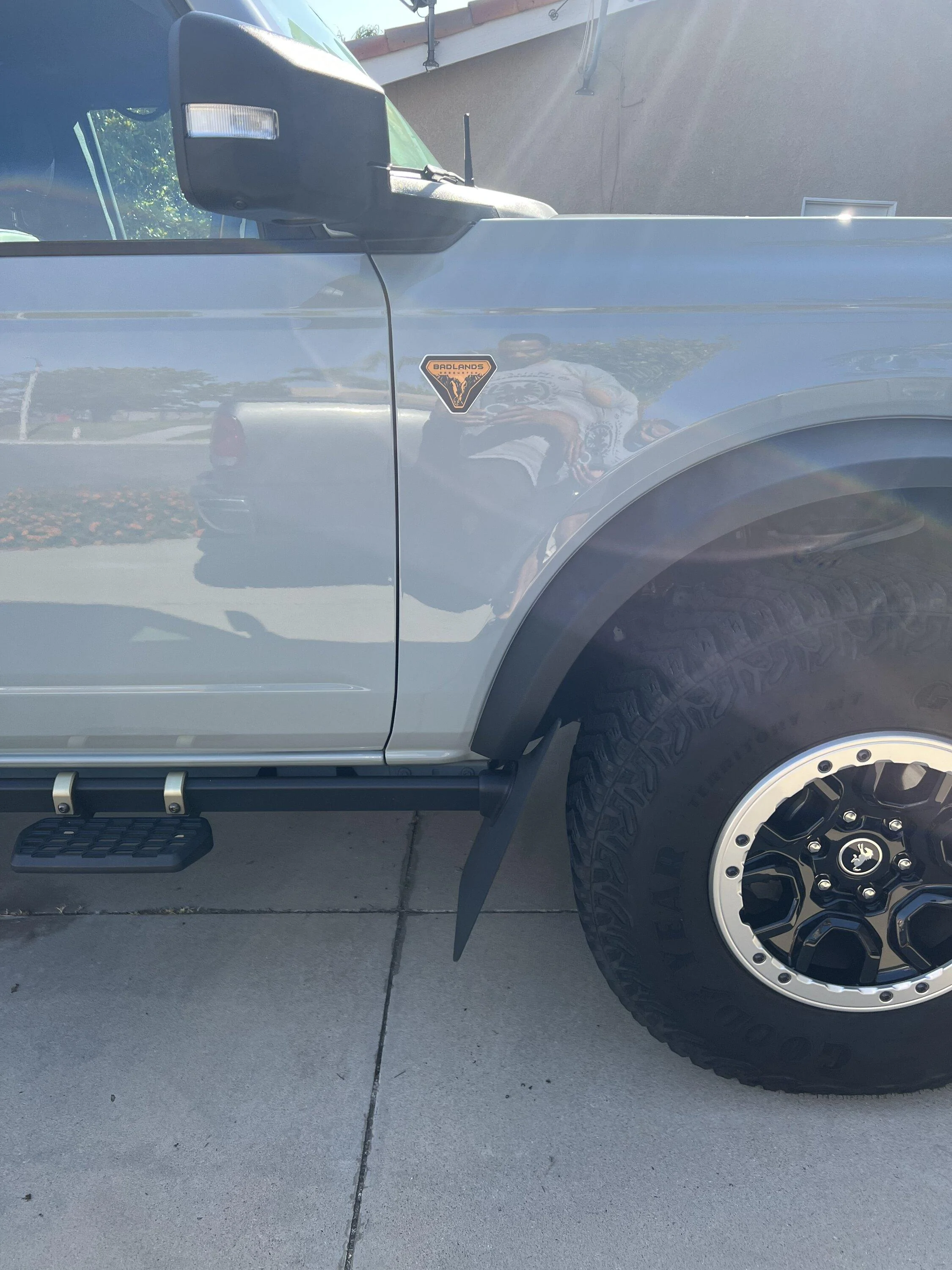

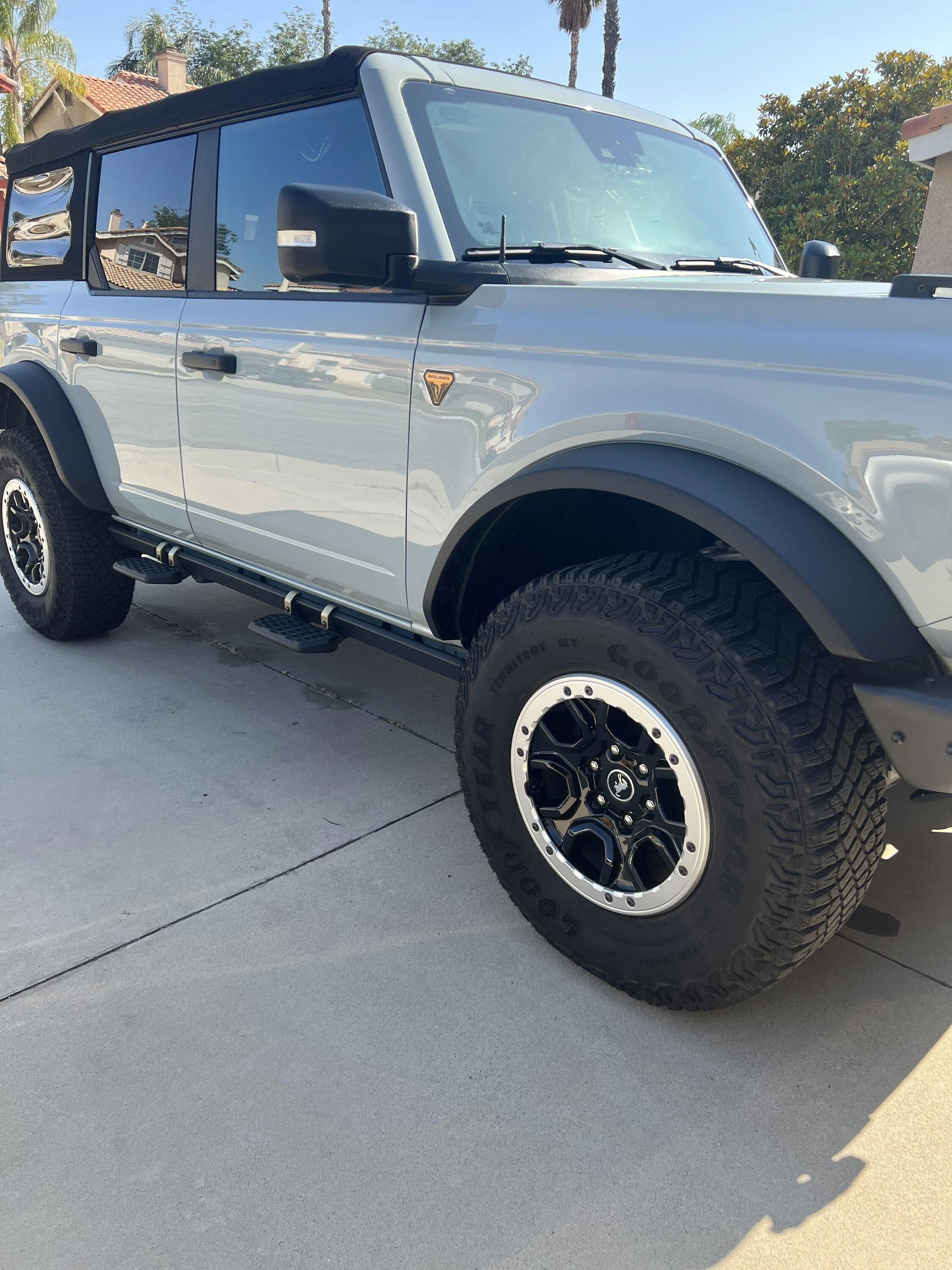

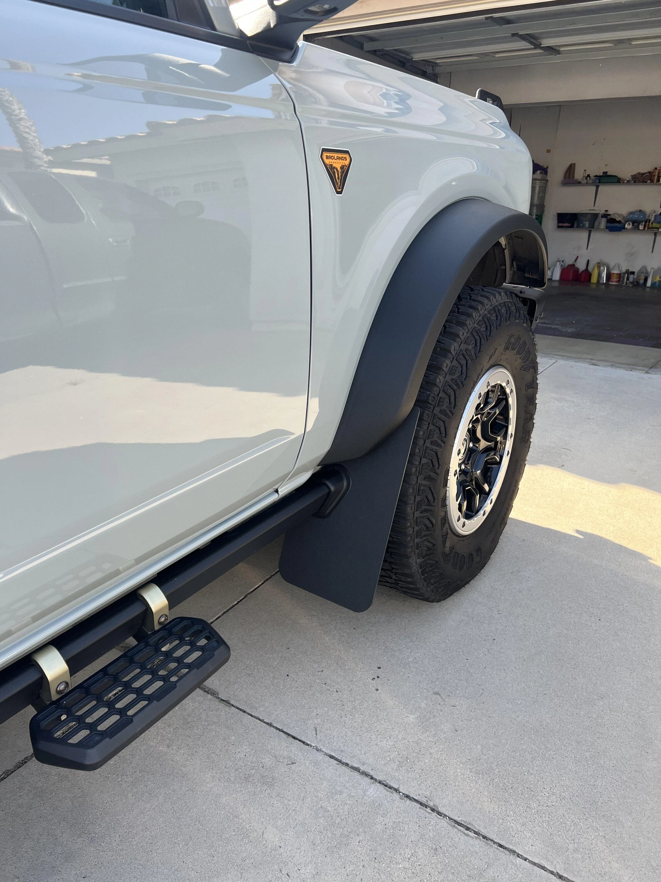

Before and After

EDIT: Review Added
I’ve done about 350 miles or so now with the mudflaps installed. Including about a 240 mile work trip.
They’ve been excellent! Every once in a while I will hear a small rock or pebble hitting them and the paint on my doors being spared haha.
They still look great too! I highly recommend them!

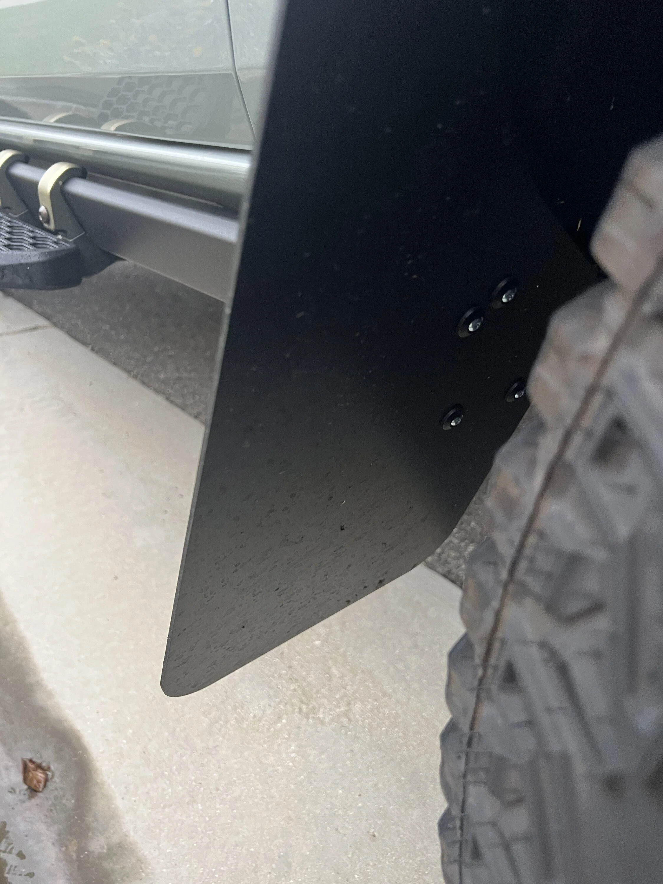

These are pretty rigid but they do have some flap and flex in them. They do feel like they can take a beating.
Since removal is so simple I would prob take them off before serious off roading

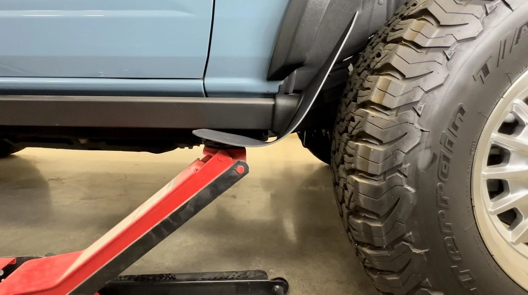

If if can ever figure out how to upload videos here I’ll have a vid showing the flexibility

Those steps are Archetype Racing Stirrups. I highly recommend them!

These are injection molded. Wait for mabett to copy them and sell them at 50% off

Thanks for the input. I will upload a flex test video. Also, these do not attach to the flares. They attach to the Rock Rails in a way that would not damage the flares if things went crazy.
