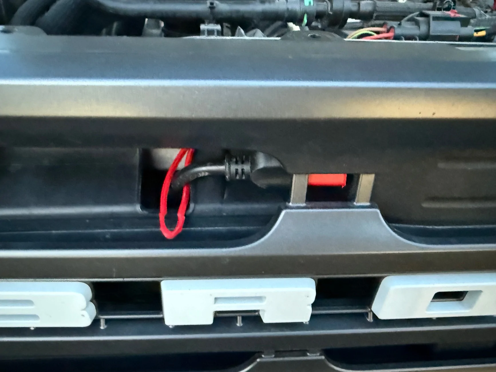

Dealer routed my plug up under the hood on the right side of the air intake (2.3L). Never checked about routing it down below out the front. Have to open the hood every time to use it. It helps remind me to unplug before driving off in the morning.

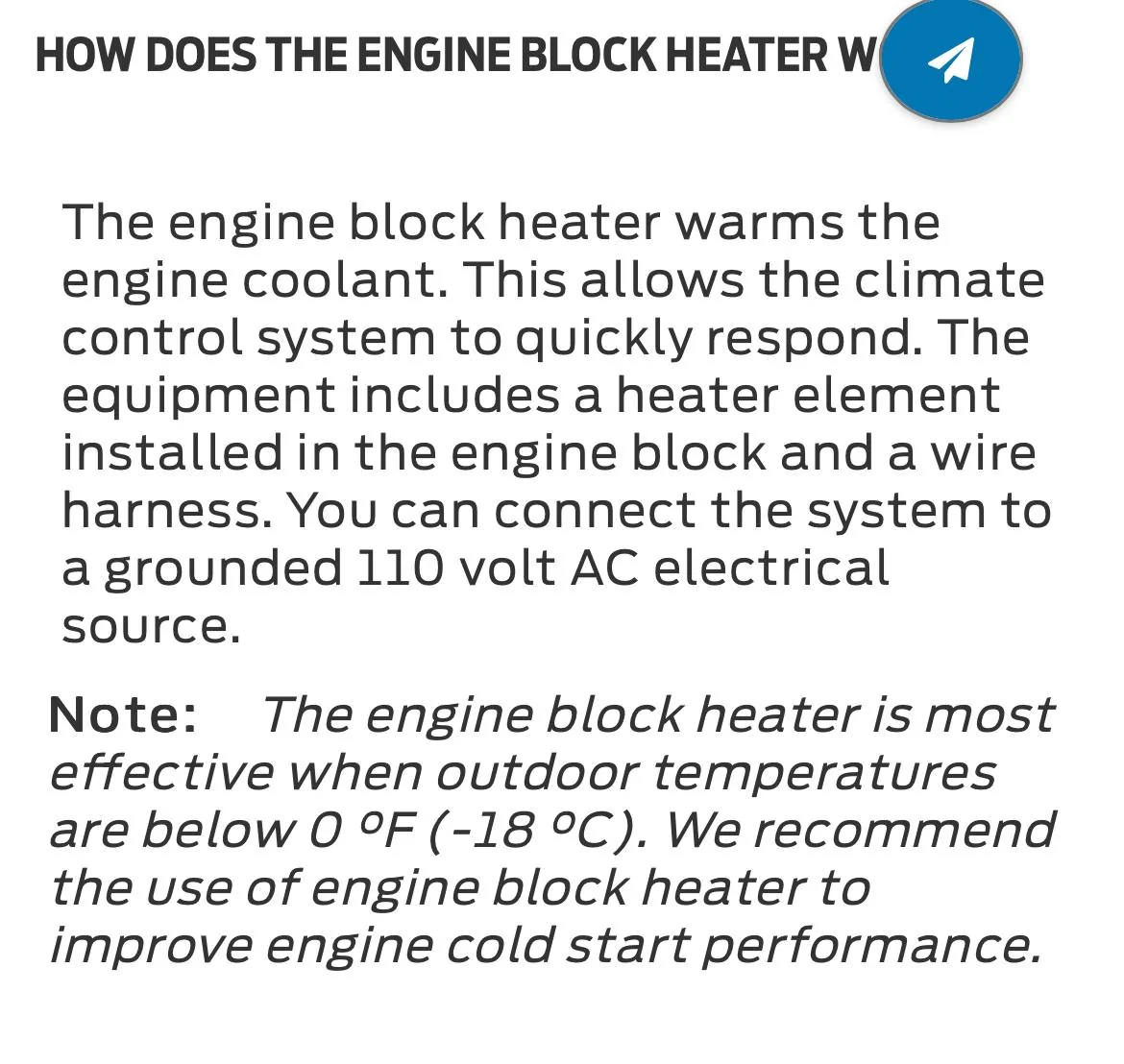

So, I just realized that the user manual states that it requires 220v and optimal temps are reached after 3 hours.

Which timer are you using, because the one I got isn’t rated for 220-240v nor is the outlet I’m using. So, I guess I need a dedicated outlet and outdoor extension cord.
Ford Bronco Block heater plug, terrible location IMG_5606
That being said those oil/coolant temps you mention, I don’t think your heater is doing much. The coolant should be 100°F+ in those ambient temps. Oil + coolant hitting 50-60°F after a few miles is normal operation. I’m expecting to be able to turn the heater on and immediately be at near operating temps pulling out of the driveway.
Dang, didn't know about the 220v outlet. I'm only plugged in for an hour or so. I use a Woods 50016 digital timer for block heaters.

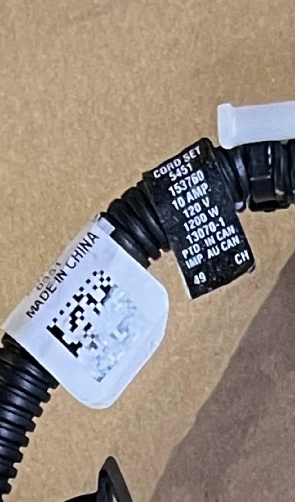

The plot thickens. This is the tag on the block heater harness itself.
Ford Bronco Block heater plug, terrible location IMG_5609
I started a conversation with my electrician and he pointed that out. He was surprised that the plug itself was a normal 3 prong - usually it would require a special NEMA plug if it was 220-240v.

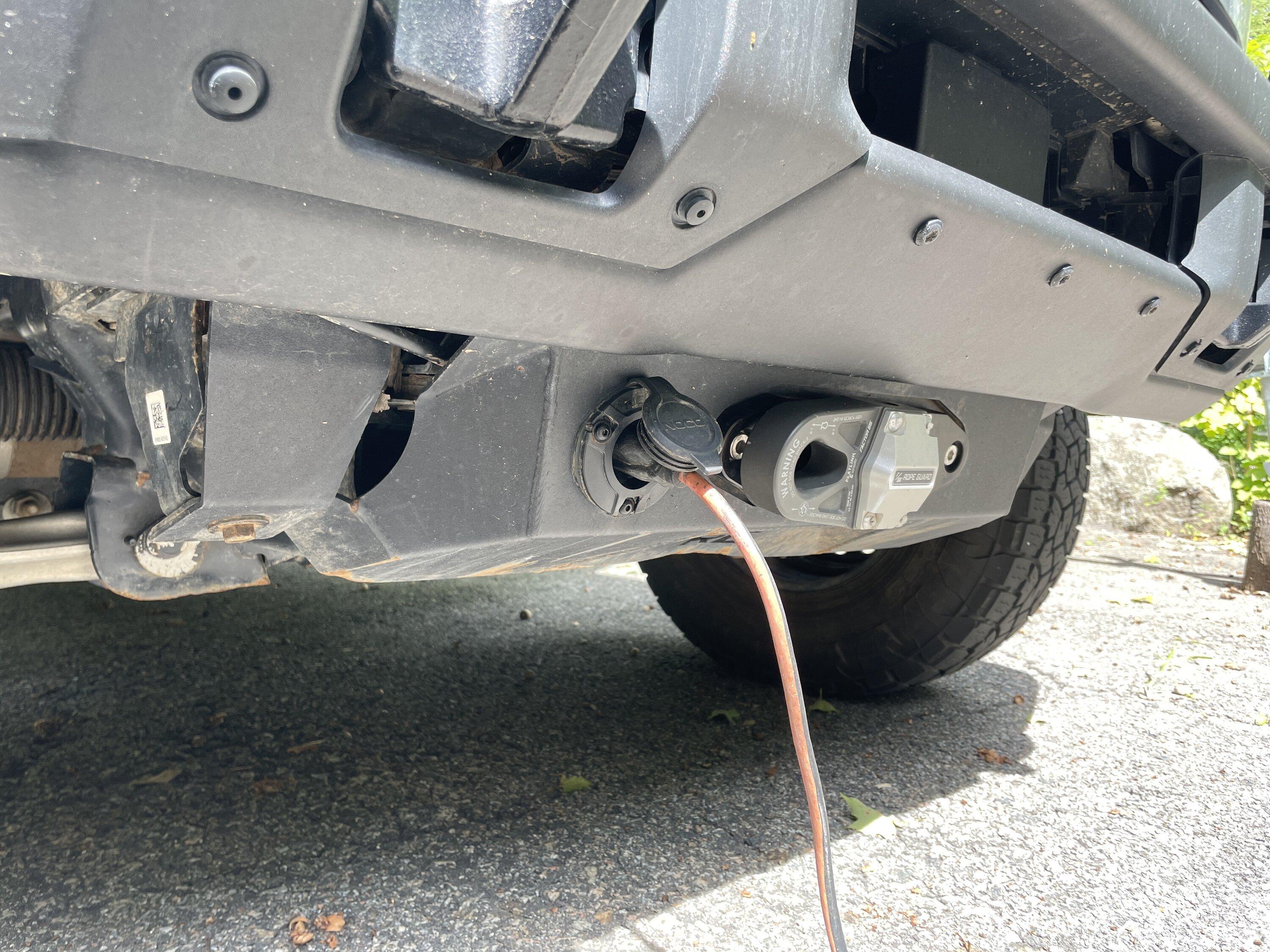

Alright, now I’m cooking with 120v.
Finally got the Noco Dual Port servicing both the block heater and battery tender. So, on those cold mornings both with get juiced up for 3 hours before my <2 mile commute.
Ford Bronco Block heater plug, terrible location IMG_5136

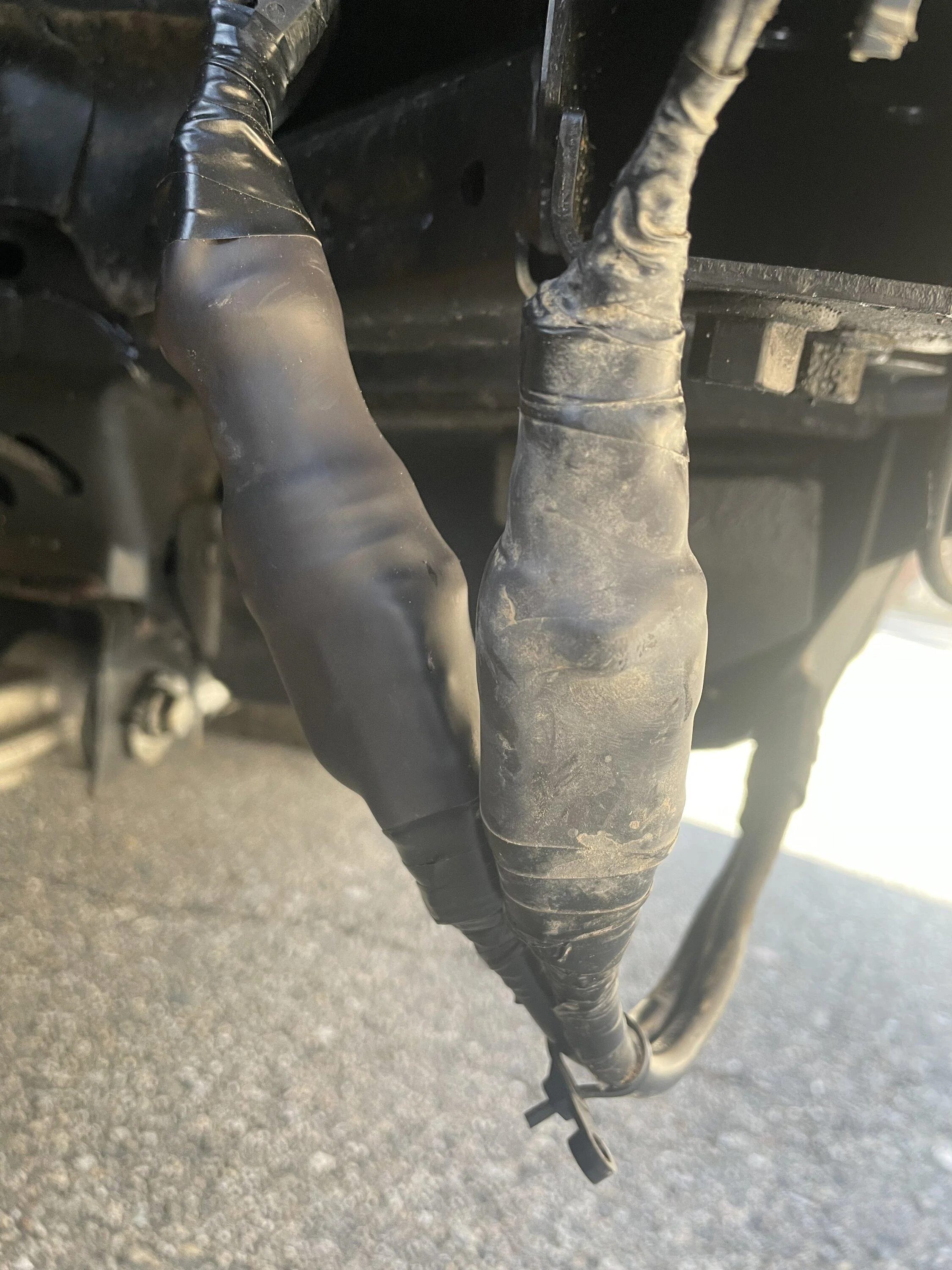

I used 1.5” 3:1 Waterproof Heat Shrink Tubing - This should help avoid any water issues for the long haul. I had the tender hooked up for the past year or so. Seems to be holding up just fine.
Ford Bronco Block heater plug, terrible location IMG_5673
All buttoned up. Unfortunately, I ran out of black zip ties and I’m anal and will likely replace them since these will turn yellow and ugly in a few weeks.

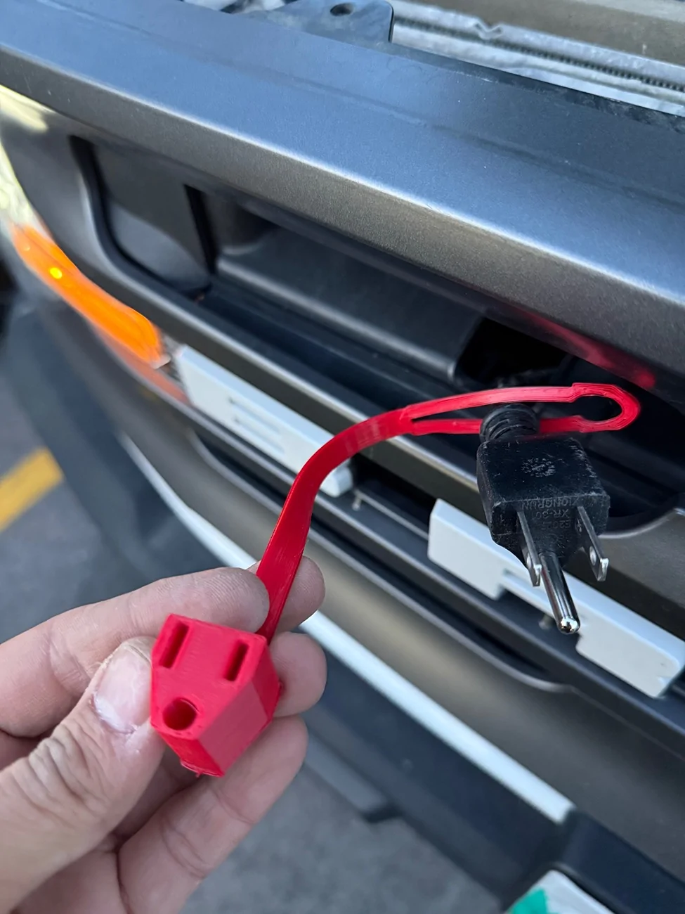

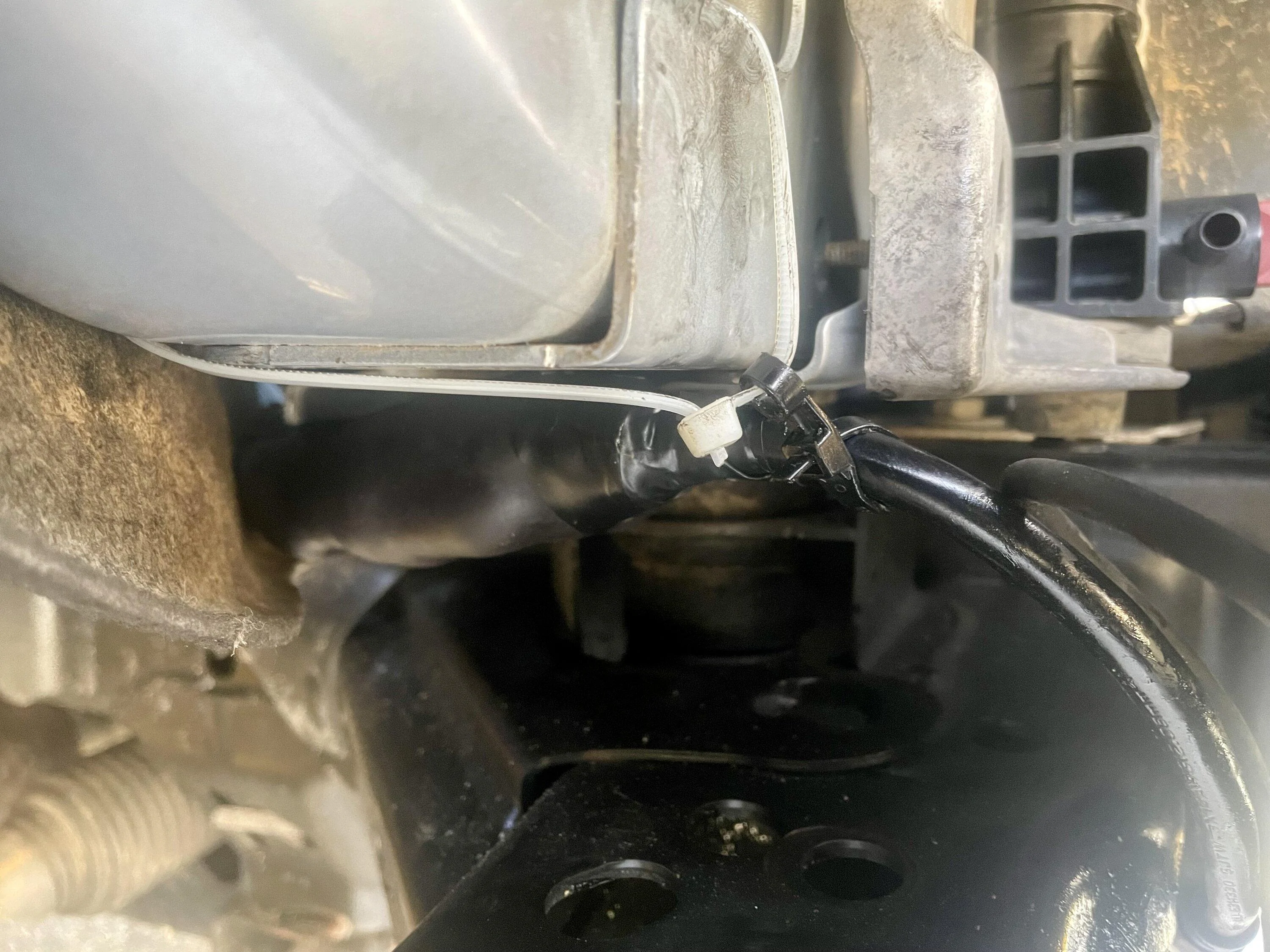

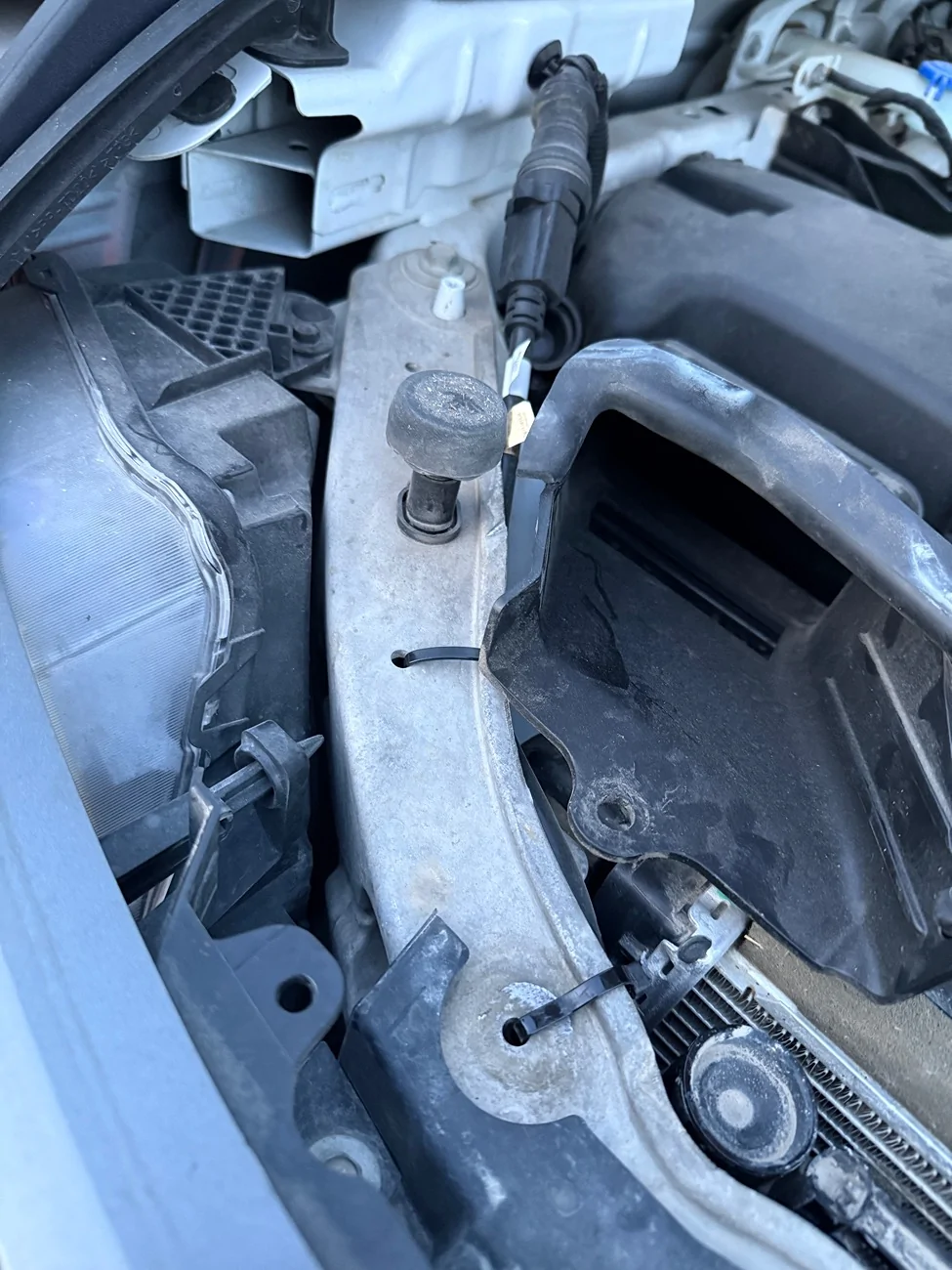

Well with the cold weather around the corner figured I better find the plug on my 23 obx, needless to say someone needs give their head a shake. Has anyone rerouted or extended theirs to an actual useable location? Would be nice if my wife didn’t have to open and block the hood everyday at work, let alone not having the engine compartment opened up to blowing snow.
I did a quick mod by adding a 2ft extension. Some people have unclipped the original cable rerouted through the bottom of the bumper but I didn’t want to do that. So here is my solution. You can also check out the post I made that has more details. https://www.bronco6g.com/forum/threads/block-heater-extension-mod.124379/
