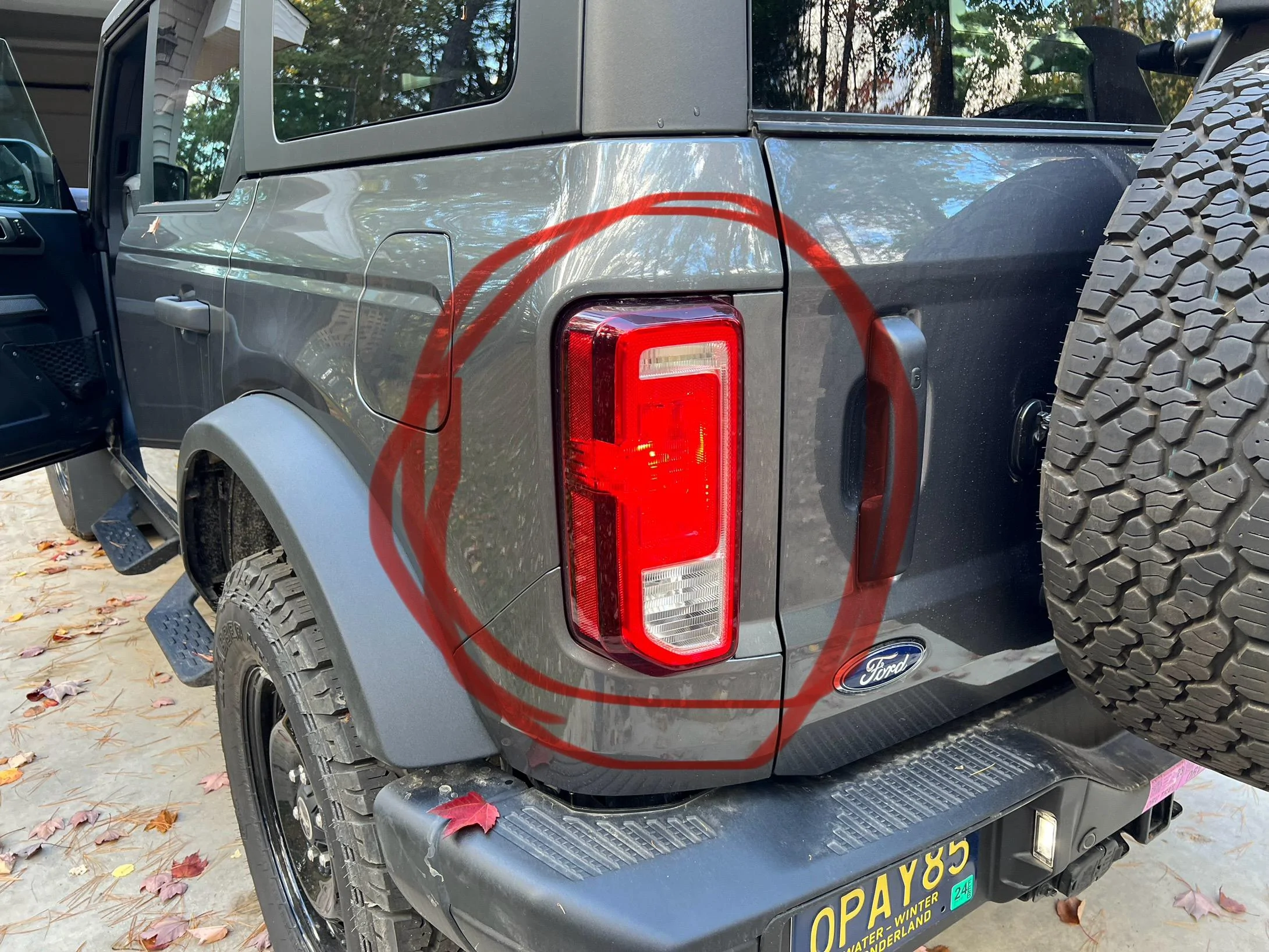

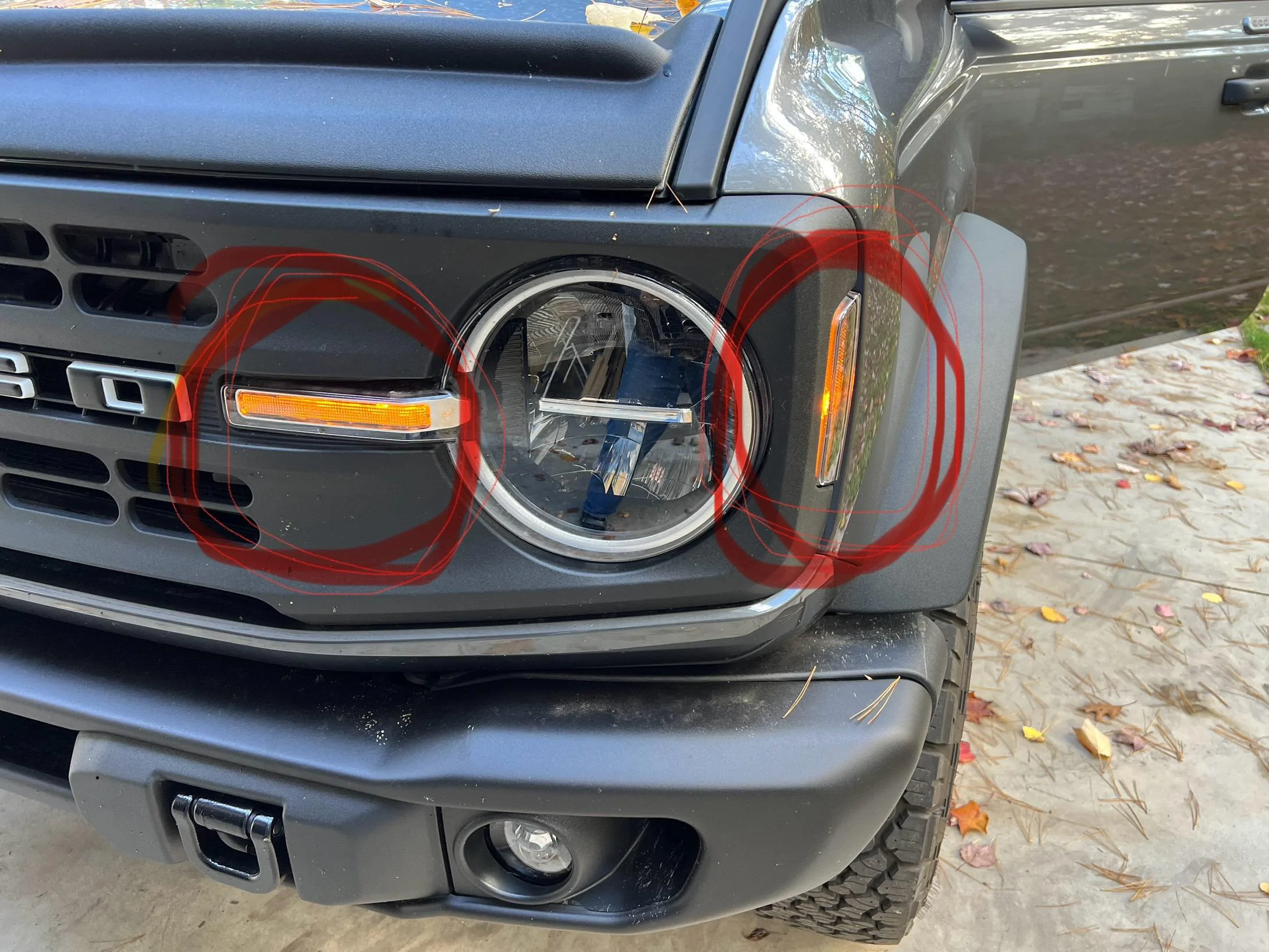

The blinker lights come on whenever I open the Bronco doors. I was doing some night photography and working out of the vehicle. This feature is really annoying. Is there a way to turn these off or disable?

The amber lights that are next to the headlights and the red ones in the rear. They come on and stay on for several seconds whenever the door

The same lights I believe.
Those are called Parking Lights or Running Lights.
If someone has found "Dark Mode" using Forscan for the Bronco you can make it so no lights turn on when opening doors.

They are really annoying. I do a few activities in the dark where the lights coming on cause issues. I suspect the bulbs for the running lights have dual functions so removing them would be an issue.
