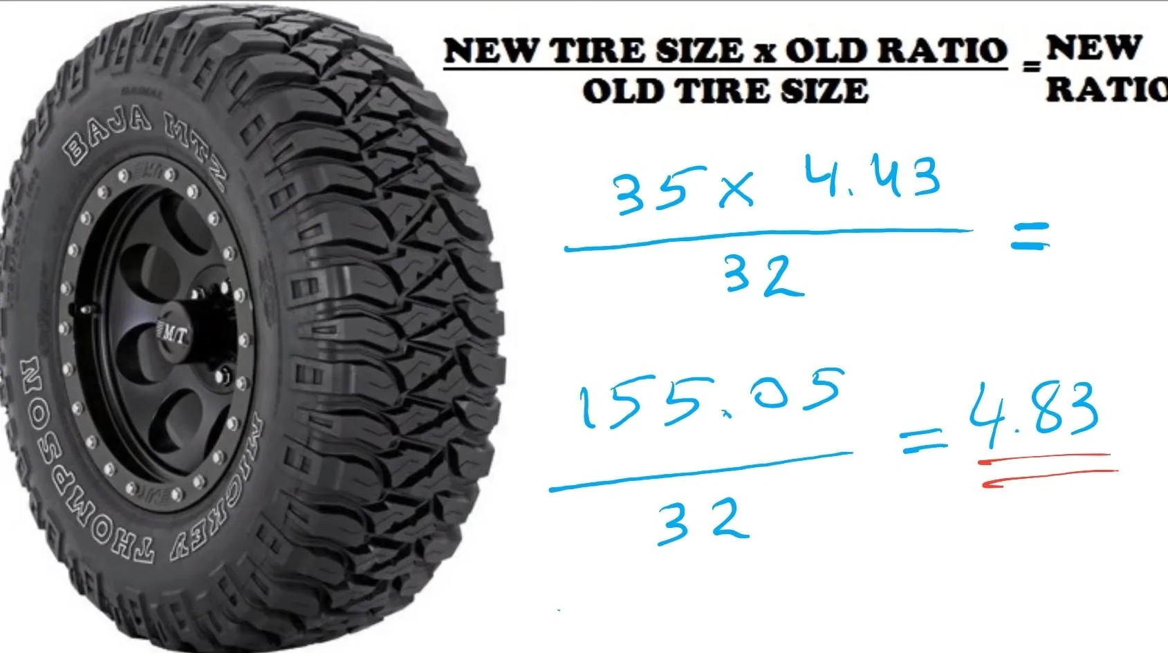

This is an interesting video shows how to calculate gear ratio based on tire size.
Here is the formula and my calculations based on BD w/o sasquatch (I guess if I need to keep 2.7 auto and 35s I have to get the sas)
Ford Bronco Black Diamond Bronco Thread Screenshot_20200907-124612_YouTu
[/QUOTE]
I understand the math and that there is a difference. If one is a hard core off-roader and excluding other variables like a highly tunable engine then the 0.4 difference might be meaningful. But if one is driving it as a mix of DD and moderate off-roading, it would be hard to notice the difference. For me it is just a cost benefit analysis, which, of course, is different for everyone.
