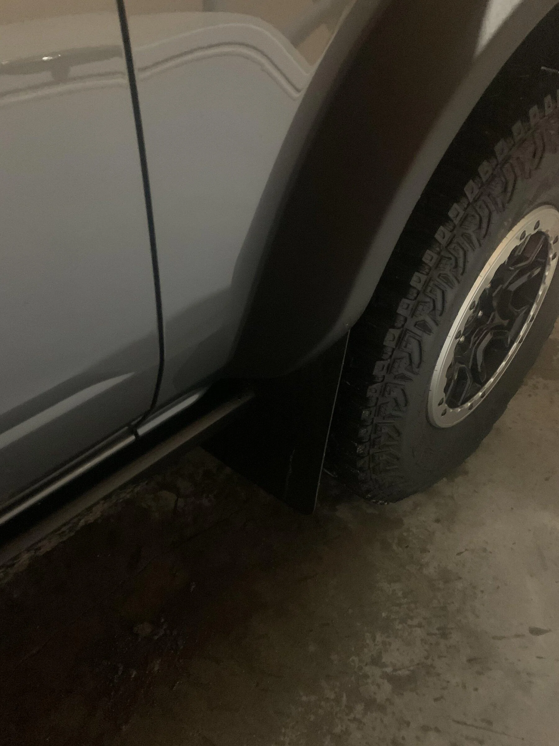

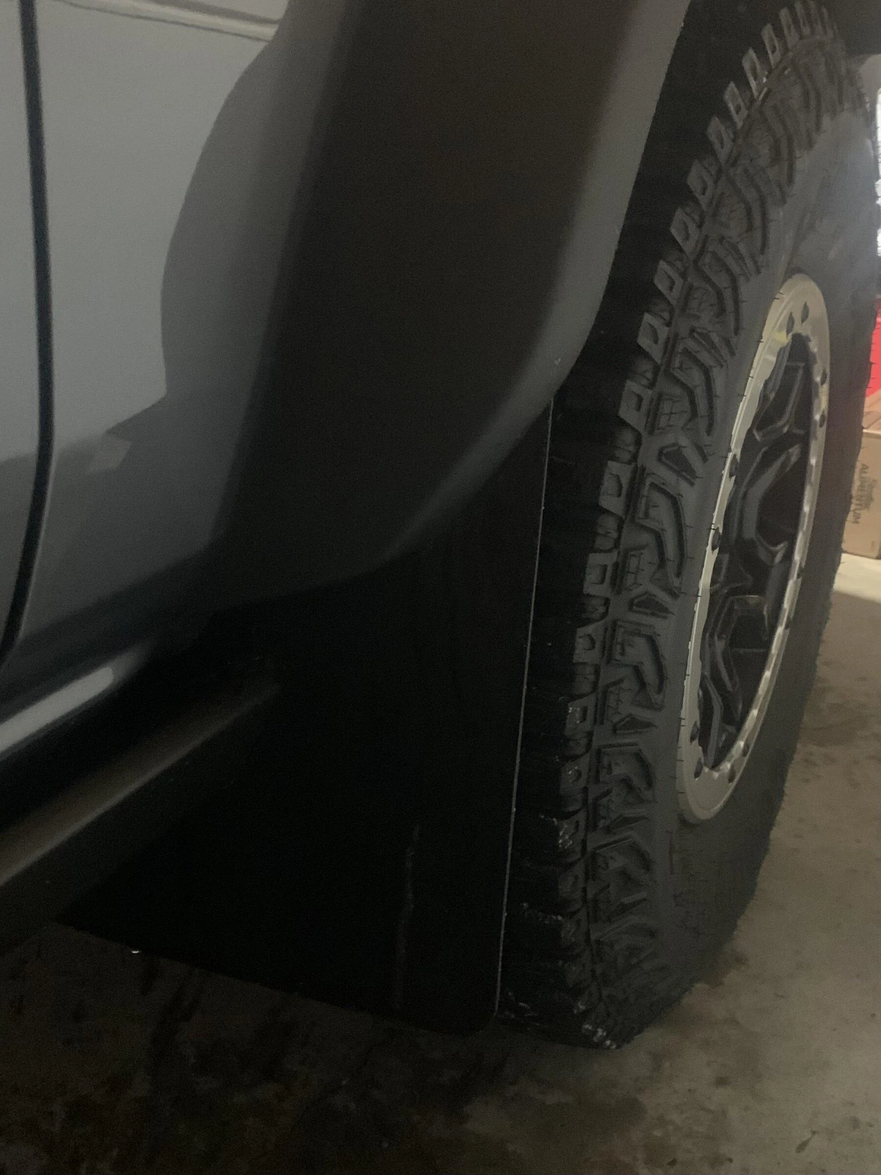

I just went with the "cheaper" Ford Gatorback Molded Splash Guards for the front only. I held them in position and used a pencil to trace around the cross-section of the rock rail, then took some additional measurements and corrected my "tracing" on the mud guard.
Once I was satisfied I used an Exacto hobby blade to slowly make the cuts. Essentially, I scored over the traced area repeatedly with the Exacto until it cut through the plastic. Took about 10 minutes for each mud guard but the fit is pretty snug. I did drill the fender flares, with the idea that I'd replace them later. But, to be completely candid, I really don't mind the look of the mud guards, so I probably will just leave it as is.

So, In this set-up, are you actually taking the rock rail off and threading it THROUGH the mud flap?

I didn't remove the rails, just slid the guards over the ends. There's a bit of a trick to it, getting the correct angle to align the guards while sliding them between the rail and the wheel well / bottom attachment point.

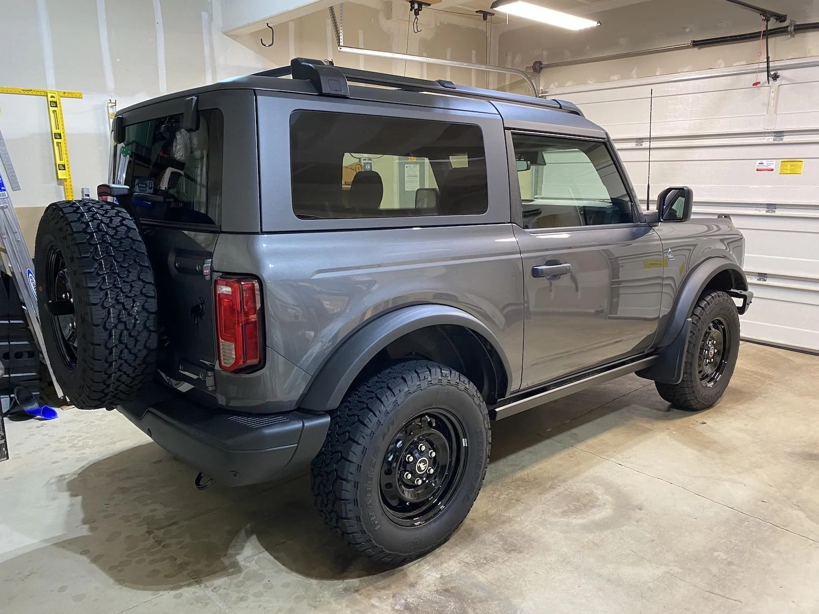

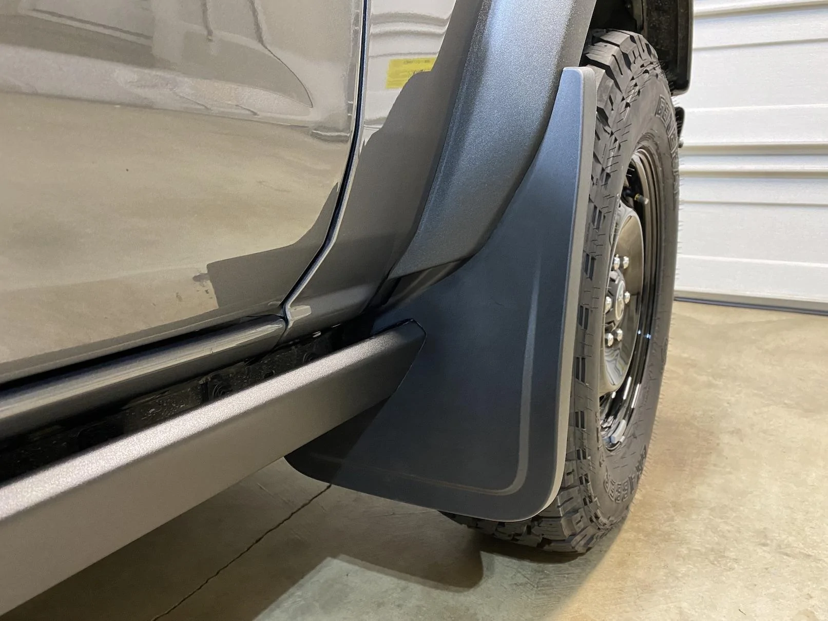

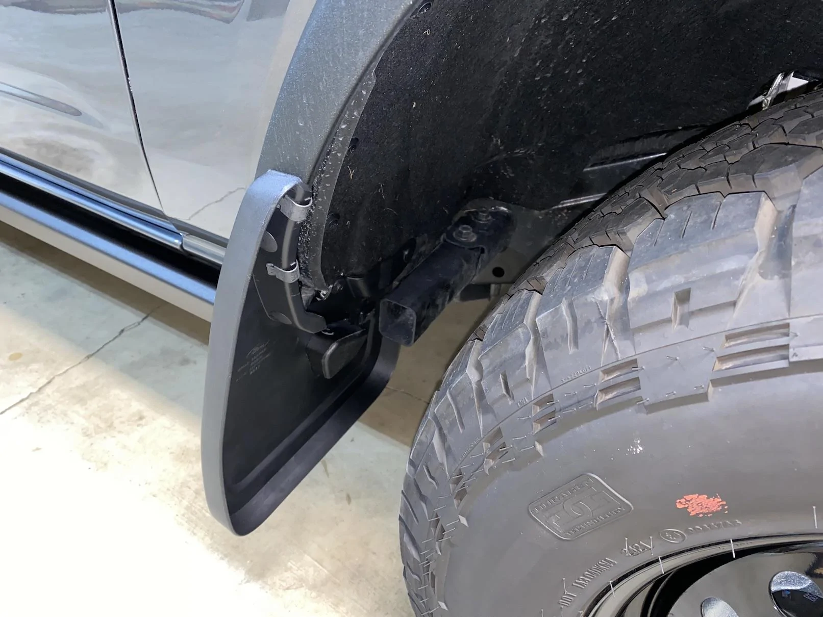

I tried fitting the factory flaps but just couldn’t get them to fit like I wanted without flapping on the outside.
I bought this set of mud flaps from northern tool for $8.49 per pair + extra for shipping. They are actually very thick and much more difficult to cut than the factory set, but a drill and jigsaw do the trick. I’d recommend ordering two sets in case you screw up like I did on the passenger side( I cut on wrong side of the flap. They are plenty wide for the Sasquatch tires and fit nicely using 2 existing trim clips in the fender well. I drilled one extra hole inside a lip on the fender flare (not through it). Longer plastic trim clips work better. With the right trim clips you could make them easily removable.
