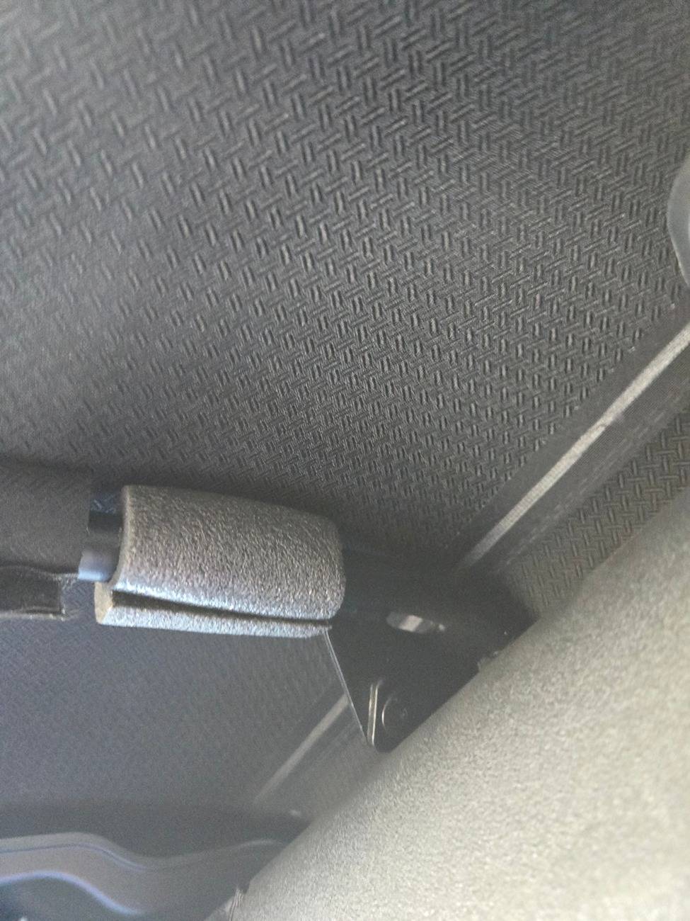

Hi I had a Jeep with the Sunrider and had to get one for my Bronco. I will say it performed much better on the Jeep.
The Bronco Sunrider is very noisey and makes loud slapping sounds that increase with speed. I never experienced this with the Jeep.
I began experimenting to find a way to quiet things down. On the center bow the top is supported by a Velcro loop but it ends at the turn of the bow where it meets the frame. I started placing my hand at this turn and noticed the slaping nearly stops. I hit my local hardware store and purchased 1/2" foam pipe insulation and cut it to fit the gap and it makes a big difference. Seems to me Bestop should have addressed this. Photo attached.

Very common fix, it just tightens things up a bit.

I've been pretty pleased with the Sunrider, no leaks though I do get the occasional slapping sounds. Going to try your pipe insulation trick.
