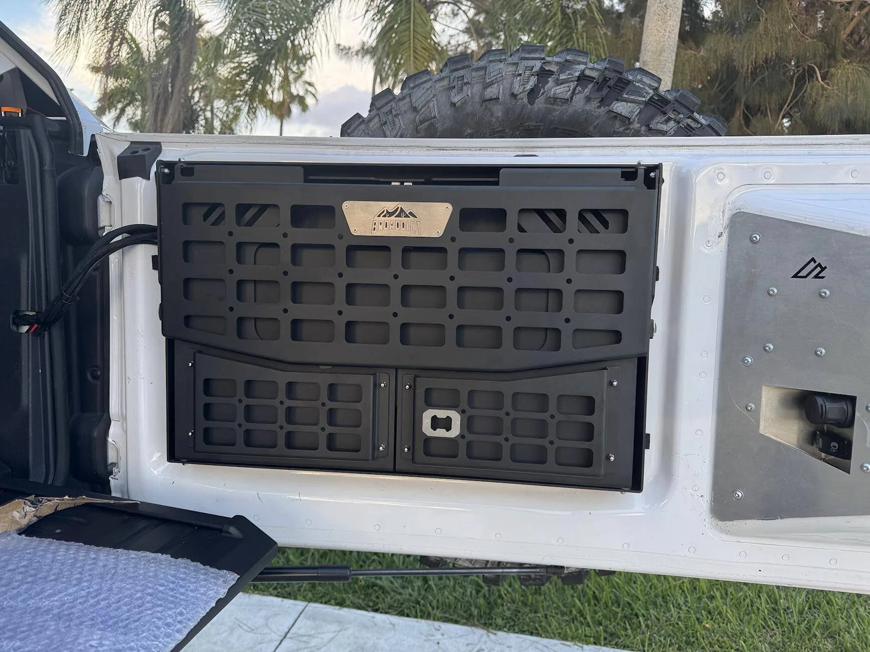

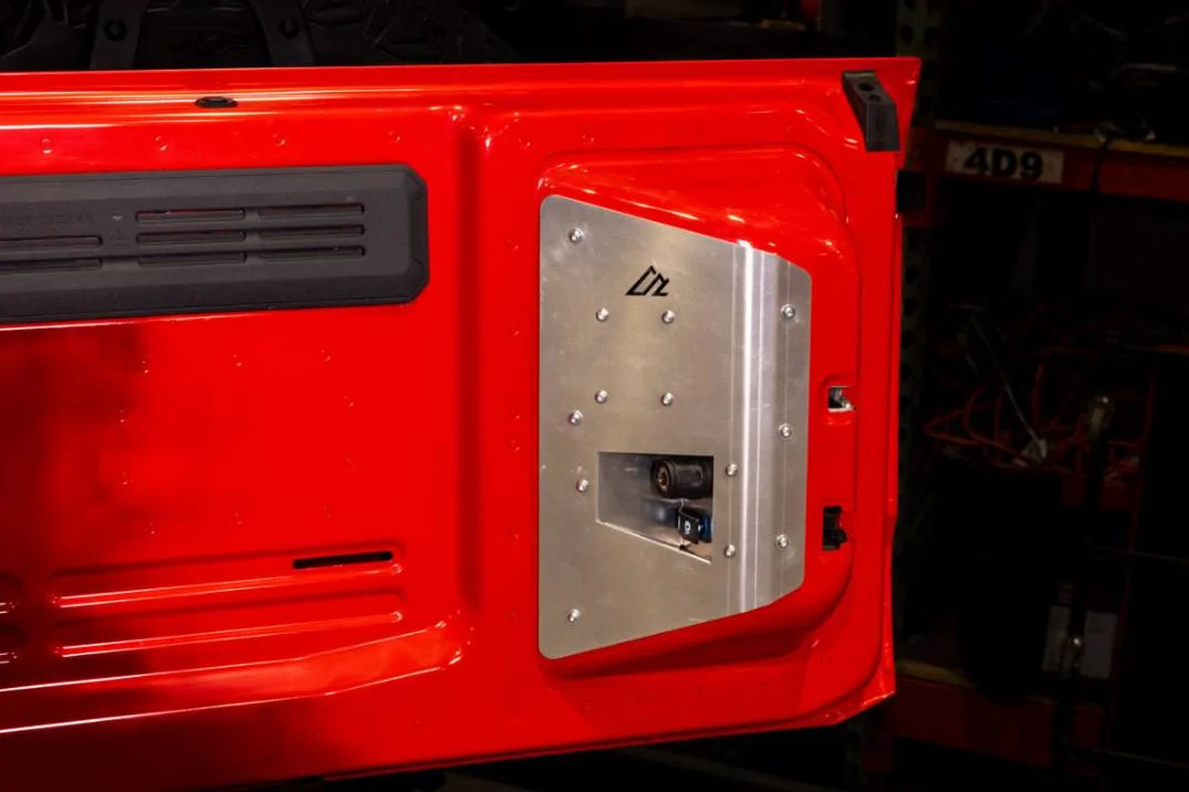

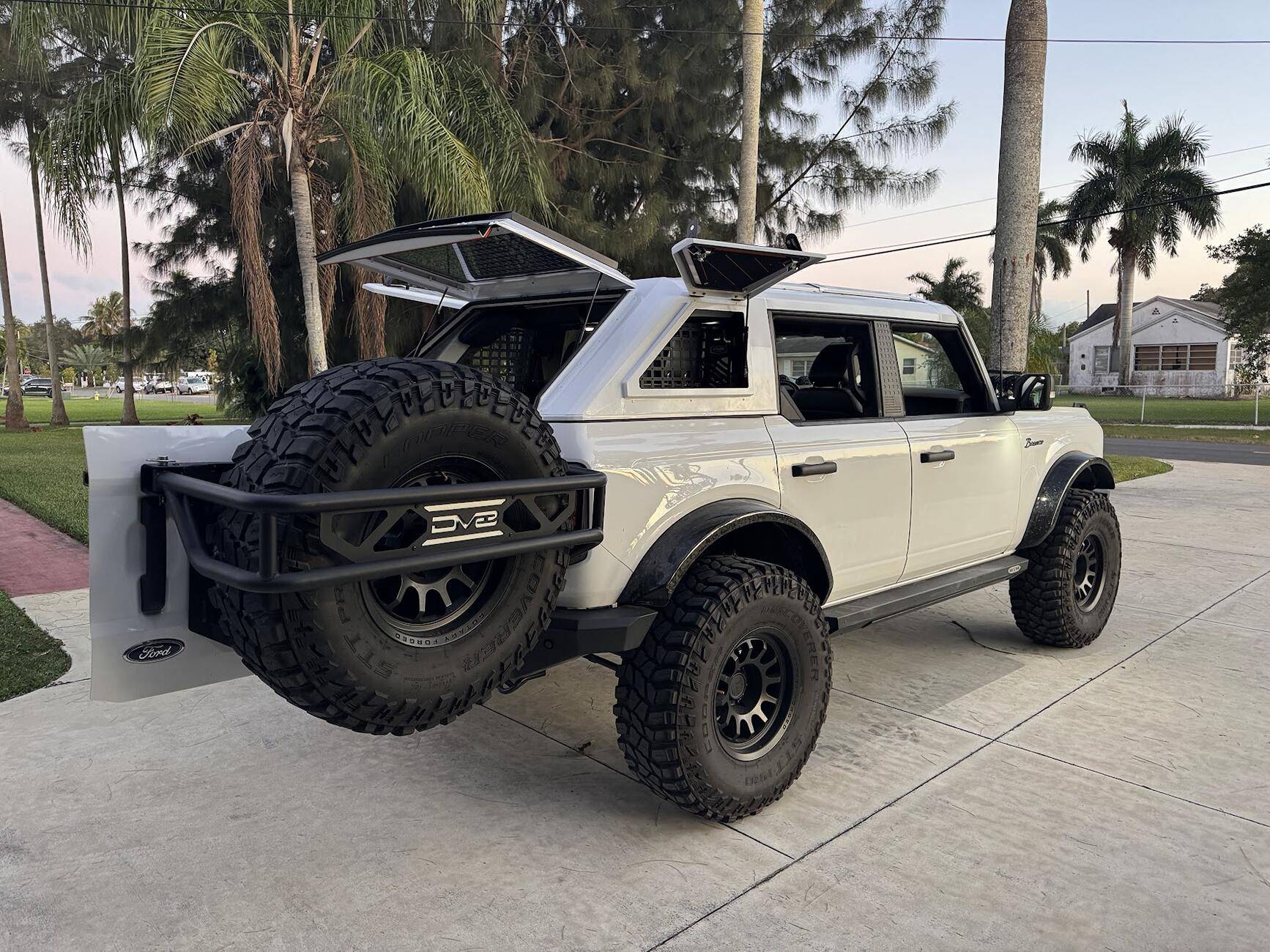

My space, running the AR/AAL compressor, and the BroAddict Molle table. I also run the DV8 Tire/Accessory carrier with a 37. No issues.

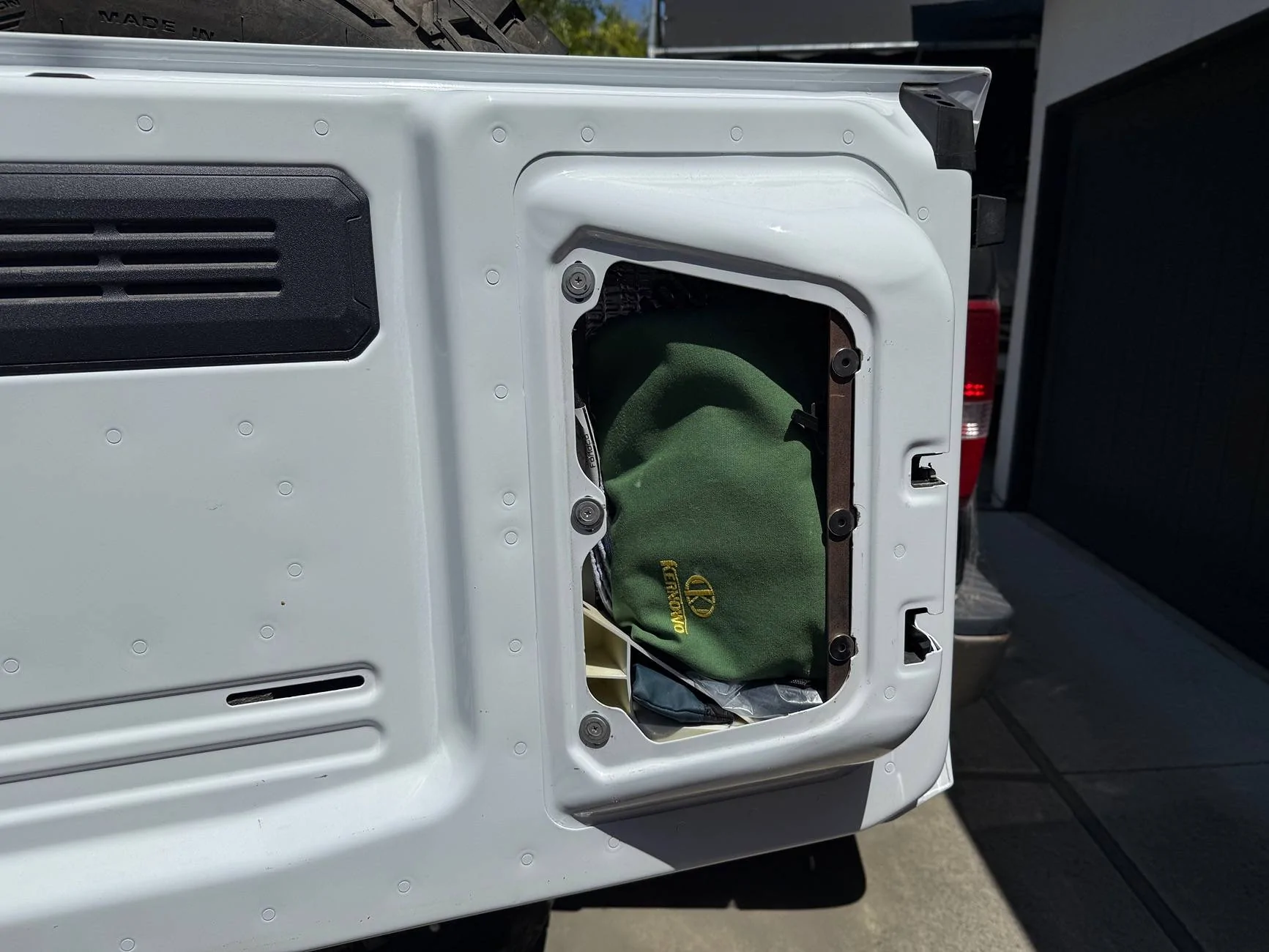

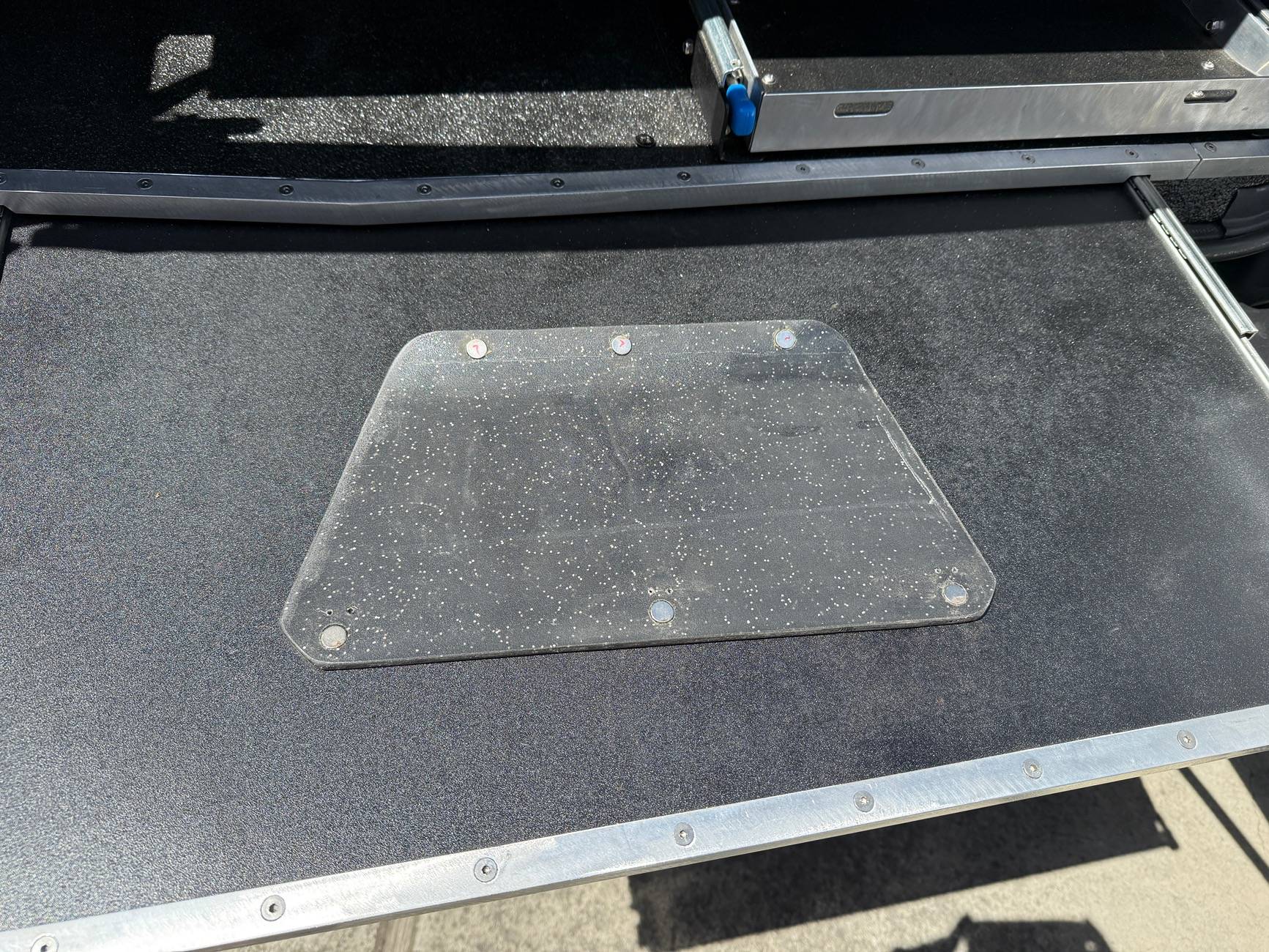

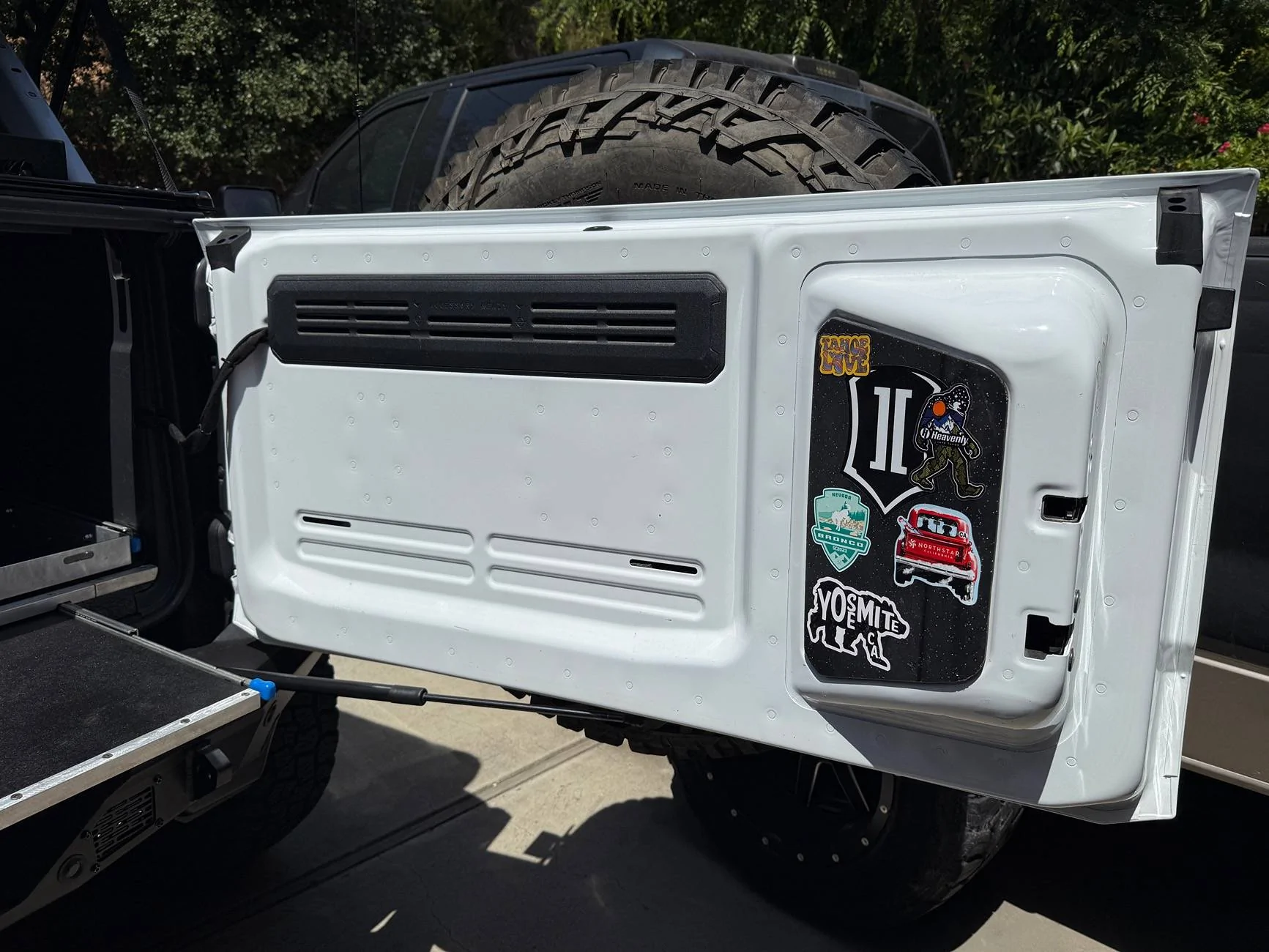

I made a lid out of a chopping board that I picked up from target. Heated it up with a torch and slowly got it to bend to shape. The lid hold in place very well with 6 counter sunk magnet. It's not perfect but it cost only a few bucks to make. I am able to store my winch remote and cable, air hoses and tire deflators.

Pretty sure that it is supposed to be a vented cover of some sort.

I was wondering the same thing when I was making it but haven’t notice any problems. Maybe because there are no seals or gaskets around the lid?

The tailgate itself has a lot of venting. As I stated earlier, I have the AR compressor in that location, and I have not had any issues, nor has anything overheated.
