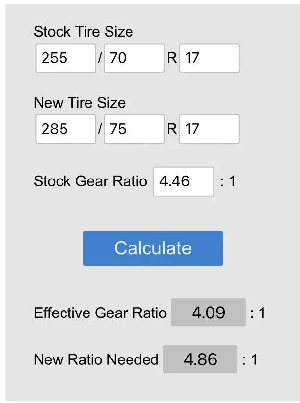

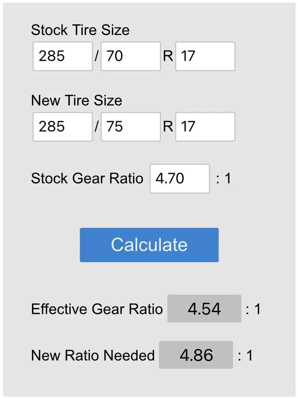

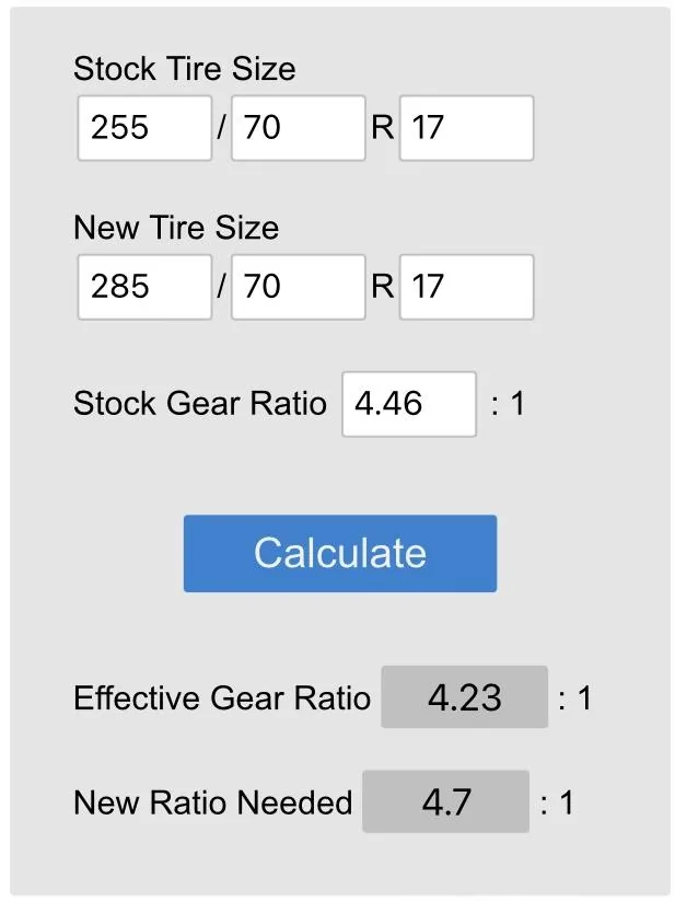

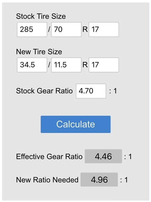

I’m kind of surprised to read these posts about 6th gear being useless with taller tires on 4.46 manuals with 34.5” and 33.8” tires. Ford sells the manual Sasquatch with 4.70 gearing like my non SAS Badlands has, doesn’t seem like that extra .24 would make that much difference. I was driving mine around yesterday and found first gear to be basically useless, I almost wanted to start in second. I haven’t had mine on the highway yet but I’m comfortably in 5th gear by 50 mph and the truck seems to pull just fine if I give it throttle. I placed an order for Toyo 285/75 tires on Friday, but Discount Tire came back and said out of stock with no ETA, based on your posts maybe it was fortunate and I’ll just stick with 285/70. I was only looking to upsize for looks, I can do anything I need to do on 285/70.
The gear ratios from base, which is generally consider overgeared.
Ford Bronco Best 33IN Tires??? 9145C5B1-72C5-4D58-90CC-8ABF9617DFF1
Ford Bronco Best 33IN Tires??? AB059498-6B1C-4146-AFBE-E194CE353704
Ford Bronco Best 33IN Tires??? 06E5520F-6B85-46BA-842B-D065F4CE9C84
The gear ratios from badlands, which compared to SAS is well overgeared.

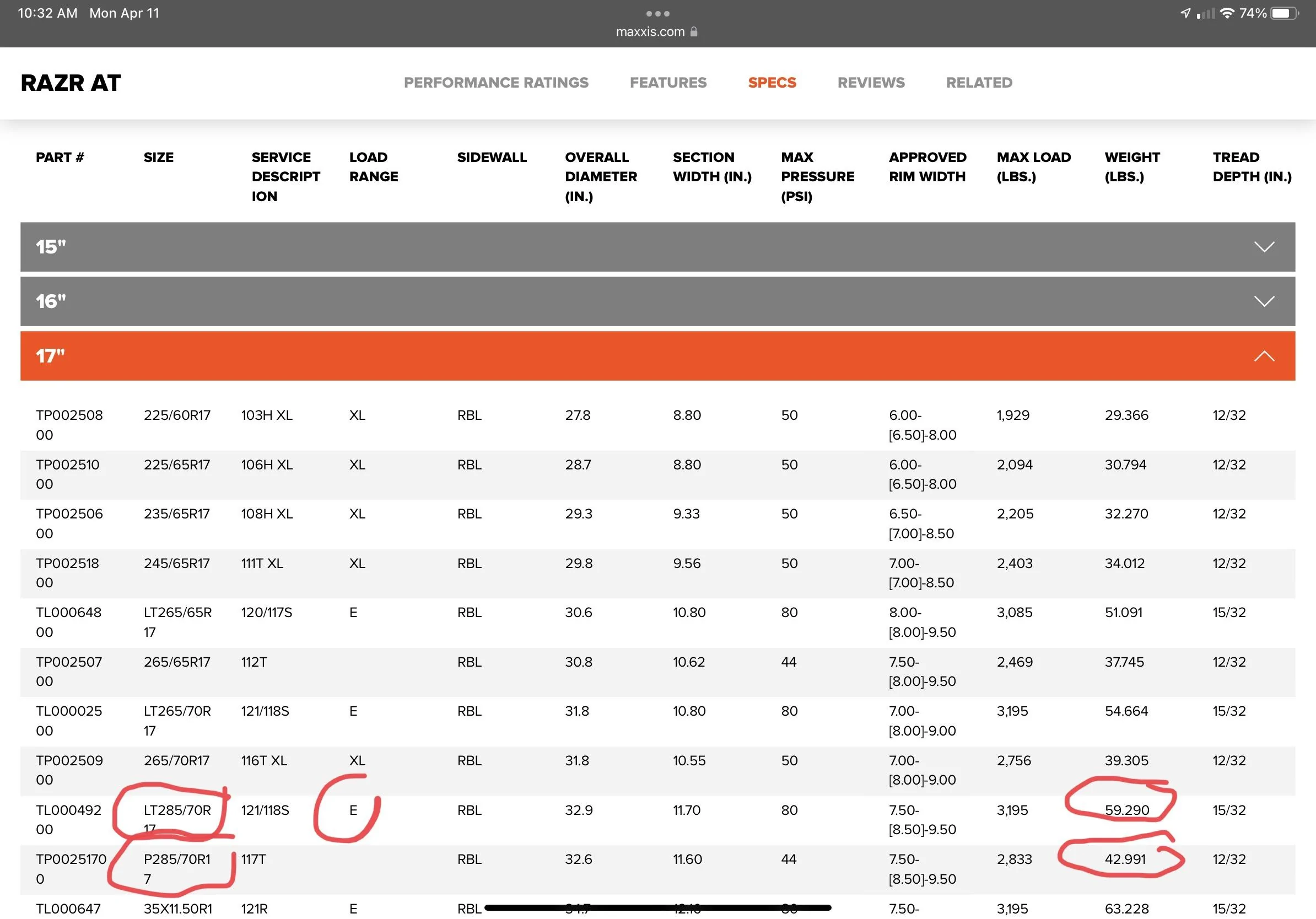

You could also consider Maxxis RAZR AT. I have heard good things about them and may put them on my BD when it comes in. They come in 285/70/17 and are very affordable.
The SL rated are light, the E rated are in line with other E rated in that size.
