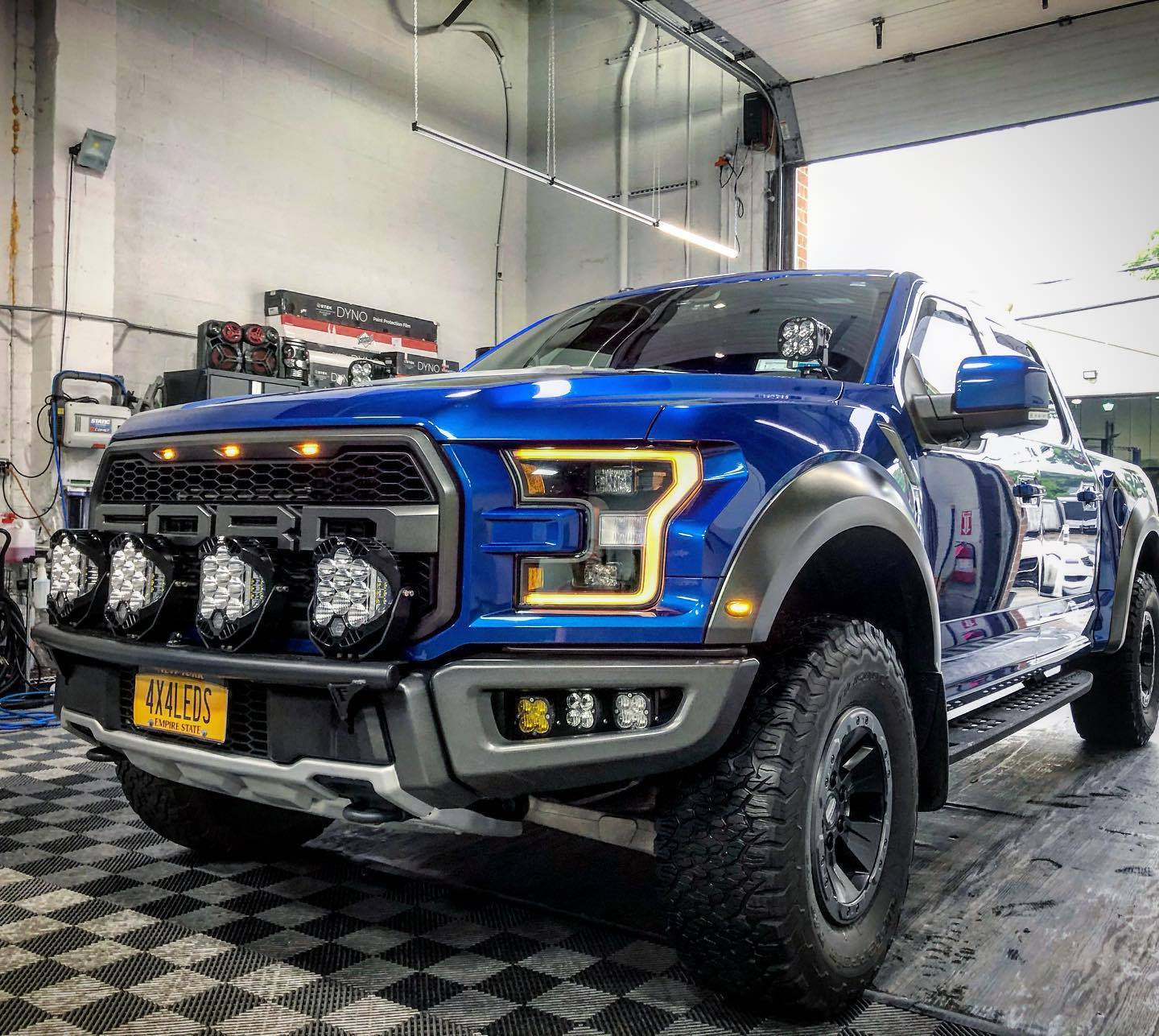

Welp our Gen2 Raptor runs 3x Squadron Pro.
1x Squadron Pro WC
1x Squadron Pro WC Amber
1x Squadron Pro DC
They are aimed down low though, check out this photo you can see how we have them aimed so it does not blind others and the pattern falls below the headlights
Ford Bronco BD Pro Vs SAE Brackets14
See how the inside and outside lights are aimed down. Those are the Wide Cornering ones.
You could run Squadron Pro WC on the bronco, just make sure they are aimed down low below the low beam cut-off. There will be a bit more light scatter then say the SAE but you could get away with it. It's not "street legal" speaking from a legal sense, but depending on where you are you probably won't have any issues
