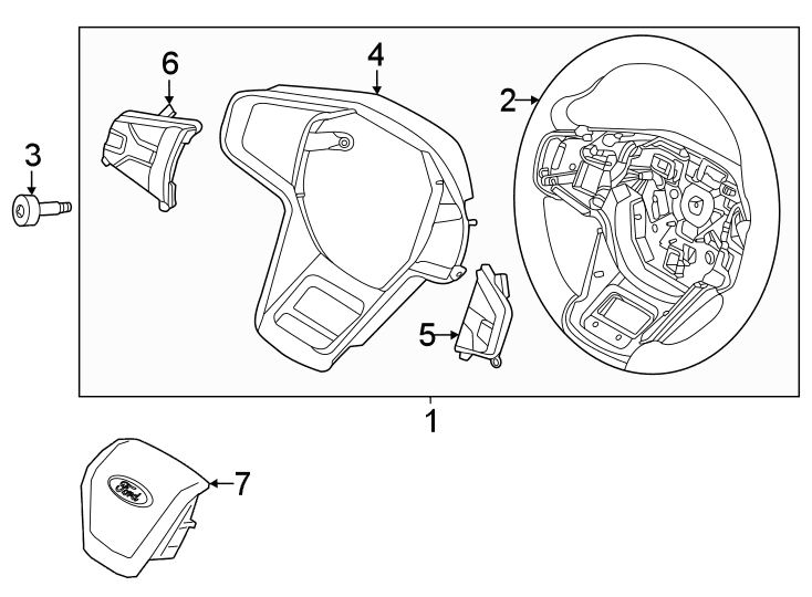

Well we're about to find out because I ordered M2DZ-3600-BA in anticipation of my Base arriving 2/10
Curious why you chose -BA (all of the components of #1 in the photo) vs -BB (just part #2 in the photo)?

I have the same question. I've always just replaced the rim.
It was a little less than $100 more and I'd prefer to just press 2 detent springs, 2 electrical connections, the 2 air bag connections and a bolt.
That $100 will save me time and aggravation and I'll be driving with my leather wrapped steering wheel to pick up beer faster.
Well, you'll have some spare parts in case any get worn. (y)

Totally get what you guys are getting at. Obviously ordering the BaseSquatch I enjoy a good deal but somethings I'll cave to and this just seemed like one that made sense.
