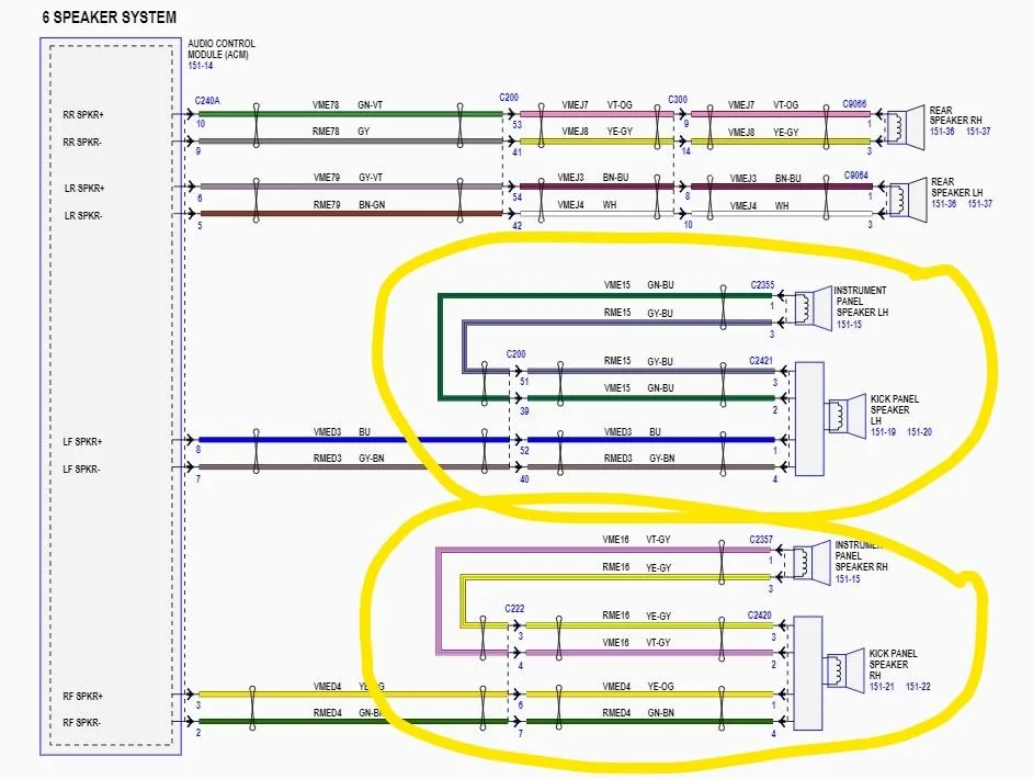

Hey, so the amp is wired into the factory speaker outputs circled in the picture below. As for the 12 volt, I'm guessing you mean the remote turn on, if so that's actually done by the amp itself when it detects power coming through the factory speaker wires.
One of the reasons I liked this amp is because I can then use the blue remote turn on wire that would be an input normally, to tell my sub amp to turn on in the back. So no tapping into the fuse box!
Phil, can you please elaborate on this "blue turn on wire". I see the 8 speaker wires you have circled. Is it one of the other wires on the image? I'm trying to avoid tapping into the fuse box myself. Thanks

Thanks Binky but I was referring to the remote turn on wire. I wanted to ask if Phil knew which one, if any, of the other wires could be used to turn on my amp.

So if you are using the exact same amp I did, it has the ability to turn itself on when it detects the factory system being turned on from the input speaker wires. I used the blue wire as a remote OUT to turn on my sub amp.
There are of course other amps with the same DC offset feature that can function the same way and avoid tapping into the fuse box!
"DC Offset turn-on can be used if speaker-level audio inputs are being used. The DC offset mode detects a 3V DC offset on the speaker wires when the source unit has been turned on."

isnt the blue wire @jay102269 has circled a speaker wire?
The terminology "Blue Wire" tends to come from aftermarket audio upgrades. The wiring kits in these tend to use a blue or blue/white wire for the accessory wire and red for the wire that comes from the positive battery terminals. When dealing with factory wiring, you can never be sure. This is one of the reasons why factory to aftermarket adapters are used so widely.
The picture with the red circle is what Phil illustrated many posts ago denoting the speaker wires. I was thinking he meant the Dark Blue/Light Blue wire beside the red cirlce as the remote turn on. Or I could be wrong he meant another blue wire. My plan was to mount a 5 channel Soundstream amp under the driver's seat.
if you are setting the soundstage for the front only, can i ask why you want to use a 5-channel amp instead of 4?
