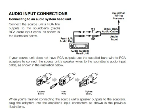

I have posted on how it integrates in prior threads, but it has three inputs, the RCA to the head unit, bluetooth and a 3.5 jack. Blue tooth overides the head unit RCA connection when connected to Blue tooth, and the 3.5 jack overrides both RCA and bluetooth when connected.
Here is the link to one of my prior posts on this,
https://www.bronco6g.com/forum/thre...o-with-lux-or-jbl-sound-bar.17327/post-629313
Thanks. So I guess we hope the factory for head unit has L/R Audio out to make it easy, right?
Ford Bronco Base Sound System Upgrade/Build Screenshot 2021-06-29 122701
