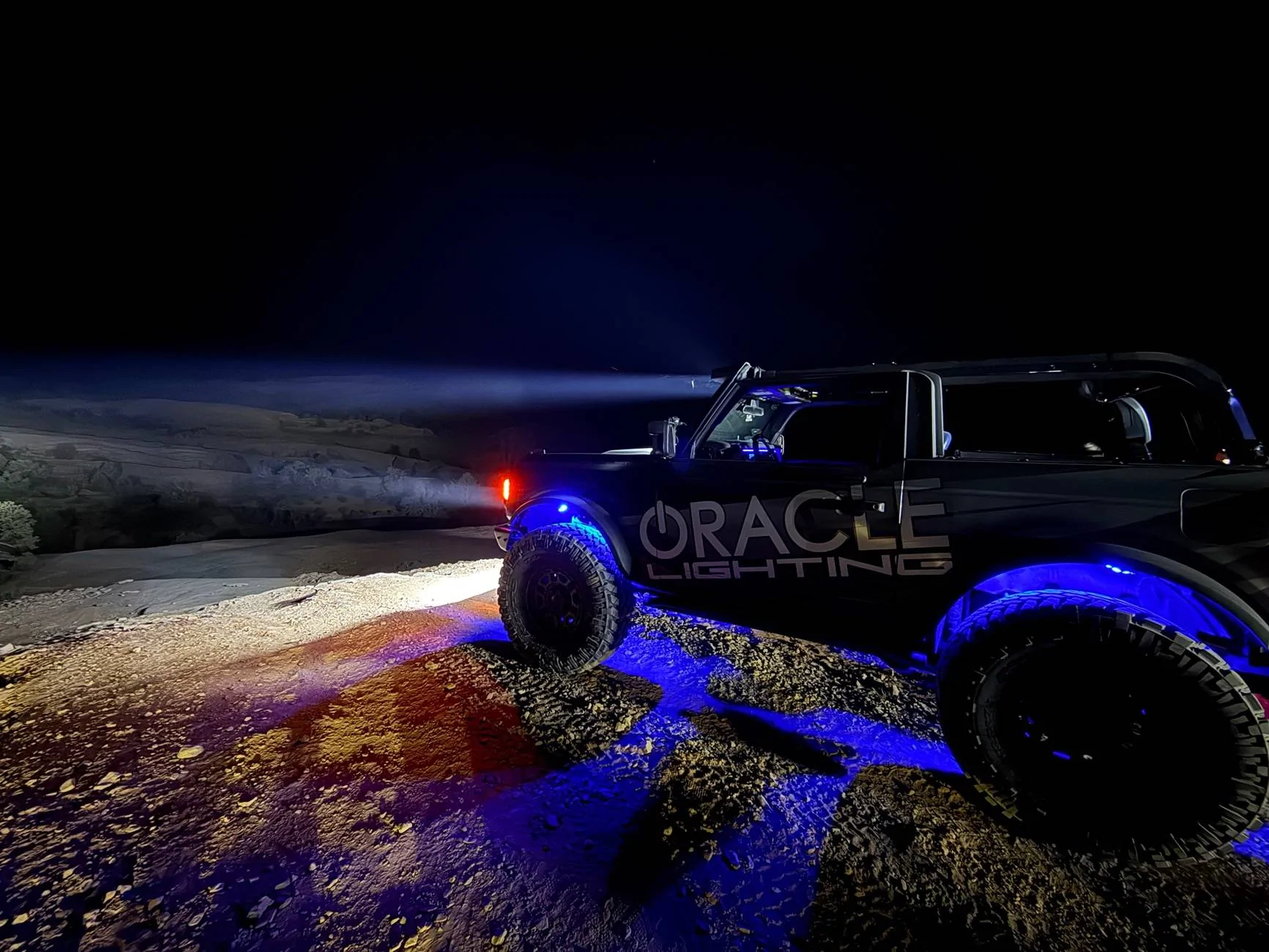

Here is our Bronco lit up on the trails in Moab!!
Ford Bronco Base headlight halo and rock light lighting IMG_0539
