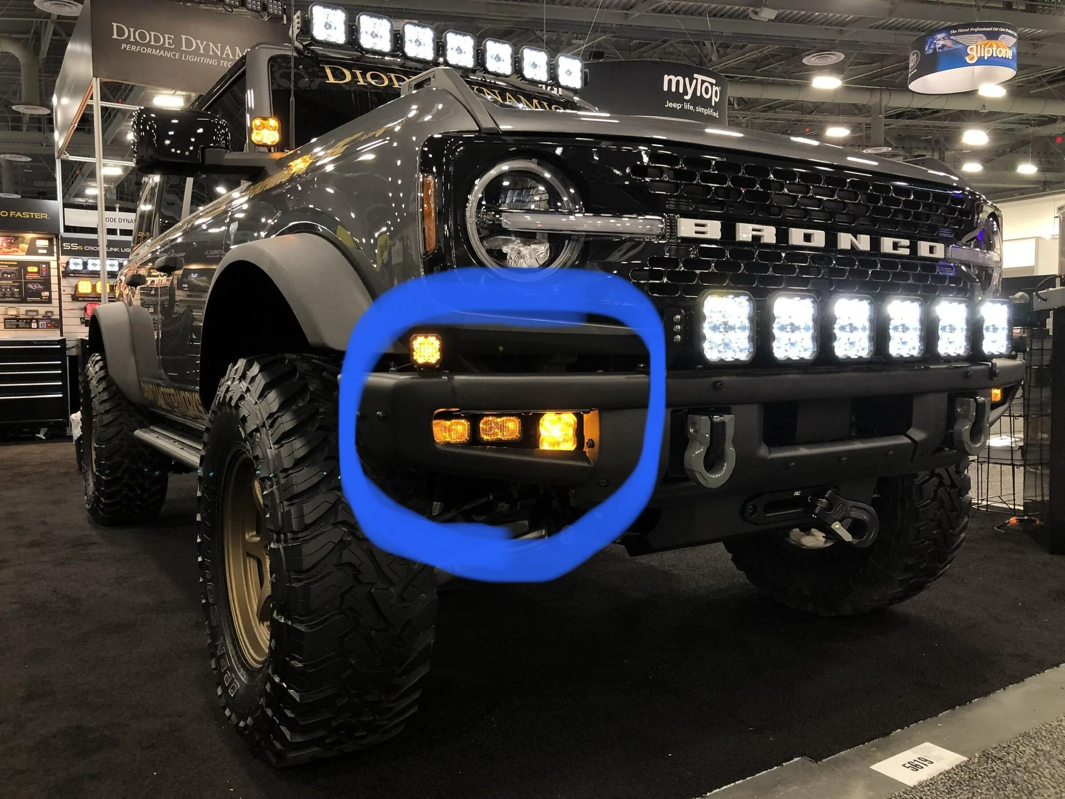

I don't mean to hijack your post but what are these? Because with that front lightbar along with these amber lights I think it looks amazing.

Diode Dynamics lights. We've been selling them for months: https://www.4x4truckleds.com/diode-...-w-kr-off-road-brackets-for-2021-ford-bronco/
The SSSC2 (smaller 2" ligjht) have always had a back-lit option, which is what you see pictured. The SS3 (the larger 3" light on the inside) have a back-lit option coming soon (this week we're told we should be seeing our SS3 back-lit lights ship to us). That was a truck at SEMA so they were showing off the new back-light SS3 and the new bumper light bar you see there.

Thank you! I’m picking up those amber lights for sure. It will tie in well with the Amber bronco led mod that’s floating around.
How does that bottom lightbar work with the lux front camera?

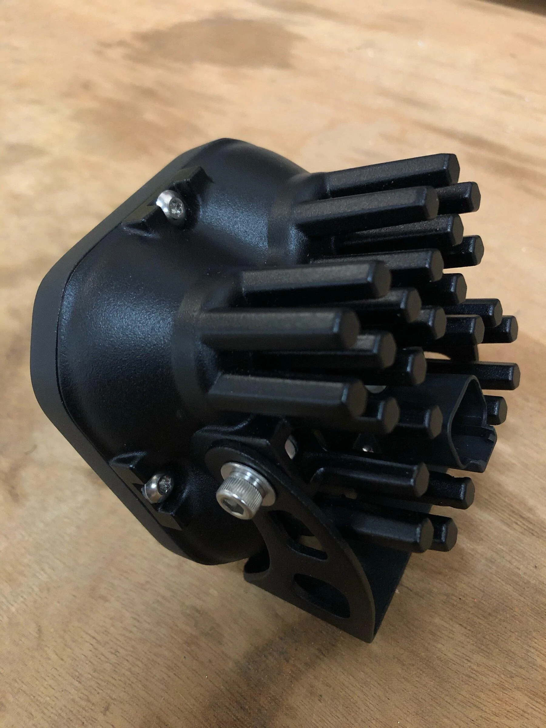

The only thing I disagree with is the finish of BD vs DD. I owned BD before DD entered the market and found their pods being anodized fade over time compared to DD powder-coated finish withstanding several drops during the installation process (clumsy me).
My Squadron Pros are still black. 6 years later

The front camera gets partially blocked naturally. You'll see the light bar in the image but you'll still see in front of you.

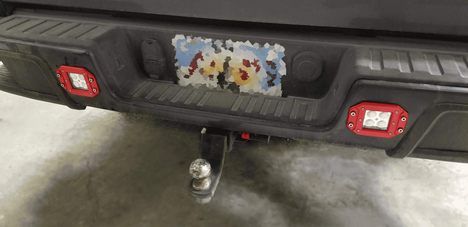

I don't really mind, since they're replacing functioning (ish) LEDs, but I was curious. Lifetime LED amber/white cubes. The DD mounting pattern is identical, so I'm going to get a noise-cancelled, better quality diode and board that doesn't make noise in my backup camera, a brighter white LED, but a slightly dimmer amber flash pattern for my Feniex switch controller.

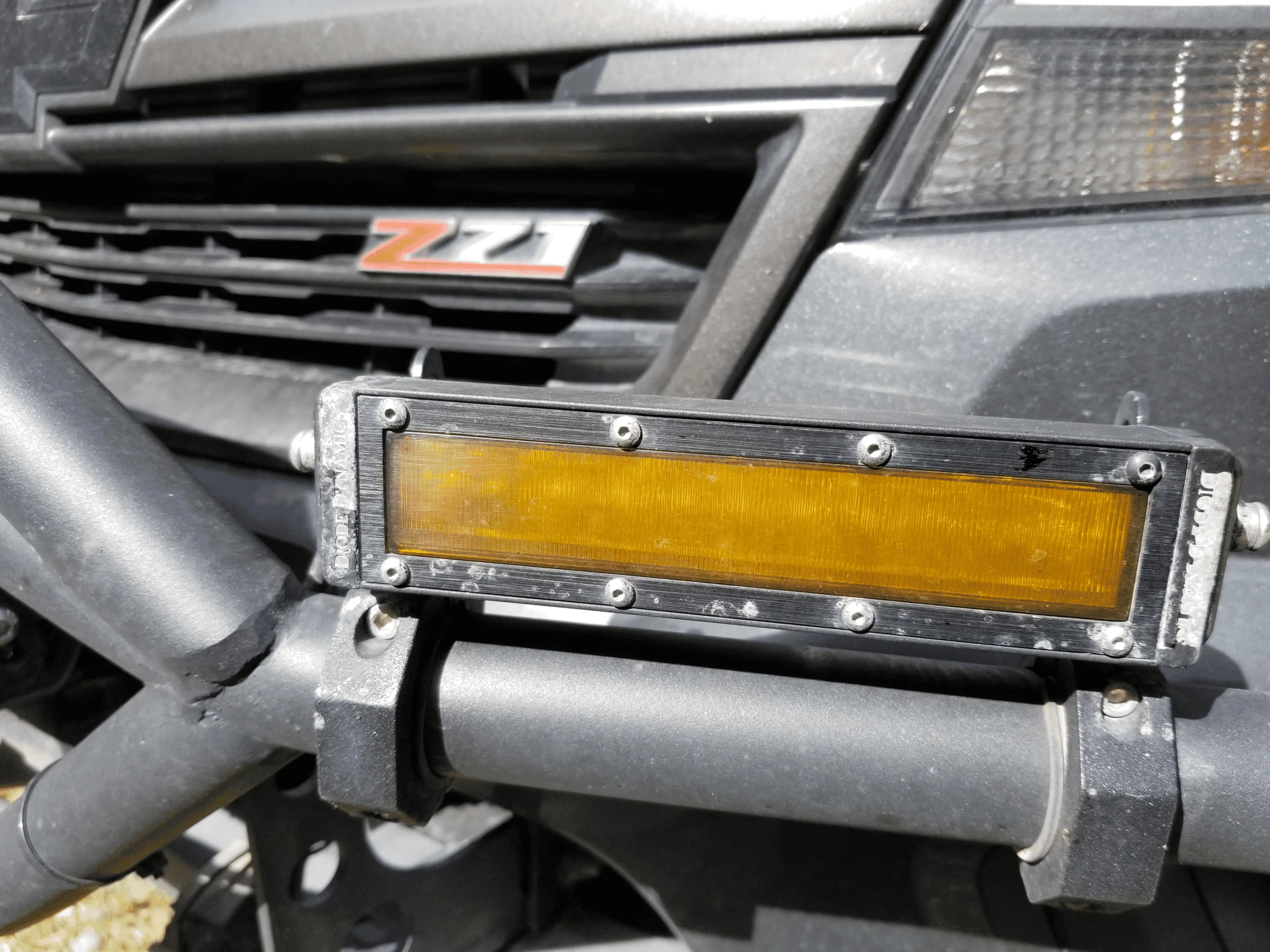

I have a mix of brands for lighting on my LWN Colorado which gives me a good amount of experience with each that mostly mirrors what @4x4TruckLEDs.com has experienced.
Front facing:
Diode Dynamics SS6 Amber wide lens​
Diode Dynamics SS18 2x Amber wide / 1x White spot lens​
STEDI C4 22"​
Baja Designs Squadrons (replaced Rigid Industries D2 spots, now on my Polaris)​
OEM replacements
Diode Dynamics XML2 5202 LED fogs​
Hylux 2A88 35W 4500K HID low beams​
Rear facing:
Baja Designs S2 Pro Amber combo in Evil Mfg 3rd Brake Light​
Lifetime LED Amber/White​
Cliff Notes:
  • Both brands mentioned ship with stainless hardware (big, often overlooked point, rusty hardware makes your truck look shitty)
  • Both brands have quality coatings, vs the Amazon Chinesium specials that yellow, or flake off completely. For my money, Rigid still has the best coatings.
  • Both brands use quality quick connects. BD uses Weatherpac-style and DD uses Deutsch Tech-style. Of the two, I prefer DD's wire, as 1) BD has a paper spacer in the wire that can wick up water if not covered/shrinkwrapped further and 2) I prefer the Deutsch Tech connectors.
  • Both brands are up front about their light output numbers and you can trust that output is what they say it is, unlike literally every garbage bargain-bin LED light on Amazon
  • The BD models I have are slightly warmer color temp than DD, but that could vary between batches
Bottom line, they both have great products, their modular design principles let you make the light you need, they both have great customer service, and you can't go wrong with either, or both, like me.

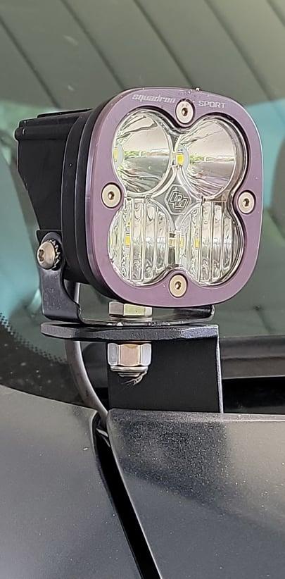

As for the coatings, I call it a draw, because I have experienced both faded Squadrons, and SS6 endcaps flaking. Both have top quality anodizing on other parts of the same light, so I can totally understand BD's statement earlier in the thread of not being able to QA/QC every single item. Easy as an email to each company to get replacements on the way.
