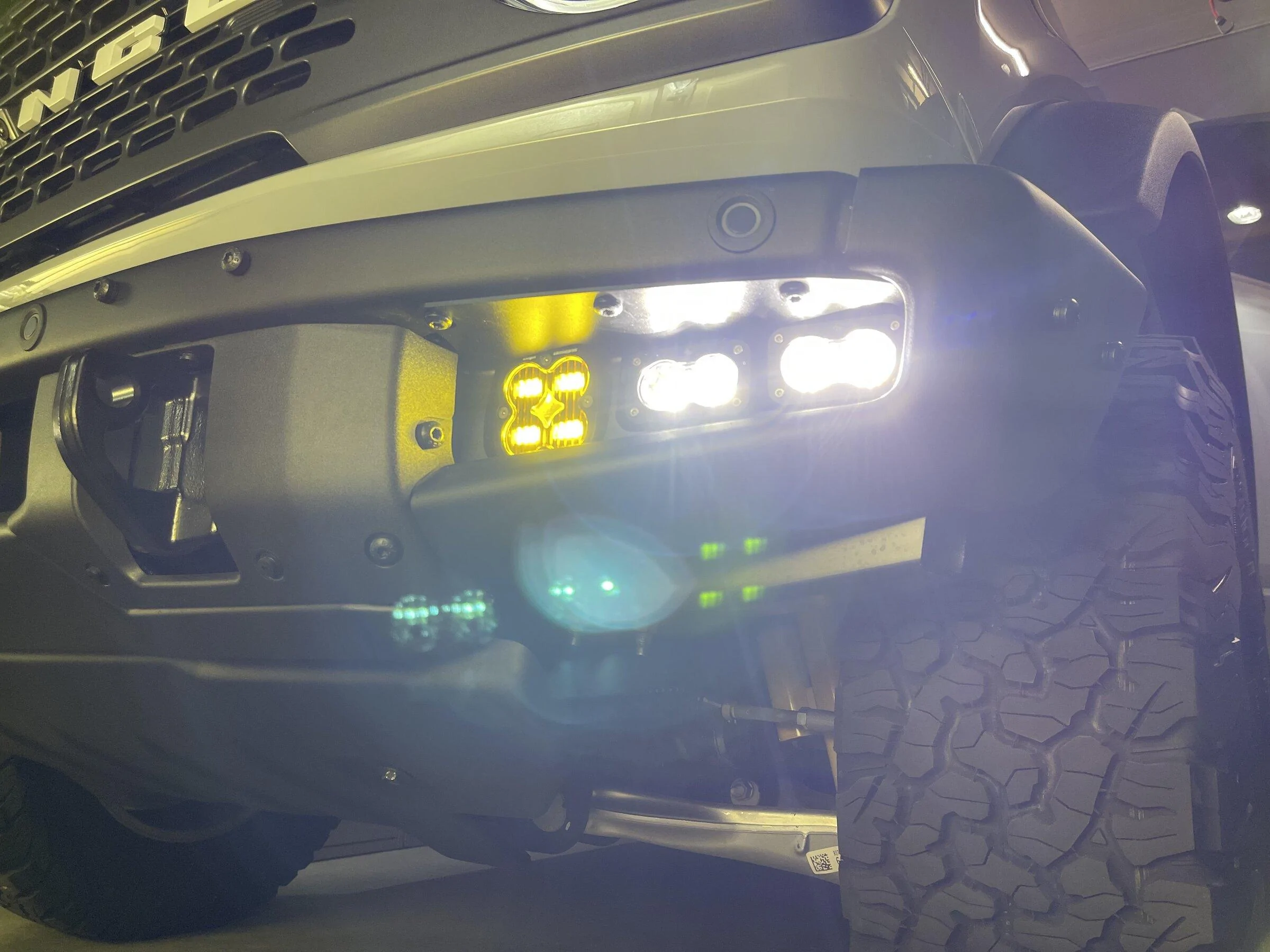

Fitting worked out, just had to figure out what went where. Didn’t remove bumper ends just the bash plate to hide the wires.
Ford Bronco Baja Design install help needed 3089E535-814D-471F-8432-1A67FA06A84E
Man they look so damn good congrats

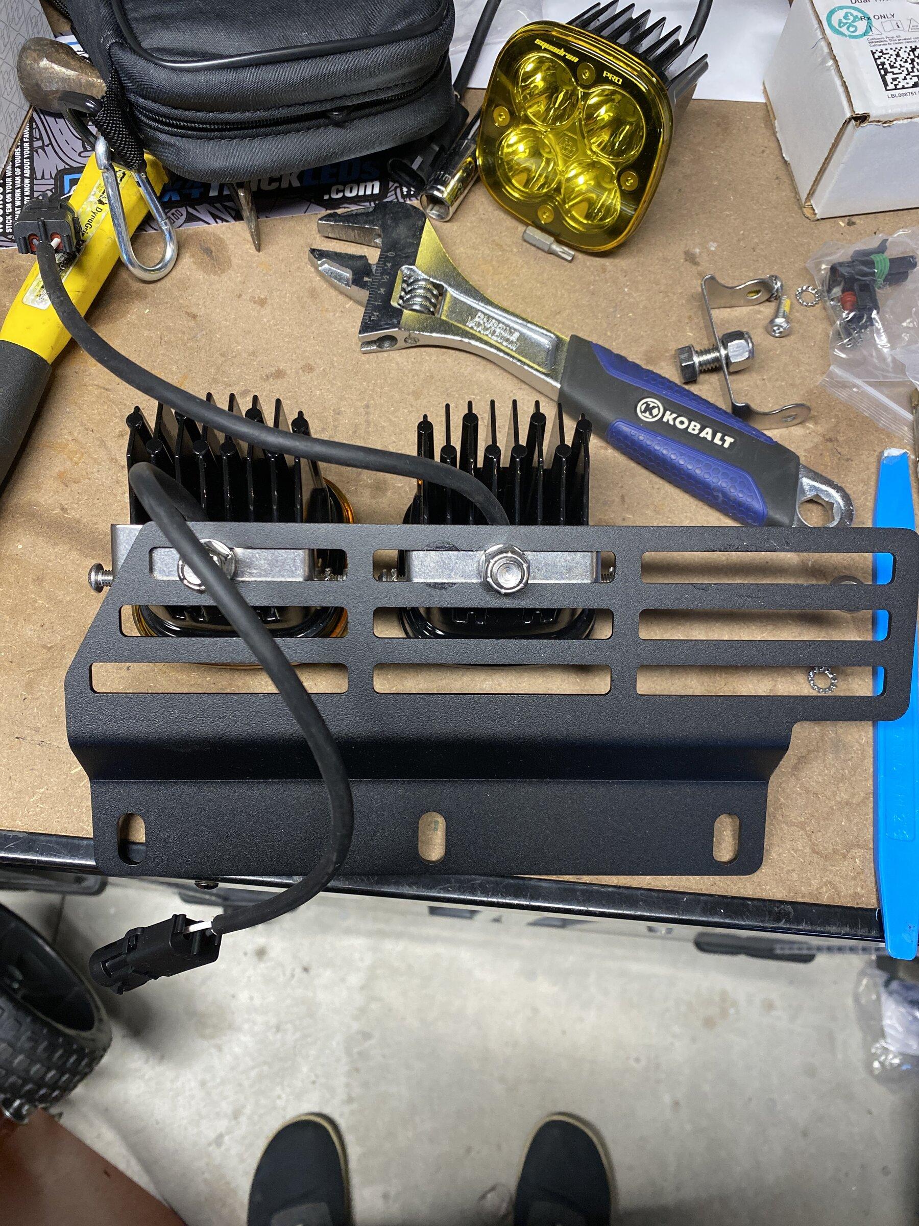

Ford Bronco Baja Design install help needed image
Any recommendations on placement for this type of bracket for the modular from I bumper?

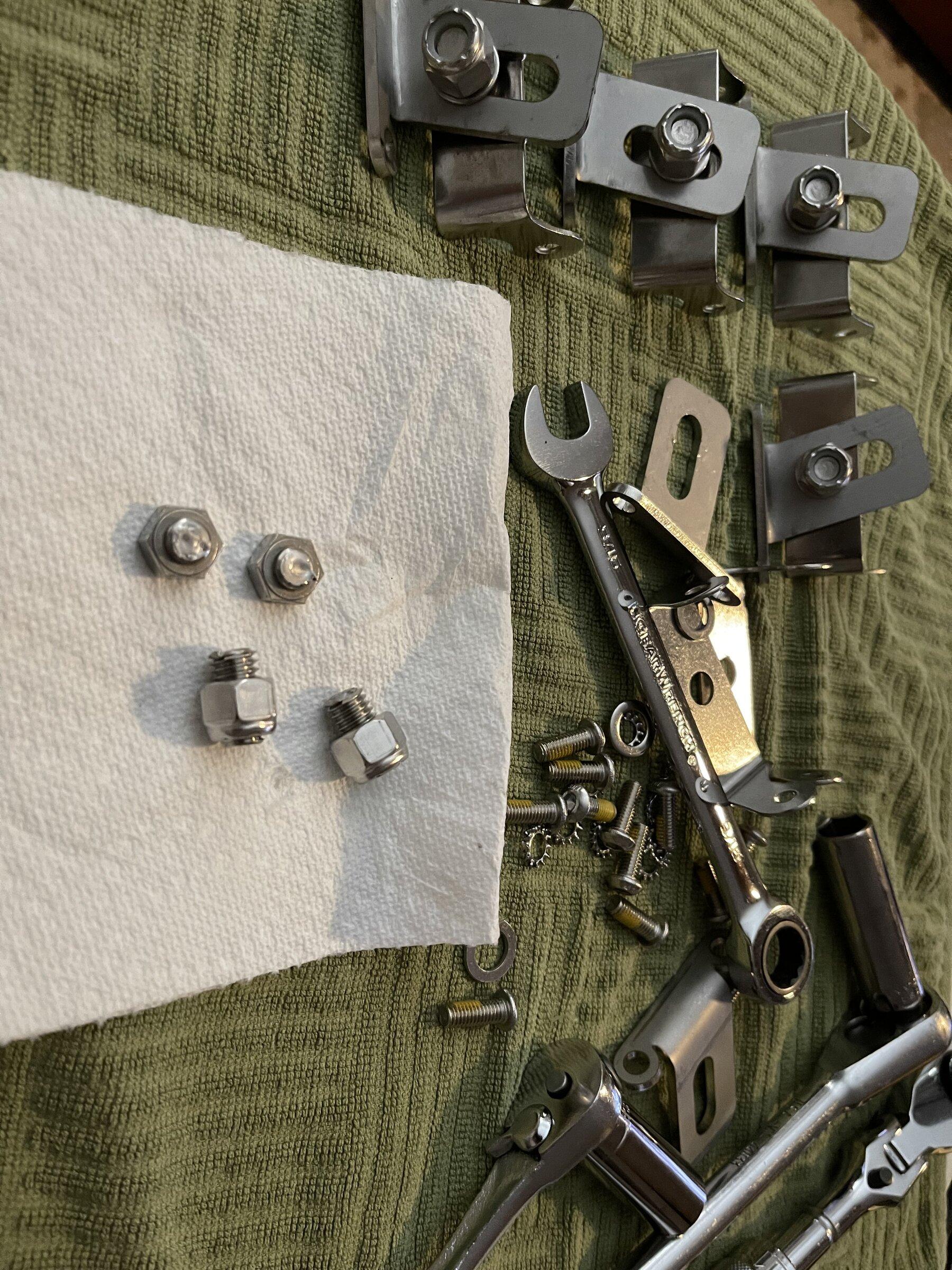

I had two of the six nuts seize, and that was wrench tightening but not snug. I was able to loosen one off after adding oil and had to cut one off. On the one I could undo I saw that the problem was galling. Stainless steel is susceptible to galling and I should have known better.
https://fastenerengineering.com/what-causes-fastener-seizing-and-galling/
It was cold in the garage when I did my install. Adding assembly lube (sewing machine oil) for the remainder of the job fixed the issue. I found the bolts I needed from my bolt bucket (including nylok nuts) and carried on with the job.
Listen to Adam from 4x4TruckLEDs. Adam, I didn’t get any lube with my order from you but no matter - the lights are in and I’m happy with the KR bracket for both the reverse lights and the modular bumper lights.
