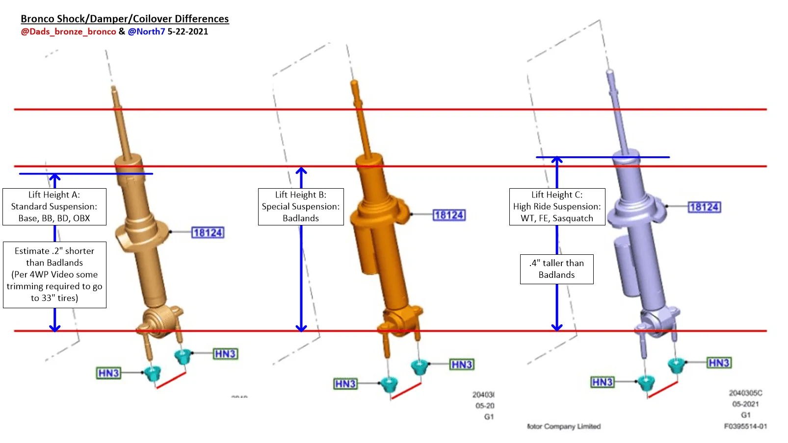

Ok, Thanks for the clarification!
I saw that, but I wasn't quite sure what it was saying or what exactly was determining the ride height on each shock.
Working from @Dads_bronze_bronco drawing and his link to the 4WP video information, here is a new comparison drawing between all models.

The difference in the tire height is less than .85”. Sasquatch runs a wider rim that balloons out more and isn’t as tall. If you were to mount the sas tires on the badlands rims, then you would be talking apples to apples.
I don't think we need to go down the mounted vs unmounted, 8" rim vs 8.5" rim, or laden vs unladen rabbit holes. We can just agree that's it's not quite an inch and move on.
