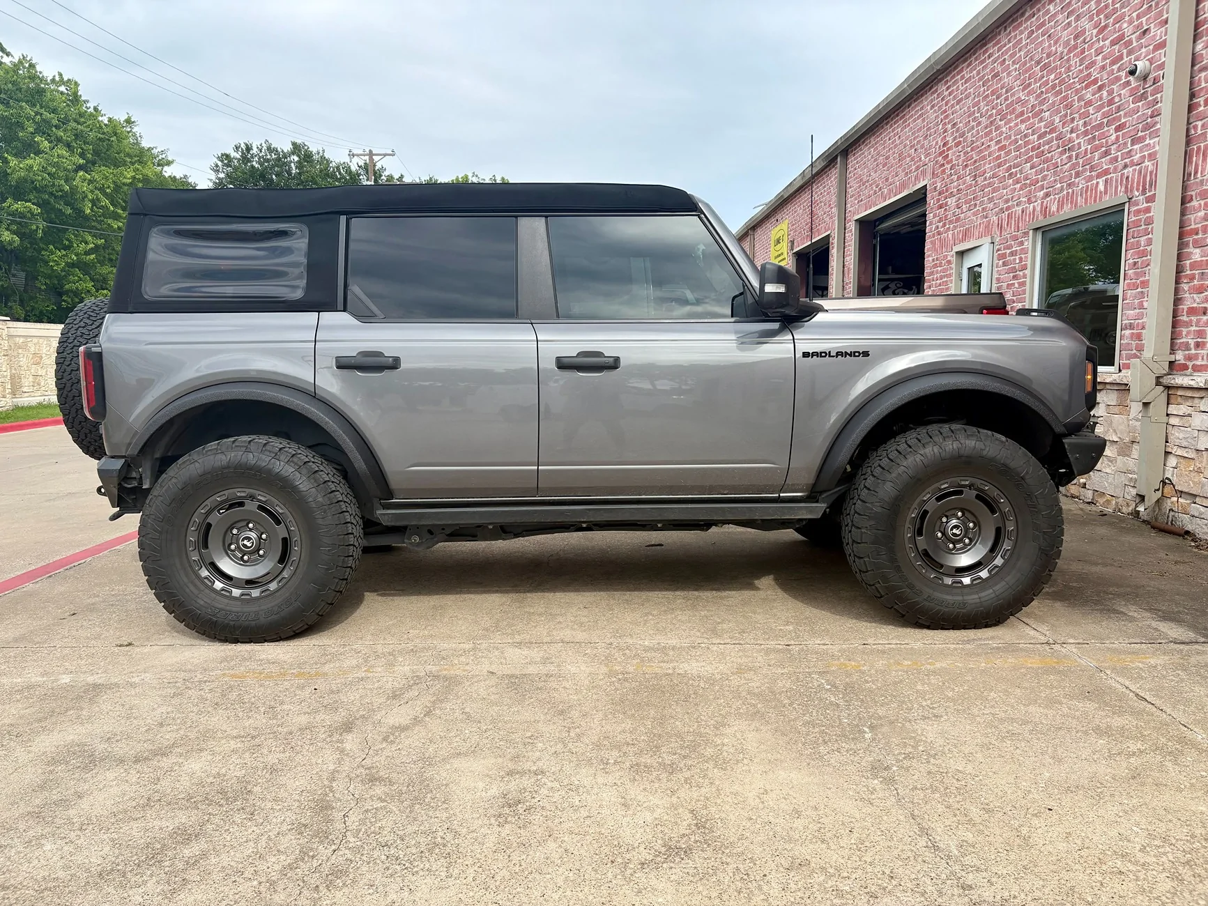

I was once in your shoes asking the same question. Ford made it easy for me: said if I kept the hardtop and Sasquatch package, the order would likely be canceled after a 2+ year wait. Covid supply chain issues and what not.
For the money, I feel like I got the best of everything with Badlands non-SAS.
