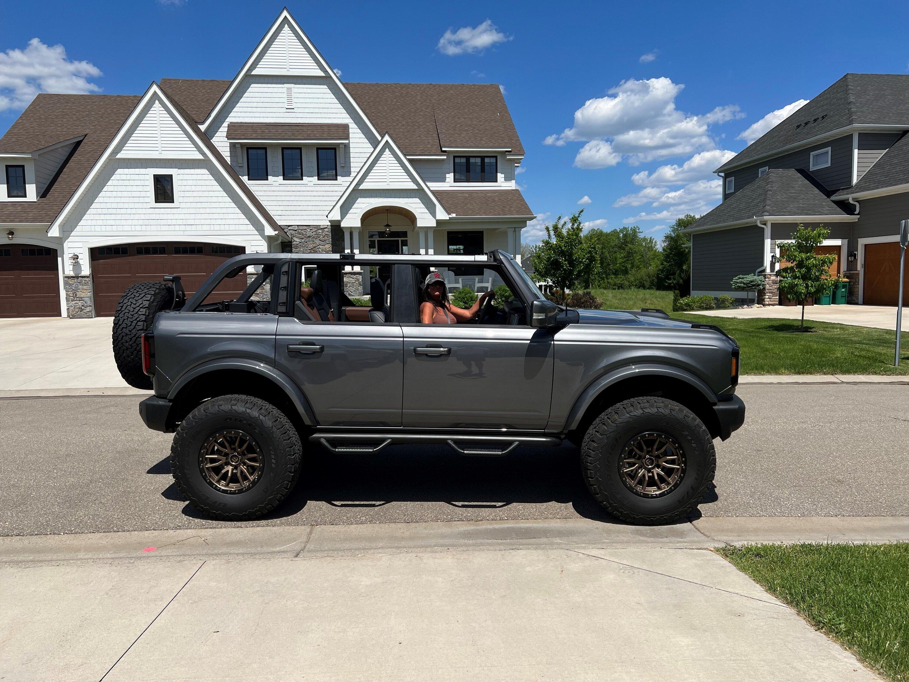

I've got a Non-Sas Outbanks. I have a 3.5 inch Rough Country with 37x12.5. I have Fuel Rebel -12 offset...I think. Yes, my crash bars are removed.
The dealer said I could have used a 2 inch lift and still cleared the 37's. So, you should be good to clear 35's Offset is key...pushes the wheel out so it clears lock to lock.

Yes, I had the dealer install my lift and wheels/tires (and a few other things) before I took delivery. They didn't mention anything about voiding the warranty. I think it's like a "don't ask, don't tell" policy. ;-)
In case you are wondering.....here is pic with the lift.
Ford Bronco Newbie question - What do I do for a lift? Bronco_Side
