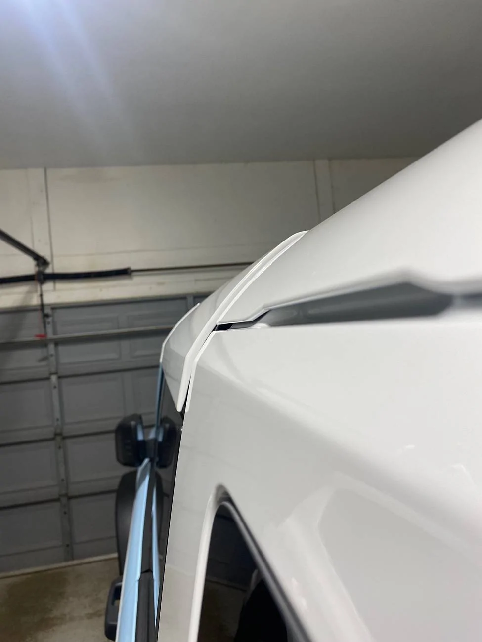

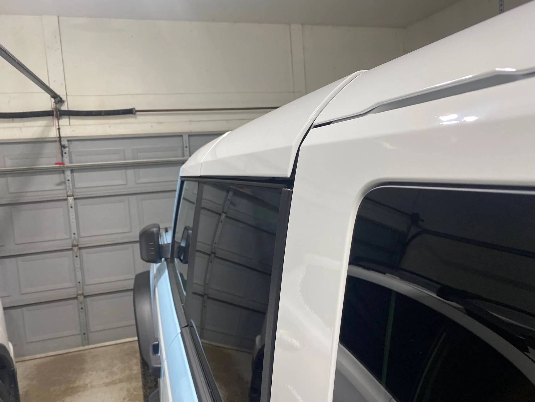

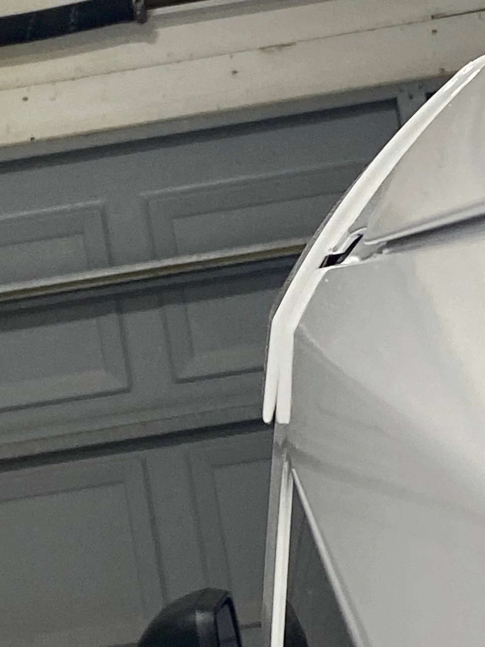

So far I love this Bronco and I almost regret doing an early morning getting-to-know-you scrutiny of my 2 week old HE as I was contemplating accessories. It looked beautiful on the lot, and while I saw minor fitment issues with the trim piece around the taillight then, I definitely didn’t notice this. Note the mid panel fit on the passenger side (dandy) vs drivers side (groan).
I popped the front panels off, and then unlatched, lifted, and relatched the middle panel to see if it shifted to align better. It didn’t. My wife hasn’t noticed and might not ever. I’m on the fence between saying “oh well, f-ck it” and caring enough to see what Ford might do for me. Anyone else get a new roof, MIC or painted with a gap like this?
Is mid panel alignment adjustment possible to split the gap between both sides?

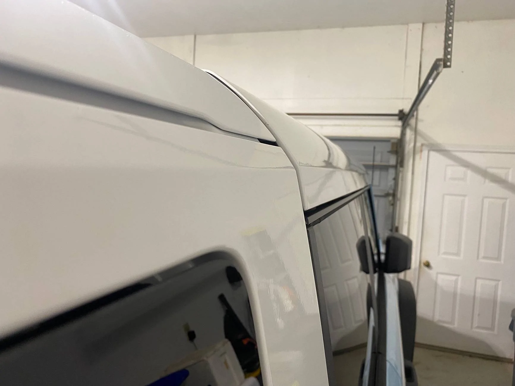

This is mine. It depends on what angle you look at it. Not totally flush, but I see what you are saying in regards to the drivers side. Have you taken it off and repositioned it?

I hadn’t taken the mid panel off before seeing this. Only one short ride with front panels off. After seeing it this morning, I unlatched the mid, lifted it, reseated and relatched it and no difference. Looks like the mounting brackets on the roll cage have peg holes that the top piece sits in so those would have to be adjusted to change alignment.
Edit: it may be this panel has a bit of a flare molded into that isn’t going to be fixed with bracket adjustment (if that’s even doable).

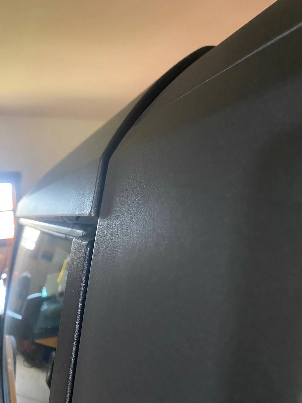

I have a 2 door but the peg holes for my front panels are misaligned and it means I have to angle the panels “just so” to get them off. Especially the driver’s side. There is a way to adjust them but it involves taking the interior trim off and repositioning the metal piece that has the peg holes. Call me crazy but this isn’t something that should need adjustment by the owner. Ford should build their vehicles properly in the first place.

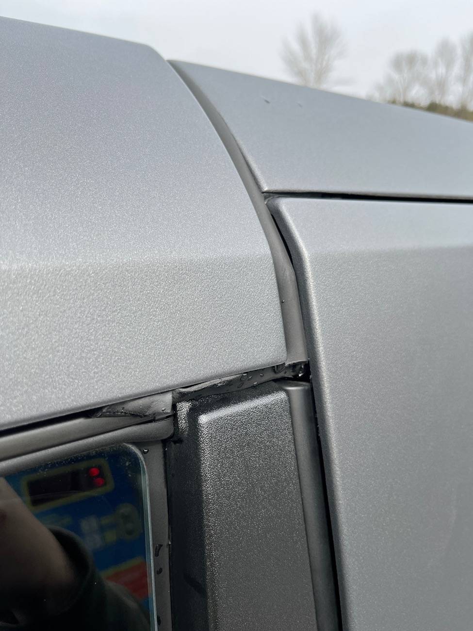

Yeah on mine what I finally realized is the top panel of the rear shell (2 door) is glued on slightly off. I feel your pain. This just shouldn’t be on a new vehicle. It’s completely reasonable to expect them to align. It’s laziness on the manufacturing side. Unfortunately very American in terms of standards in manufacturing. Mine I could actually see daylight from inside because the gasket didn’t cover completely. Loosening the top two bolts will give you some realignment wiggle room. Not a ton but it can help.
