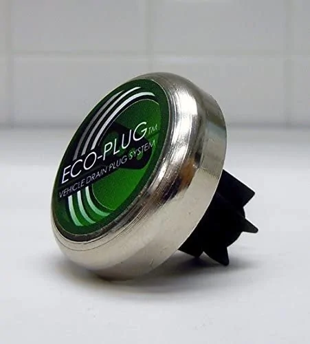

I usually change the oil in all of my vehicles after the warranty expires. One time my daughters Camry was due and I didn't have time so I told her to go to Walmart. Soon after I noticed it was leaking so I checked the plug and it was loose but wouldn't tighten. Those guys had ripped out almost all of the threads on the oil pan. It was just barely grabbing but wouldn't tighten. Of course they denied doing the damage. I thought I was going to have to replace the oil pan or install a helicoil until I found a magnetic drain plug. It worked great! You just twist it in and it seals tight. To remove just use a pair of pliers and twist it out.
