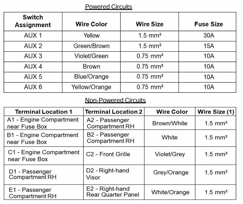

From the Equipment Install Guide.
Everything on the Bronco is metric obviously... but...
  • 1.5 mm2 is roughly 15 AWG
  • 0.75 mm2 is roughly 18 AWG

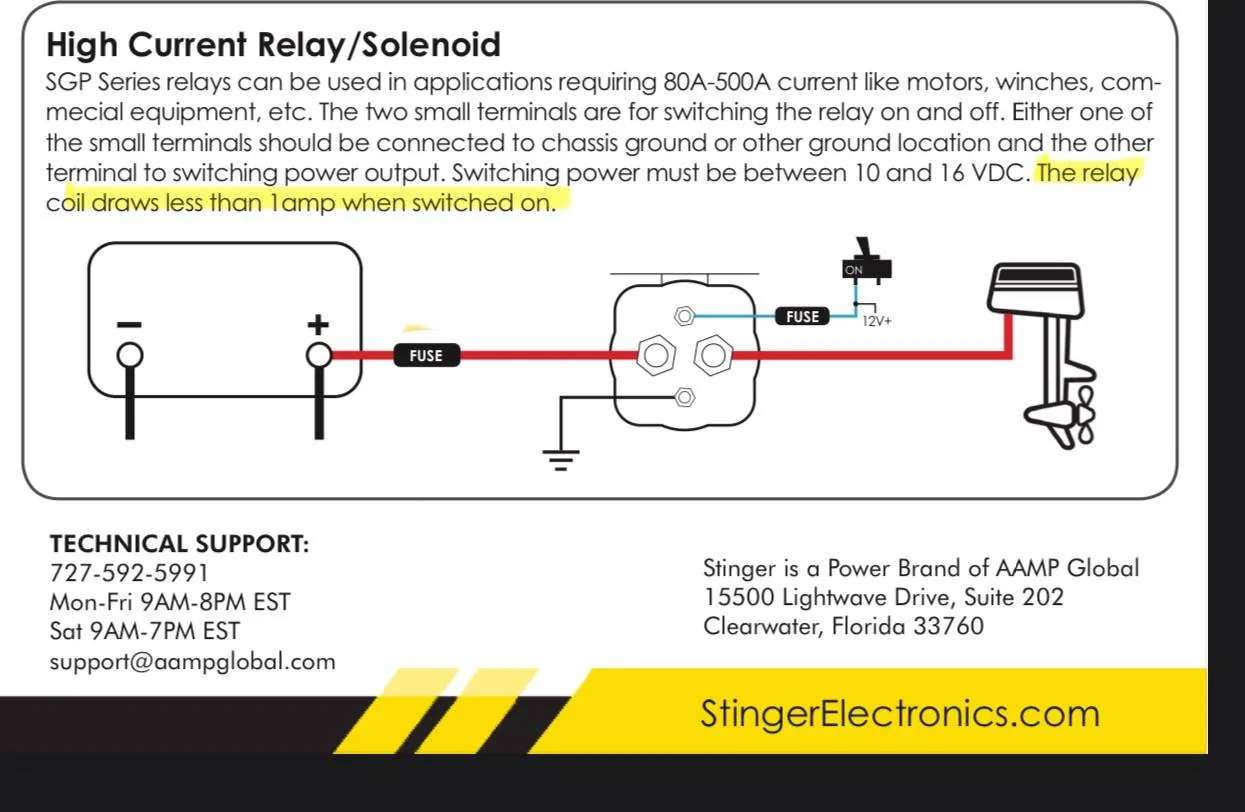

In contrast I am about to wire up my winch and a 500 amp relay so I can kill power to the winch when not in use. The relay will be triggered on/off by an AUX switch. The install instructions are very clear about the amp draw for that device, which is 1 amp or less.
It seems the RC device works in a similar fashion, I just wish RC was more detailed & clear about it.

Perfect, thank you. Weird they used 15 gauge wiring. Not sure I’ve ever seen that.
Yeah it's not actually 15 AWG. It's just metric wiring.
15 AWG is just the closest American Wire Guage size for a 1.5 mm2 metric wire. Although... I guess it's actually somewhere between 15 AWG and 16 AWG.
  • 15 AWG = 1.6502 mm2
  • 16 AWG = 1.3087 mm2
