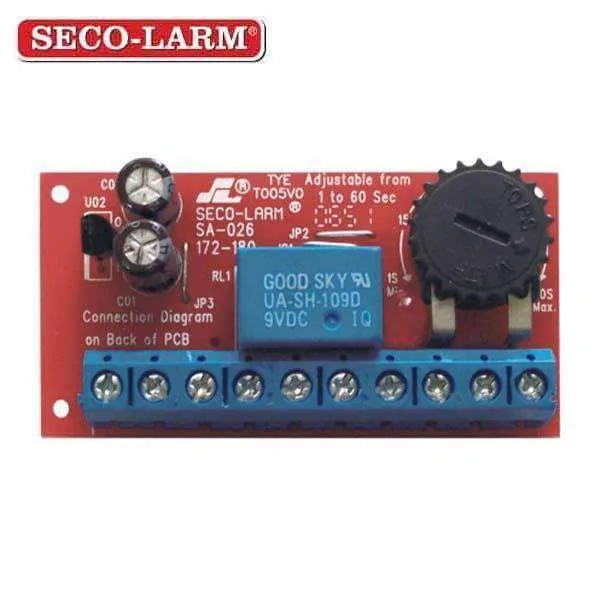

Okay I am wildly out of practice when it comes to wiring (and have virtually no experience adding that into the automotive realm). It occurs to me that some of the things people have thought about hooking up use some sort of momentary switch (horn, garage door opener), but that these aux switches are latching (and powered).
Could something like this be used to enable an aux switch to function as a momentary switch for these kinds of devices?
https://www.uhs-hardware.com/produc...module-w-relay-output?variant=31395707060291/

and this is why I asked what you meant. If you can't answer it then just just don't reply. No one needs the Philosophical BS
I think we all need the philosophical BS, as it is one of the several things that separates man from beast. Cogito, ergo sum.
To answer your question, yes.
This device requires a momentary contact input, so at a quick glance the auxiliary switches can’t be used directly to trigger it, otherwise it may continually activate if the auxiliary switch is left set on. You’d have to flick the switch on and then off (a manual momentary switch function) for this device to work properly.
