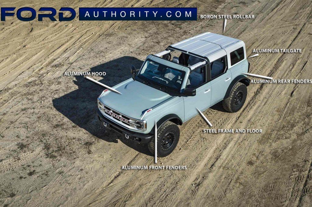

The hood and all body panels are aluminum. sooooo.
You'll save a bundle by only needing to do the frame and doors.
2021-Ford-Bronco-Exterior-Panel-Materials-All-Labels-Front-Three-Quarters-1024x682.jpeg
Looking more to mitigate galvanic reaction between the aluminum body parts where steel floor/frame connection points occur. But being over cautious with preventative measures I might consider full coat due to oxidative conditions being a real potential.
