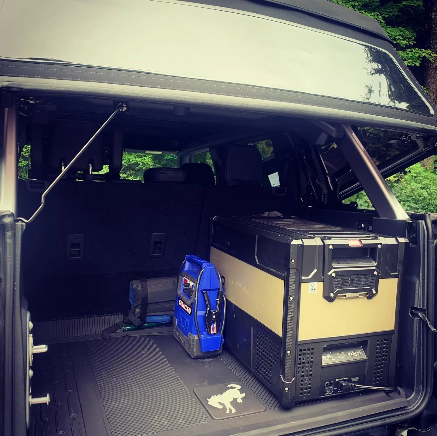

You've seen a 63 or 73 fit the same orientation as your 47 (handle towards the rear)? I'd like to see one in the back of a Bronco with back door closed before dropping $1500.
It will be close. Especially with the flat 12v plug - it should JUST make it.
Ford Bronco ARB Zero Series Fridge Freezers 5B26F655-EBDF-4C46-93C7-842F4CCCDA67
I have the cargo cover - which you lose roughly 3/4” in the back from the sidewall.
Ford Bronco ARB Zero Series Fridge Freezers 74436DFC-2789-4295-8DBD-67EBC71ED823
I know it's snug, Can you measure up higher (20in or so) because the back seat slopes. Plus to the inside of the back door. Thanks!
Even with the backseat fully reclined - it doesn’t sit further back than that lip/edge on the cargo cover which is as far back as you will be able to get the fridge and have it level. Door closing has at least 31”.
