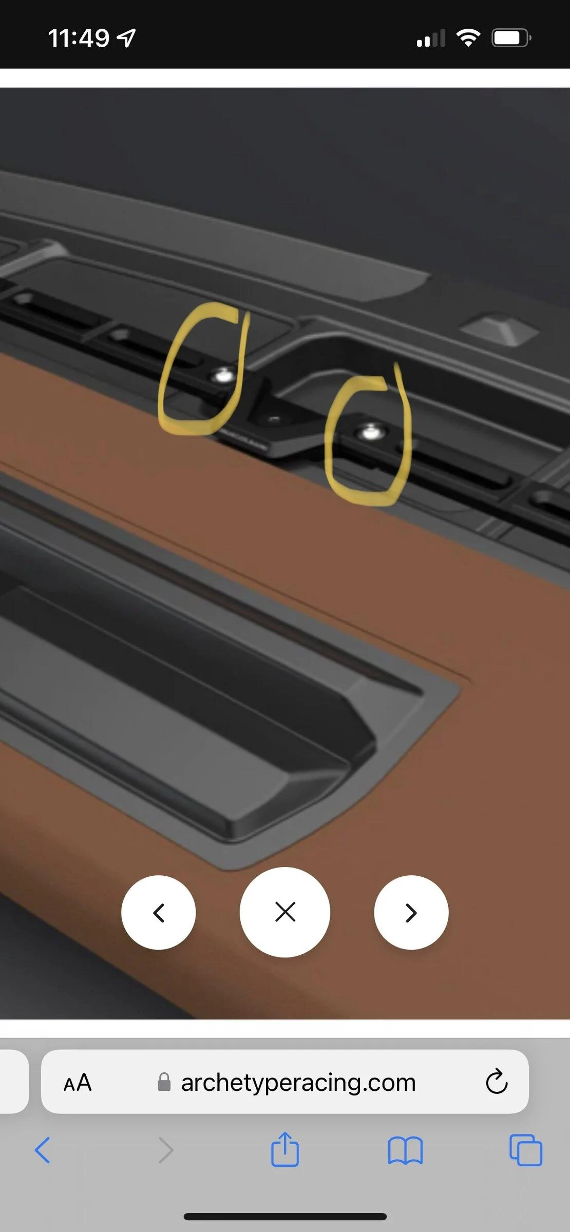

So here’s my question @EIGHTLUG…with the bam rail, do the two additional mounting locations line up where the BAM pieces meet? So technically we could get a couple longer screws at those points and beef up our BAM rails? Spots are pointed out in attached photo…

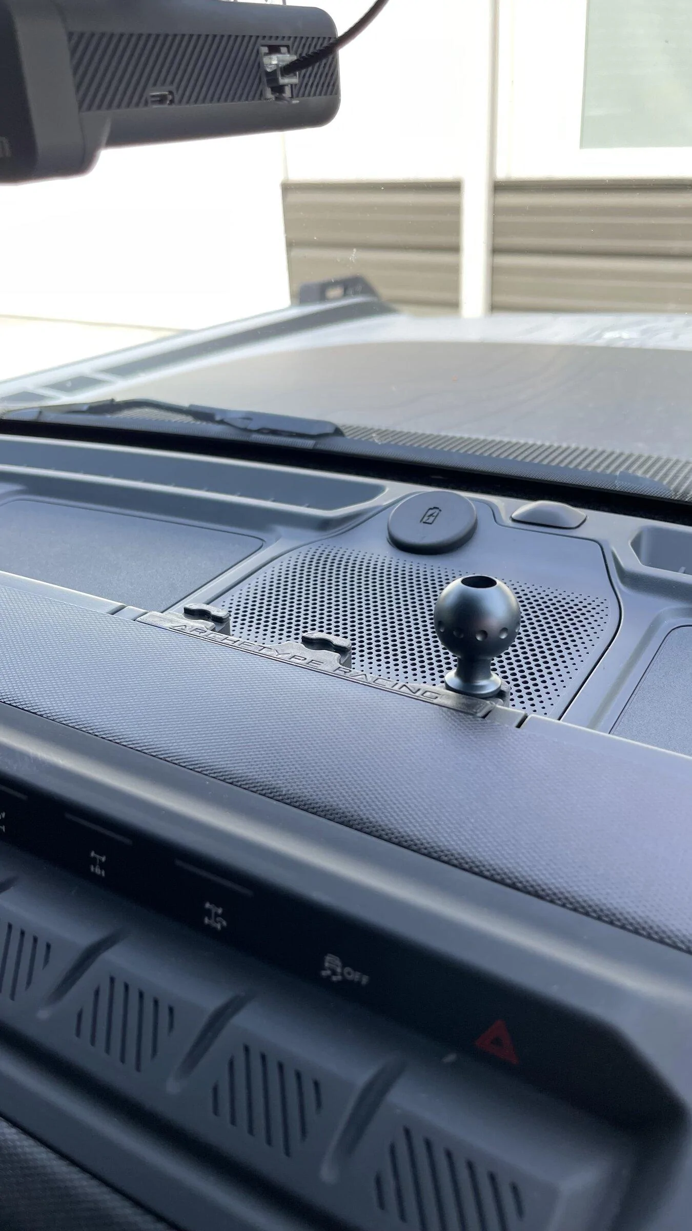

Prototype is installed and looking great. I still want to make a couple tweaks before I crank out the billet parts.
That looks gooooood.
