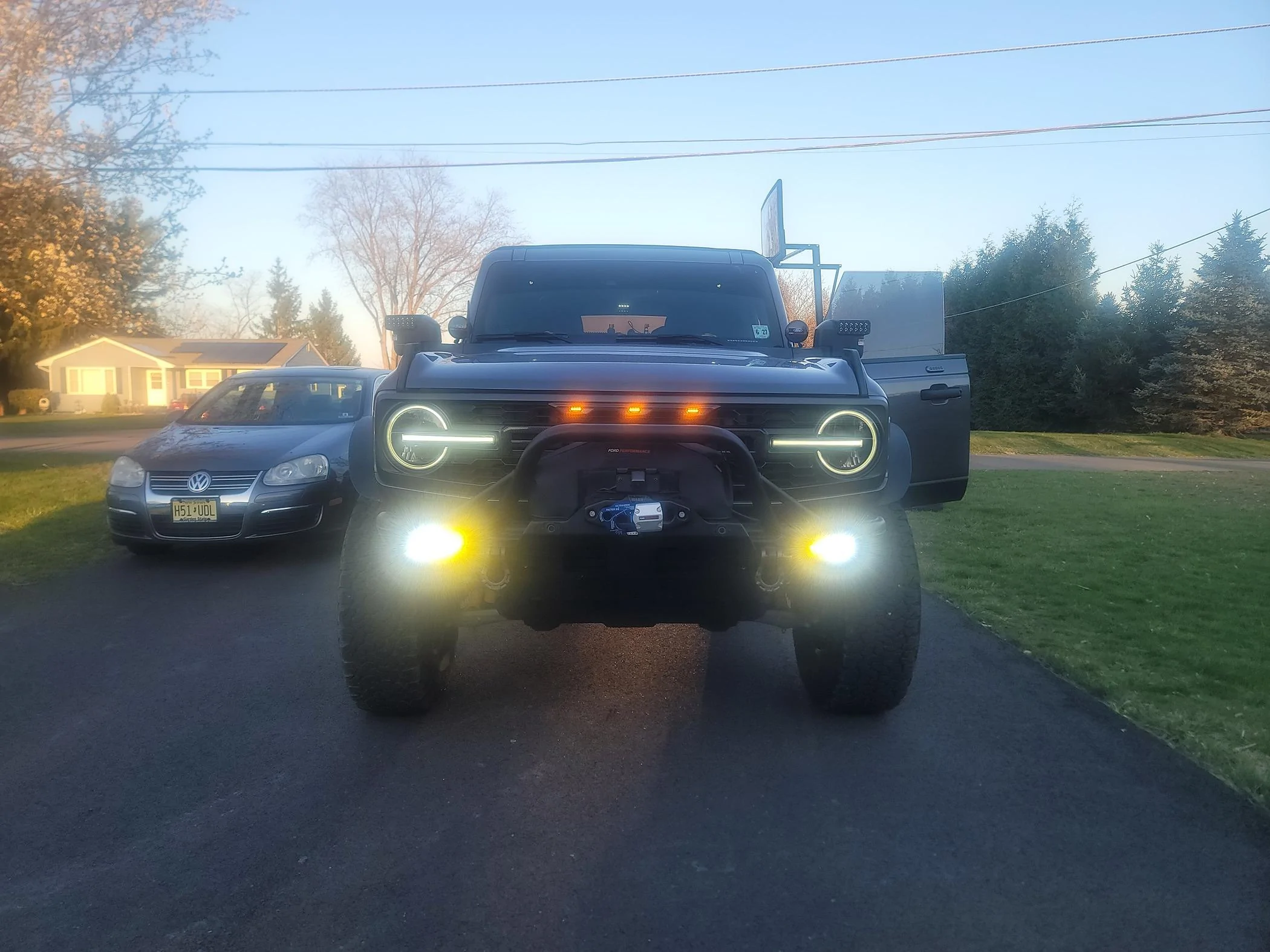

I really do like the quality and the look of the bumper. Getting the wiring and all of the park sensors situated was a little difficult but doable. Overall the install was quite easy, Just need 2-3 people to lift it as the winch and everything needs to be assembled on the bumper before you install it. I also used the TD frame horn reinforcements when I installed it as I plan on being able to use my winch.
Every works as it should. Park sensors, ACC, everything. Since I purchased my bumper from a fellow forum member here it was missing the light brackets for it. I made my own bracket and put two 3" lights.
how do you like the quality of this bumper?
curious to know how difficult was the installation?
camera, parking sensors, cruise control all functional?
appreciate the feedback.

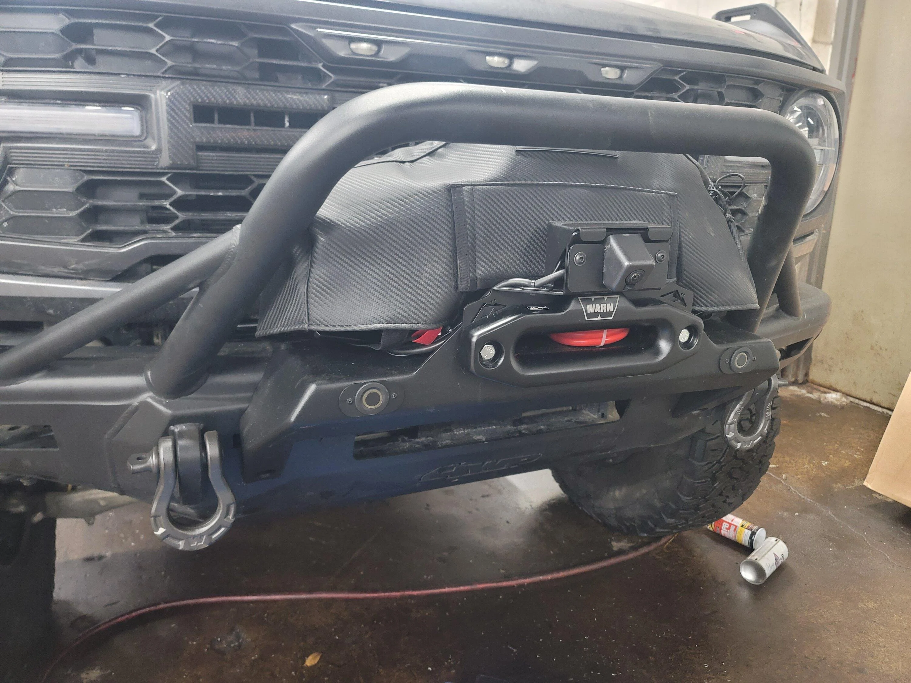

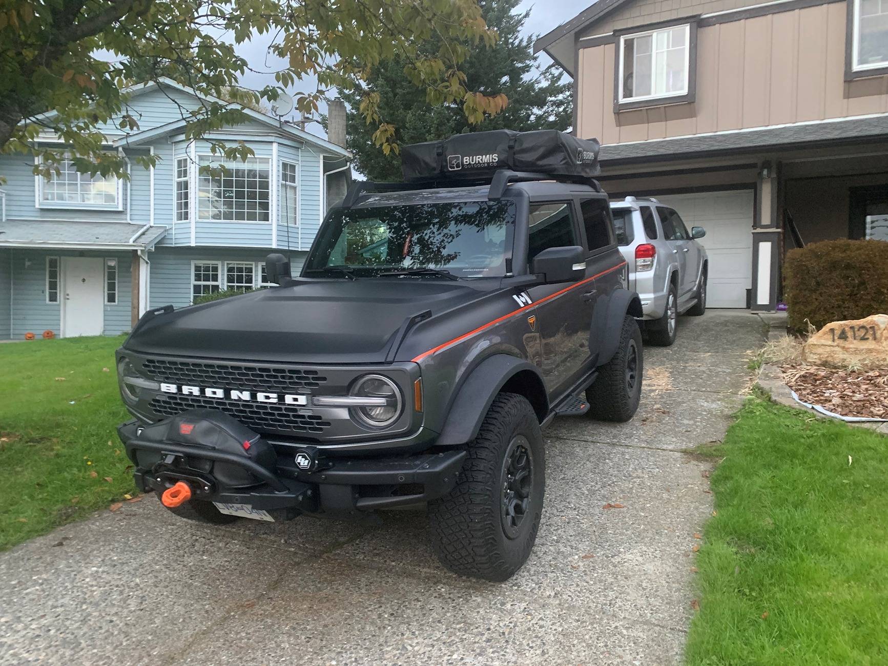

I used mountains to metal relocate with 4wp front bumper. Everything works perfect.
Just completed my installation. Be advised the optional cover isn’t compatible with the Ford Performance mount. Not enough clearance from the bull bar

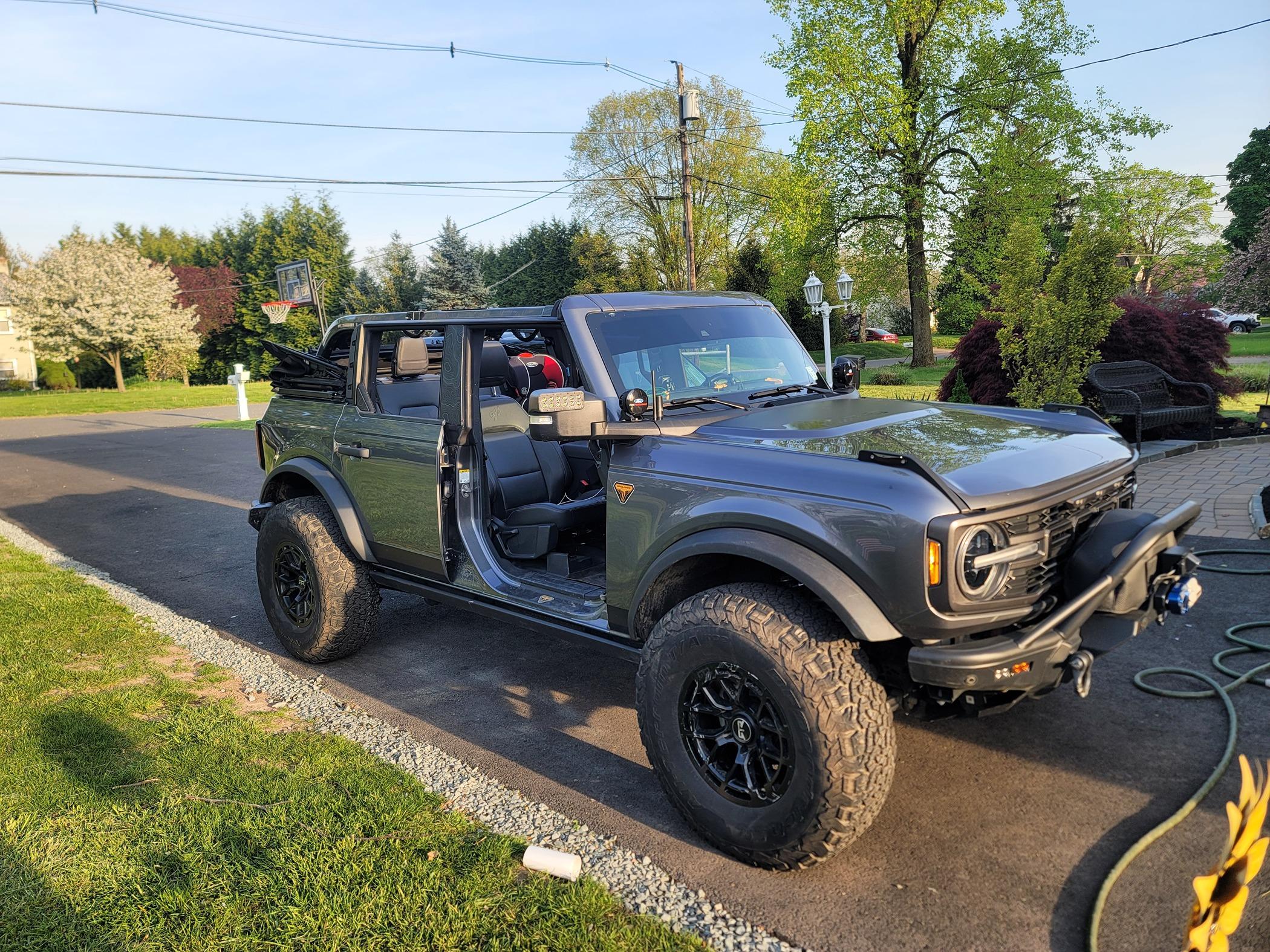

Yup...
