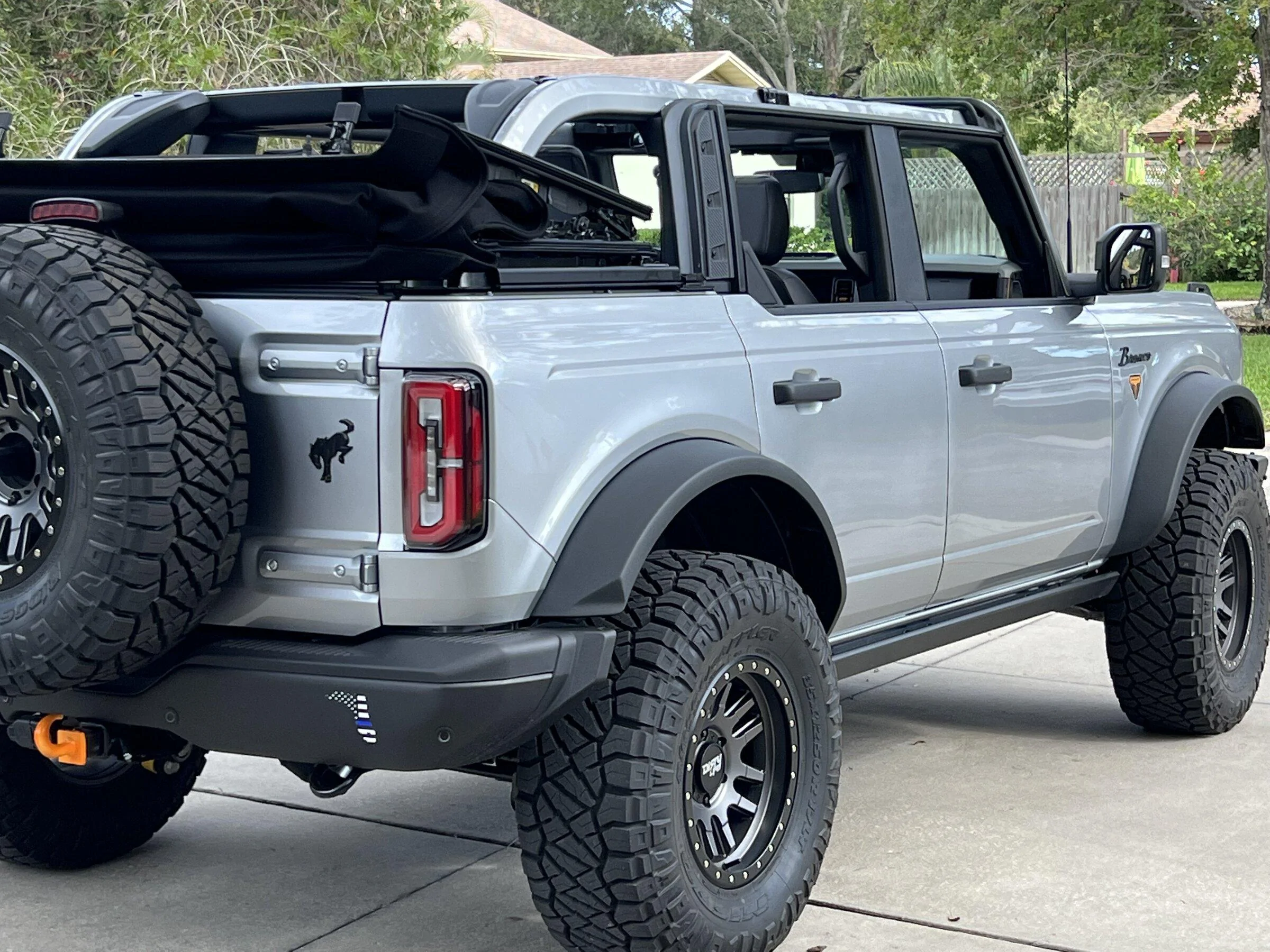

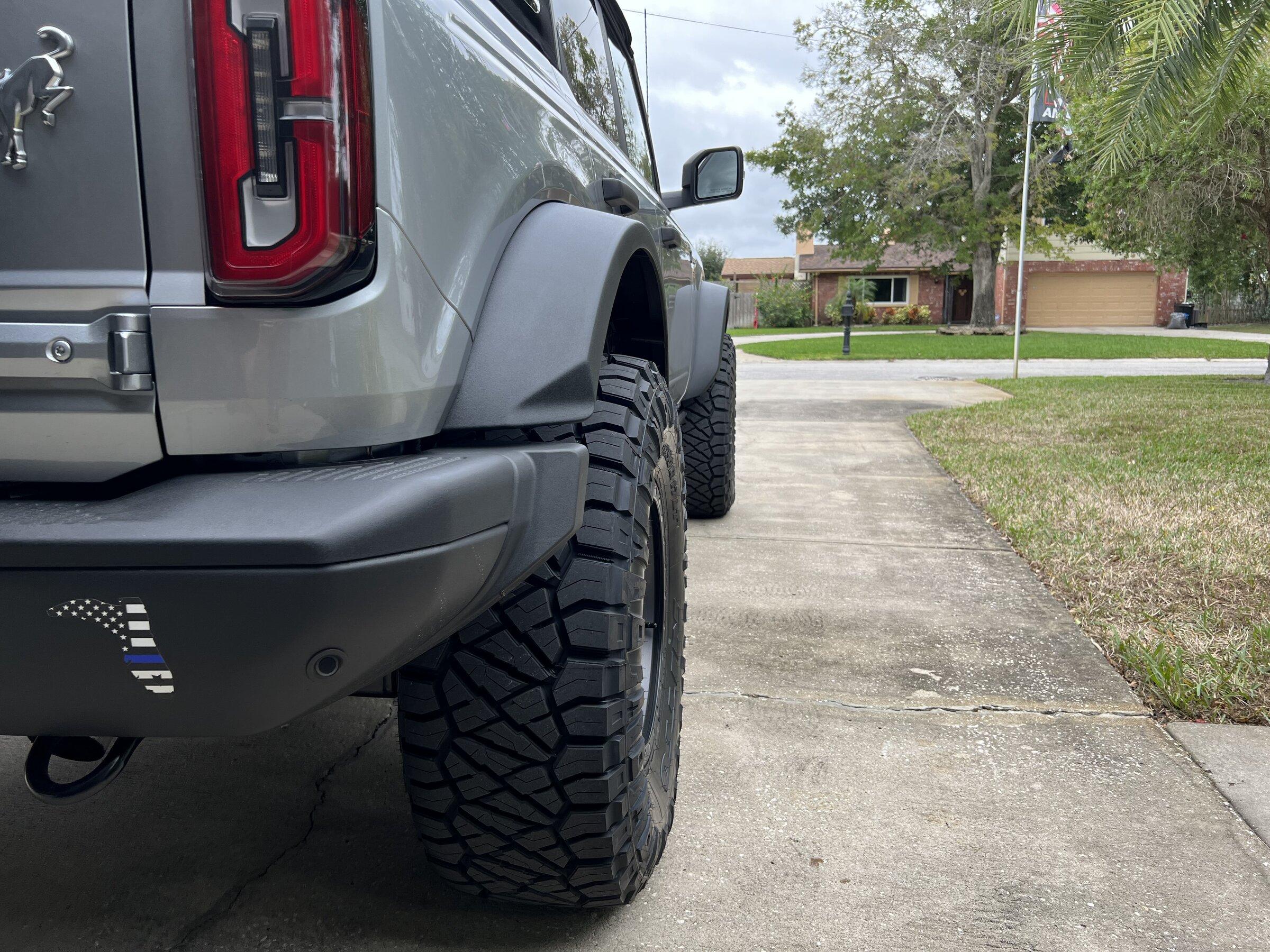

The Wheels and Tires are 17x9 Dirty Life Canyon Gray Wheels 35" Nitto AT Tires 6x5.5 2021 Ford Bronco off Ebay seller: auto-addicts
(I specified12.50X35R17) the ones they advertise have 315/70R17 the wheels are 0 offset 5" backspace they sent them with the Tire pressure sensors, that were already programmed for my Bronco, I literally Bolted them on Torqued to 100 ft. lbs. and done they were truck shipped on a pallet that was carefully set up and shrink wrapped including 27-splinned lug nuts and socket to mount all wheels including the spare I got them in 3 Days after order Date Very Satisfied with the entire experience as far as the 1-1/2" level kit I had it installed at 4wheelparts.com ($638.45)including a 4 wheel alignment and on a level surface it is dead-on level! and the shackles (D-rings) are from Harbor Freight and the say Badland on them APEX 3/4 in. D-Ring Shackle (harborfreight.com) I painted them orange to match also I bought: 10,000 lb. Capacity 3 in. x 30 ft. Recovery Snatch Strap (harborfreight.com) and a: Receiver Tow Hook (harborfreight.com) as well.
That stance looks perfect. It’s interesting that 4WP did the install. I went to local shop in Austin, TX and they said there isn’t currently a kit for the SAS that 4WP had approved to install? Ford dealer quoted me $500 to have the 1” Zone installed, so considering that.
