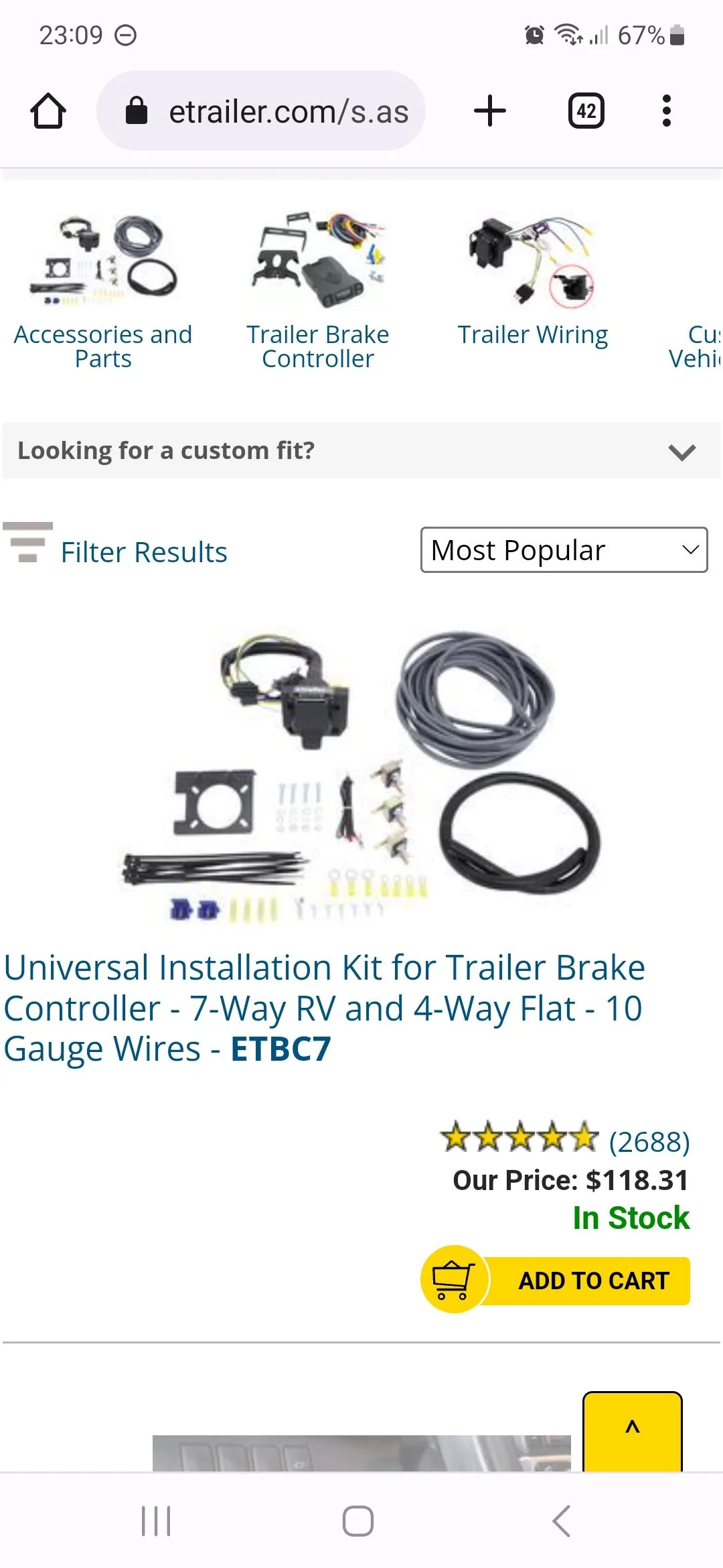

I have the curt 4-pin and I ordered this to get 7-pin. Based on others in the forum it's pretty much the easiest way if you're adding a brake controller or not. I'm not ordering a brake controller until I find a Camper the boss lady and I agree on.
