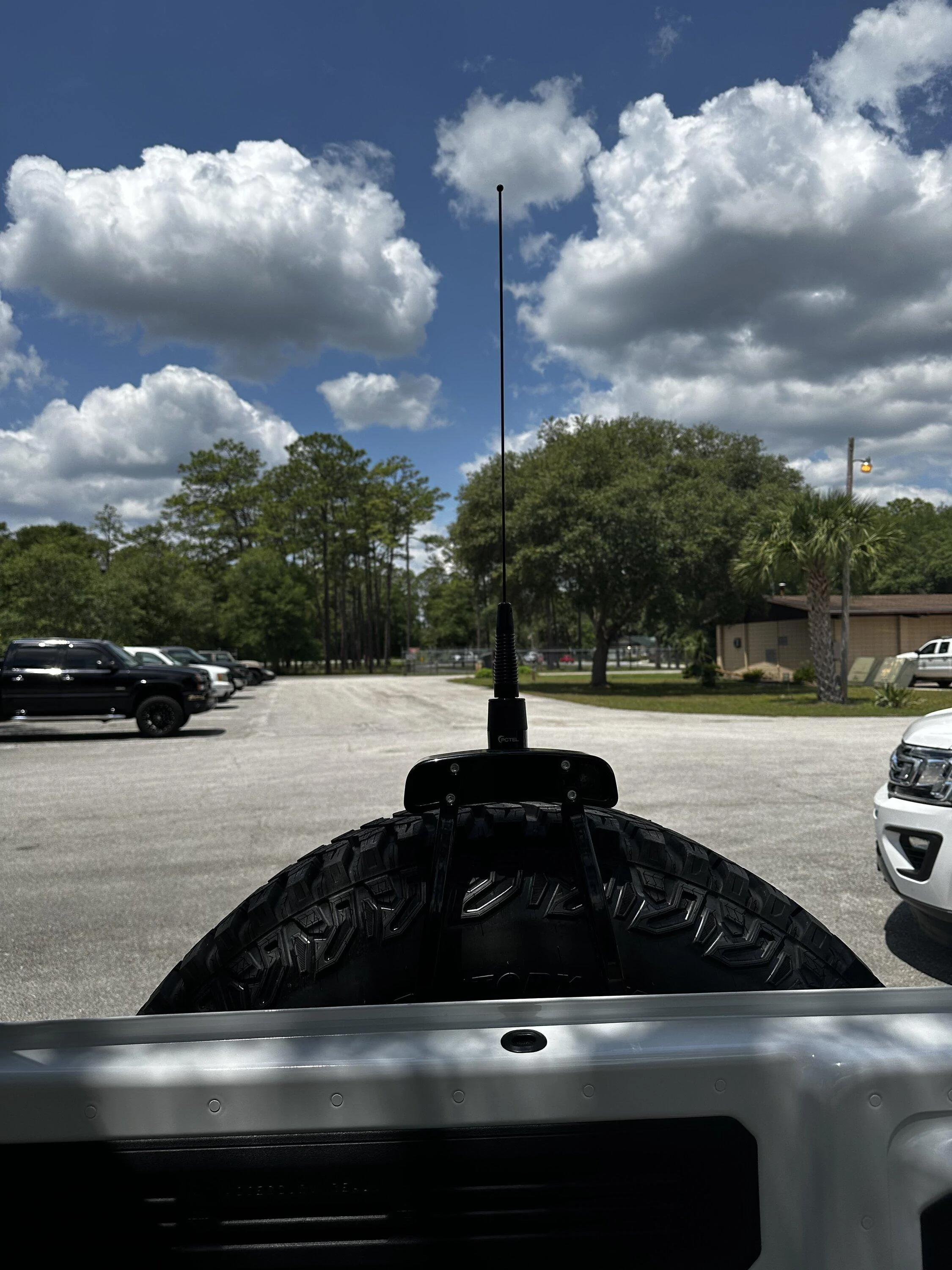

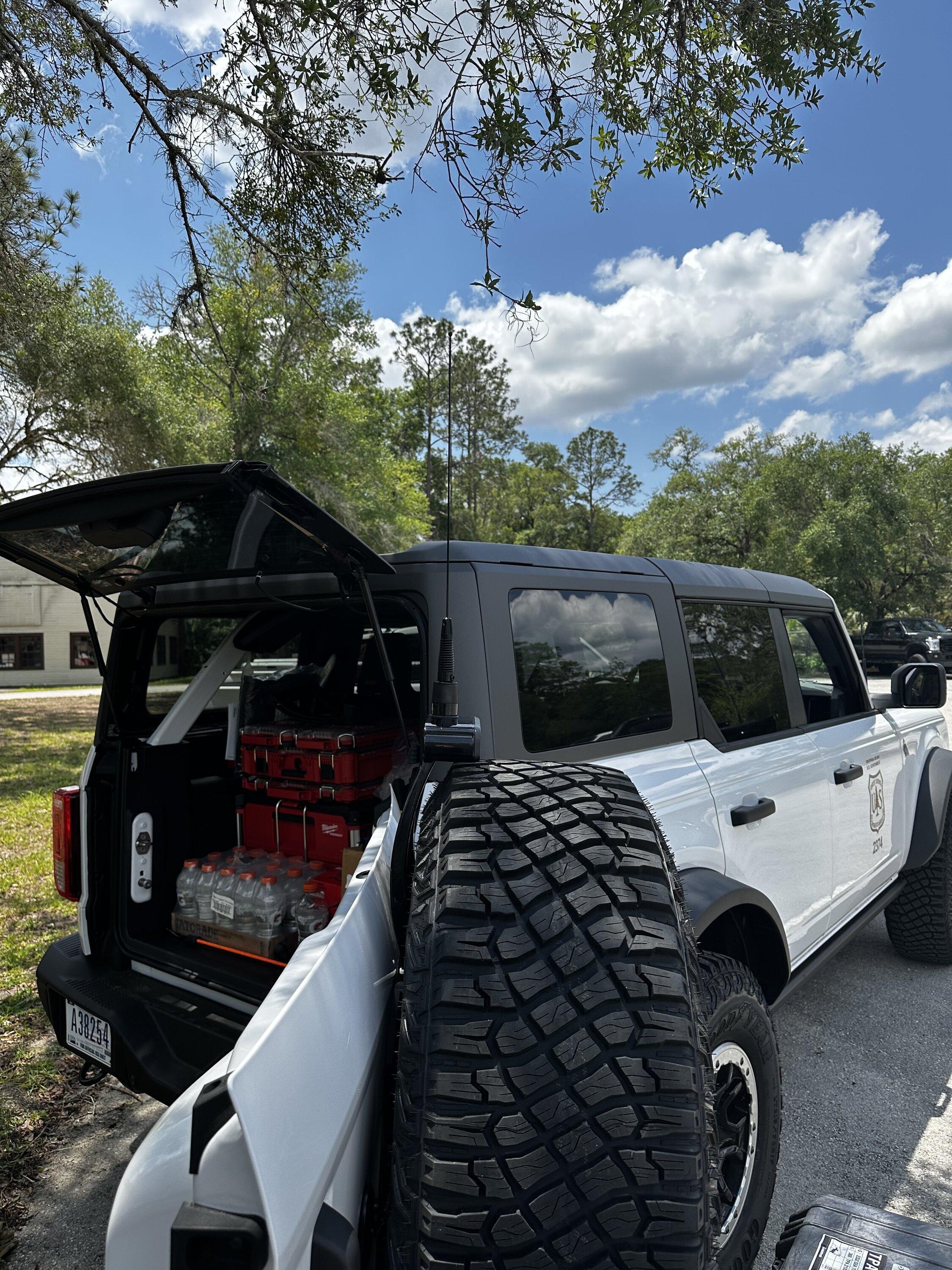

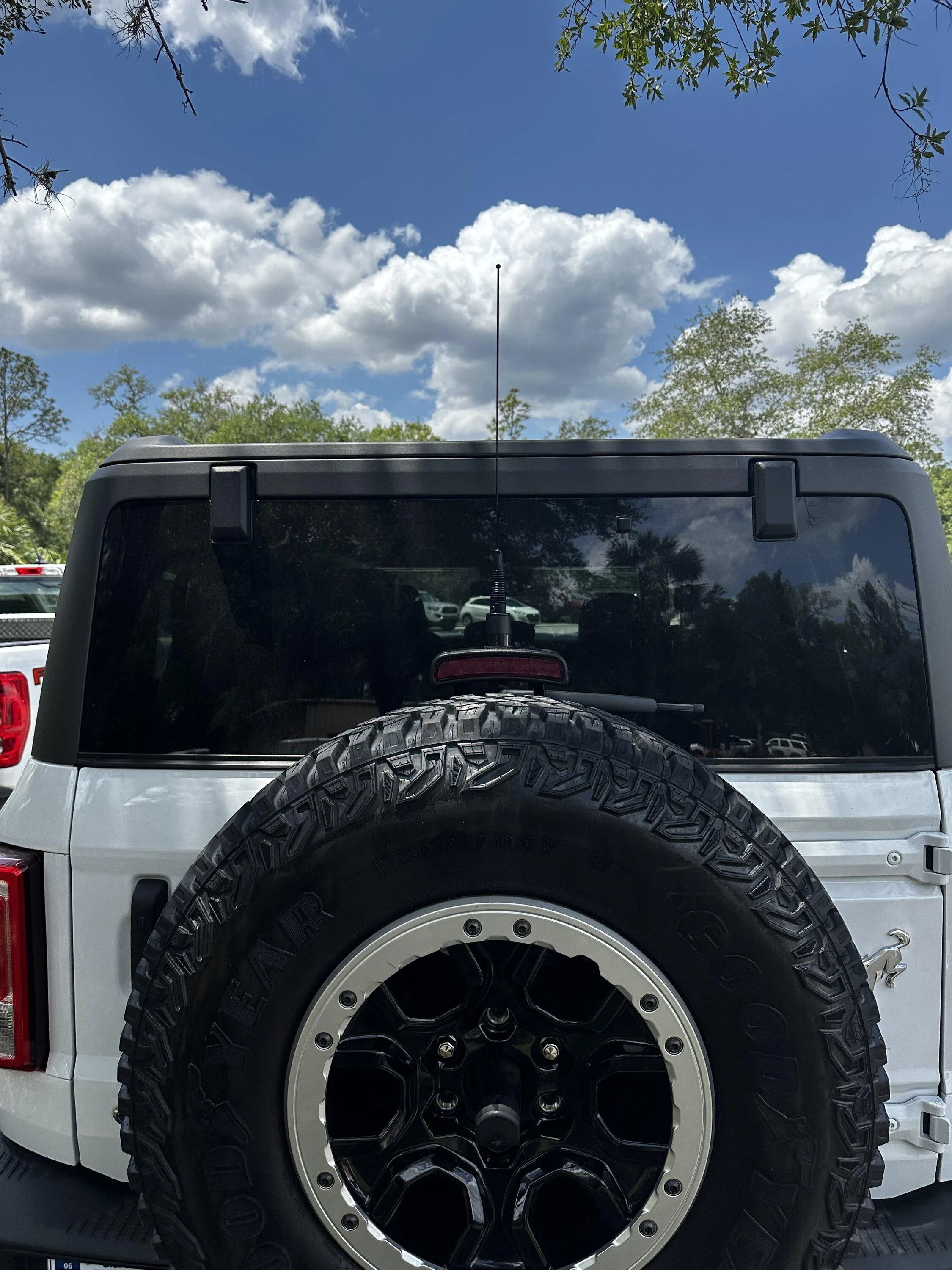

Hey all. I found a slick antenna mount for those looking. Just got it installed on my work rig today. It’s a 3rd break light replacement. It’s pricey but I do comm for a living so I needed something that will hold up. Here’s some pics.
Check out bulletproof diesel. Google Third Brake Light Antenna Mount - 2021-2023 Ford Bronco With 35" Tire

I didn’t say it was cheap! Lol. This is my work rig and I do land mobile radio for a living. That price is cheap compared to my radio. It would cost someone about $3500 to get the same setup I use. Not counting installation but I do that myself.

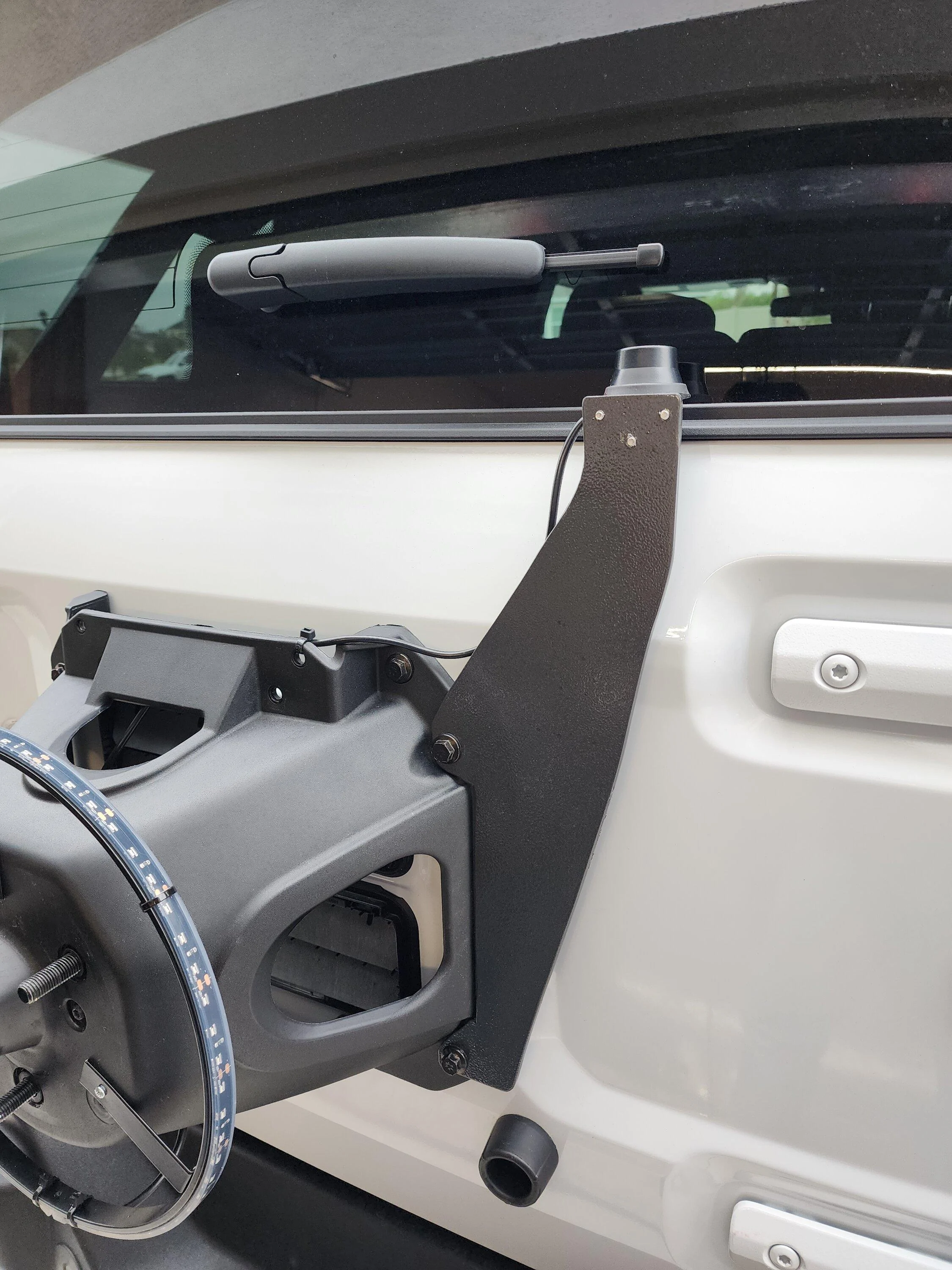

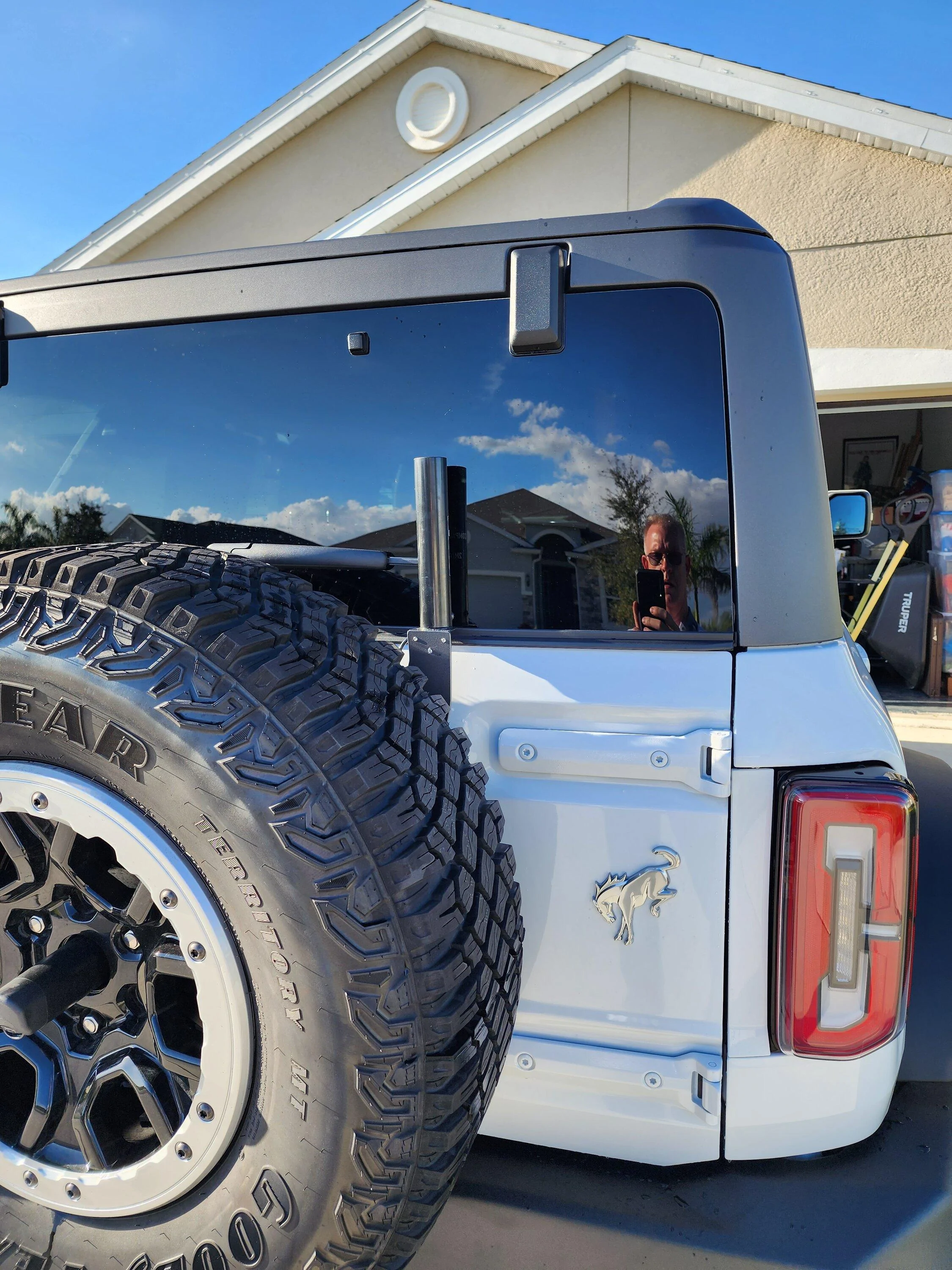

I fabbed up a mount from 3/16" aluminum plate and an NMO mount. It worked out great and the magnetic can antenna works great on both 2m and 70cm bands. I also keep my Comet CA2X4SR
Ford Bronco Antenna Mount by Bulletproof Diesel 2023-01-21 16.57.54
Ford Bronco Antenna Mount by Bulletproof Diesel 2023-01-30 16.22.21
in the back in case I need a little more gain to reach out when I'm in the "back country"
