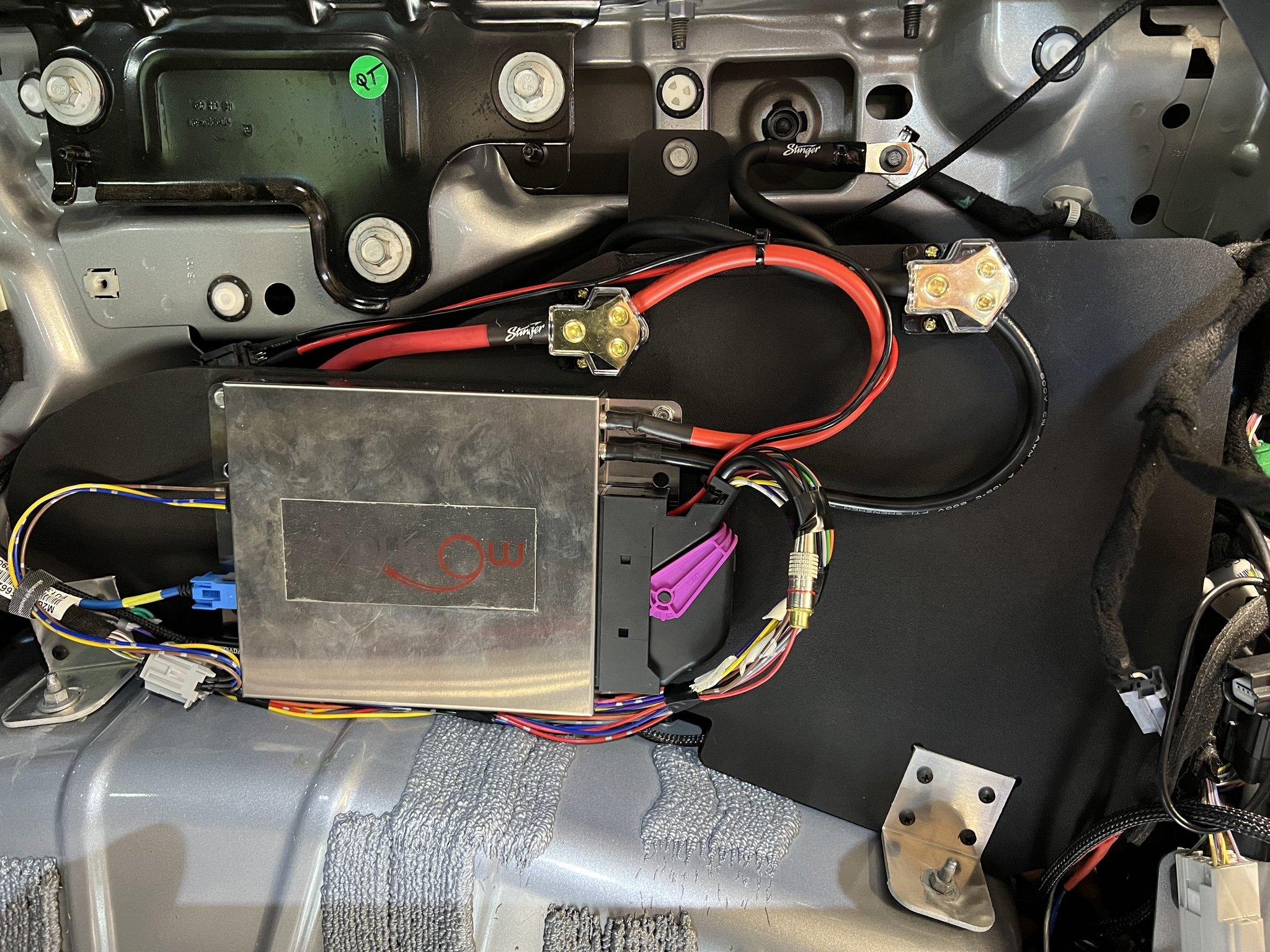

Here’s a pic of the amp in the subwoofer area…. Let me know if there are other pics you are interested in checking out…

@mObridge will the amp fit into the same location as the factory B&O? I'm looking at the Gearshade 8" box to replace the B&O sub. Would the Mobridge fit in as well?
https://www.gearshade.com/product/bronco-subwoofer-square/
I’m really leaning towards adding this and the JL stealth box in my 2 door OBX
It will mount on the factory subwoofer Box with our mounting bracket that comes in the kit in the 4 door. However if you have the 2 door it will not.
I would say it would likely fit on that box
