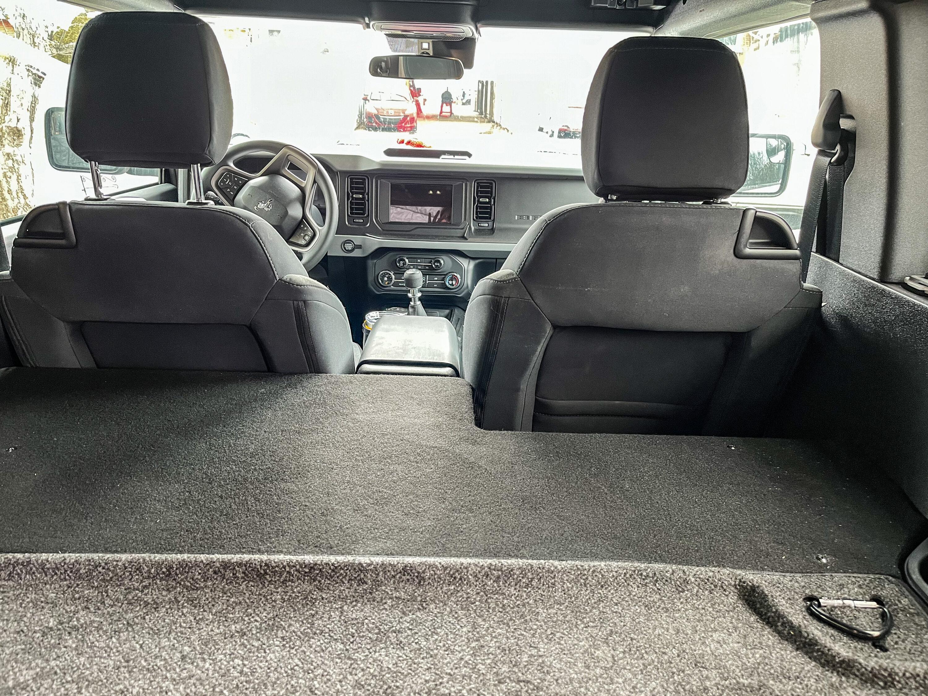

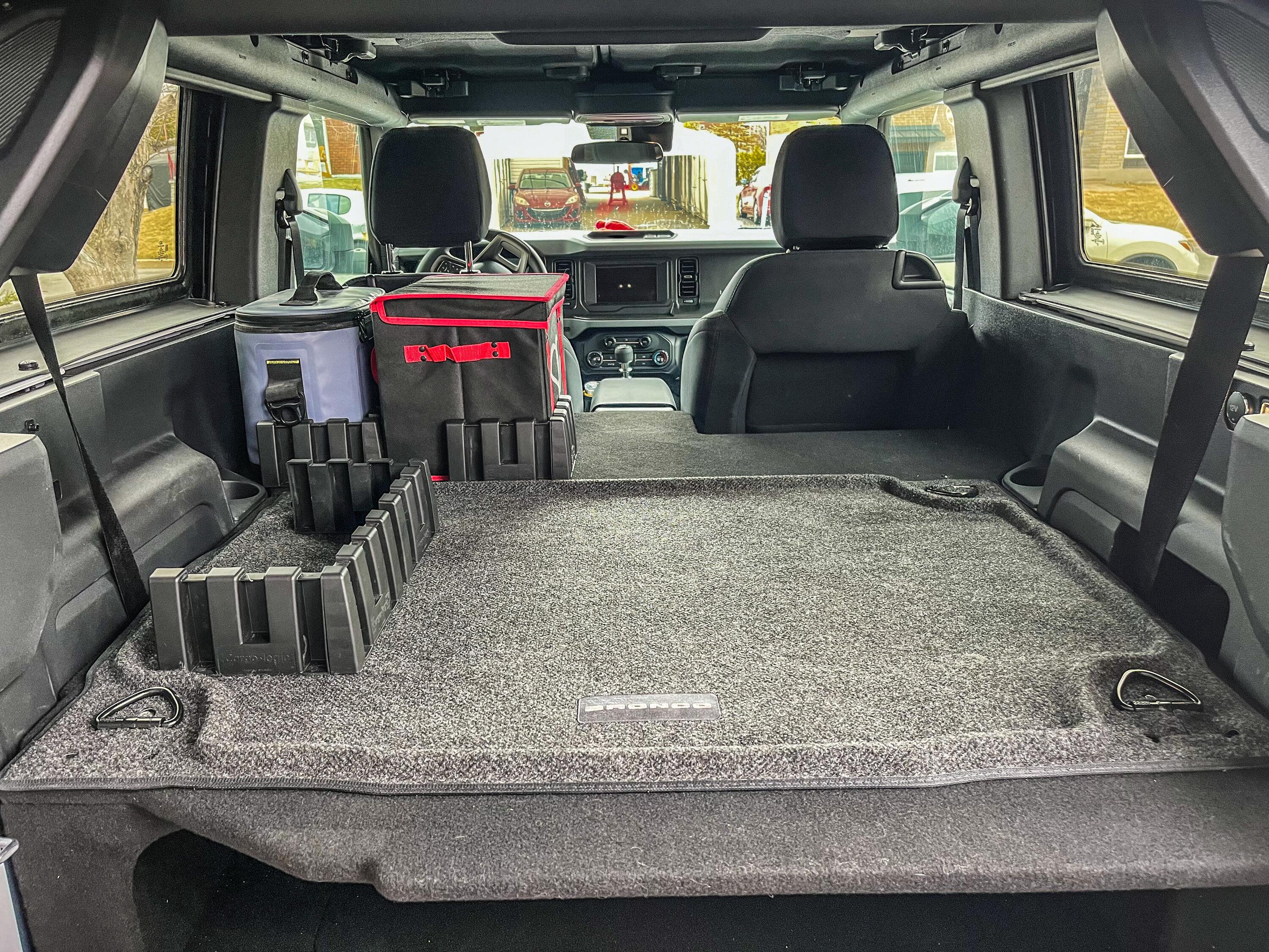

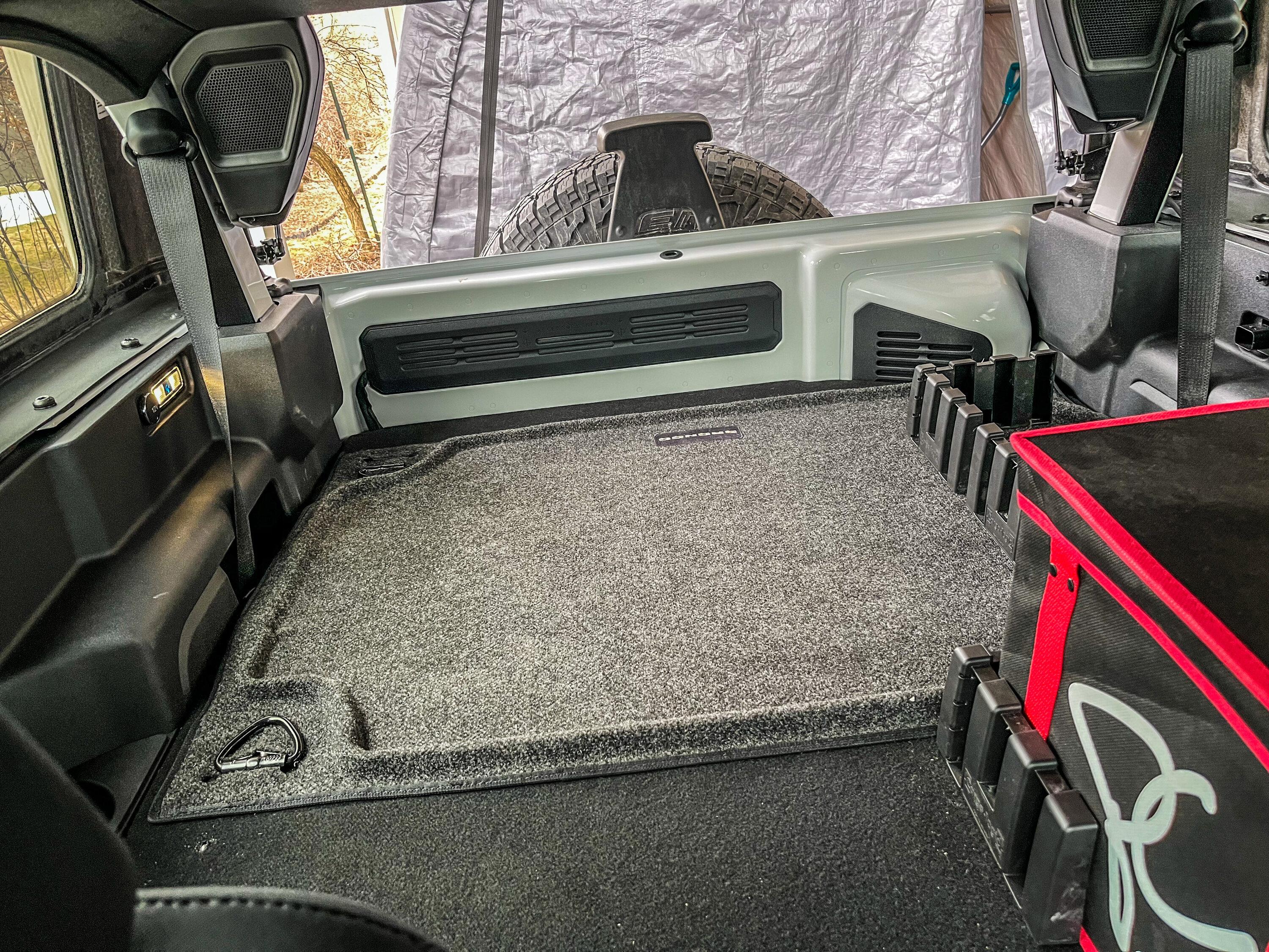

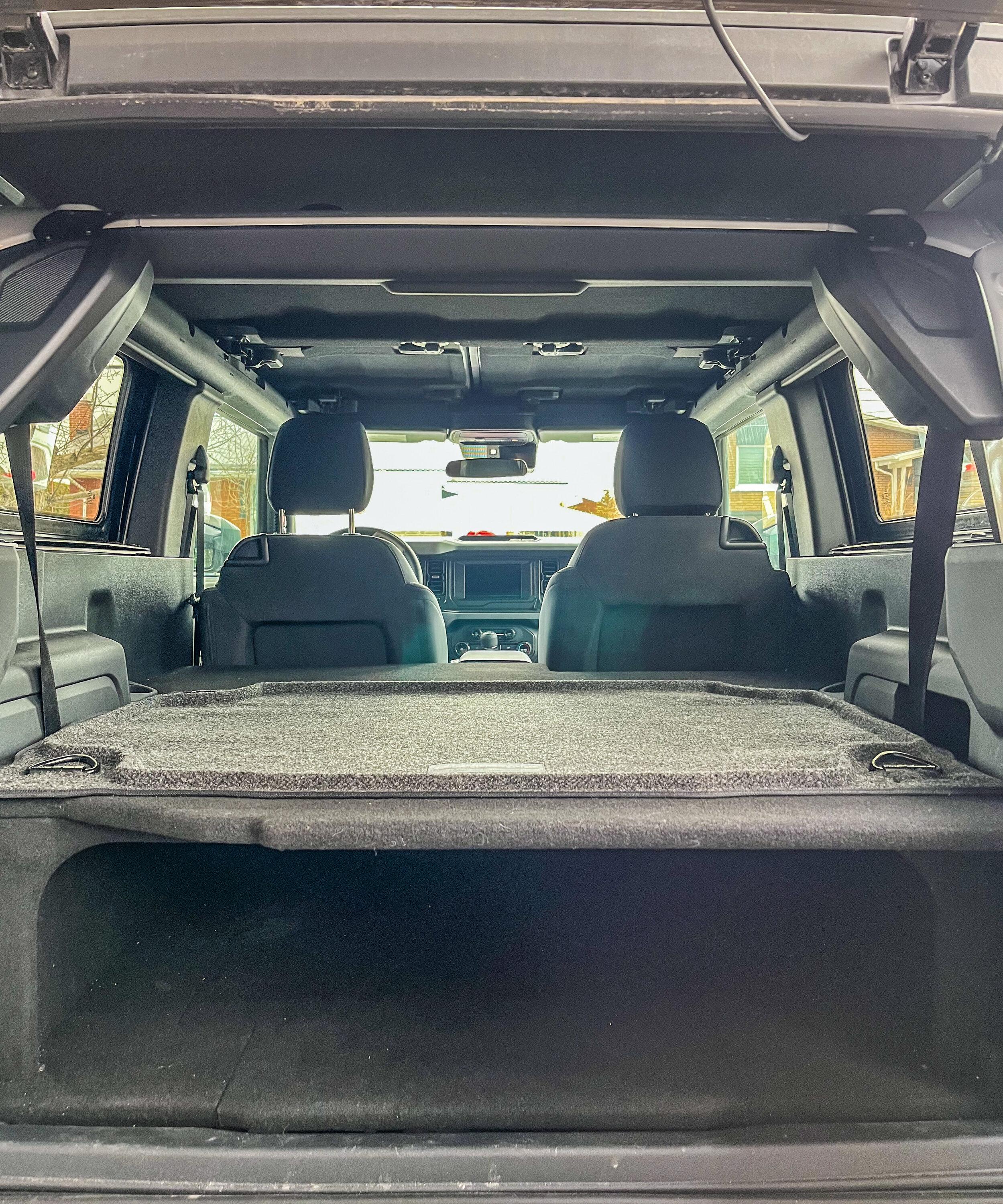

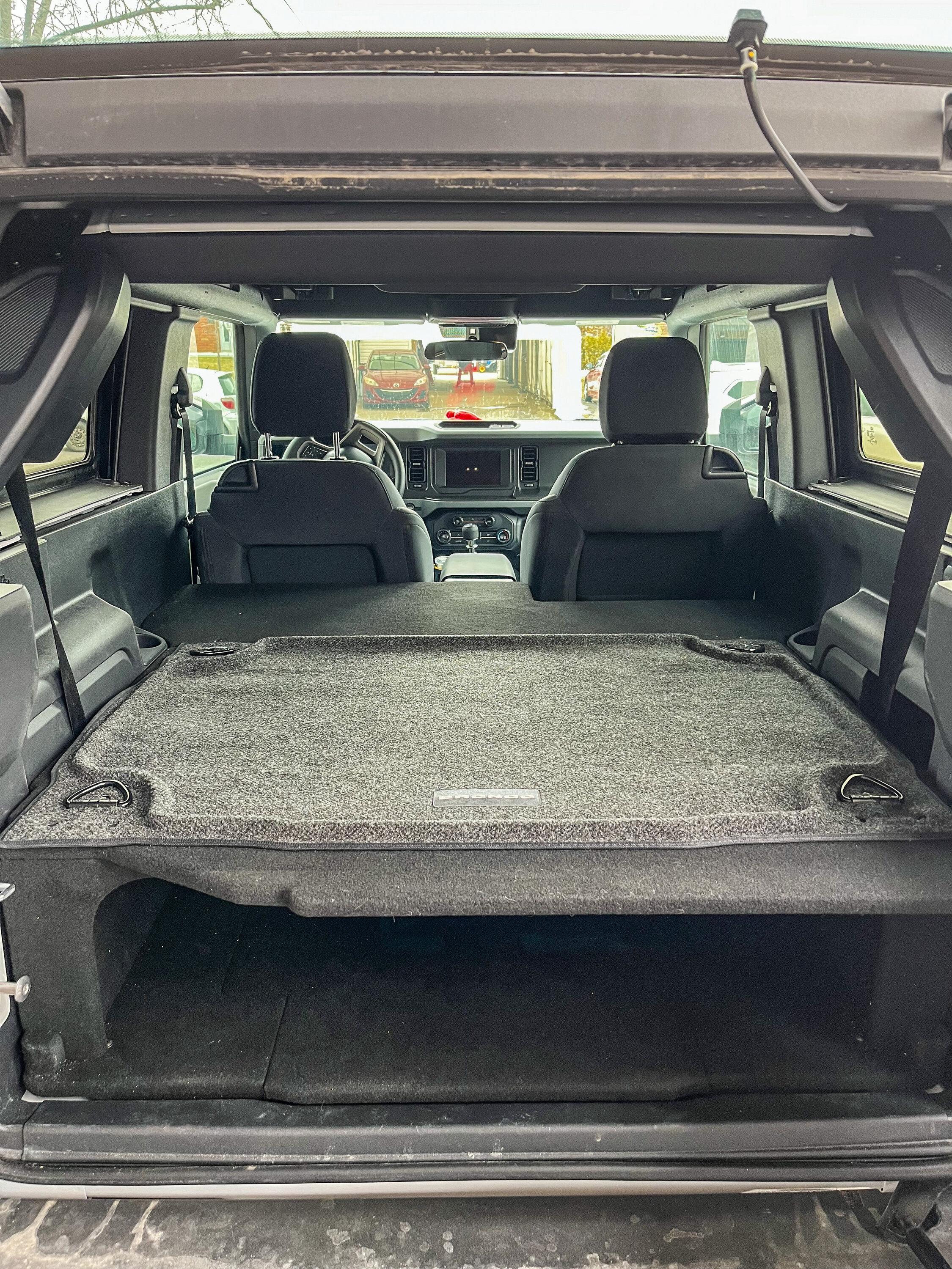

The goal was to fit 2 carry-on hard bags, 2 soft bags and my Kicker 2x10 compact sub securely while toodling around with no top.
Still keeping access to the tools and lower storage, not have stuff flying around and of course my wife can nap with the seat leaned way back.
I’ll be ‘submerging’ a Yeti style cooler behind my seat once I decide on the size.
Bolted to the floor using original bolts front and rear, the whole thing can be removed in about 15 minutes and another 30 to get the back seats back in (most of that time is seatbelt fiddling. 3/4 plywood. The Bronco logo mat is for the 4 door and I bolted the tiedown hoops where the 4 door would go.
