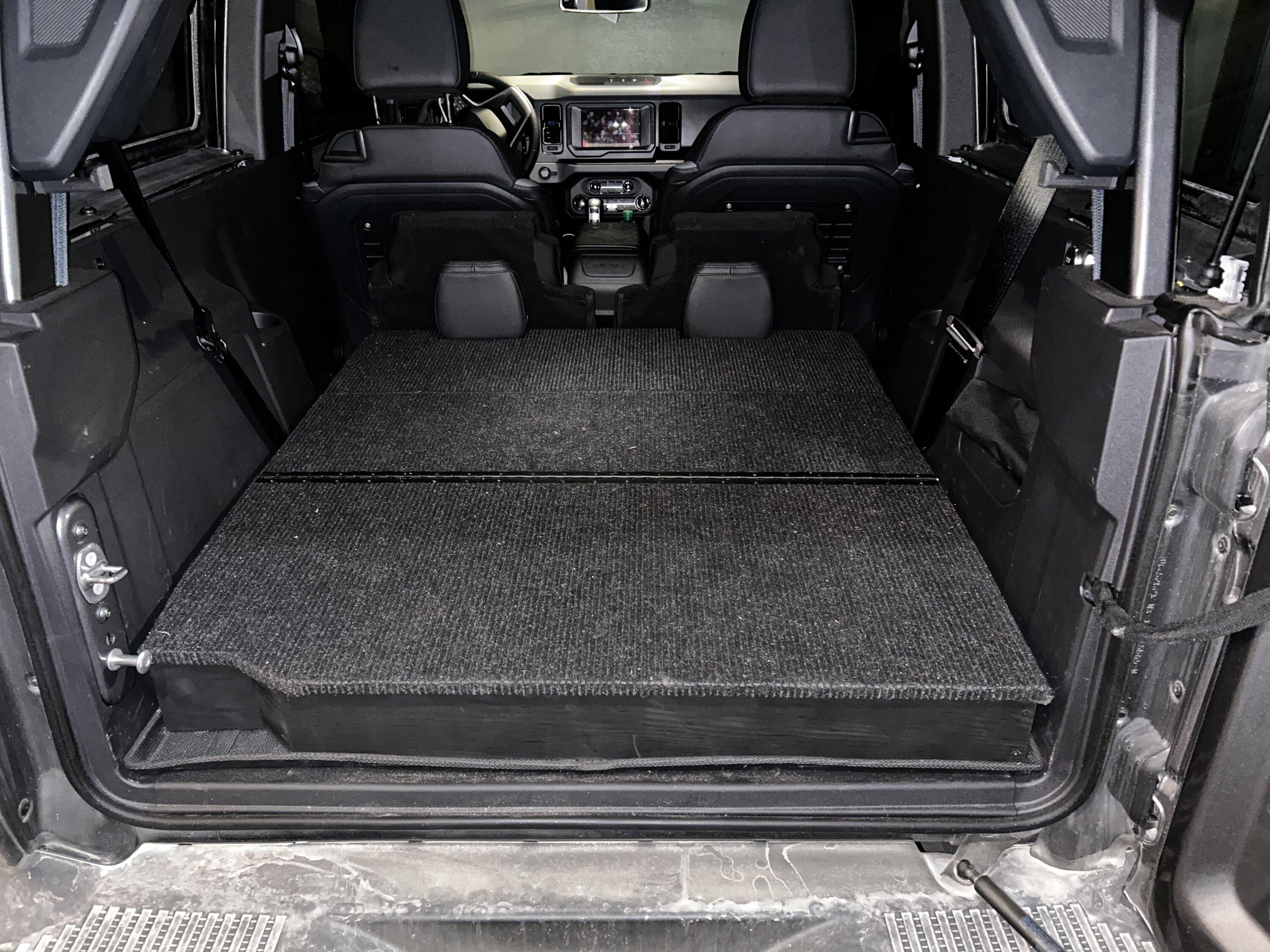

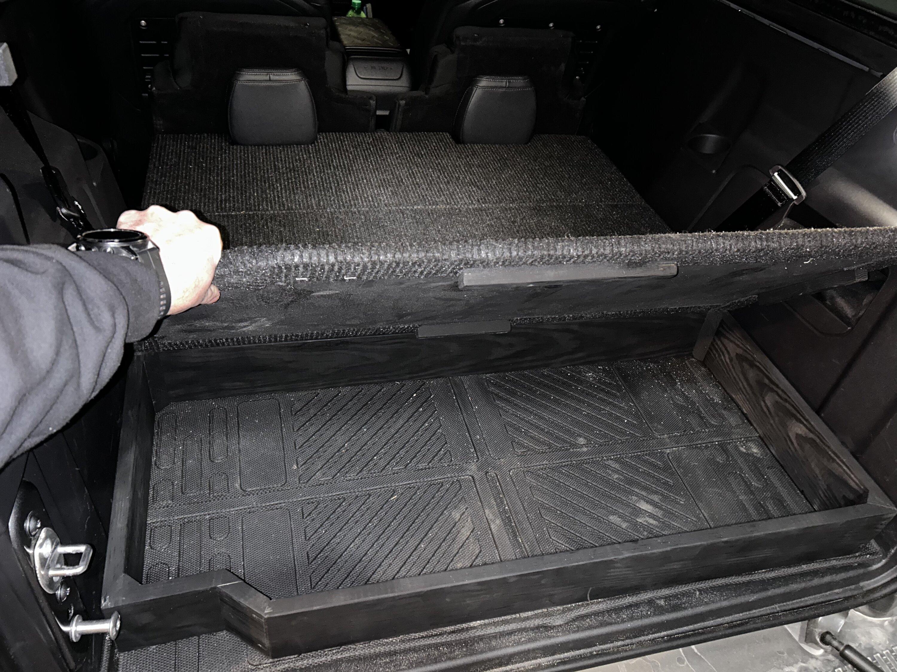

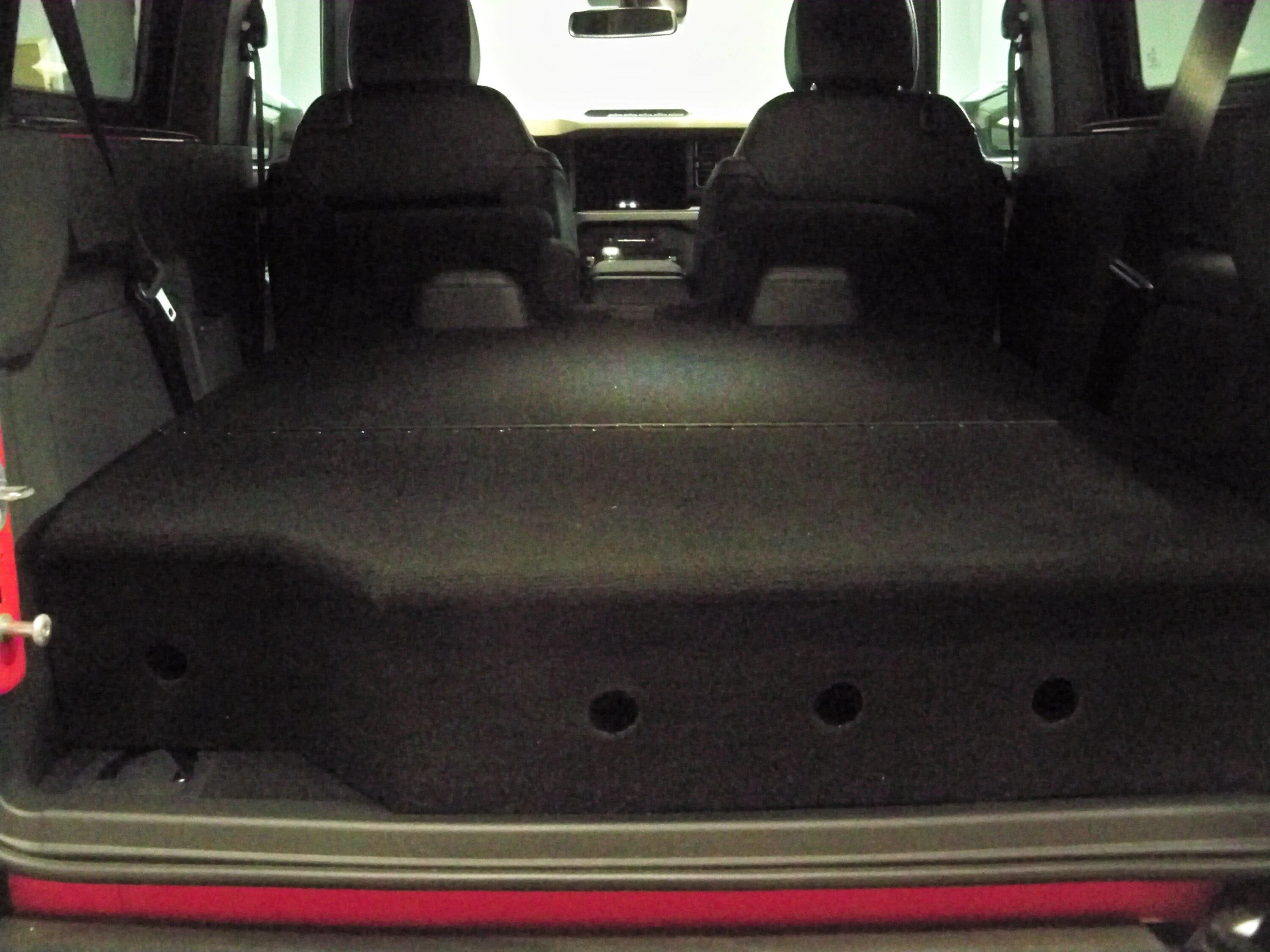

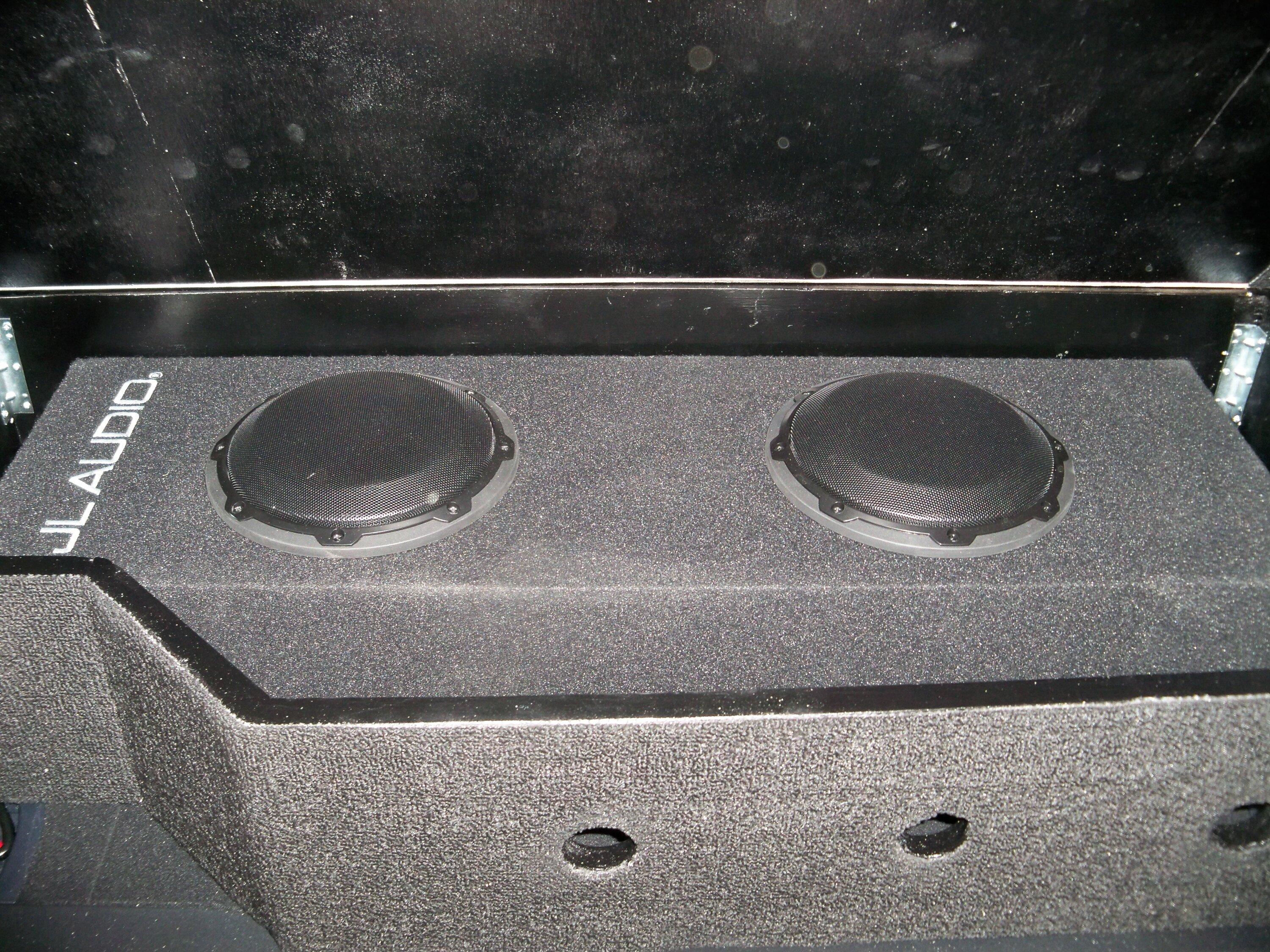

Thanks to Trigger I spent the week-end putting my platform together. I had to go taller to fit my sub-woofer. I also added a block at each top corner for a little more stability. It came out pretty good, will certainly provide more storage and easily collapsed to give the extra seating.
Ford Bronco Another custom 2-door rear cargo area level platform 100_9036
Ford Bronco Another custom 2-door rear cargo area level platform 100_9042.JPG

I apologize for missing this question last winter. I assume you solved the problem. Trial and error worked for me. Did you finish the set-up? I’d love to see a photo.👍🏼

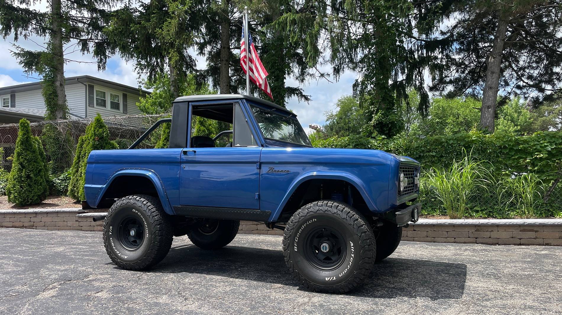

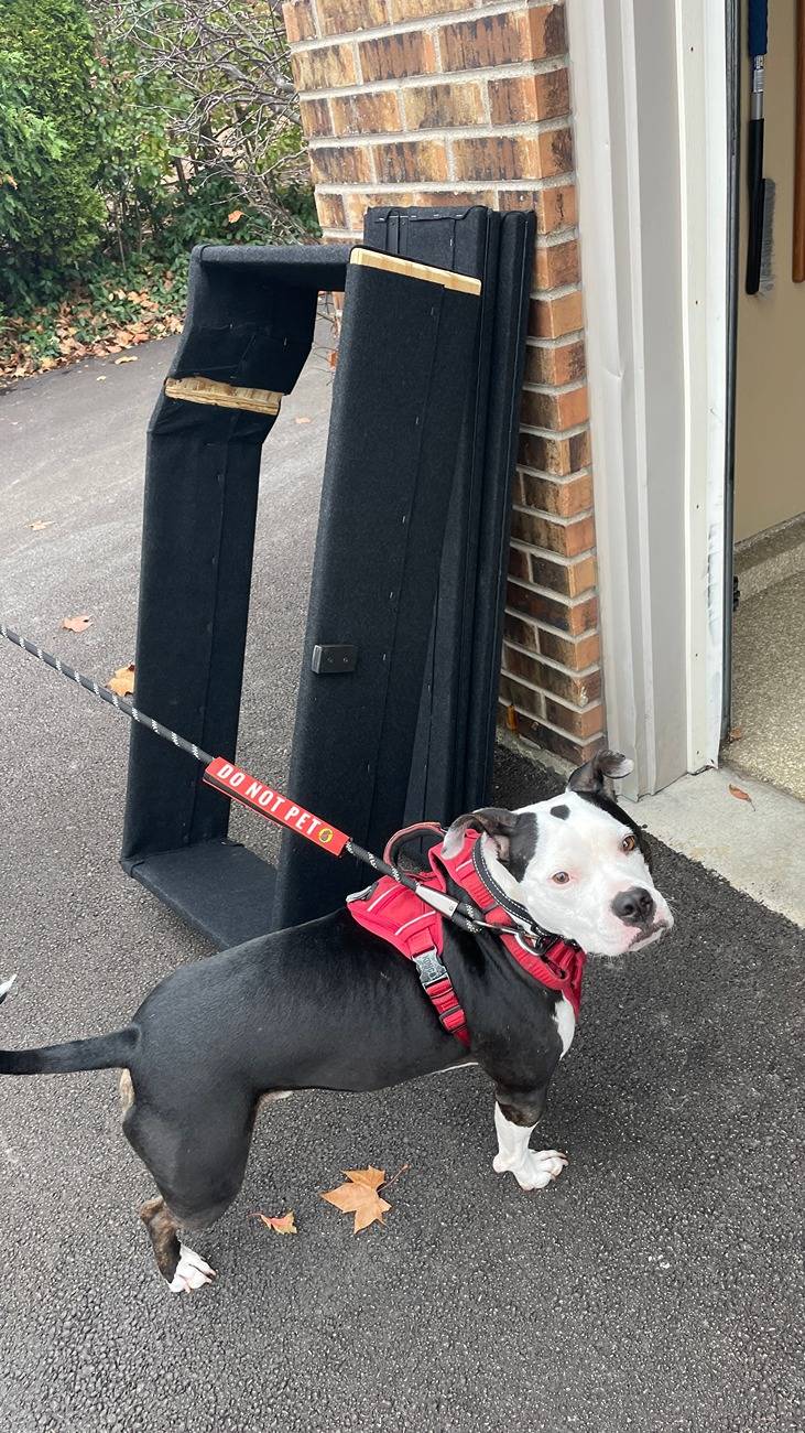

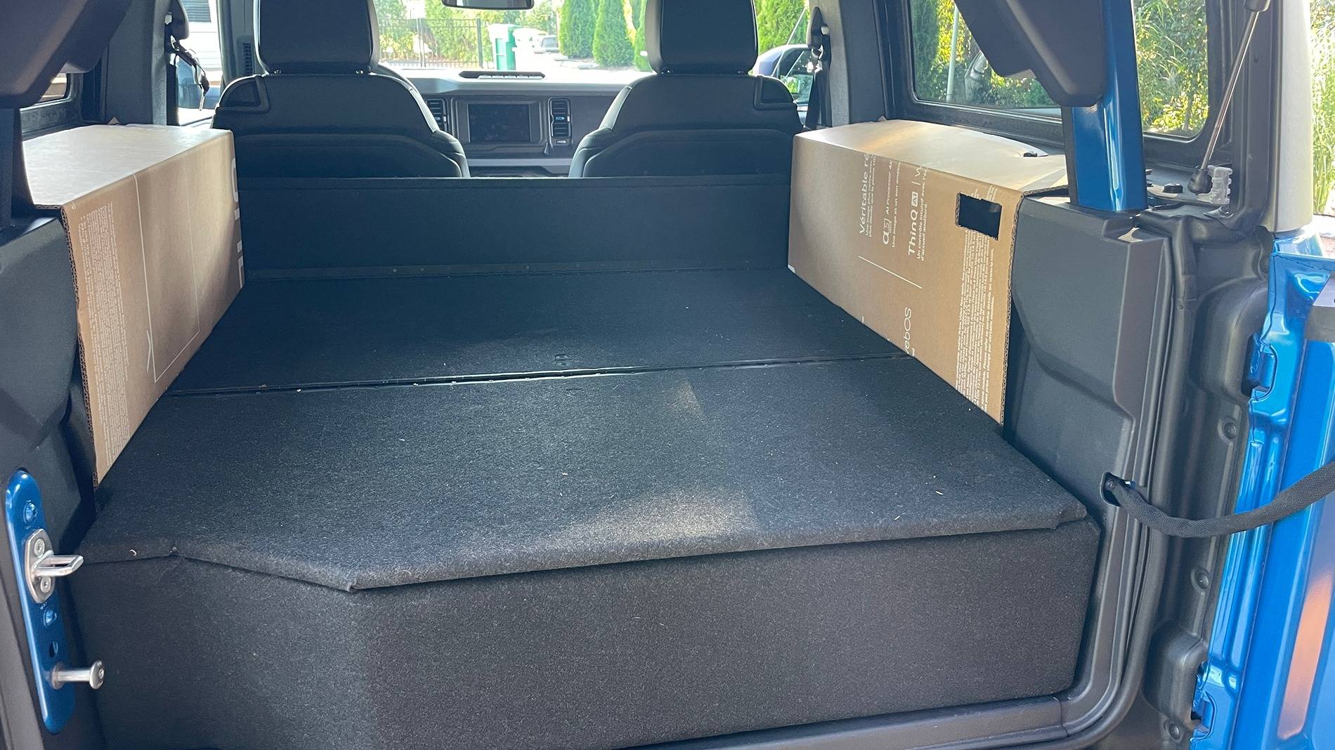

This thread was the inspiration for my platform, same concept as OP but raised up so the dog could look out the windows.
Sadly I sold the Bronco, I think I'll try to sell the platform in the Market section of the forums, just wanted to thank the OP for his original post.
Ford Bronco Another custom 2-door rear cargo area level platform IMG_8618
Ford Bronco Another custom 2-door rear cargo area level platform IMG_8615
Ford Bronco Another custom 2-door rear cargo area level platform IMG_8622
Ford Bronco Another custom 2-door rear cargo area level platform IMG_8628

well done, it looks great. I am interested in the vertical piece that is up against the front seats. Looks like you have a hinge there. What is that about? Sorry you had to sell the rig, I am still enjoying mine. Glad my plan could help you,

Those pieces at the front were just a little more protection for the headrests in case the dog started to paw at them.
I also added some protection for the sides, used some heavy cardboard and covered them with very thin black rug, almost like a felt. I later took these out because they made opening the back storage area more difficult.
Ford Bronco Another custom 2-door rear cargo area level platform IMG_6587
I was hesitant to sell but I still have my 76 to cruise in.
Ford Bronco Another custom 2-door rear cargo area level platform IMG_7775

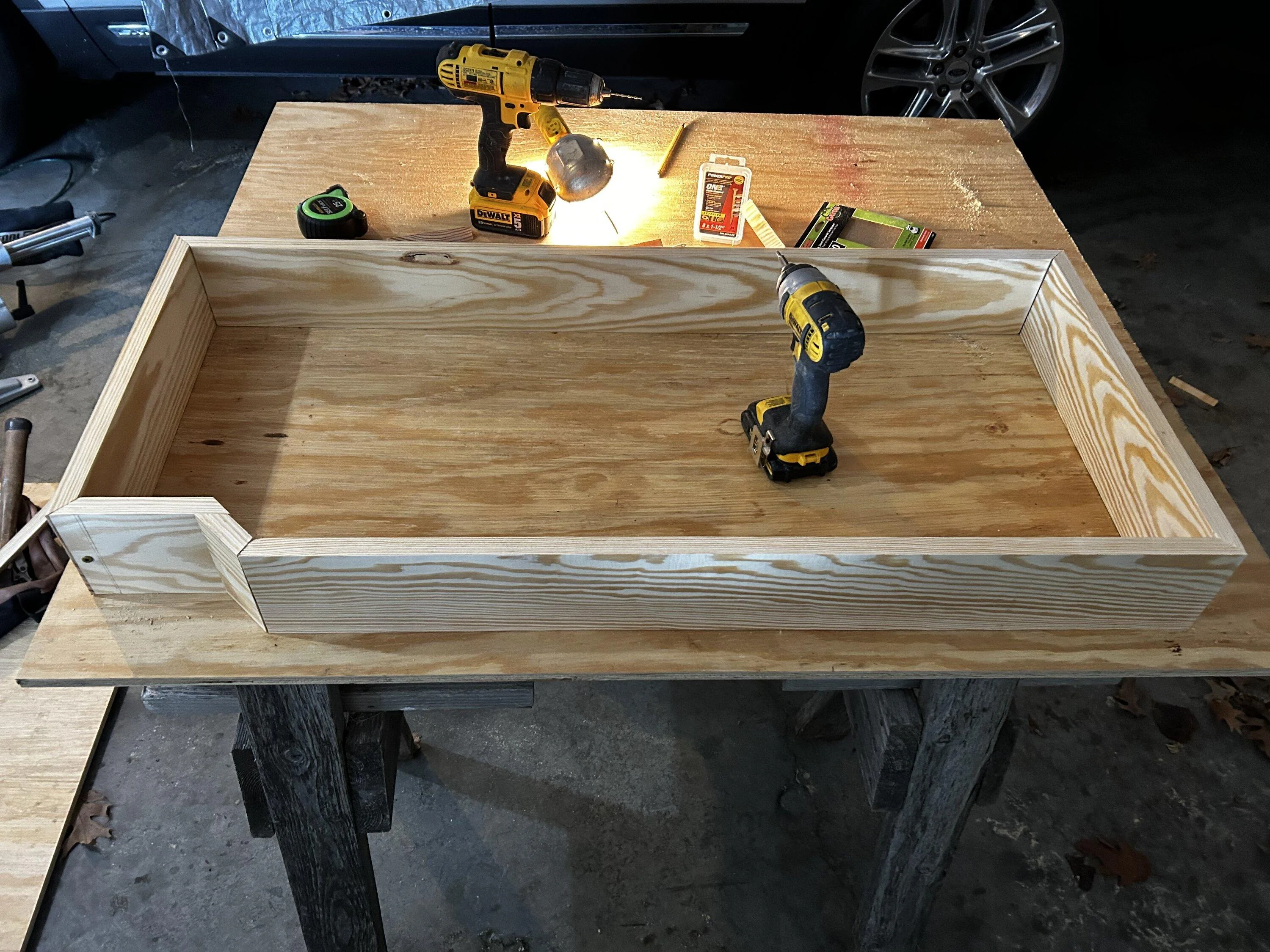

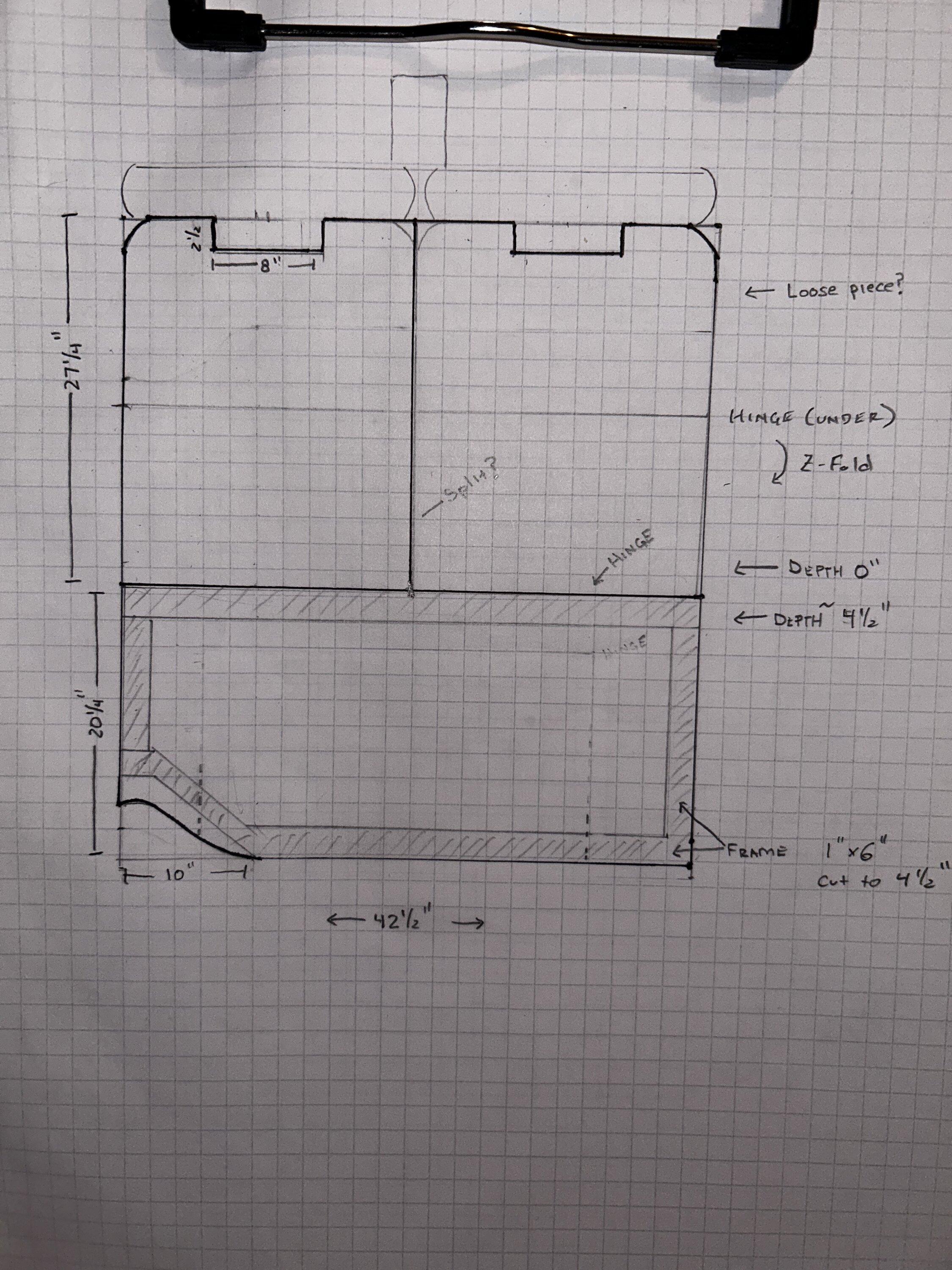

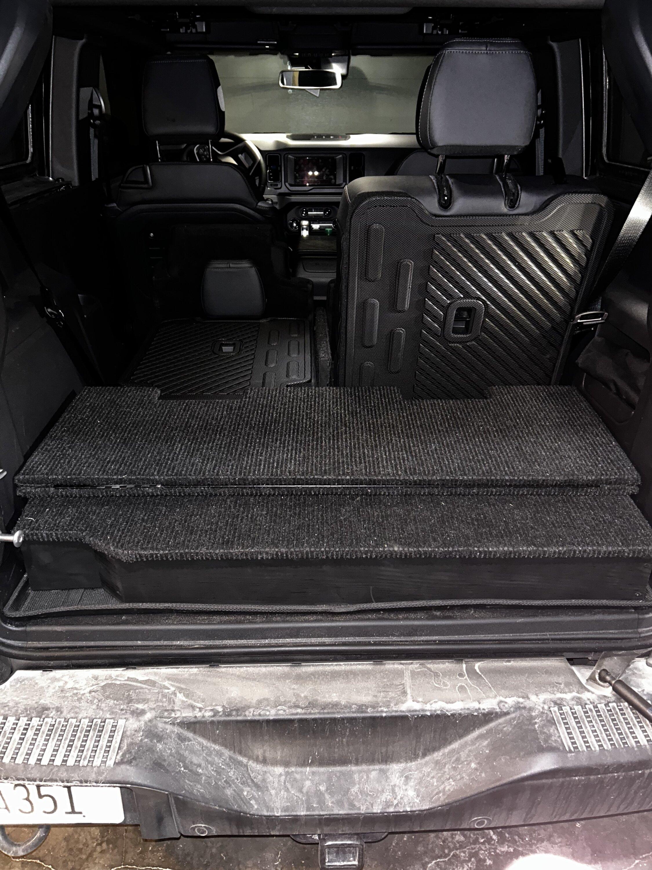

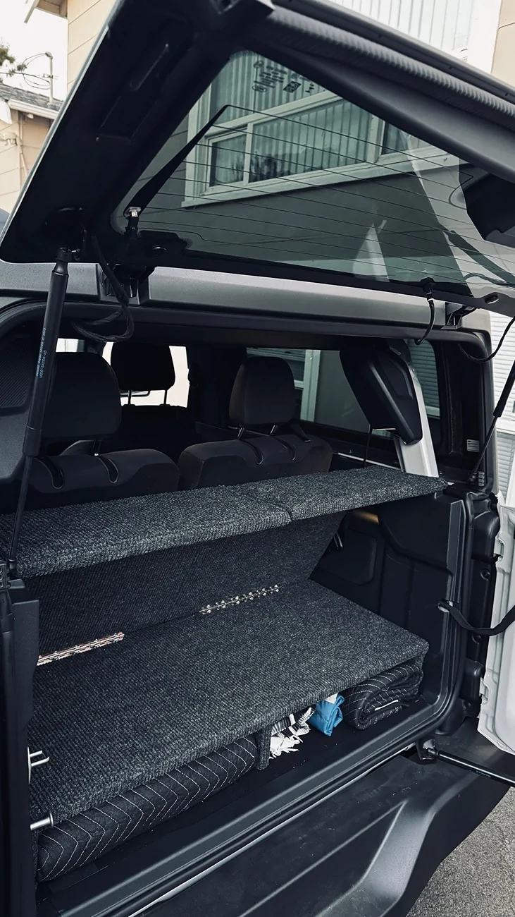

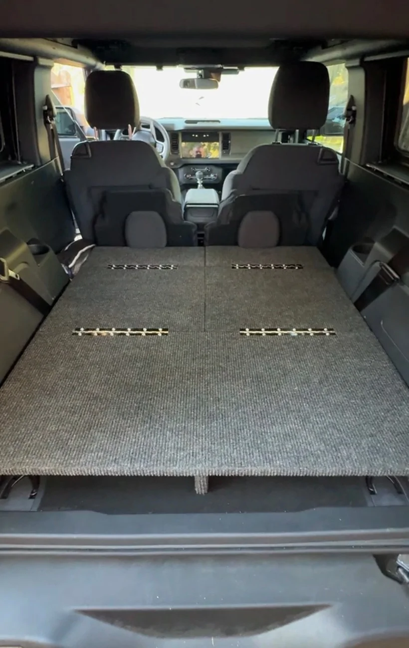

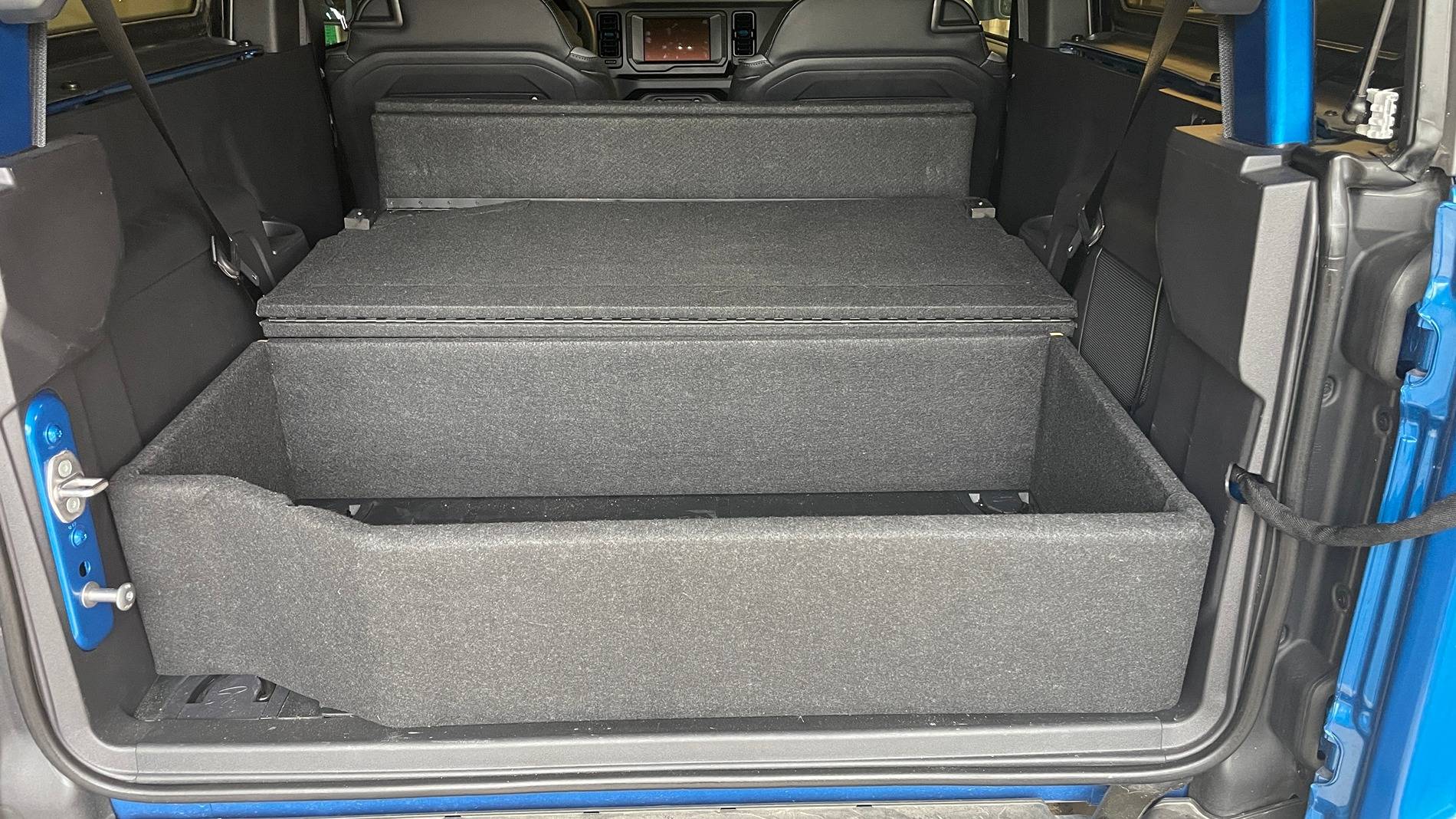

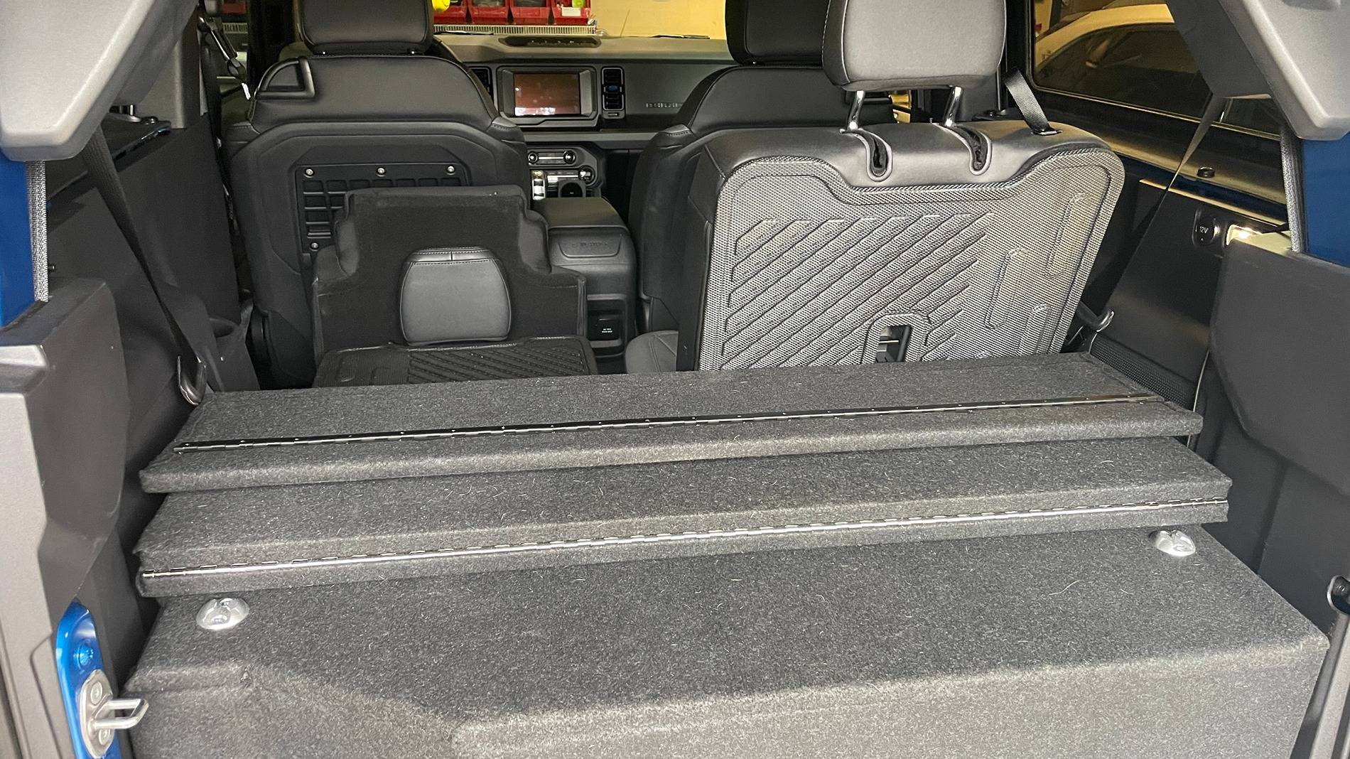

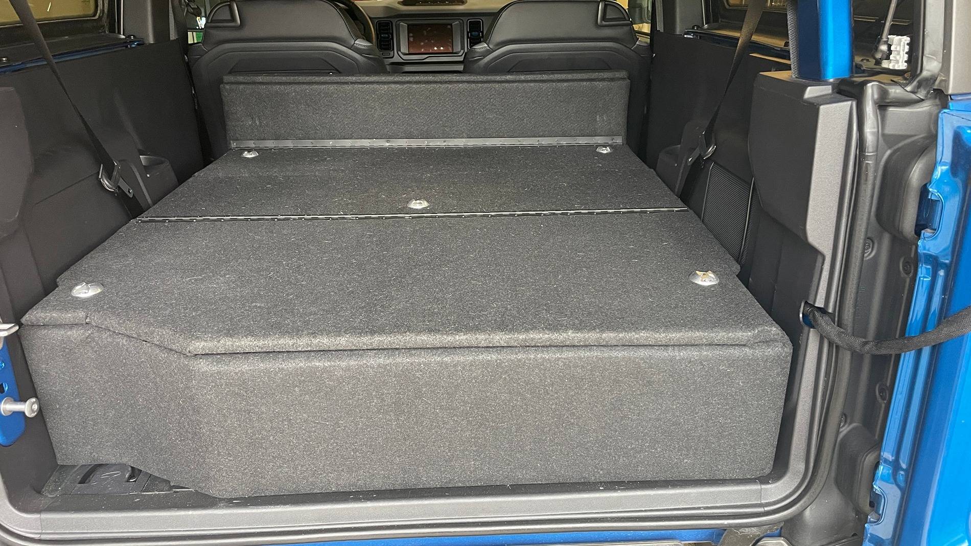

Thought I’d share.
Thank you so much for this post and the inspiration. I picked up on the note in your original sketch of splitting this platform down the middle to accommodate for one rear seat passenger + cargo - and I thought that was a super super cool detail I hadn't seen elsewhere - so I did that in my build!
Ford Bronco Another custom 2-door rear cargo area level platform IMG_6442
Ford Bronco Another custom 2-door rear cargo area level platform IMG_6437
