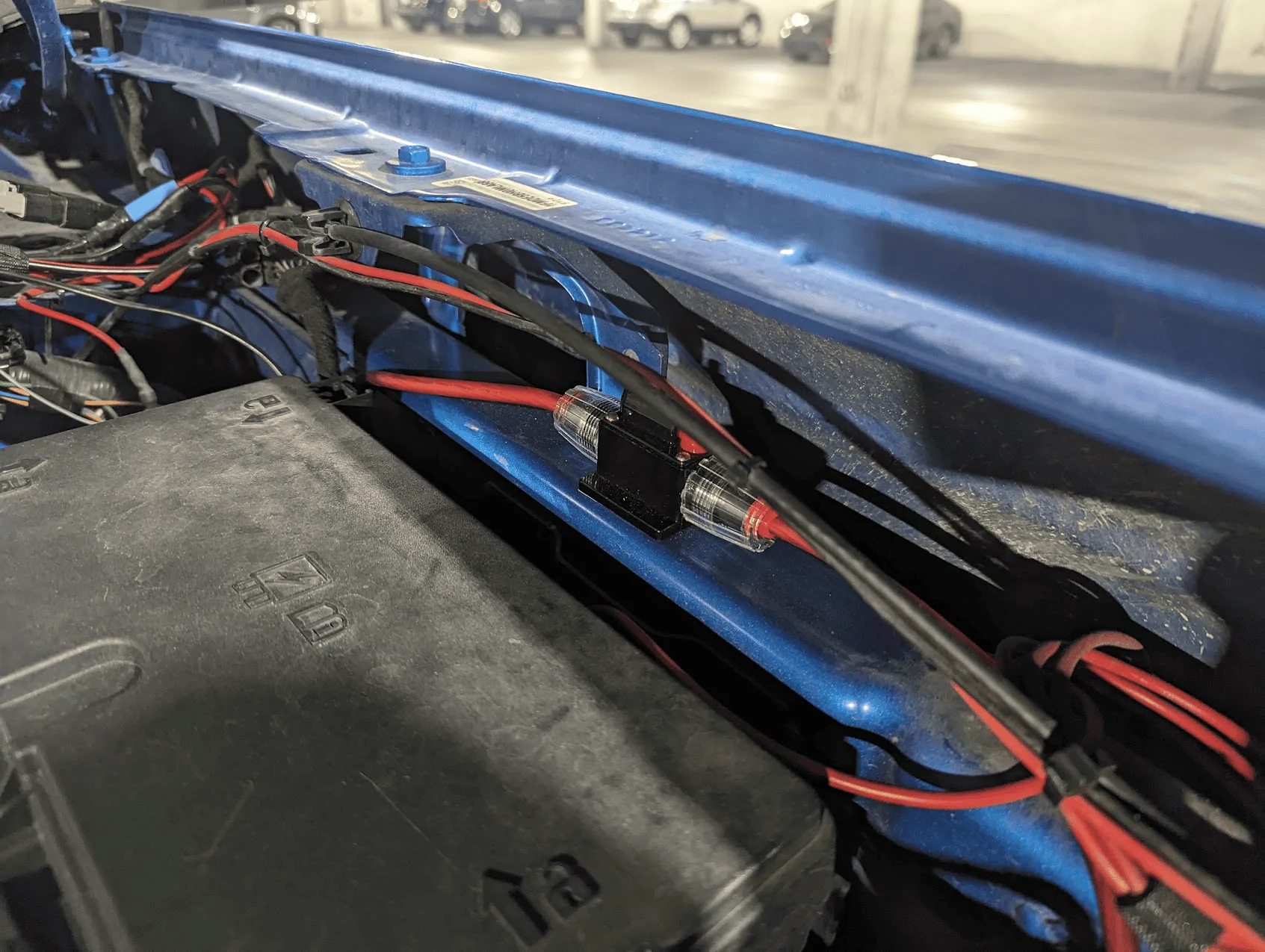

For the 500.1, I wouldn't even go to the fuse box or use any existing wiring in the truck, run your own 8ga with a 60A fuse to the battery, and then just tie down a ground in the back (I used a rear seat bolt).
Ford Bronco Amp Fuse Wire Option? 1709831034667
Sounds like you might be concerned that the amp turns off when you leave the car, but they turn on and off with the speaker inputs on their own, so it's a non-issue

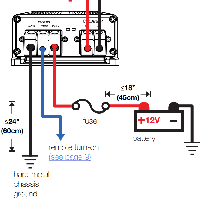

So I ran the 8g power wire to the 500.1 I was referring to the remote turn-on wire. Unless this is not needed, however I thought it was? Now I am confused. Sorry this was not the amp I was planning on using, but fits the space so much better plus the plug in play kit that I got.
Ah - not needed with the Kicker. Since you are doing a speaker-level input, the amp will detect when the head unit turns on, and turn itself on.
