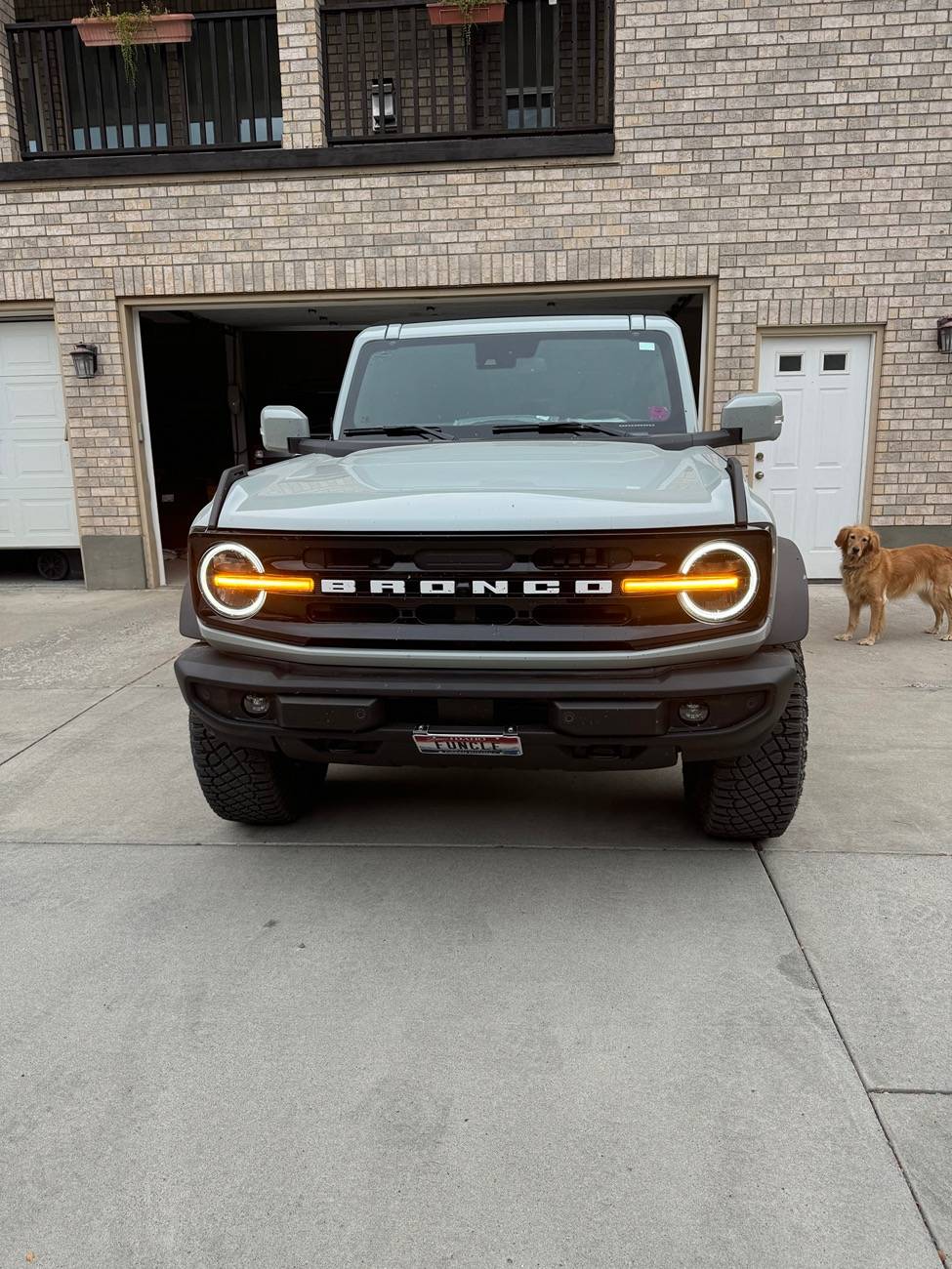

I was finally able to get the DRL switched to Amber in forscan by changing to 0101.
Blinkers work as normal. But when headlights turn on they switch back to white.
Had anyone found a way to change them to amber all the time, even at night, while still maintaining full function of blinkers etc??
I’ve researched this and haven’t found anyone on the threads that has successfully done this but thought I’d check specifically in case it’s been done but not posted on a thread.

Not that I’ve heard of without buying raptor lights or aftermarket. I tried everything and asked around researched two years ago when I went Amber. I just learned to live with it. I wanted Amber in the daytime as I had a number of close calls with the dim white in the first few months of owning a bronco. The number of people pulling out in front of me drastically went down after switching to Amber.
