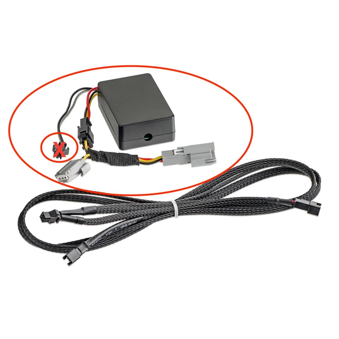

So I ordered the Mabett dome light and the 4 piece interior lights recently and installed them in my Bronco. I immediately started having issues with the interior lights randomly coming on, not shutting off, all of the above. The dome light worked perfect. I ended up disconnecting all of them until I could figure out what I was going to do. @Mabett must have vanished from the forum because I messaged them on here a couple of weeks ago and have never got a response. I found this thread and saw the IAG harness and ordered it because why not. I am happy to say it has fixed my issue and now I even have the ability to turn on the interior lights with the factory dome light button which wasn't an option before. But, it has a weird sequence where you have to push it twice to turn them on and twice to turn them off. I can live with that. Everything else is working perfect when opening and shutting the doors, unlocking and locking the Bronco.
The harness included 2 pieces. The Mabett interior lights connected into the dome light so for my setup, I only had to install the top part as shown below, connecting the 2 grey clips into the dome light. The clip I circled with an X didn't need to plugged in to my setup so I just tucked it away above the dome light. Depending on your setup, you may have to utilize that into your interior lights.
Hope that helps anyone who is having issues with their Mabett lights. Feel free to ask any questions, happy to help or I can take some pictures of my setup. Cheers
I just did this. I bought the Mabett interior lights because i thought they had their issues fixed (Amazon Prime day deal). They did not. I bought the IAG harness linked above and ended up splicing the circled connector onto the Mabett harness. Works like a charm!
Is the IAG harness just plug/play into the Mabbet dome light or did you have to actually cut wires?
Can you still turn on all the lights with just a single push of the button on the driver's side? Or do you now have to push twice per the note above?
Any details on how you did this would be appreciated!
