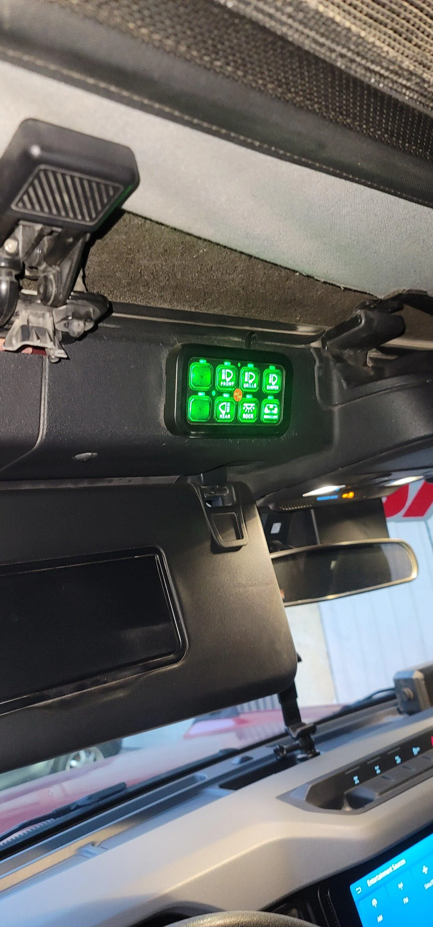

How easy was it to feed the main wire down the drivers side trim and pillar, did you have to remove trim or can you feed it down without?, did you not use the fuse panel that came with the switches and use the bronco fuses? Did you just tie right into the wire harness that’s left bundled and disconnected on drivers side? Thxs, I have the auxbeam panel and would like to do this
I was able to feed the wire without removing any panels. Just the door gasket . I used the fuse panel that came with the unit and yes I was able to tie into the harness.

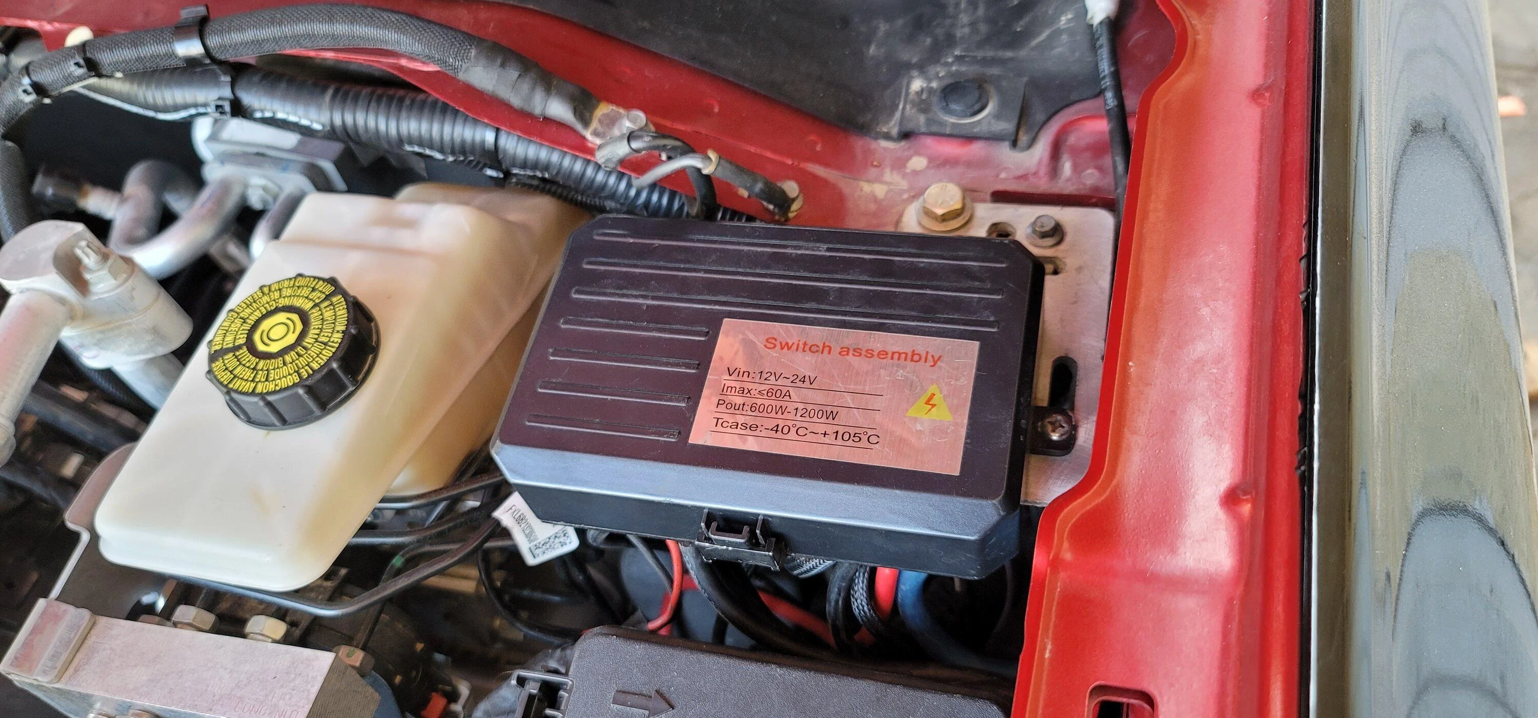

When I got my bronco delivered the aux switches where not added. However I did notice the bronco is still pre-wired to the diffrent locations. I purchased one of the Amazon swichbpanels and was able to jsut tap into the original witing.worked out perfect.
(Edit)
So here is the link to the Amazon switch panel i purchased
https://www.amazon.com/OFFROADTOWN-..._rd_i=B08DHL65NV&psc=1&ref_=pd_bap_m_rp_62_sc
I used double sided tape on the switchbpanel to avoid drilling and ran the wire down the driver side panel.

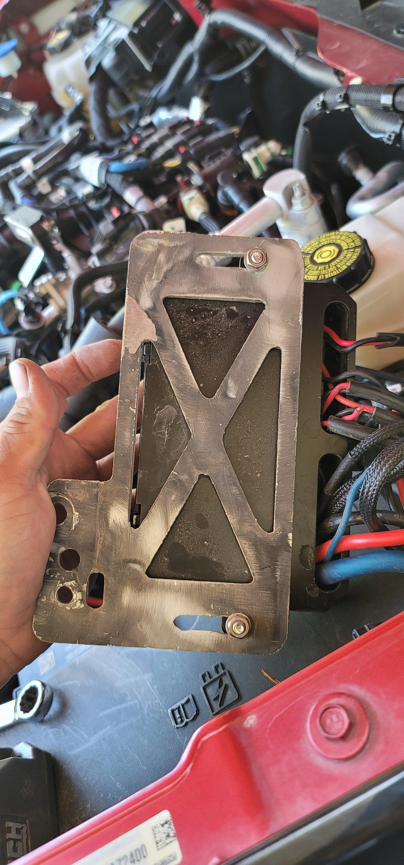

As for the fuse and relay box I made an aluminum bracket that bolted up right on top of the oem aux switch wiring. Although mine didn't come with the switches the wires are still their. Using the ford manual for the switch wiring I was easily able to to wire my chase light, bumper lights, ditch lights, and radio.
I've had this setup for almost 7 months now and I love it. Easy no drilling ,and we'll under 200 bucks..Can't beat it.
