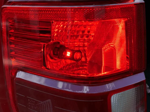

Please note these are tail/brake light LEDs only, no turn signals. And they are red, not white. The only tool you will need is an 8mm socket (or 5/16) The heatsink is well machined and big. It even looks spiffy when off and looking though the lens. The red light from the LEDs pass through the lens with out a lot of attenuation giving a deep red color that's pretty to look at. White LEDs produce a wide spectrum of light much of which is blocked by the lens, or the tail light appears orange or purple depending on if the white LED is truly white or leaning warm or cool.
Ford Bronco Aftermarket tail light suggestions? 1654680593463
Digital camera adjusts for brightness. Looks brighter to the eye. The deep red color is nice.
Ford Bronco Aftermarket tail light suggestions? 1654680632169
Brighter than the halogen bulbs. Sorry, I do not have the numbers for lumens and all that.

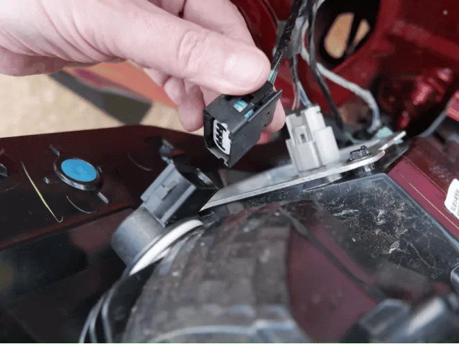

The bulb holders are removed by rotating CCW. On the left-upper and right-lower you will need to remove the wire harness connector first.

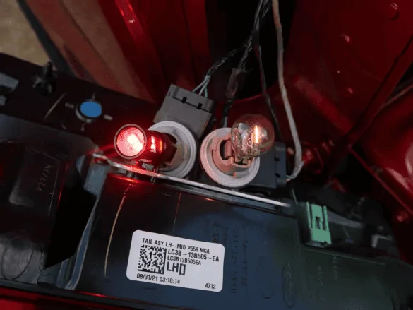

Swap out the bulbs for the LEDs

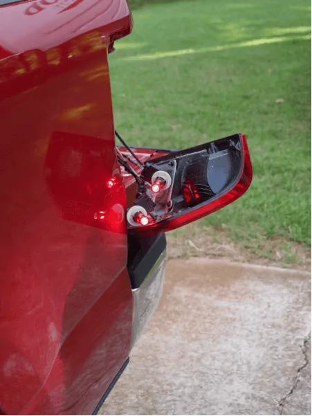

Test the LEDs. If you don't have a helper, the wires are long enough to hang the LEDs "over the side" and you'll be able to see them using your mirrors from the drivers seat. You'll test for tail and brake lights, then turn signals.

You will need to disconnect left-upper and right-lower wire harness connector to get the bulb socket base to rotate out of the housing.

Testing the bulbs without a helper. You can see them in your mirrors. Getting them to stay there is a trick. In hindsight, a couple of clothespins would have been helpful.

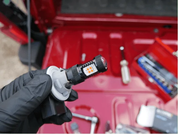

They are big, well made and you don't have to "modify" the base to make it fit.

In short, I think they are great. They have fewer LED chips than most/some solutions and that gave me pause, but having tried them they are plenty bright. Also I recalled my LED fog lights have only 6 LEDs and they are awesome bright.
The heat sink or frame of these things is massive. Well machined. They even look cool looking at them through the tail light lens.
