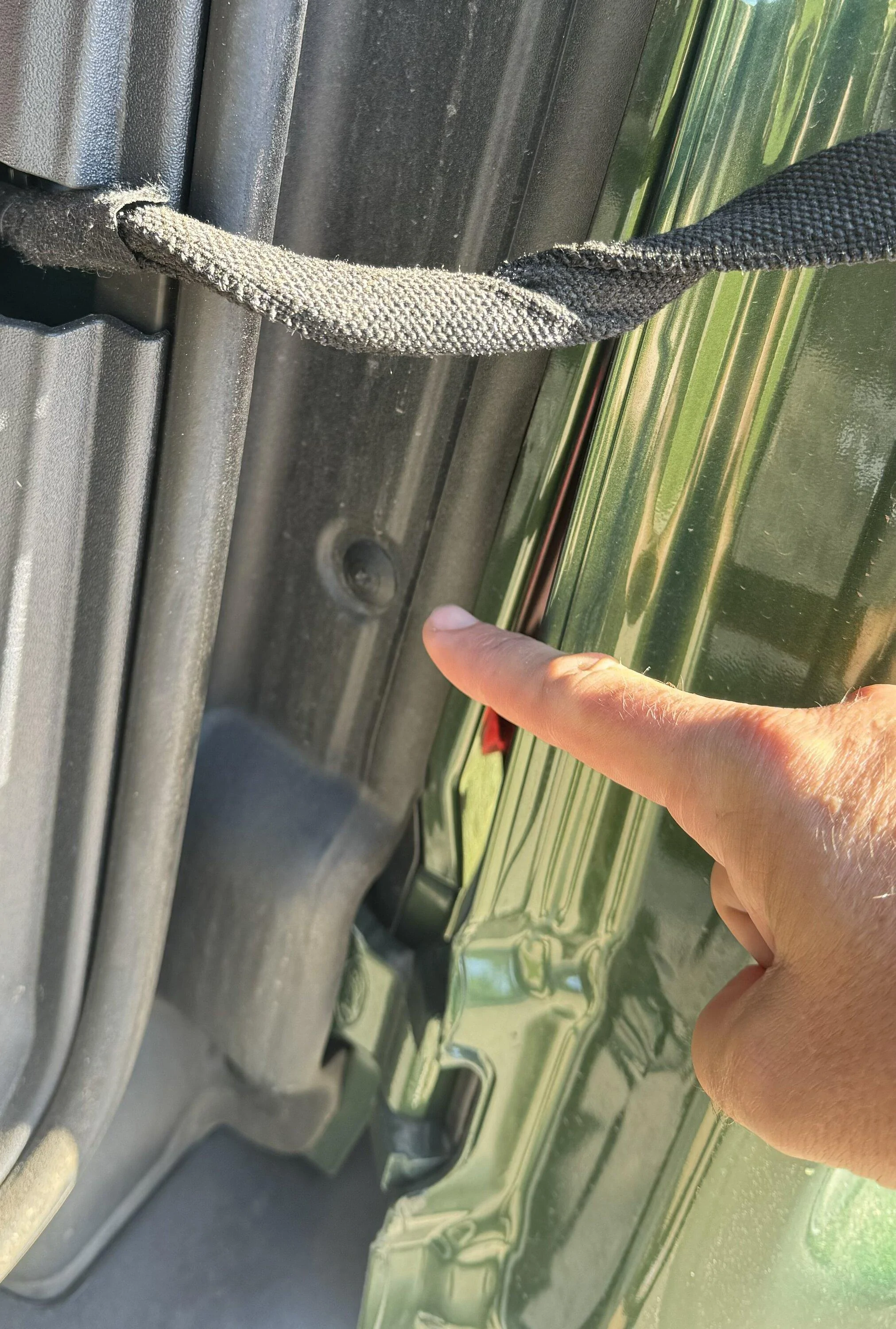

I need to replace one of the trim screws in the tailgate. It was stripped from the factory, but made worse when I upgraded my reverse bulbs. Does anyone have the part number?
Ford Bronco Trim screw tail light part number IMG_3364

pull the other side screw out head to you nearest ace or true value and get yourself a screw. they have the best selection of standard and metric screws

punch in this number ( W715694-S300 ) on Amazon.com from the states (I can't do it in Canada) and it will be the first Trim Pin that shows up that works great. It is 6.3mm which is what you want. Buy the 30 pack, and hold on to them for other things on the truck.
by the way, the Ford replacement ones are not cheap..... about $5.00 each !!! WTF !!!!
Appreciate it!
