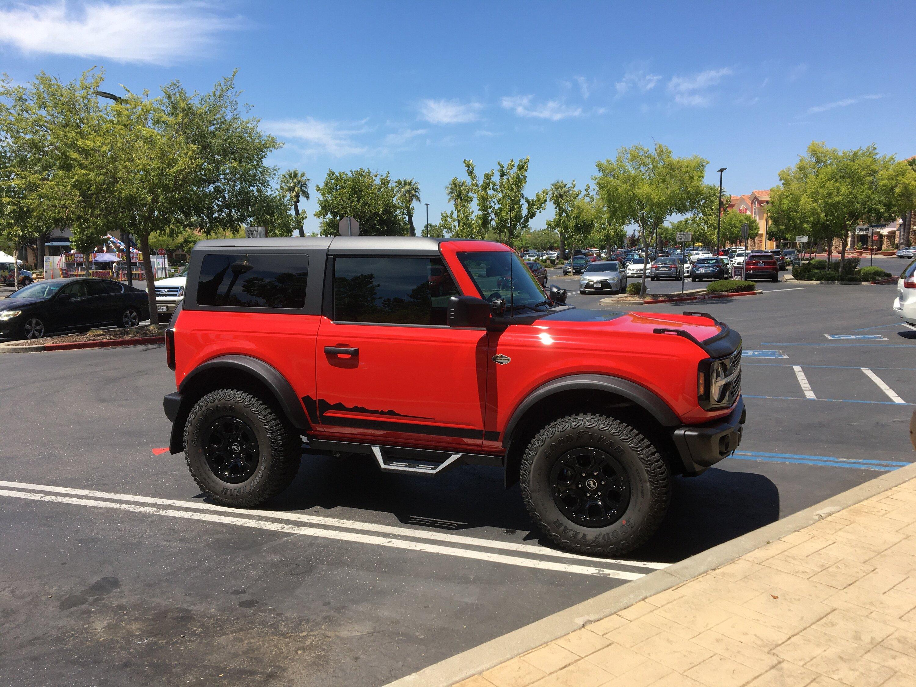

Any one have experience or tips on removing the Aeroskin deflector? I bought mine with it already installed and don’t think i love the look.
Hi, I just removed mine and replaced last weekend, I strongly suggest using Hot water only in a bucket and micro fiber cloth. It will take time, remove using dental floss first, soak old adhesive attached to the paint over and over and scrub off with cloth. My faded some in California sun, so replaced, it has saved my windshield countless times
