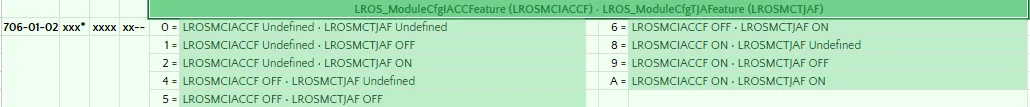

I think you would need to disable ACC and TJA here in the IPMA:
Ford Bronco Adaptive cruise and crash front sensor removal 1780426201239-5k

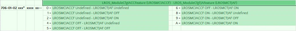

There is no info in the Bronco or Raptor spreadsheet for the CCM, but I think disabling ACC in the IPMA would be enough. There are also settings for IACC in the IPMA that may need to be disabled if disabling ACC alone is not enough:
Ford Bronco Adaptive cruise and crash front sensor removal 1780426992628-n5

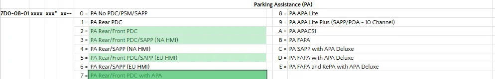

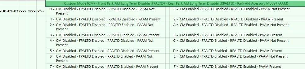

I can't find anything in the IPMA or IPMA regarding front parking sensors. All I can find in the APIM are these bits below. I am not sure if disabling these would prevent any codes once you actually unplug the sensors, but hopefully this helps.
Ford Bronco Adaptive cruise and crash front sensor removal 1780426799416-hj
Ford Bronco Adaptive cruise and crash front sensor removal 1780426821209-h7
