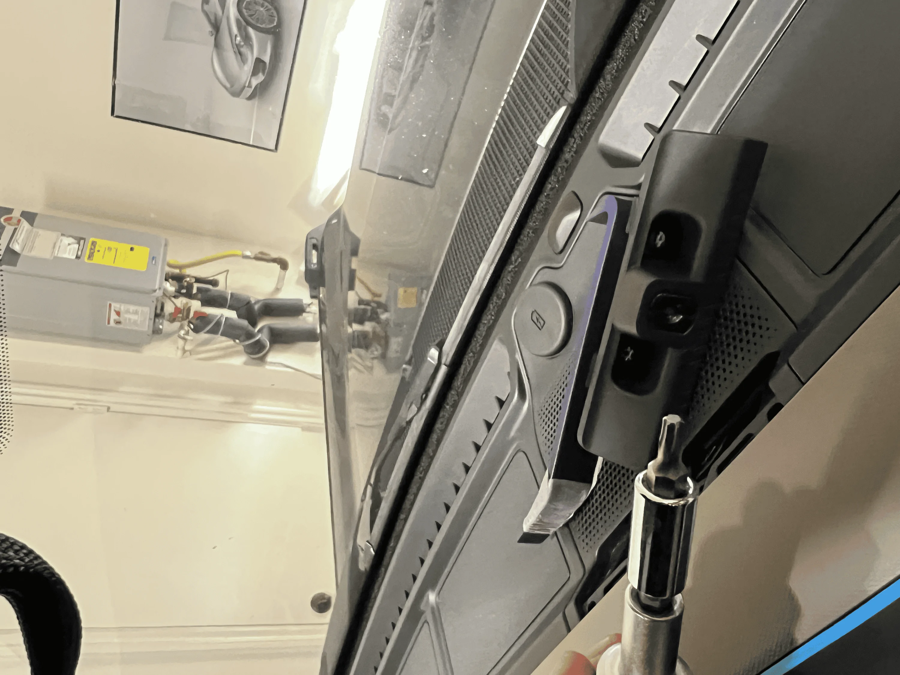

There are 2 bolts on each side of the accessory mounting hole. Once those are out, you can pop the cover off but be careful with the USB cable/plug.

Torx t27 btw

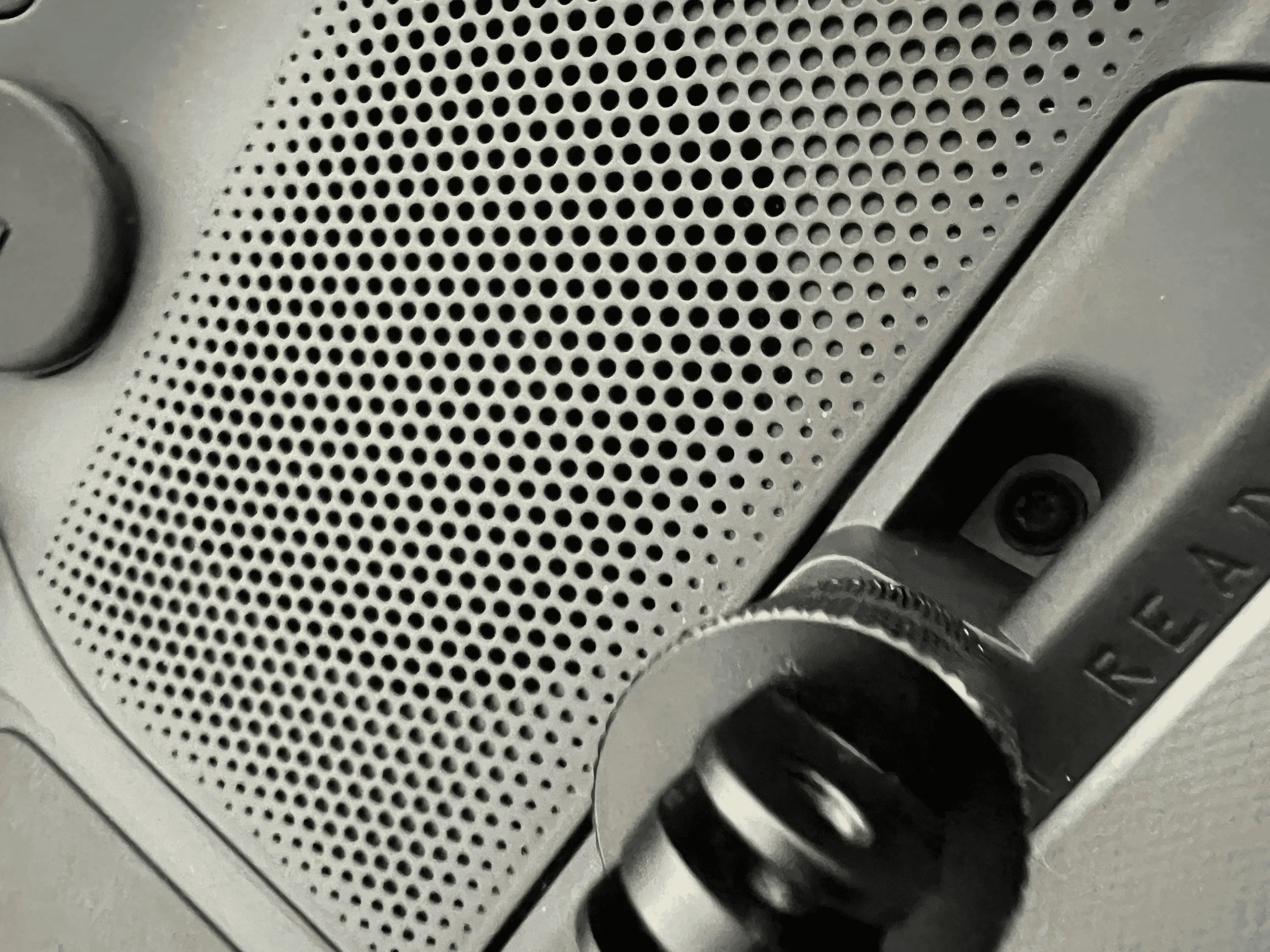

For the life of me i can not get those screws out
I have tried every size Torx
Its almost impossible to see in there
So frustrated
Is there any way around it?

Came right out with T20 Torx

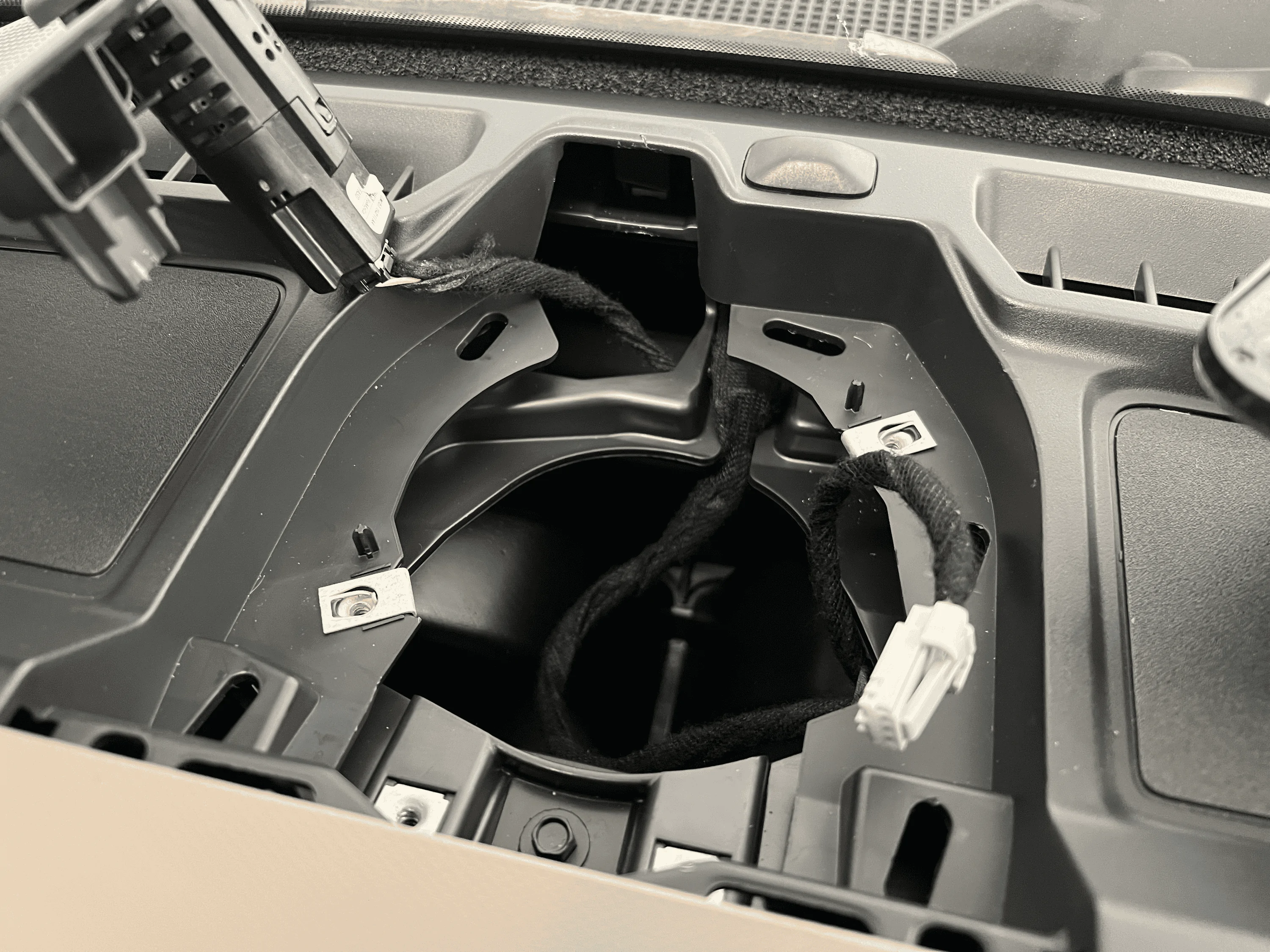

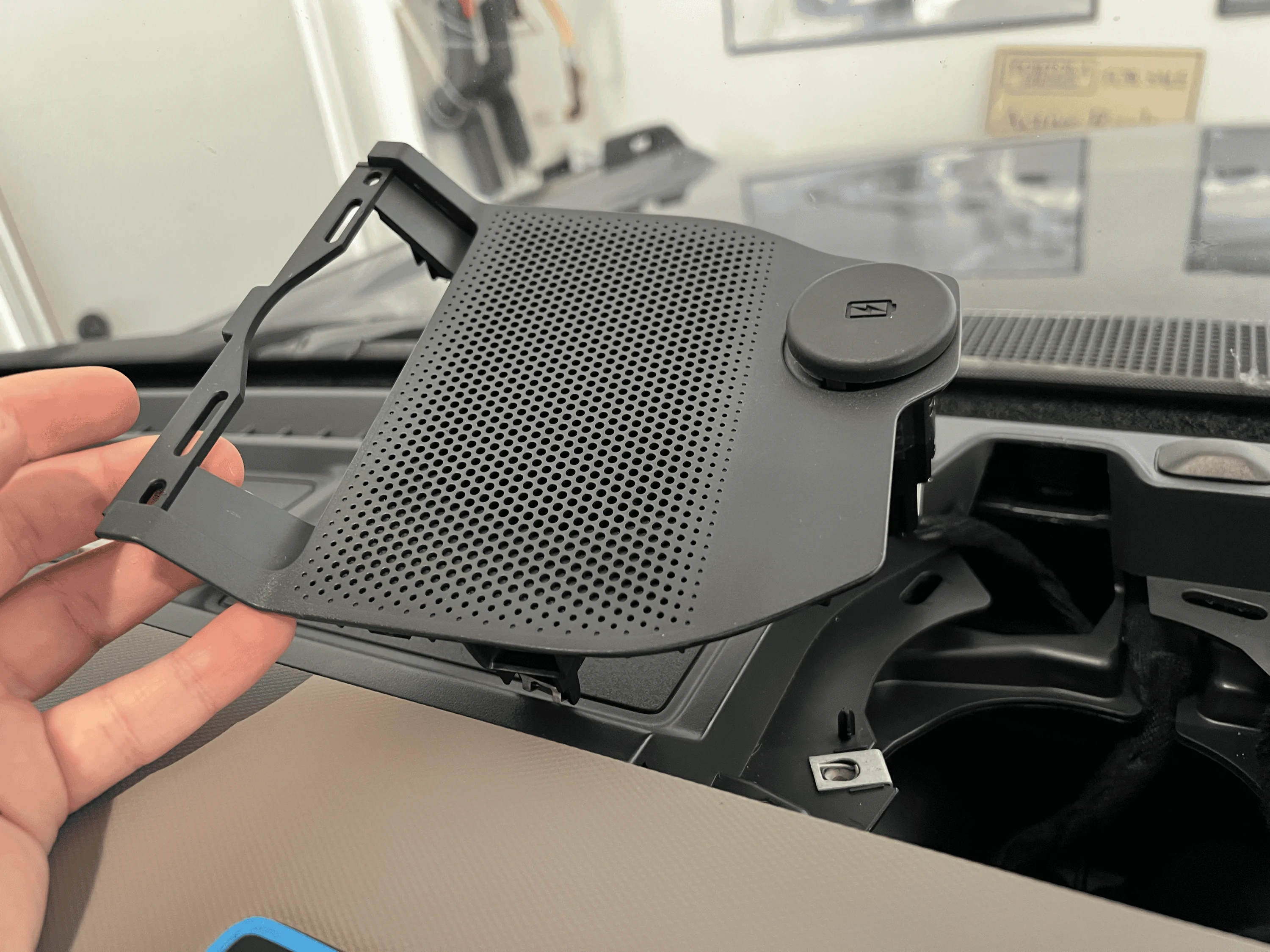

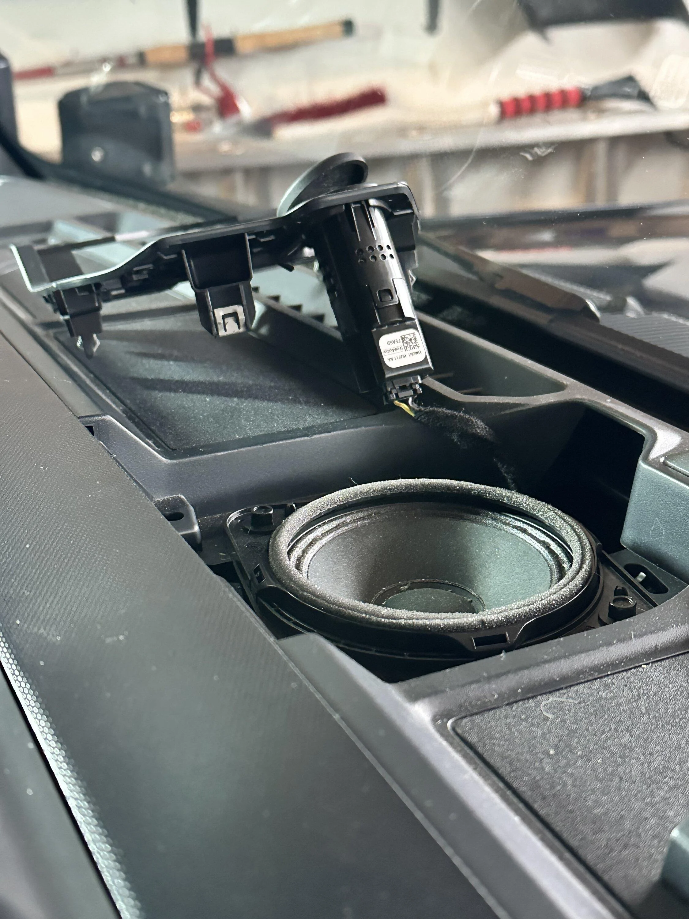

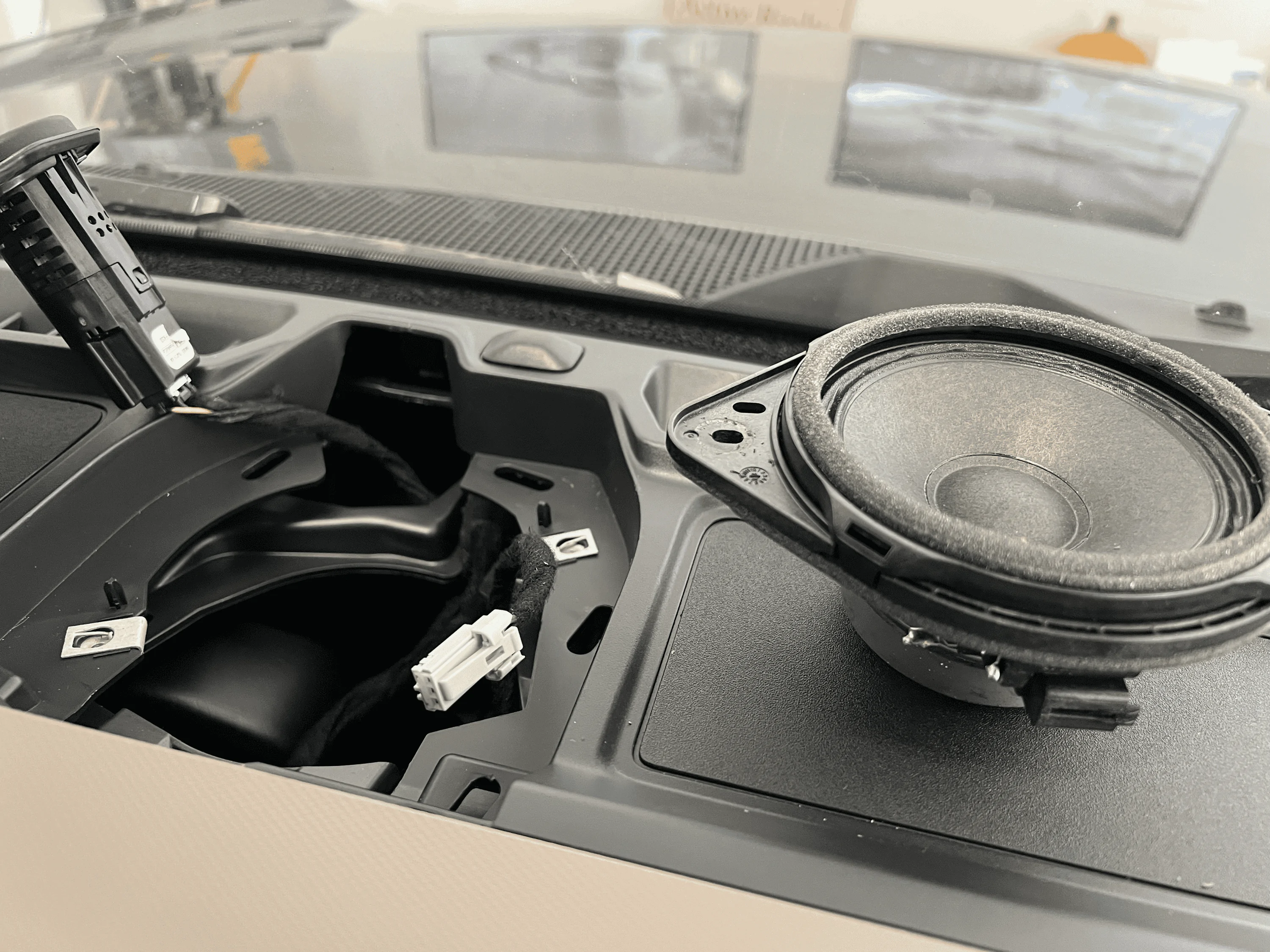

Here is a quick guide to removing the center dash speaker cover for the B&O system:
1. Remove the "Accessory Ready" stand with Torx T-20
2. Start prying with prying tool from the outer top edges gently until clamp comes out
3. Pry the side closest to the accessory ready area from the sides until they lift up but isn't fully out
4. Push the USB charger inwards towards yourself, then lift it to snap out.
5. Repeat same process in reverse to install again

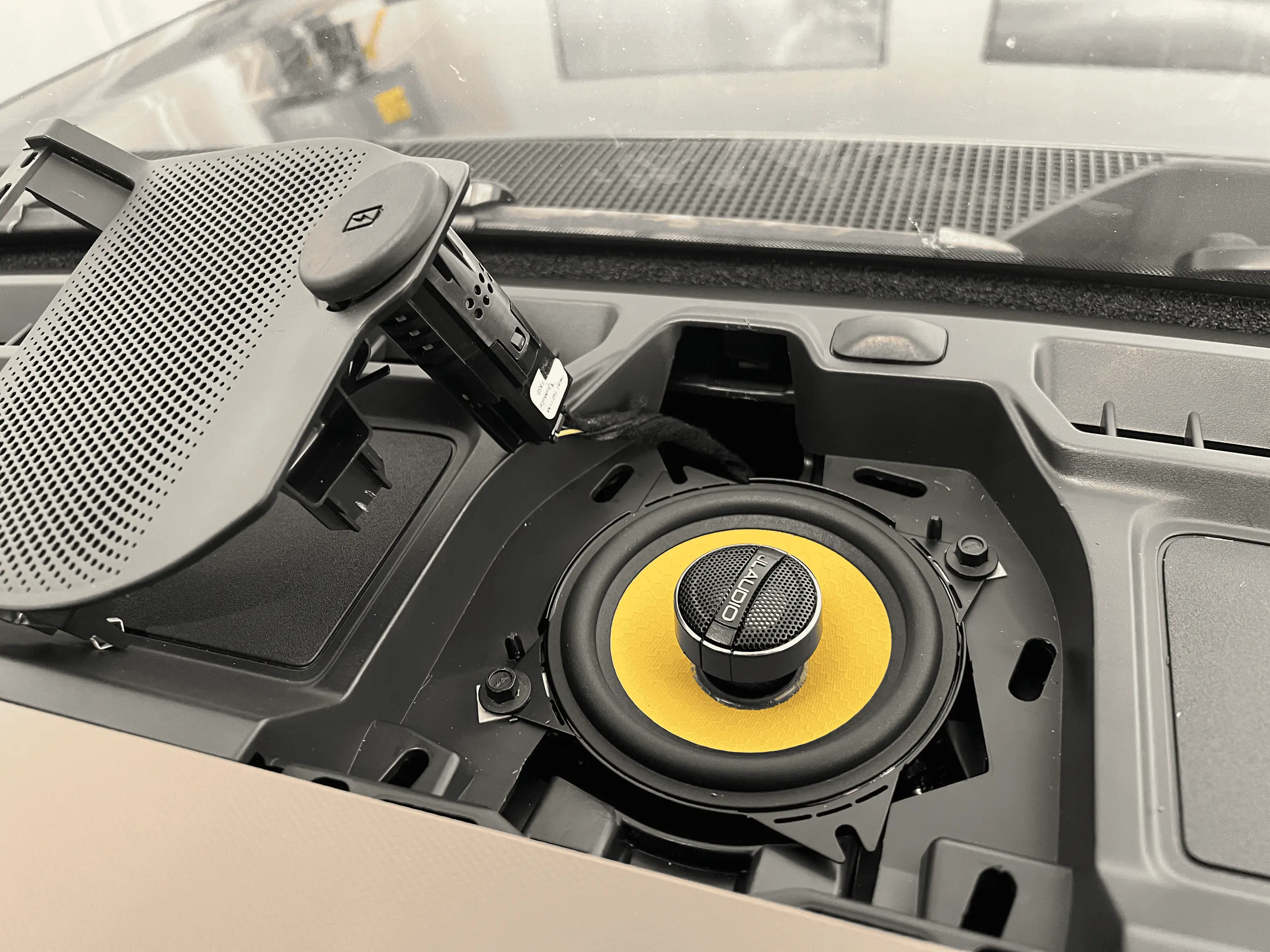

Did you have any clearance issues with the grille when you put it back on? I see where Crutchfield says this speaker won't work in the dash corners due to height. Any issue there with grille? Still got the single speaker?
Thanks!
LiftedPony
Sean
Aug 14, 2020
166
103
Irvine, CA
2021 Wildtrak 4dr, Porsche GT4, Porsche Macan GTS
Thanks!
No clearance issue, you just need to plug in the speaker to the adapter first, tuck the adapter in, and then twist the speaker from side to side until the clears the plastic edges to sit flush and screw down. No issue with new speaker touching the cover either after install.
