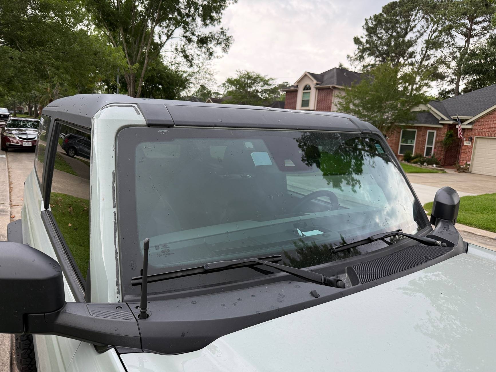

I bought this 23 model about a year ago. The previous owner had done a little modding to it I think. I was driving down the interstate recently and this A Pillar cover went flying. I didnt even realize what it was that I heard until hours later when I saw this missing. It appears from what I've been able to deduce its an aftermarket part. Anyone able to help me confirm that and and ideas as to where I can get a replacement? Thanks in advance for the help!

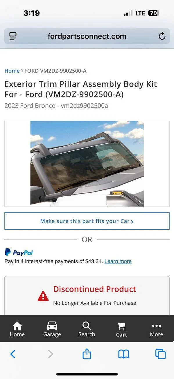

https://www.bronco6g.com/forum/thre...lar-assembly-body-kit-anybody-got-this.59427/

This isn't much condolance - hopefully you can find one someone has stashed away someplace.
But if you can't find it - you can remove the other two pieces and clean it all up. A little heat gun, a little patience with some dental floss, a little GooGone or WD40, and should be able to get all that back to factory paint.
