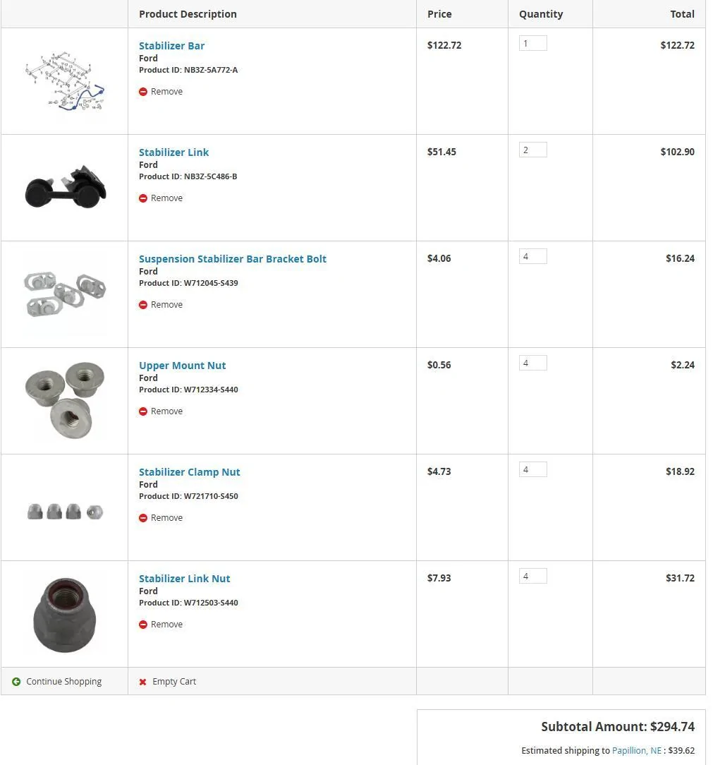

Part #s
Ford Bronco OEM Rear Sway Bar Install with Tips and Initial Impressions Bronco Rear Sway Bar Part #s

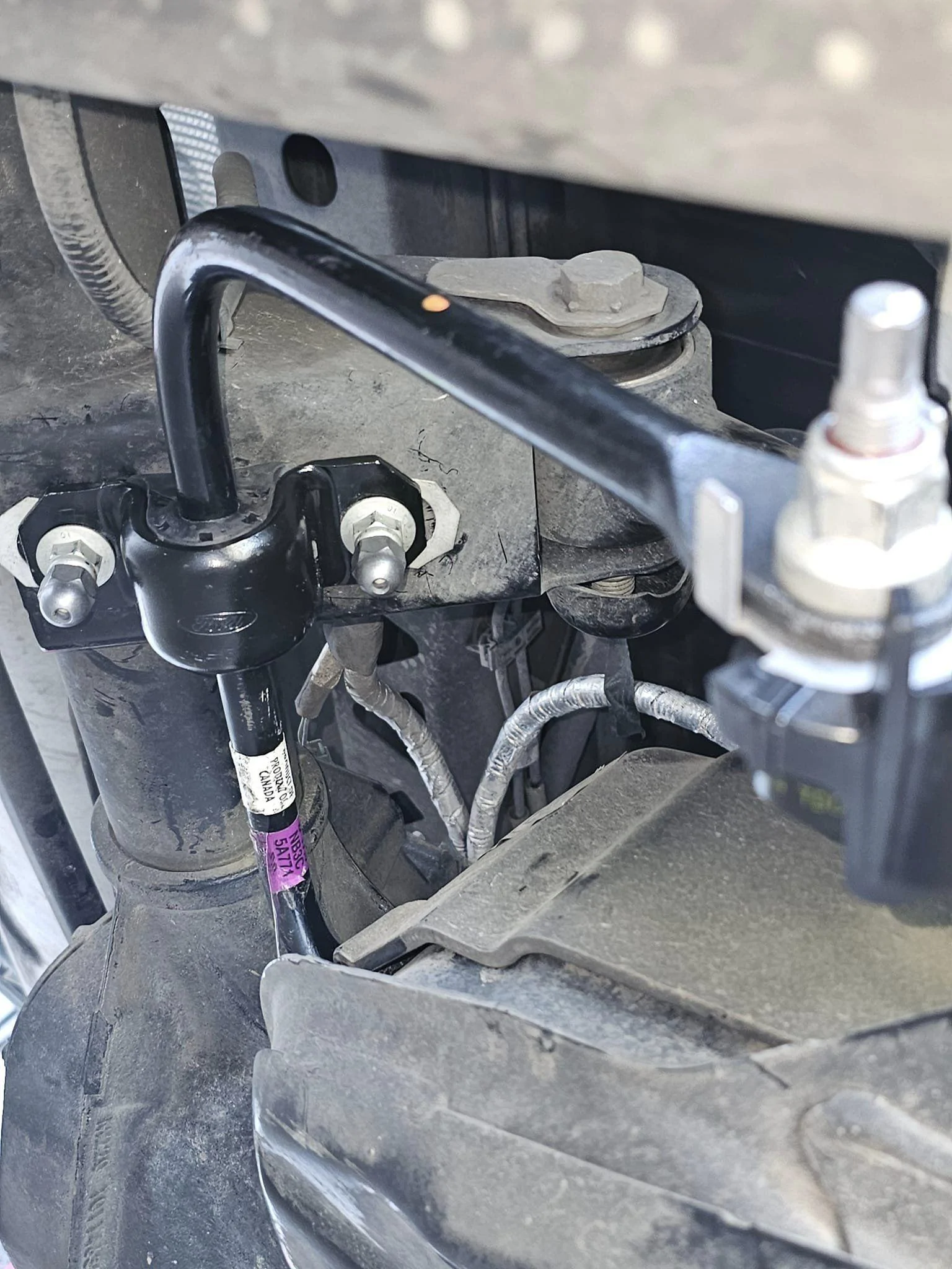

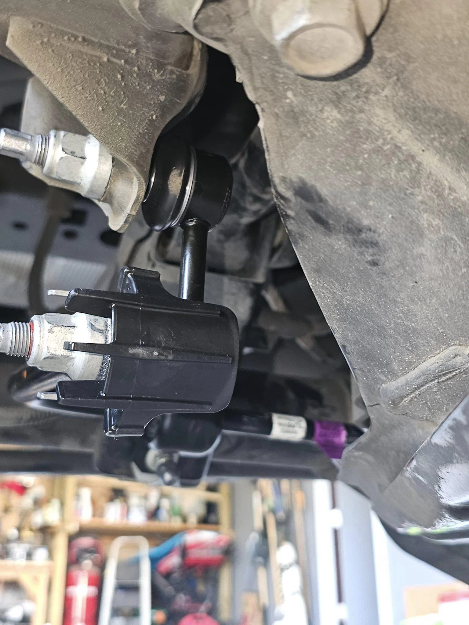

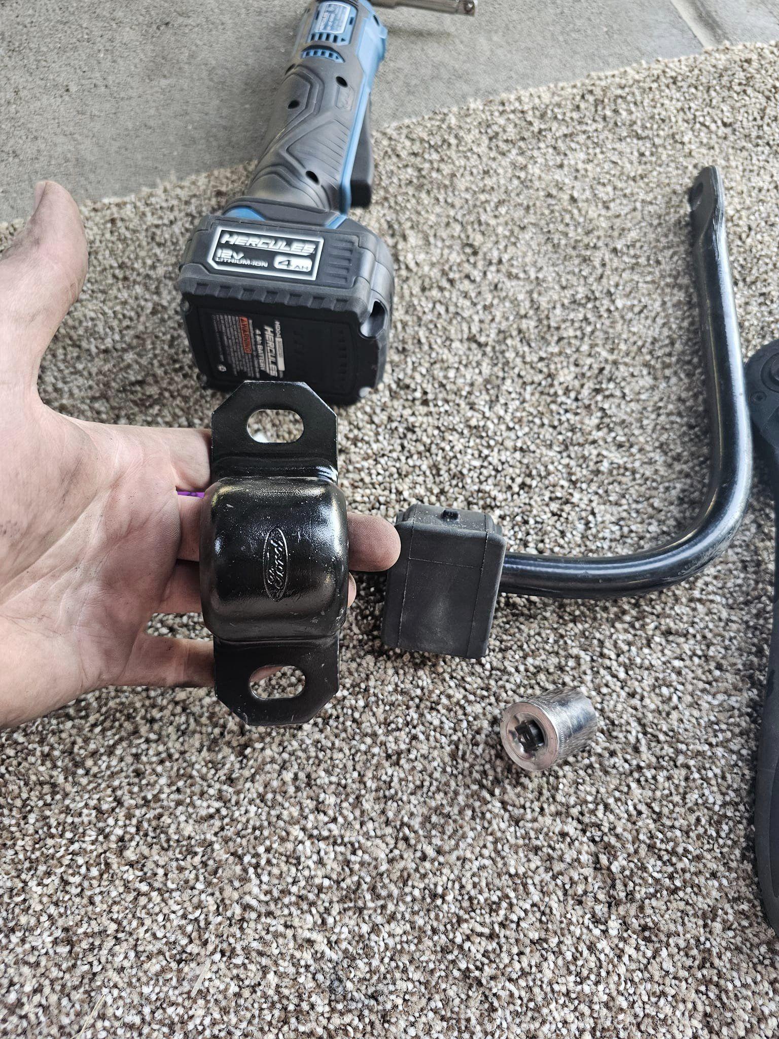

I jacked the vehicle up right to the point where the rear tires were about to leave the pavement and set with jack stands. I did not remove the tires. I really struggled to get the sway bar clamp on the passenger side past the gas tank, until I realized that the clamp could be removed by depressing little tabs that held it on.
Ford Bronco OEM Rear Sway Bar Install with Tips and Initial Impressions clam
Once I removed that clamp, I was able to muscle it over the diff and around the gas tank without removing anything else. From there it was just a matter of installing the nuts and bolts. I tightened all the nuts to be close to tight and then bounced the vehicle up and down several times to make sure it was at normal ride height before torquing down fully. I did not have the torque specs, but tight is tight. It took me about an hour 15 minutes to install, and probably could have saved the 15 minutes if I had just removed that clamp from the bar in the beginning.
Ford Bronco OEM Rear Sway Bar Install with Tips and Initial Impressions Installed 1
Ford Bronco OEM Rear Sway Bar Install with Tips and Initial Impressions Installed 2

Excellent write up and thank you for posting P/N’s and quantities!! This has been on my wish list for some time.

Thanks for the write up. I've wanted to pull the trigger on this upgrade for a while now but the consensus on here seemed to be that you needed a lift to snake the bar into position. I'm wondering if removing the clips like you suggested is the secret. Would it be possible to elaborate a little more on where you placed your jack stands and how you got the bar into position? I'm going to order the parts today.

Thanks for the write up. Part list was a bonus. Question for anyone. I have a non-sas badlands with around a 2” lift . Would I need to extend the stabilizer links 2”?
