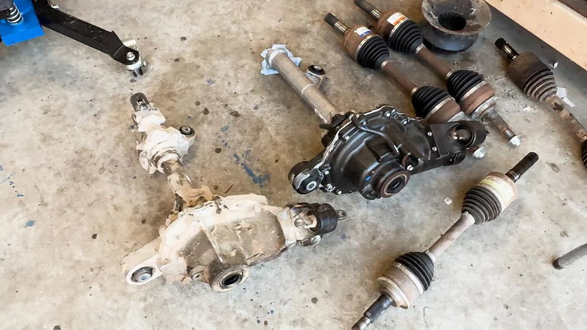

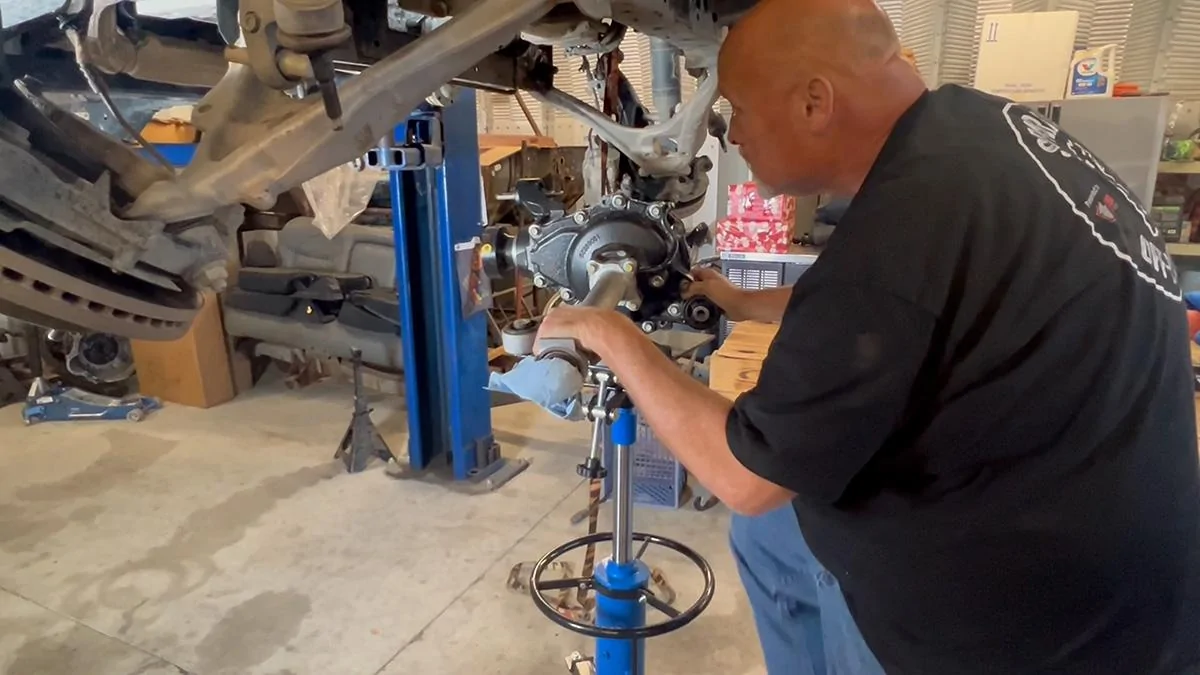

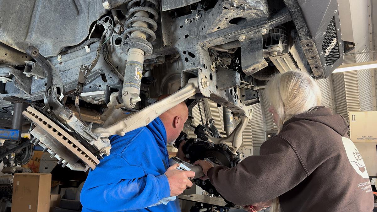

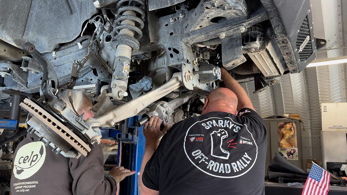

Hey guys if you're thinking of swapping your Front Drive Unit or just wondering about the work involved in doing it yourself, here's a video my wife and I just completed that documents the process. This video is part of our series on re-gearing and axle-swapping our '21 Ford Bronco Base. This video covers the process, in-depth, of removing the factory M190 Front Drive Unit and replacing it with a used or aftermarket M210 FDU. In our case we swapped in a used Badlands FDU that we had already re-geared and freshened up. But the process would be the same for those considering installing a brand new M210 FDU assembly from Ford Performance or Dana.
This is a fairly long video because wanted to capture the entire process for anyone considering doing this work themselves but might not be sure what it entails. Experienced mechanics might find it a bit basic and ponderous so it won't hurt our feelings if you choose to find something more brief to view for your Bronco entertainment. But for those considering this as a DIY project, it's all in there so grab a beer and follow along!
Ford Bronco Front Drive Unit Swap (M190 to M210) - In Depth DIY Video IMG_6791.00_20_56_48.Still001s
The tl/dw for those who would rather not take the time to watch it is that swapping the FDU is a fairly long, complicated and tedious process. I am a fairly OK shade tree mechanic but definitely not a pro, which I'm sure comes across in the video. But I'm old, fat, and bent from arthritis so if I can do it, just about anyone can. I do have a lift in my shop which makes doing something like this possible for someone like me. I myself wouldn't even attempt this job without the lift, but it would be entirely possible for someone younger and in better shape to do it on the floor with jack stands.
Ford Bronco Front Drive Unit Swap (M190 to M210) - In Depth DIY Video IMG_6791.00_18_58_46.Still004s
Two things we found out: 1) it's possible to R&R and M190 without removing the steering rack, but not possible to install the M210 without removing the rack. And 2) installing the steering rack is a MAJOR pain the butt, just from trying to shoehorn it in there with the FDU already in place. We explain the struggle and what finally worked for us, in the video, but it simply boiled down to struggling with it until it's done, with lots of pushing, pulling, prying and cussing. I'm not looking forward to doing that again, though I will have to soon because I bought the HOSS 3 rack (I didn't have it yet, when we shot this video).
Ford Bronco Front Drive Unit Swap (M190 to M210) - In Depth DIY Video IMG_6791.00_23_25_07.Still002s
In case you missed the previous installments, check out the gear swap (HERE for the thread on this forum, or HERE for the YouTube video) and the rear axle swap (HERE for the thread on this forum, or HERE for the YouTube video). The next one will cover buttoning up both ends, installing ProCal to defeat the FAD delete issue, wiring up the locker switches etc.
