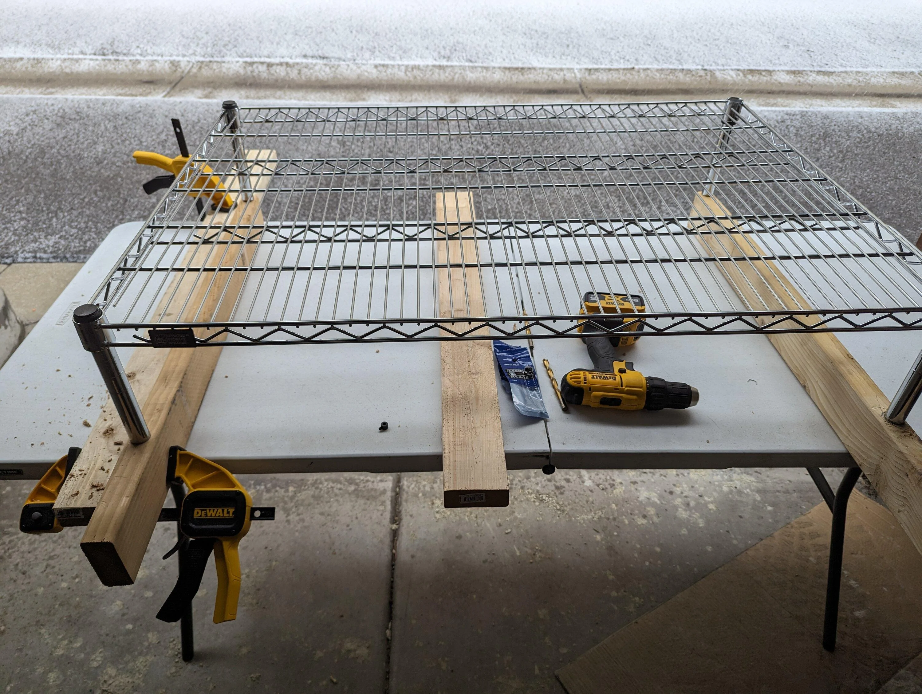

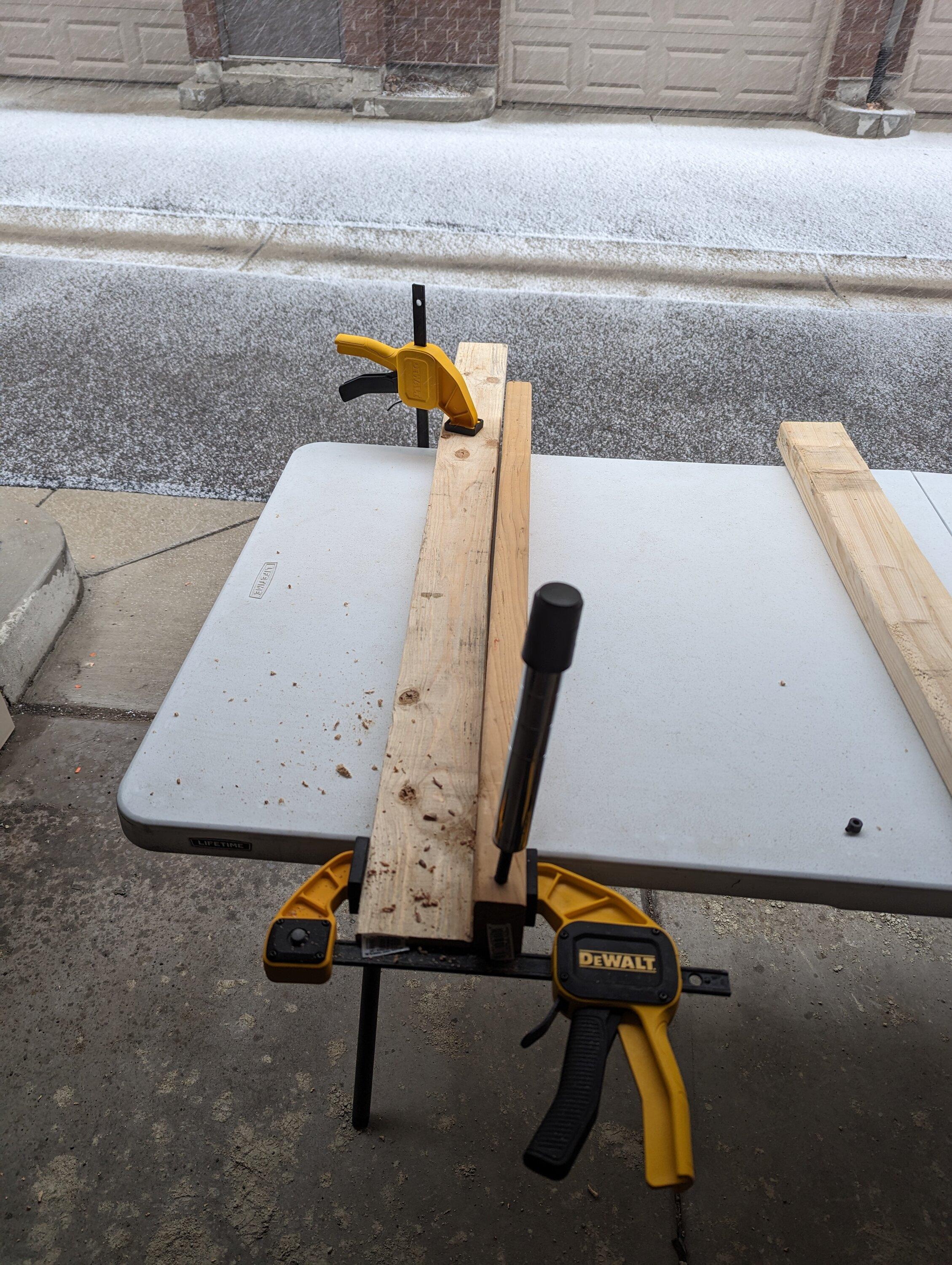

I used some 2x4's and 2x1's and bought some clamps (can never have too many of those) and a hand saw. I some 3/8" diameter hangar bolts (i.e. double-sided screws - one end is a machine screw, one end is a wood screw) to screw into the wood and then have the other thread into the legs for the wire shelf. This would work a lot better with a drill press, obviously, but I was able to use the clamps to at least keep the holes I was drilling somewhat-kinda square. Thankfully the wire shelving system is very tolerant of the legs not being precisely vertical. I used vertical 2x4's as runners down the side to mount the hangar bolts and shelf legs in. It's perhaps a bit high, but I can always shorten the metal shelf legs if needed or move the shelf down on them. I also cut out some notches in the boards to fit them over the seatbelt attachment points on the side (there's another stud poking up there, so even if you detatch them, you'd still need the notch).

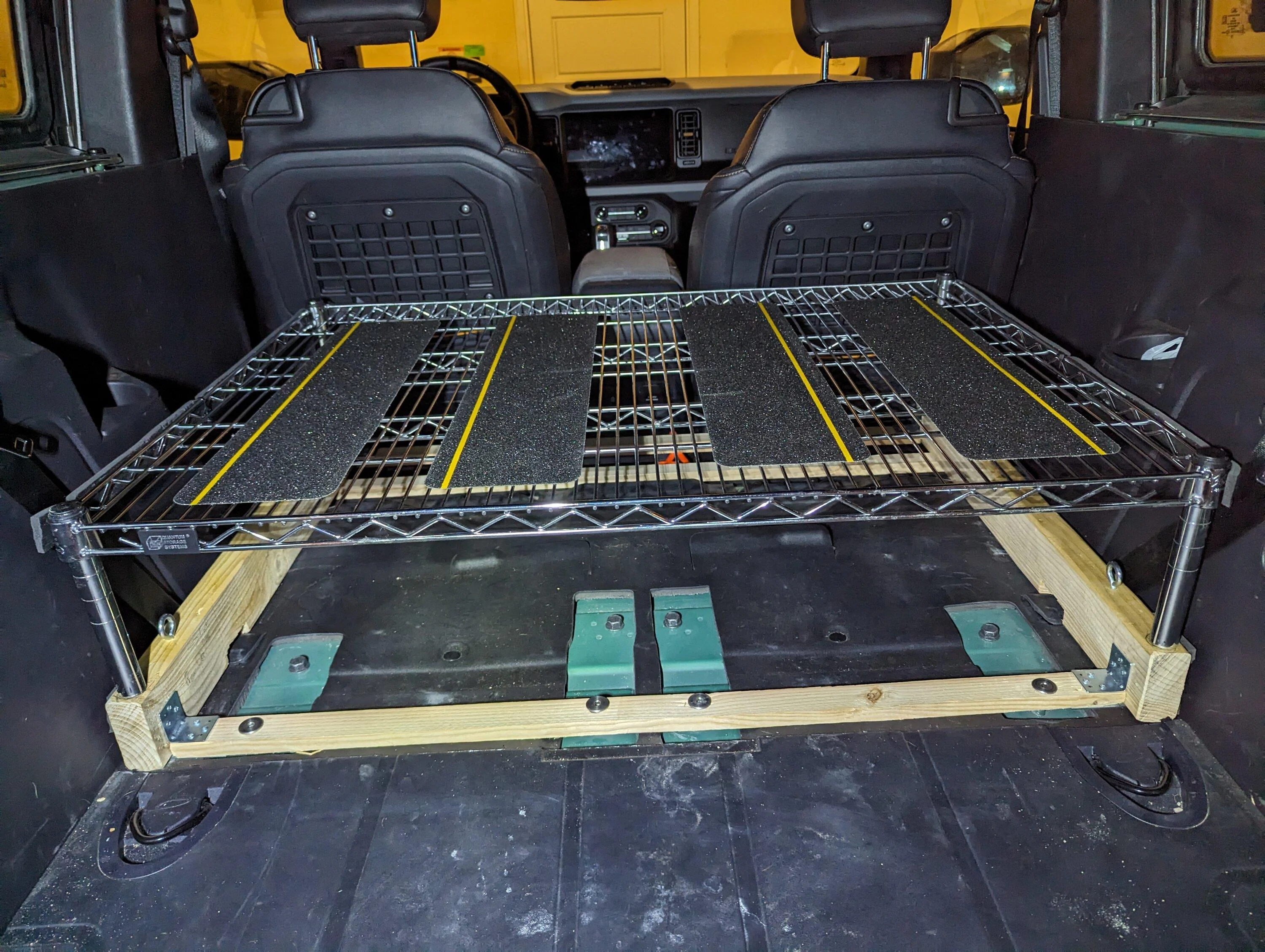

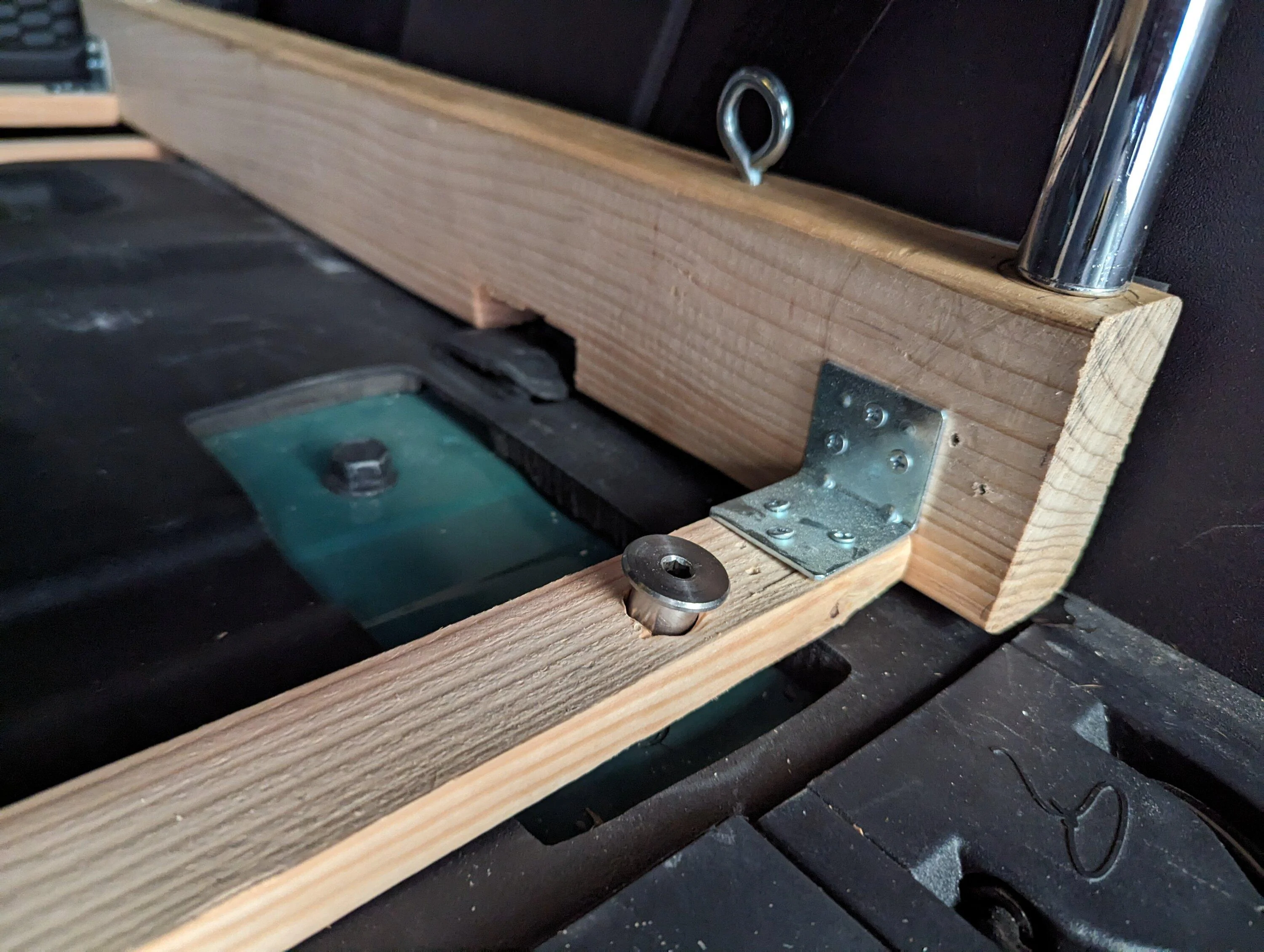

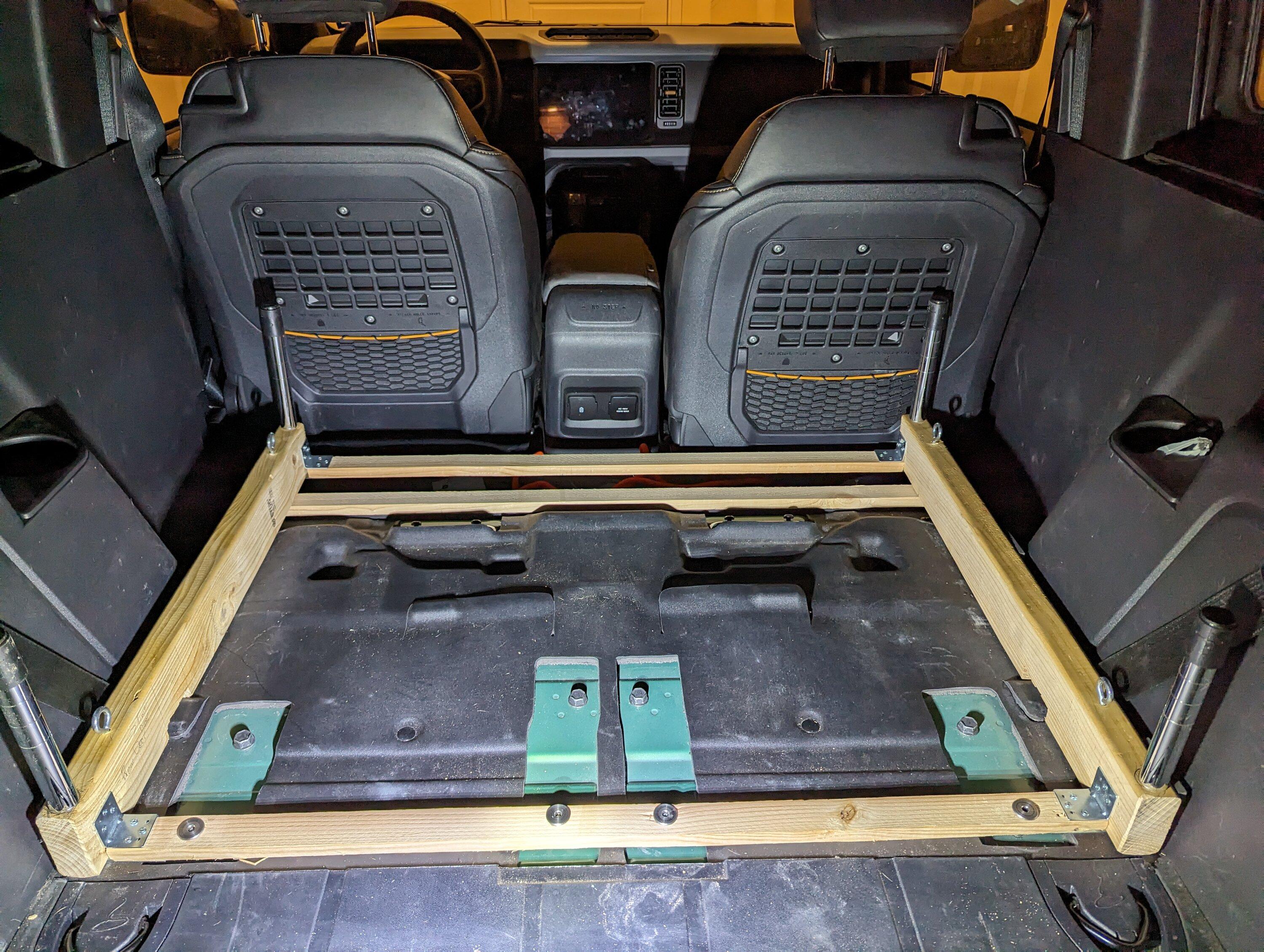

I was able to find some sleeve nuts in the right size to bolt onto the threaded studs that come up from the floor as part of the seat mounts. If you can't find them locally, they're these: https://belmetric.com/ultra-low-profile-allen-sleeve-nut-stainless-steel/?sku=NSLEEVE12LOWSS The nuts were key because they allow mounting the base via a 1x2 going across and still have things essentially flush with the top of the board. The board makes a nice "lip" to keep boxes from being able to too easily slide back while still being low enough to be able to fit a 10" high crate beneath the shelf. I coarsely located the hole locations by assembling the shelf with the 2x4 runners, cutting a 1x2 to the right length to fit inside, inking the top of the studs with a sharpie, and pressing the board down. I knew I couldn't get things too precise with a paddle bit, so I drilled it, then used a dremel tool (hand rasp would have been fine, but I had the dremel with me for other reasons) to smooth things out and expand the holes in the wood as needed to make the nuts thread on. E.g. here's one that's not yet screwed down just to give a sense of it:
Ford Bronco DIY rear seat delete shelf solution for our dog PXL_20240411_011232826

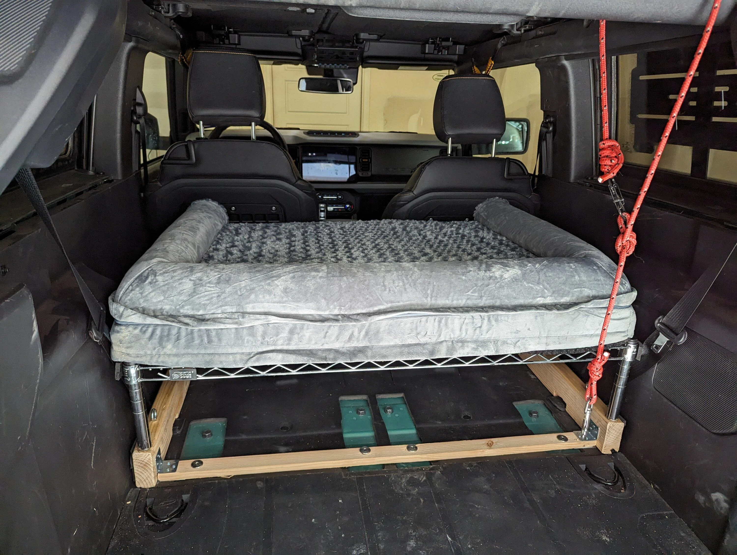

In the end, the base mounted nicely. I added a "dropped down" 1x2 on the back to give some support right before the higher portion of the back ends (there's a bit of a ledge it fits on quite well). I then added some foam tape along the sides and on the bottom where needed. That hopefully will help avoid scuffs when removing the platform and also if it wiggles side to side a bit under load. I also put on some stick-on traction strips for steps to keep the dog bed from sliding around, as well as some eye bolts in the runners to strap down crates if I need to.
Ford Bronco DIY rear seat delete shelf solution for our dog PXL_20240411_040146879
Ford Bronco DIY rear seat delete shelf solution for our dog PXL_20240411_040323490
The dog bed fits nicely and it appears Copper approves! He likes being higher up for sure. I have been clipping him to a rigged up leash around the roll bar, which keeps him from climbing into the front seats and avoids him jumping out if we don't want him to. He seems to like the setup, anyway! I'm quite happy with it. We'll see how the plastic shelf mount sleeves around the metal legs hold up to rattling around. They're cheap and easy to get, though, so if I have to replace them now and again, it's no big deal. Things seem very solid and way more than strong enough to support an 80lb dog (the shelf is rated for 800lbs, though I would not want a ton on it in a car - static vs dynamic loads and all that).

Yeah, exactly. He's clipped to the roll bar and he's wearing a harness when he's in the car. The leash currently isn't strong enough for an actual crash, but it's enough to keep him from flying forward if we slam on the brakes (or, more commonly, keep him from trying to climb into the driver's seat because he wants a better view).
You can get a sense of it here:

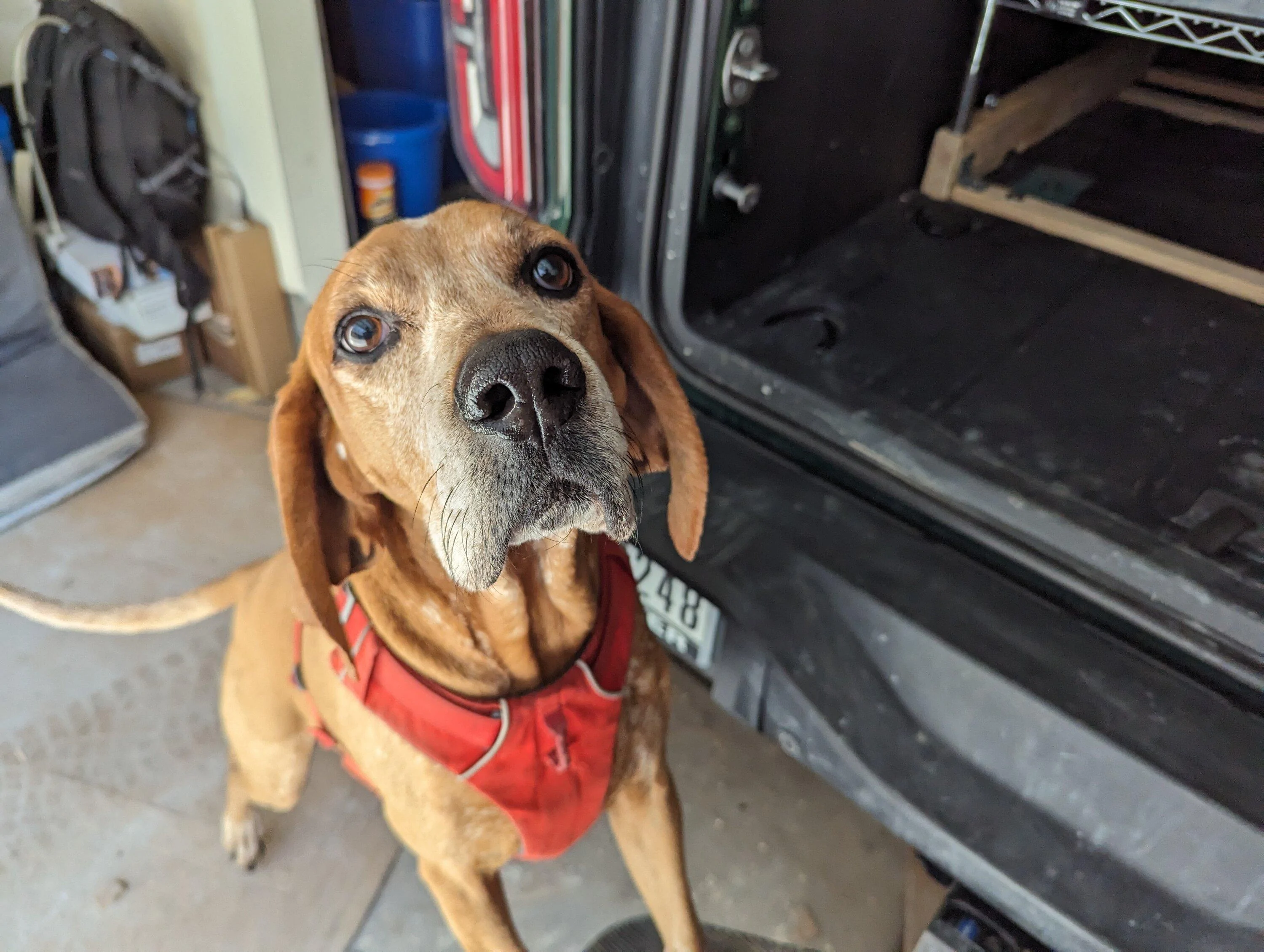

If anyone's curious how this has held up, last weekend I finally had to replace the plastic clips that go around the vertical posts to hold the shelf up. They do wear out from bouncing around. But 2 years is a long enough duration for me, and I have extras around regardless.
