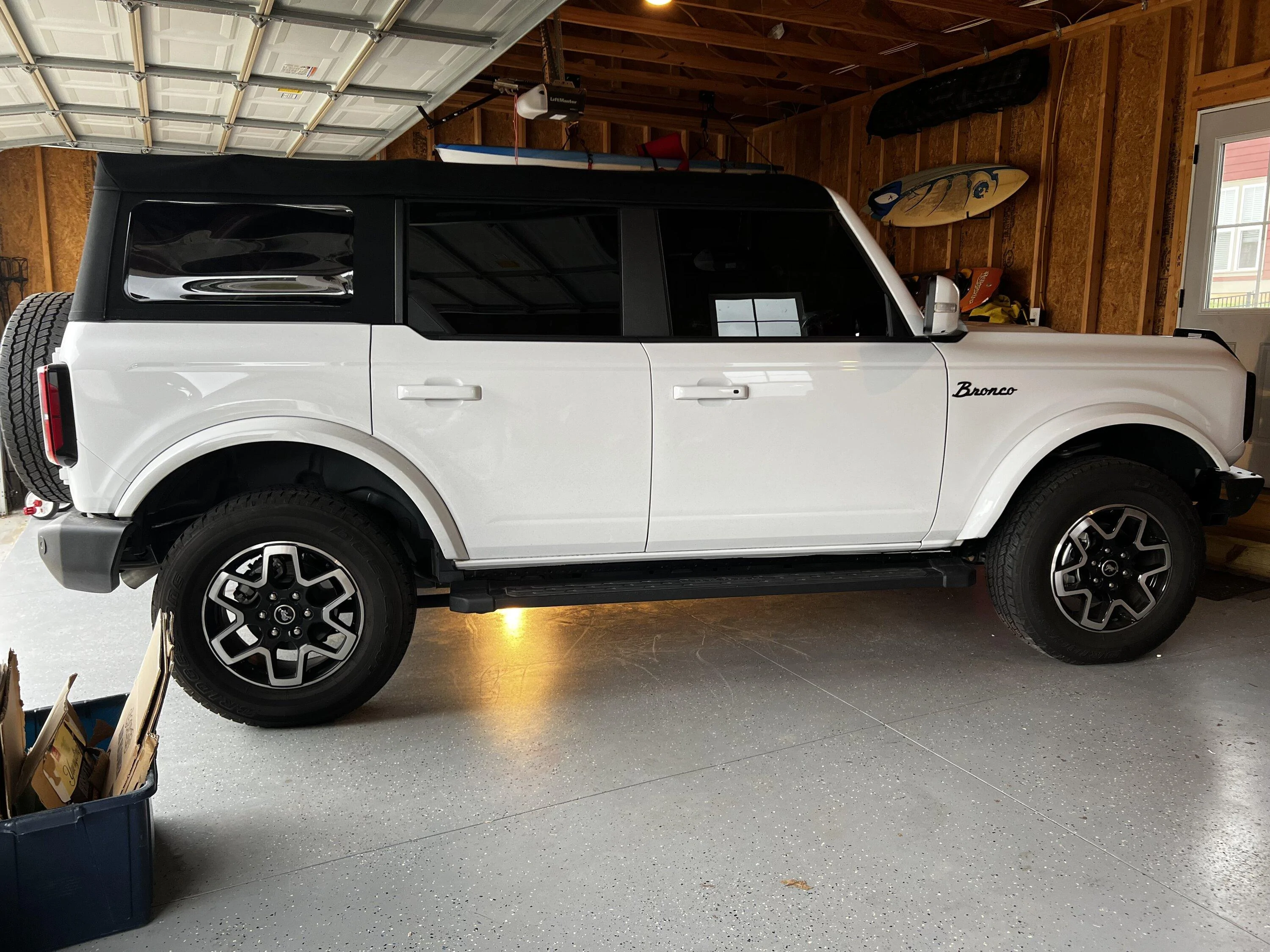

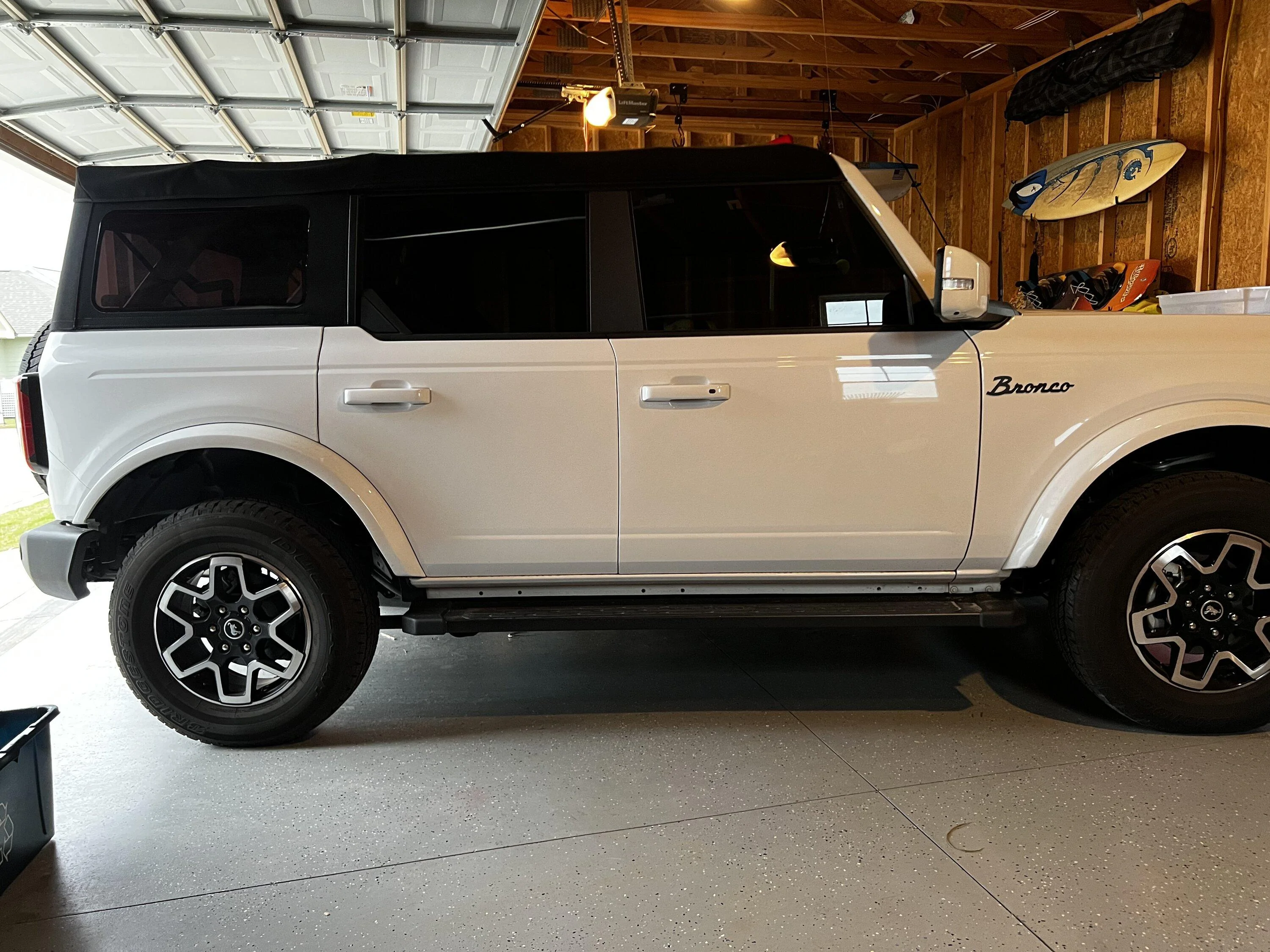

After searching for solutions that didn’t break the bank (ie. $269 Ford Trail Armor 🙄) I decided to experiment with some Plasti Dip.
- Is it perfect.. no
- Did it cost $269.. no
- Did the pinch weld disappear.. yup
Disclaimer - would it wear down over time off-roading, probably. But for now, it works. Hope it’s helpful for anyone else out there

How did you protect the paint above?
I realize the step below isn't as crucial, being black and all.
VAtruck
Mar 14, 2025
210
252
I masked the underside of the rocker with blue painter's tape, slid half sheets of paper between the back side of the pinch molding and the rubber lip of the running boards, and painted the pinch weld with a brush and semigloss Rustoleum. That's the way they did it on cars back in the 1960's Came out pretty nice:

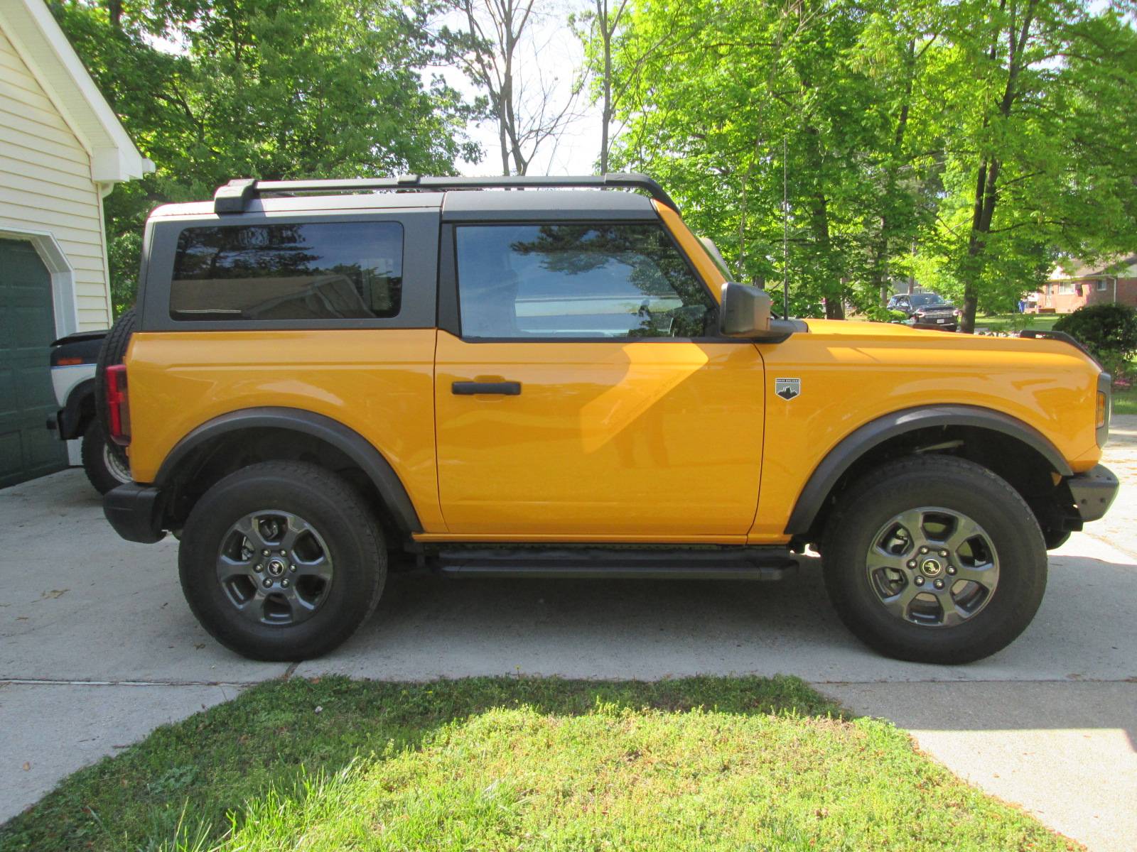

Finally had a chance to do ours this morning and it now looks much better.
