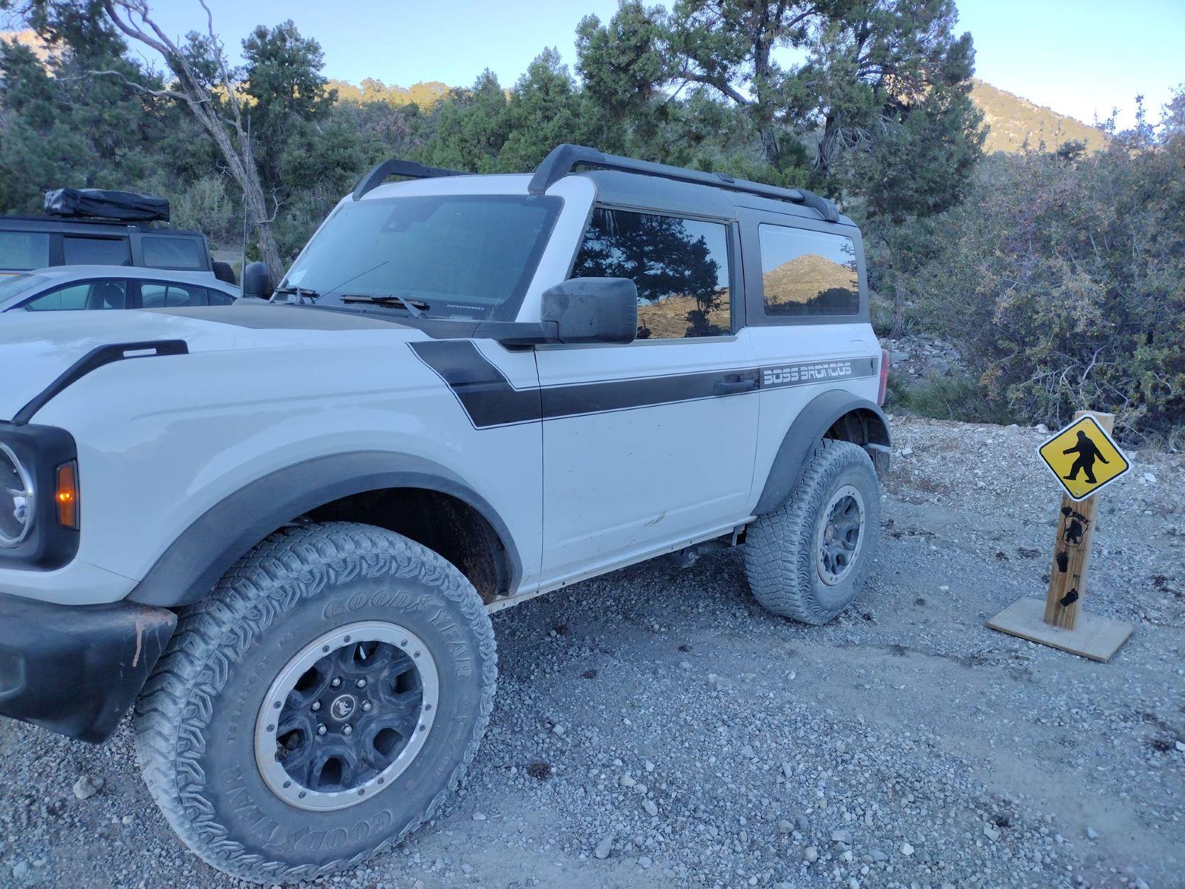

Window tint and graphics by Rapid Wraps & Tint in Hemet, CA.
Ford Bronco BOSS Bronco Build - 2 Door BaseSquatch 2.7 311662506_100505152863993_4948507975572350238_n

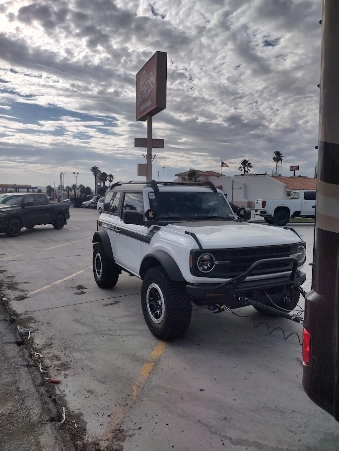

Also the first time flat towing:
Ford Bronco BOSS Bronco Build - 2 Door BaseSquatch 2.7 IMG_20221011_132638950_HDR

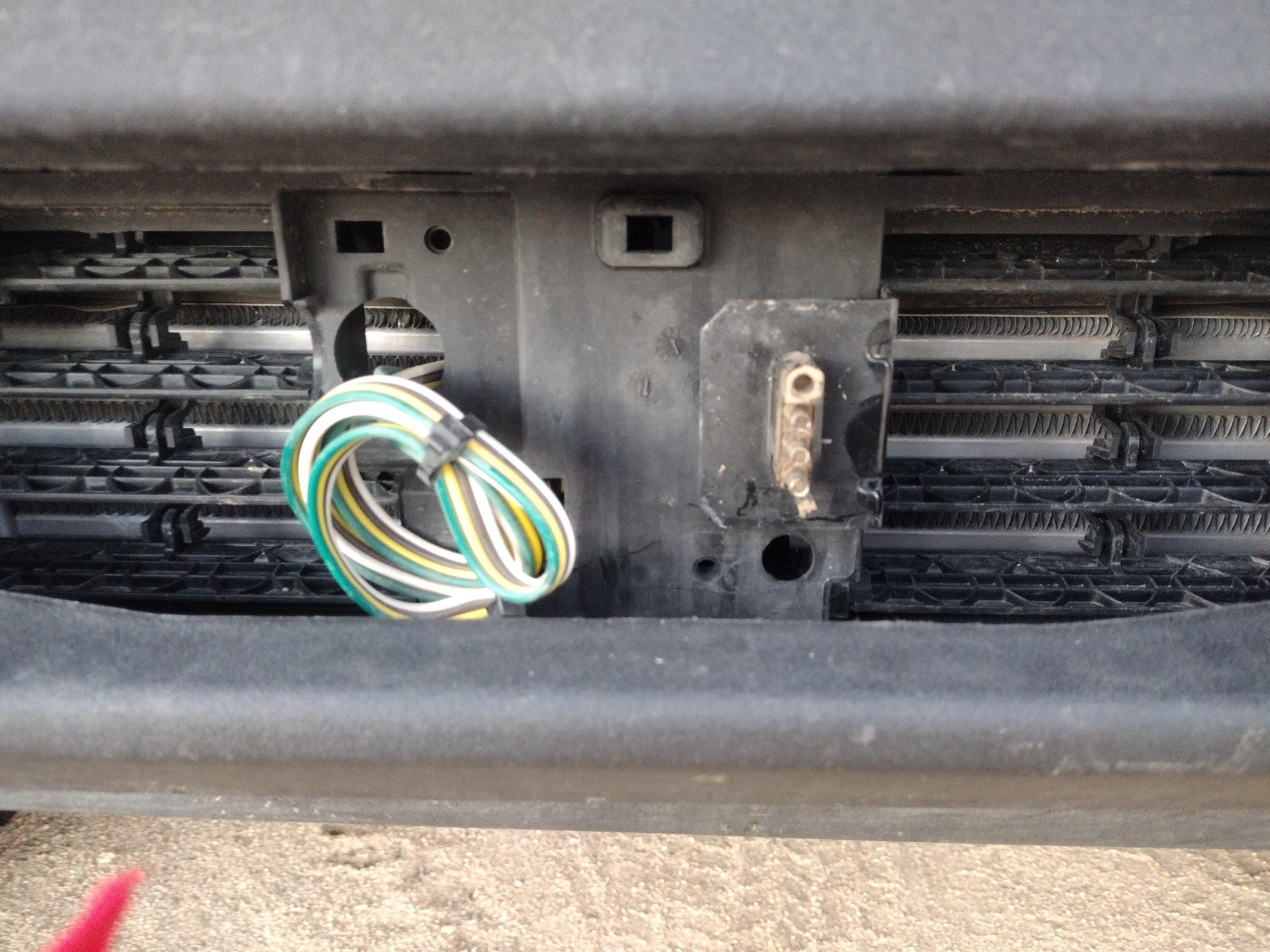

We used the Blue Ox Alpha 2 system with base plates for the stock plastic bumper, and we also installed the Curt wiring kit for non-LED taillights, as well as a Curt receiver hitch for the back to load the bike rack.
I can provide more details on the components if need be. We have since changed out the front bumper and have removed the base plates, opting to use adapters for the recovery points instead (more info to come). The base plates had protruding tabs for the safety chains that got bent up easily.

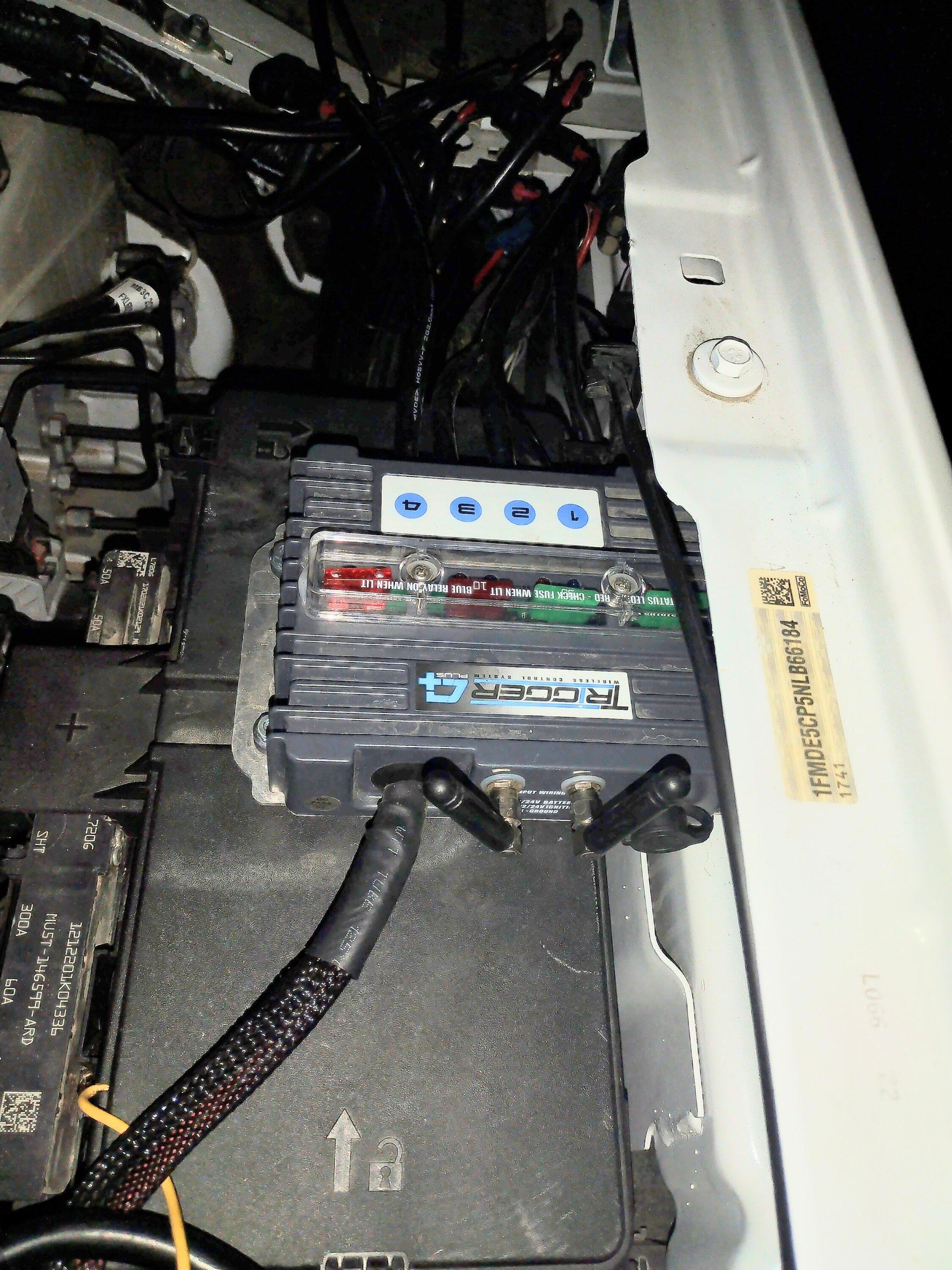

Here is where we ran the wiring to in the front (behind the removeable black plastic box), 4-pin connector with excess wiring zip tied.
Ford Bronco BOSS Bronco Build - 2 Door BaseSquatch 2.7 IMG_20230208_172212971

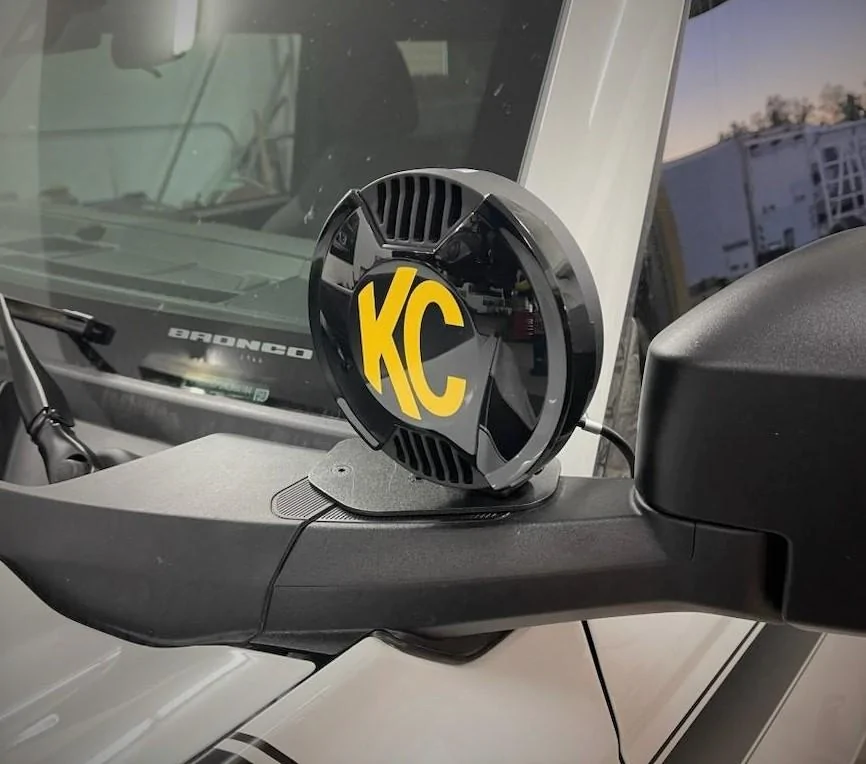

Only mod this month was adding the KC Slimlite Ditch Lights, and the ACC Trigger Controller since we missed the Aux Switches when we ordered! We went with the KCs for a retro look and the ACC controller made wiring easy, with remote switches so no need to run wires through the firewall. Only thing we added was a mini fuse splitter to tie it into the fuse box to an ignition controlled fuse (I think we used the USB charging port fuse).
Ford Bronco BOSS Bronco Build - 2 Door BaseSquatch 2.7 ACC
We developed low profile, more secure mounts with countersunk bolts for a smooth finish!
Ford Bronco BOSS Bronco Build - 2 Door BaseSquatch 2.7 KC5-0100-7
We originally were going to use Diode Dynamics lights, but liked the look of the round KCs with the Bronco's round headlights.

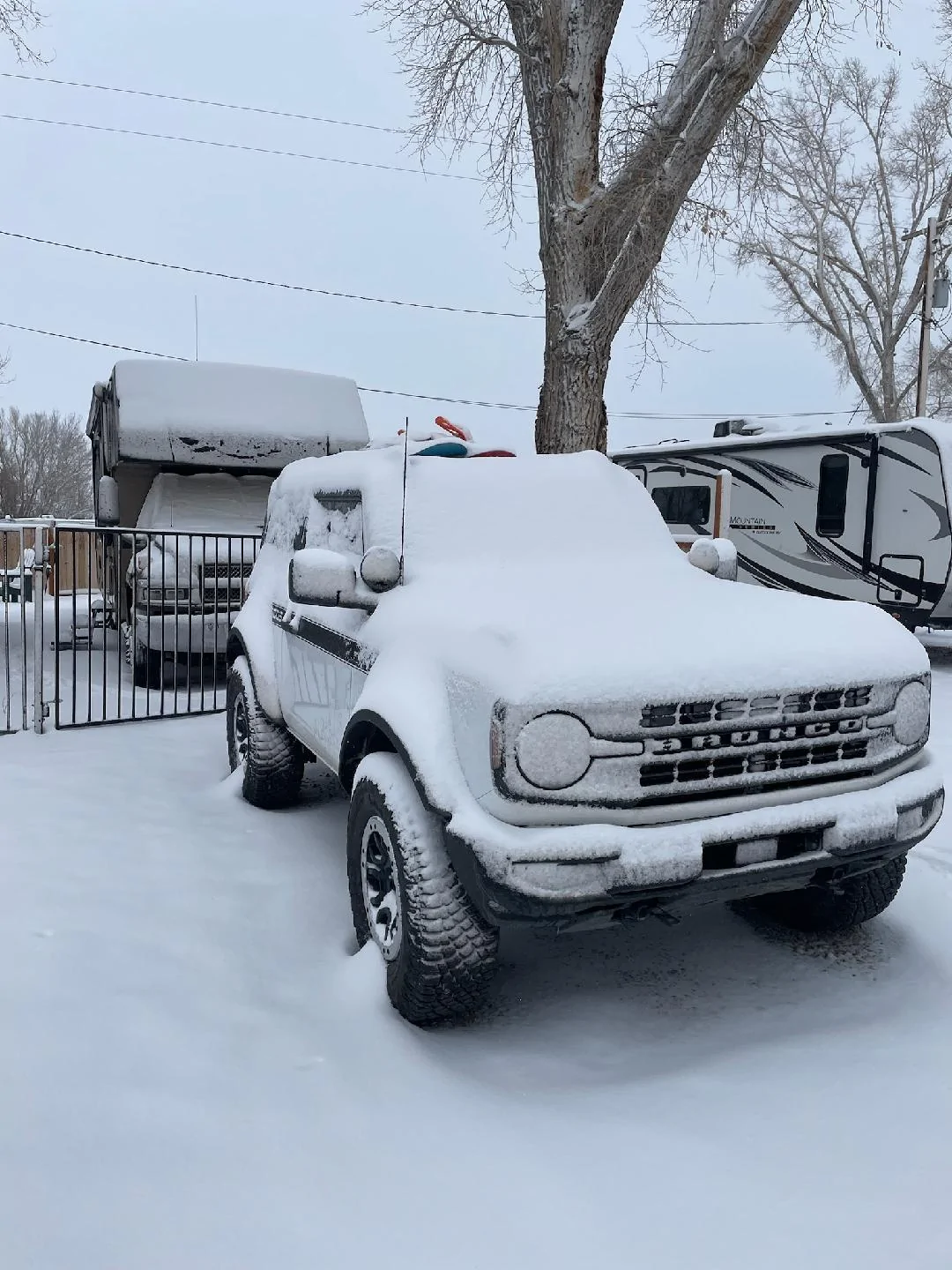

Trip to Utah for ski week towing the Bronco. Ended up leaving the motorhome and driving the Bronco back to So Cal due to all the snow! Went back 3 days later for the United by Bronco event.

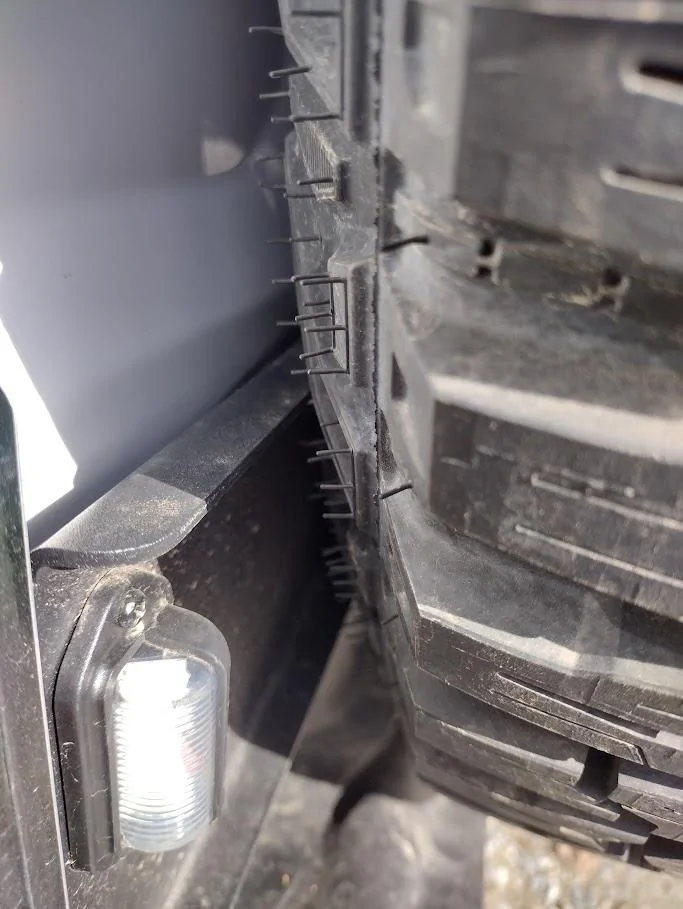

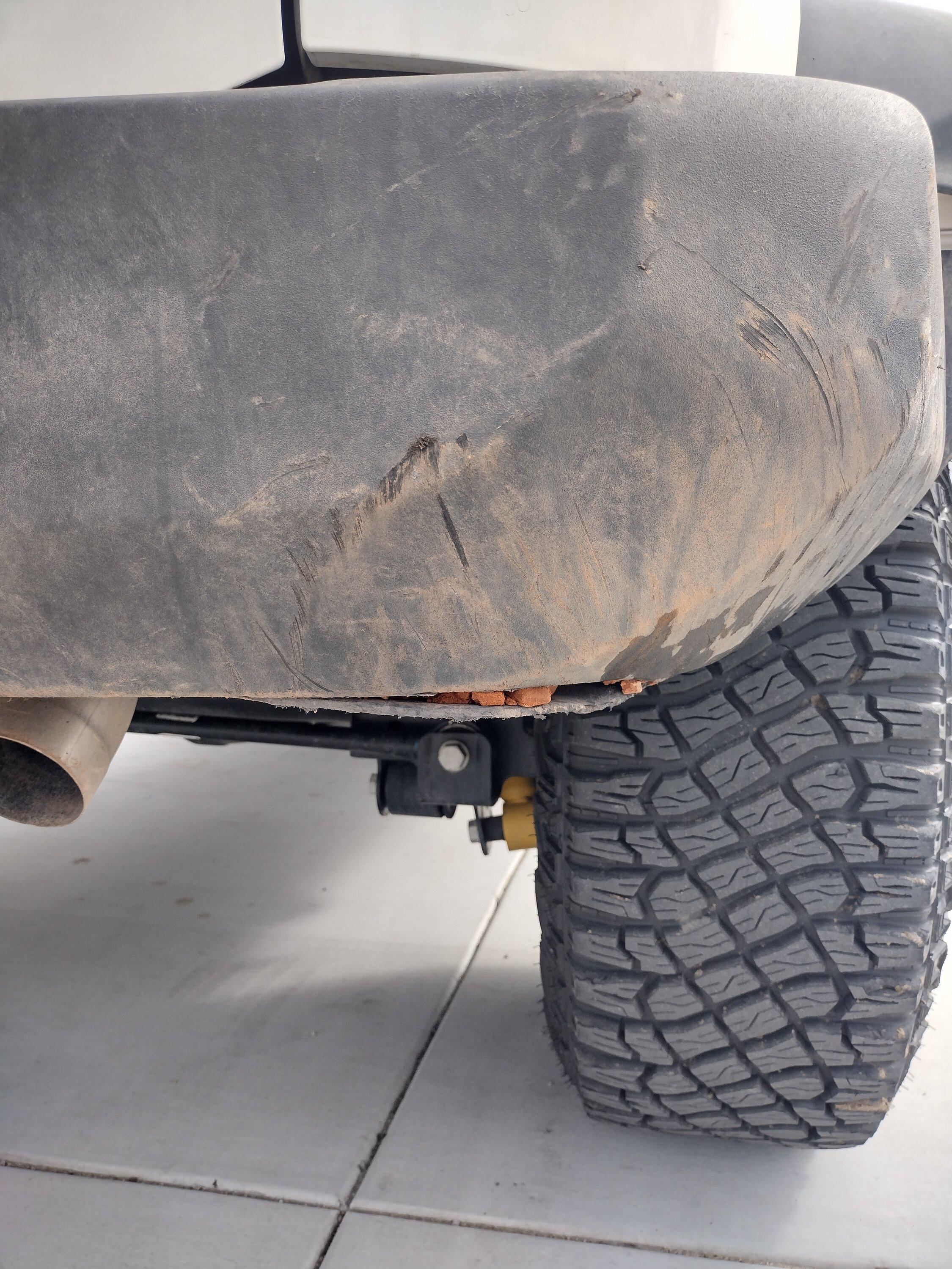

Stock rear bumper damage on the Toll Booth obstacle with some red rock souvenirs!
Ford Bronco BOSS Bronco Build - 2 Door BaseSquatch 2.7 IMG_20230306_143935581_HDR

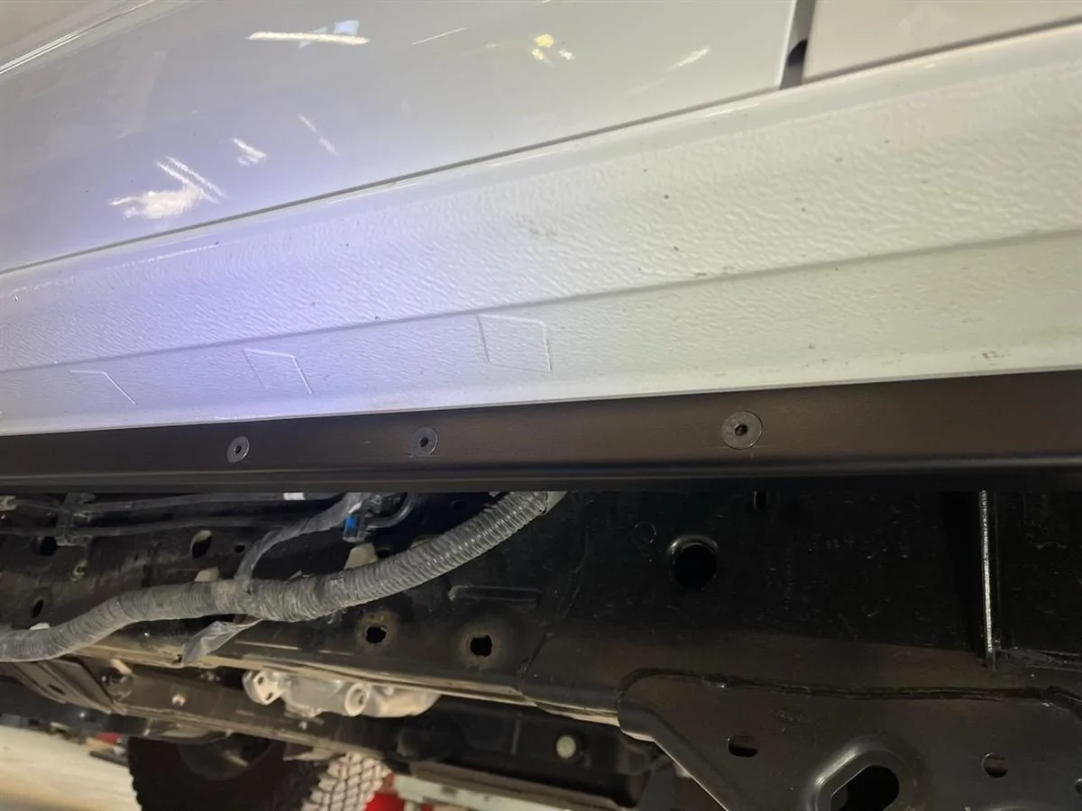

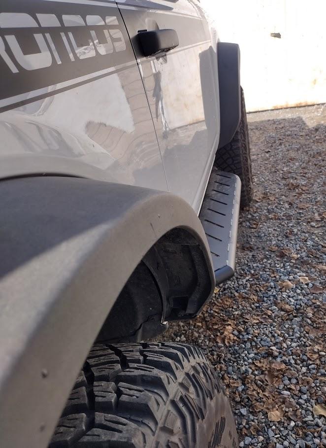

Still didn't have rock sliders, but did get some pinch weld guards on:
Ford Bronco BOSS Bronco Build - 2 Door BaseSquatch 2.7 BB2-PWG-2
Countersunk black zinc plated bolts for a smooth finish and corrosion resistance. They wrap underneath for some added protection.

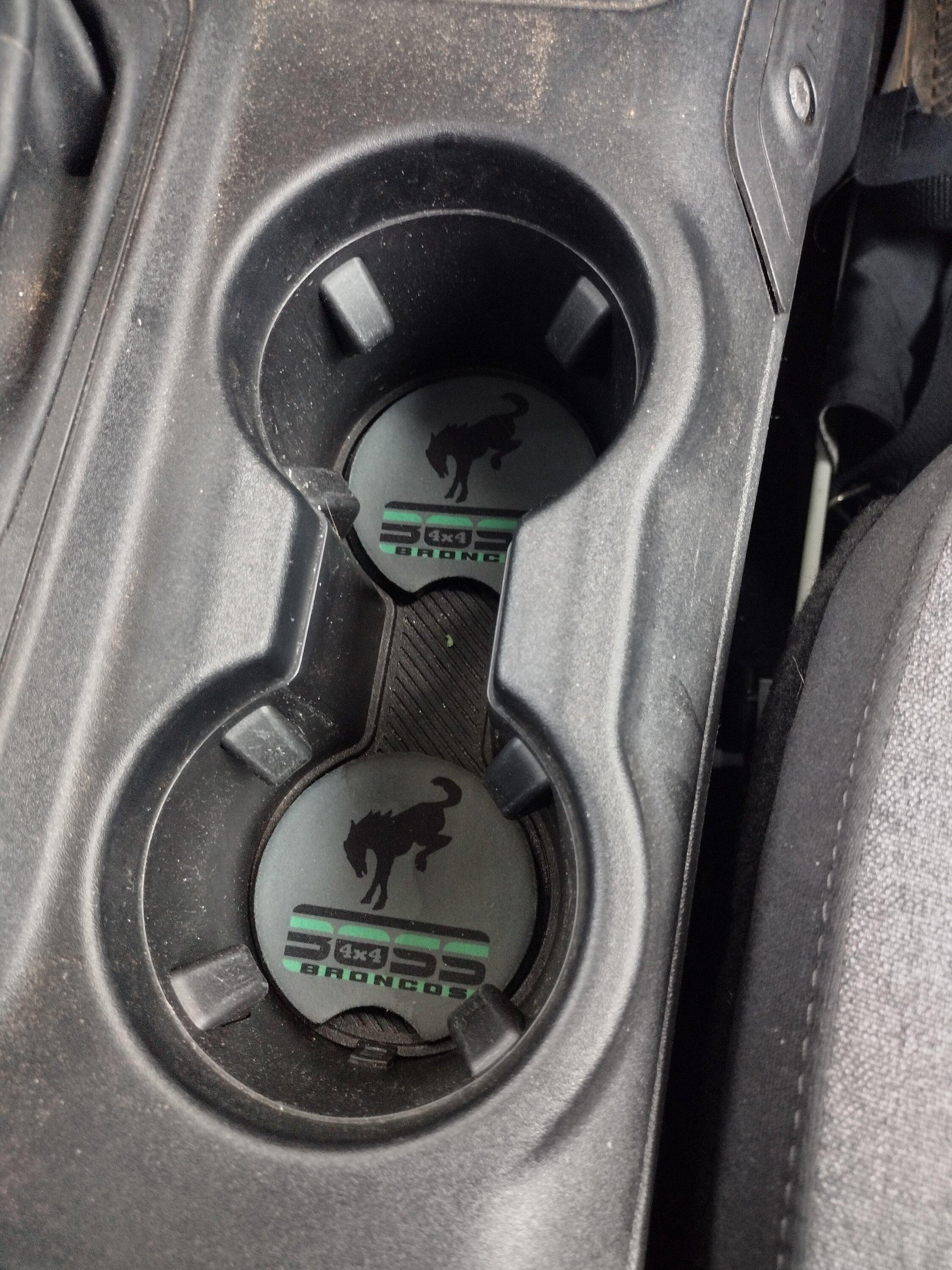

We also had these cup holder inserts made for event give-aways!
Ford Bronco BOSS Bronco Build - 2 Door BaseSquatch 2.7 IMG_20230306_160615886_HDR

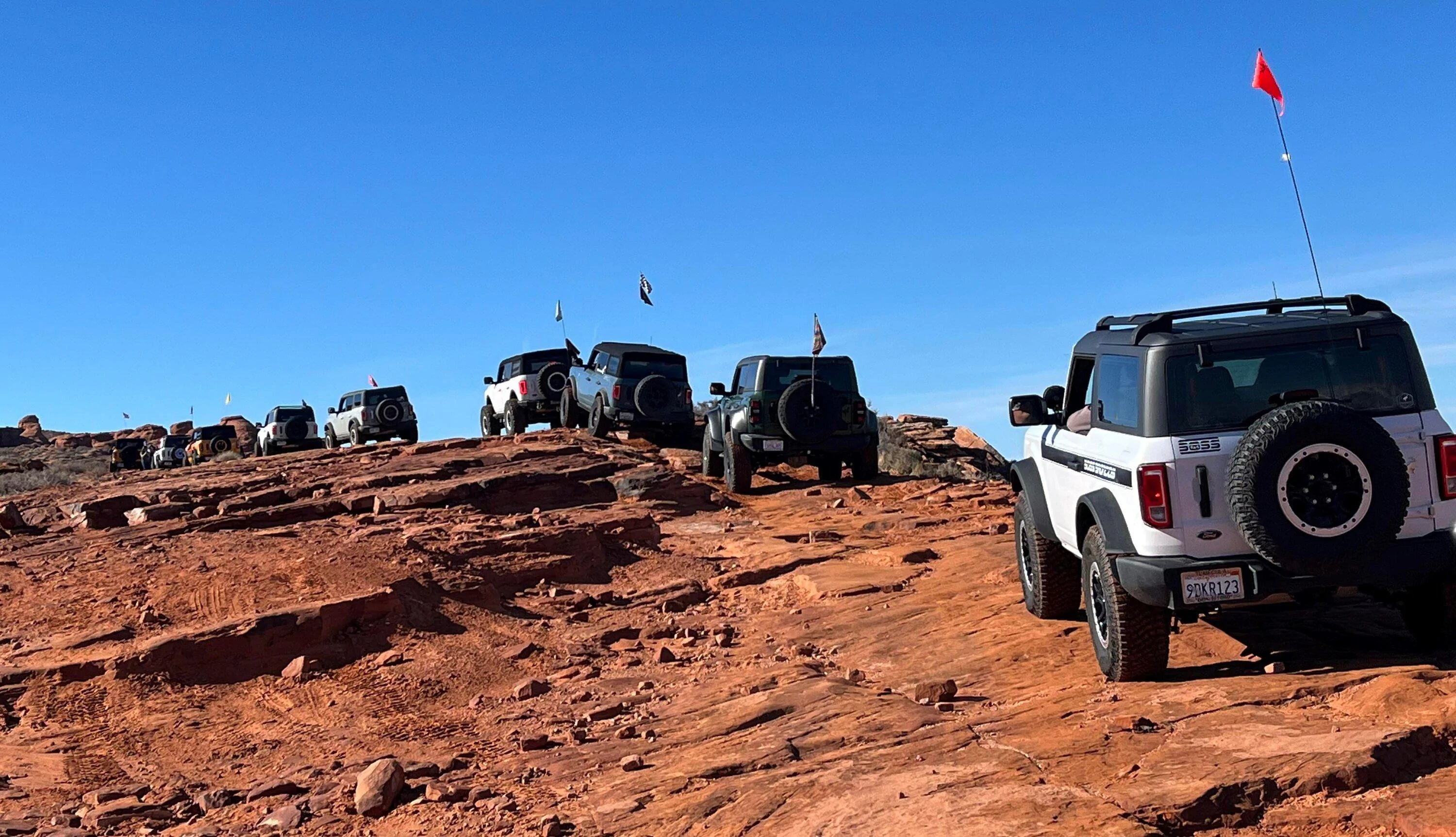

Bronco Safari in Moab UT was epic!
Towed the Bronco there!
Ford Bronco BOSS Bronco Build - 2 Door BaseSquatch 2.7 IMG_20230503_125642265

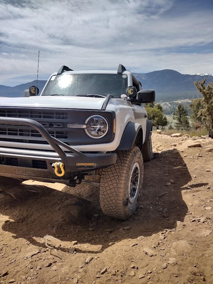

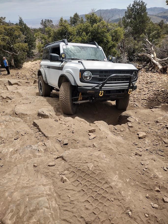

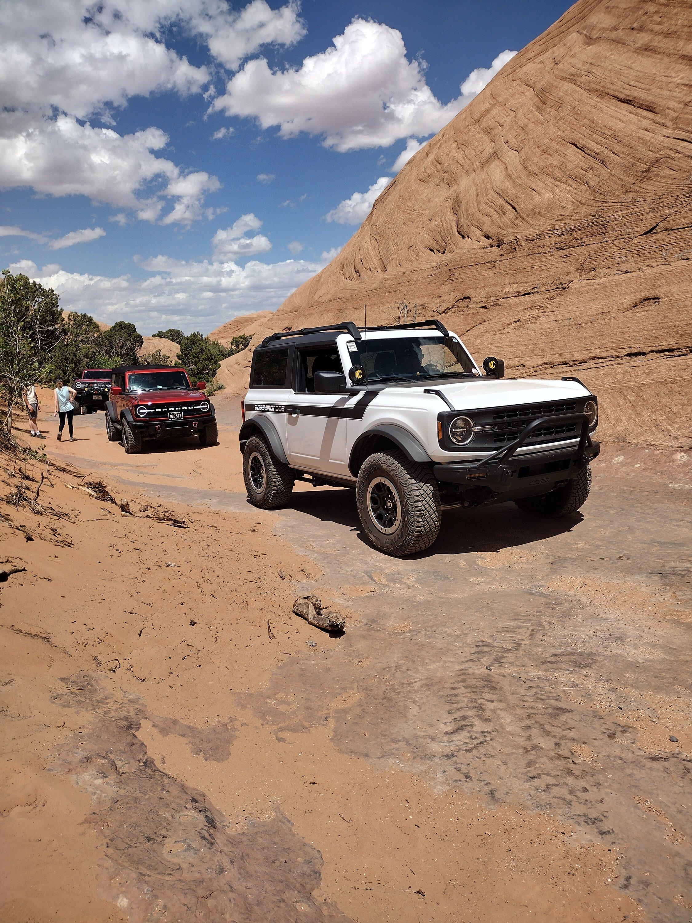

Swapped out the stock plastic base front bumper for a 4WP bumper ($500 scratch & dent special!) The Rigid fog lights cost almost as much as the bumper!
Ford Bronco BOSS Bronco Build - 2 Door BaseSquatch 2.7 IMG_20230504_122938168_HDR
Ford Bronco BOSS Bronco Build - 2 Door BaseSquatch 2.7 IMG_20230504_100927855

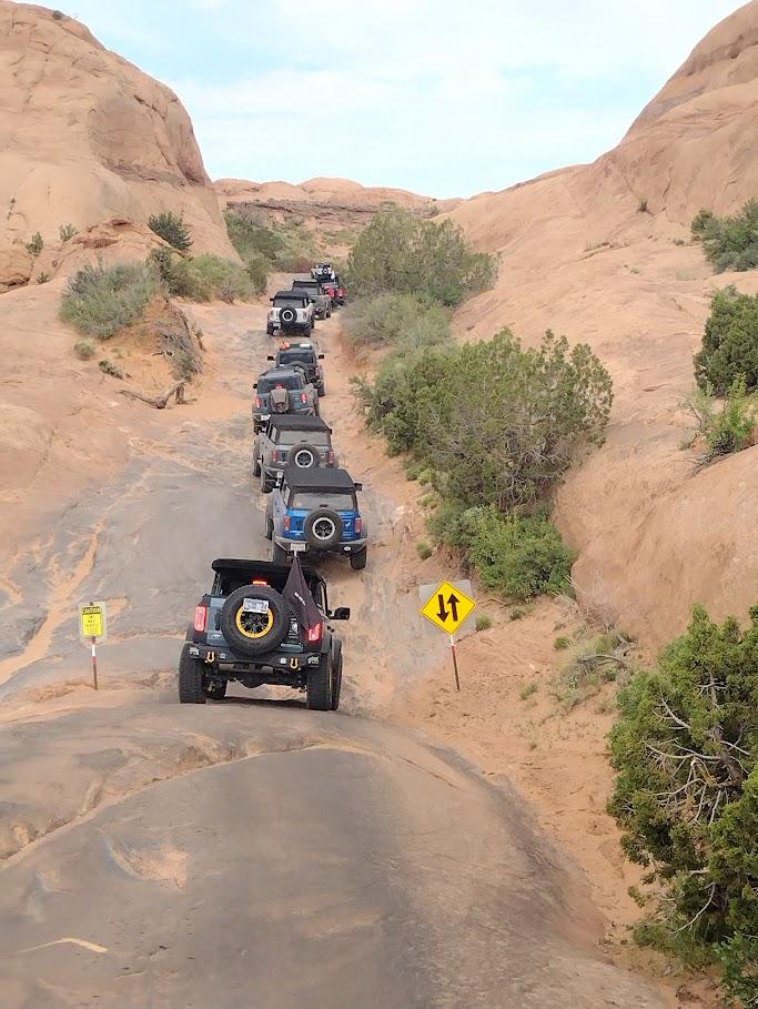

Day 1 - Hells Revenge:
Day 2 - Steel Bender:
Day 3 - 7 Mile Rim Ladies Run:

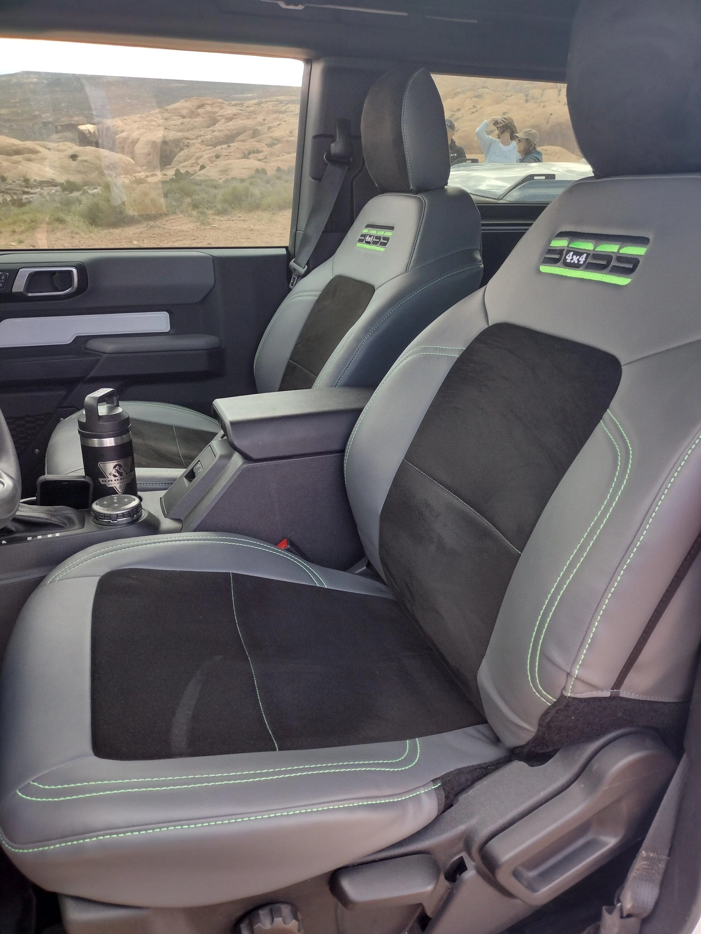

Also added custom PRP Seat Covers:
Ford Bronco BOSS Bronco Build - 2 Door BaseSquatch 2.7 PRPInstalled
Fully customizable! You can pick the colors, materials and stitching! Perfect fit and high quality. We opted for marine grade vinyl outer with suede in the middle seat area. It was easier to install by removing the seats.

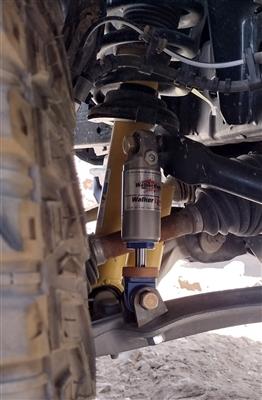

Trip to Calico near Yermo, CA to test a new product and meet up with Dusty & Steph of So Cal Broncos in their white 2-door base Chanel!

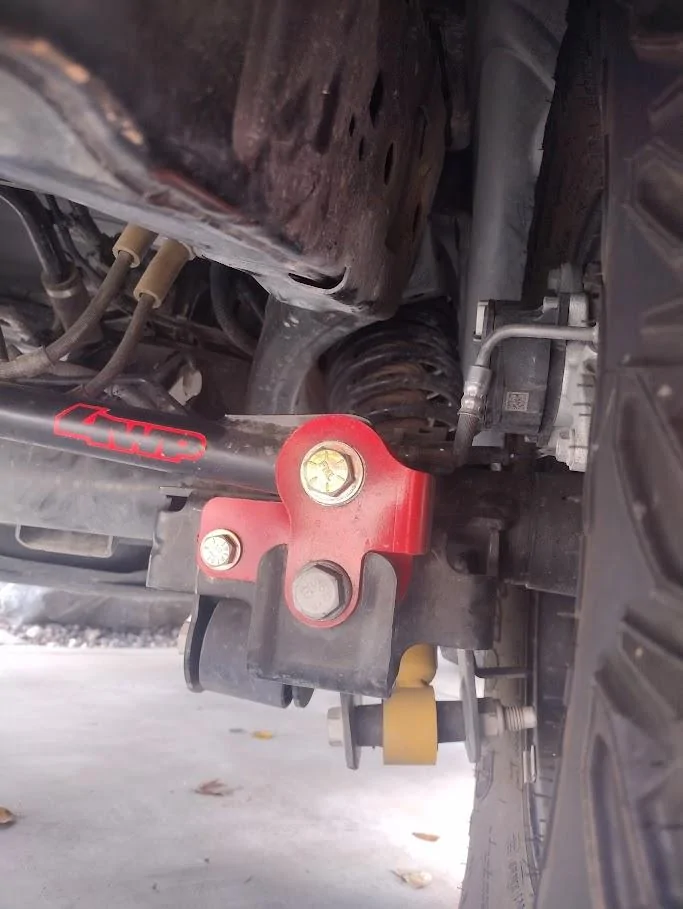

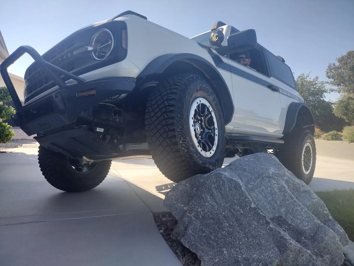

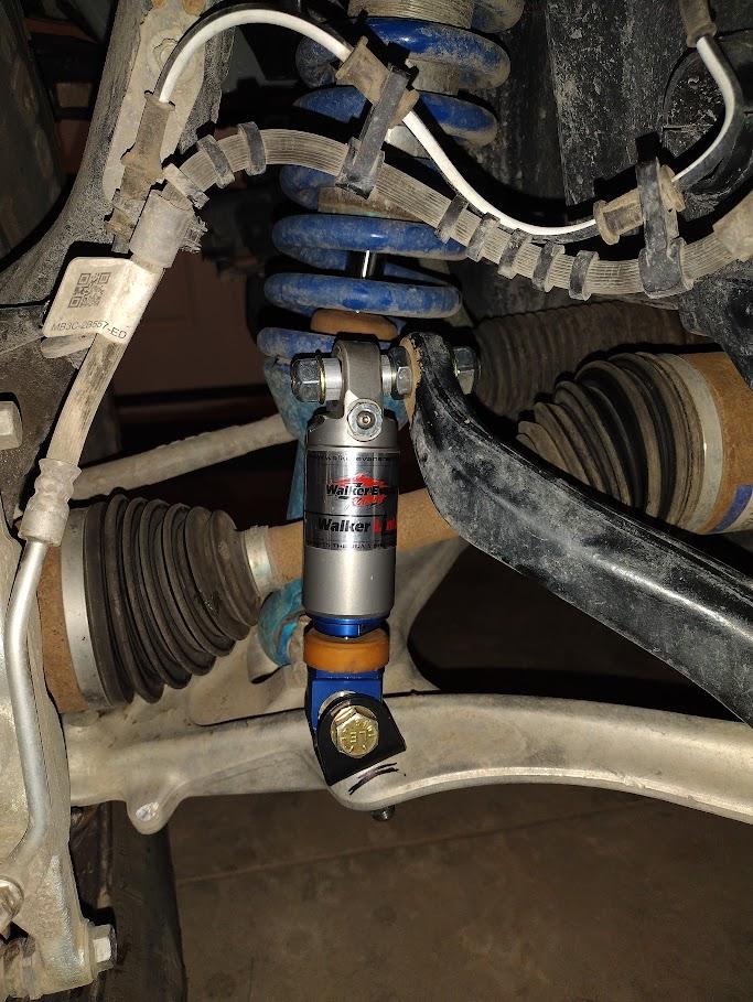

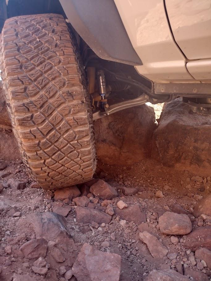

The new product we installed was our BOSS Walker Link System:
Ford Bronco BOSS Bronco Build - 2 Door BaseSquatch 2.7 BB8-WL-4T
This is a game changer for added wheel travel and a smoother ride! Less 3-wheelin'!
Ford Bronco BOSS Bronco Build - 2 Door BaseSquatch 2.7 IMG_20230528_103218198_HDR
Ford Bronco BOSS Bronco Build - 2 Door BaseSquatch 2.7 IMG_20230528_122105589_HDR
Ford Bronco BOSS Bronco Build - 2 Door BaseSquatch 2.7 IMG_20230528_111811680

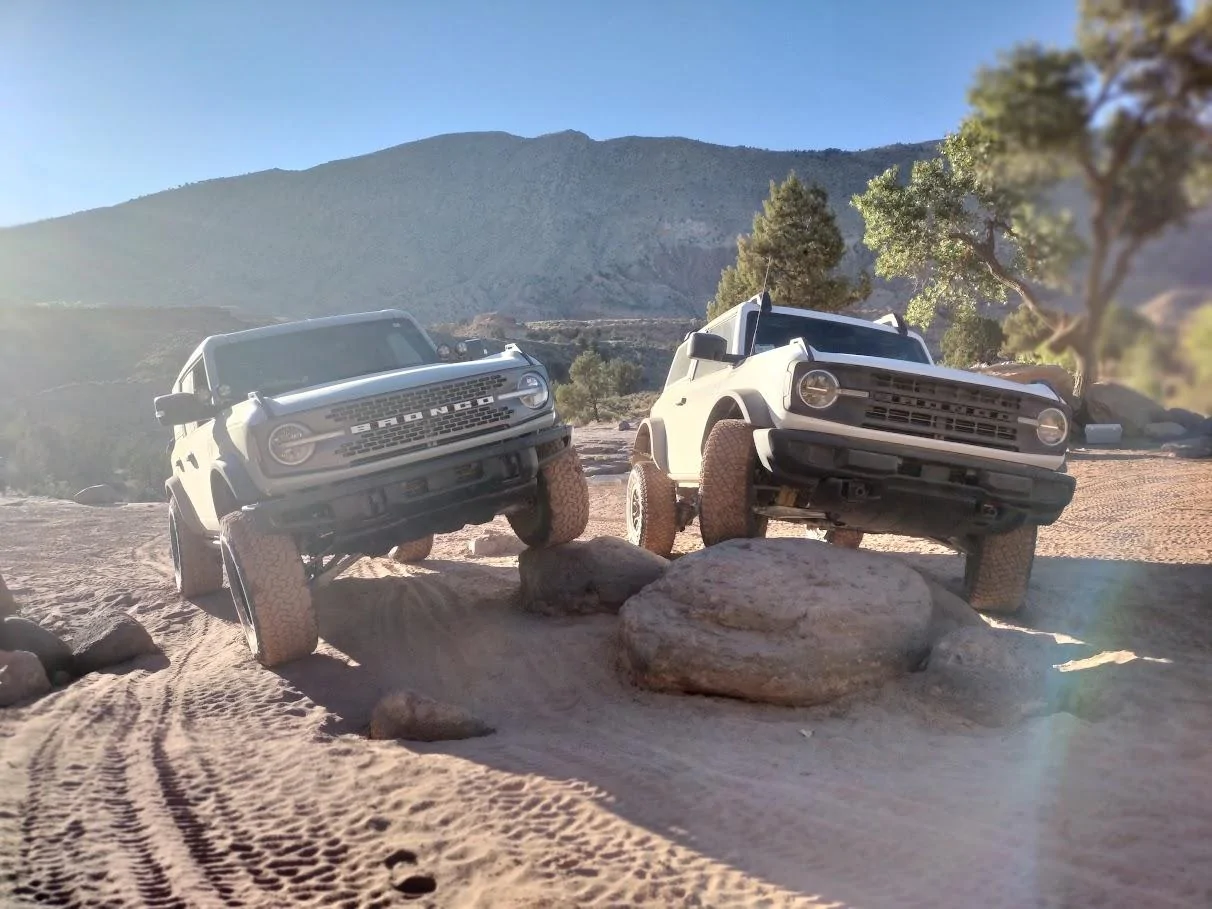

June 2023
Big Bear Bronco Bash!

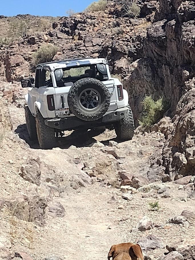

Continued testing the BOSS Walker Link System.
Friday - Ladies run
Ford Bronco BOSS Bronco Build - 2 Door BaseSquatch 2.7 IMG_20230609_142524098_HDR
Ford Bronco BOSS Bronco Build - 2 Door BaseSquatch 2.7 IMG_20230609_121544653_HDR
The "Squeeze":
Ford Bronco BOSS Bronco Build - 2 Door BaseSquatch 2.7 IMG_20230609_135912570

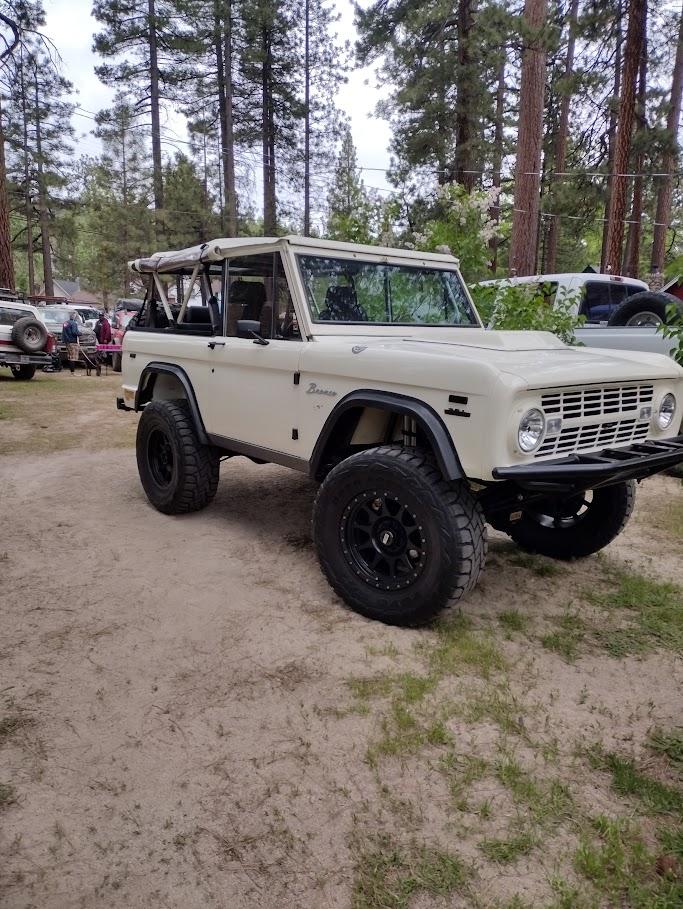

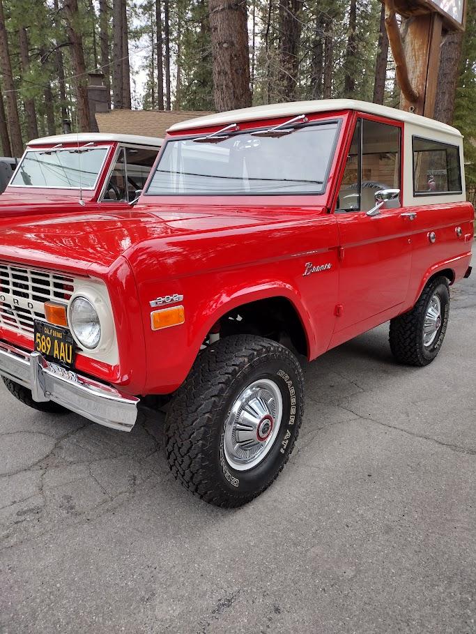

Plus lots of cool OG Broncos at the event BBQ, here's a few:
Ford Bronco BOSS Bronco Build - 2 Door BaseSquatch 2.7 IMG_20230610_190803603_HDR
Ford Bronco BOSS Bronco Build - 2 Door BaseSquatch 2.7 IMG_20230610_185613945_HDR
Ford Bronco BOSS Bronco Build - 2 Door BaseSquatch 2.7 IMG_20230610_190840127_HDR

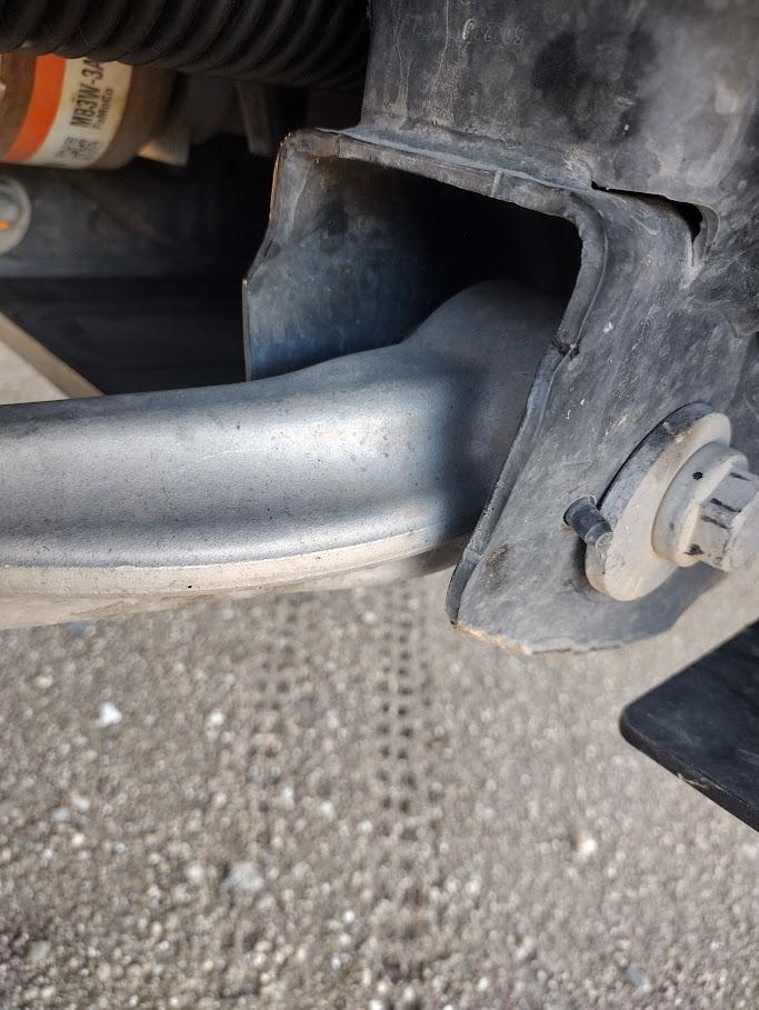

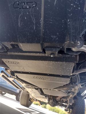

Wish we would have added the front skid sooner since we bashed in the lower control arm pivot brackets. We are working on a fix to strengthen the LCA mounts.
Ford Bronco BOSS Bronco Build - 2 Door BaseSquatch 2.7 IMG_20240102_125401871_HDR

Made a Panhard Relocation Bracket to correct the geometry of the rear Panhard/Track Bar on lifted applications, including Broncos with the Sasquatch pkg.
Ford Bronco BOSS Bronco Build - 2 Door BaseSquatch 2.7 BB8-PRB-2T
Testing the clearance in our driveway!
Ford Bronco BOSS Bronco Build - 2 Door BaseSquatch 2.7 IMG_20230929_152339256_HDR

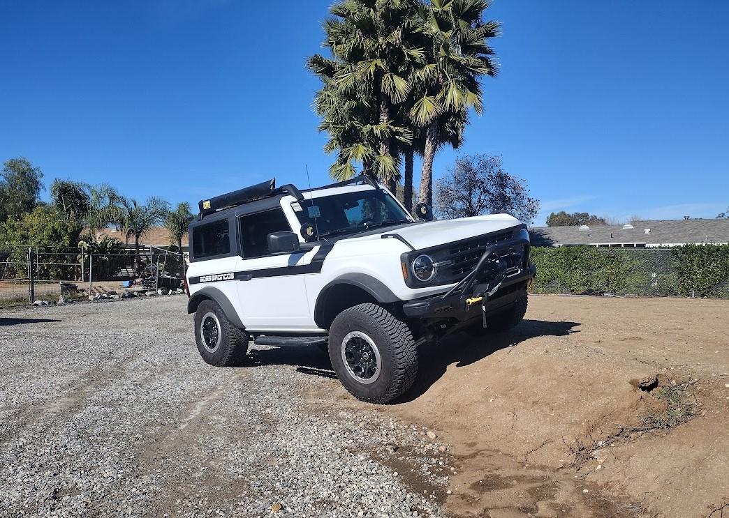

Stuffed rear tire, and plenty of clearance to the frame:
Ford Bronco BOSS Bronco Build - 2 Door BaseSquatch 2.7 IMG_20231223_122653880

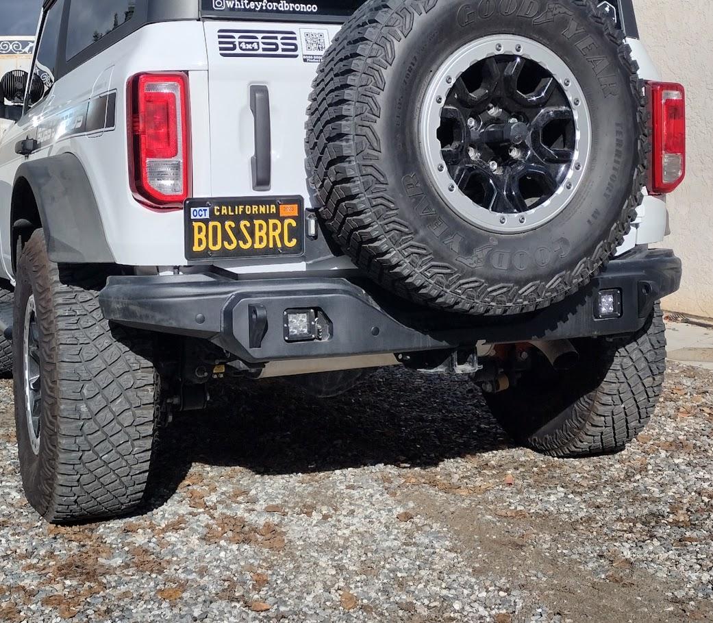

Besides the custom license plate and bracket, we also added a matching 4WP rear bumper and side steps:
Ford Bronco BOSS Bronco Build - 2 Door BaseSquatch 2.7 IMG_20240103_131722828_HDR
Ford Bronco BOSS Bronco Build - 2 Door BaseSquatch 2.7 IMG_20240103_131748635_HDR

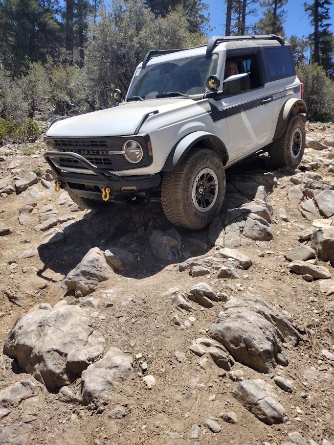

Reviews on 4WP armor:
Front bumper
Pros: great approach angle, solid recovery points, flush light mounts, doesn't block air flow, price, tubular hybrid styling, optional winch mount (which we add later)
Cons: needs added brackets to adequately tie into frame
Rear bumper
Pros: tubular hybrid styling, high clearance, flush light mounts, solid recovery points that tie directly into frame, compatible with hitch
Cons: didn't like license plate mount for the spare tire, a little hard to adjust alignment (we still need to tweak it some more)
Side steps
Pros: price, functional step
Cons: seem a little short lengthwise, would not be suitable as a "slider" (we will be removing them before off-roading)
Skid plates
Pros: price, good design in being high clearance and bolts protected, access panel
Cons: we did dent the front skid a bit, so it could maybe use some added reinforcement, no fuel tank skid (but we have the factory fuel tank skid)

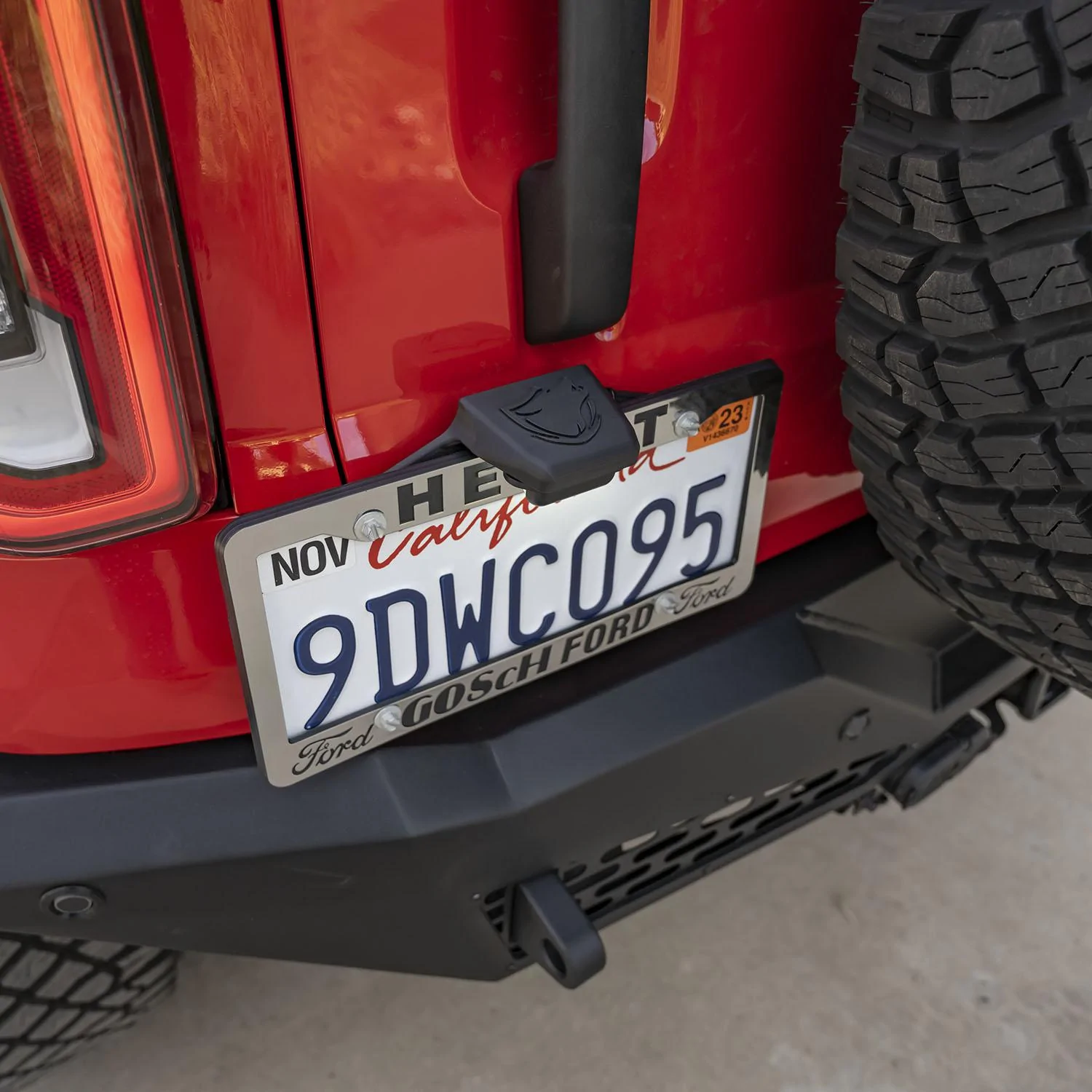

For the license plate mount, we went with the DV8 relocation bracket for a cleaner look than the spare tire mounted kit that the rear bumper came with. The DV8 bracket was easy to install, however, we do not like how it digs into the stock Sasquatch spare tire.
Ford Bronco BOSS Bronco Build - 2 Door BaseSquatch 2.7 DV82-LPBR-03-2T
Ford Bronco BOSS Bronco Build - 2 Door BaseSquatch 2.7 IMG_20240103_133430983_HDR
We later saw Lobo Off-Road's bracket and will likely switch it out, but it is pricy. It mounts in place of the "Ford" logo.
