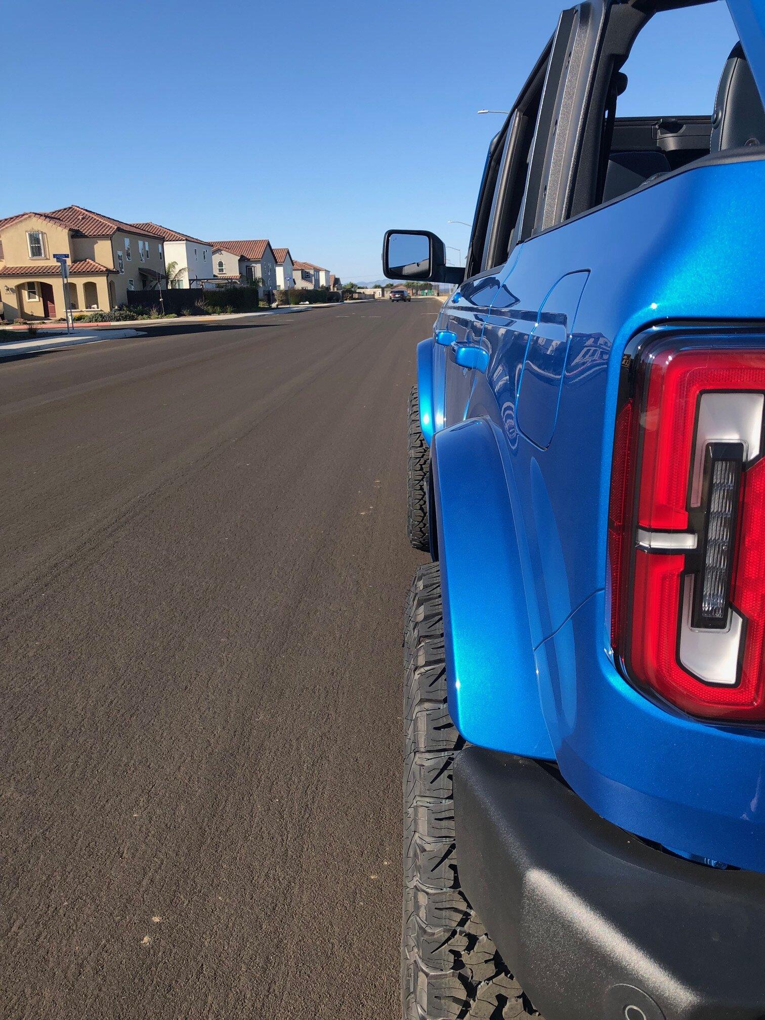

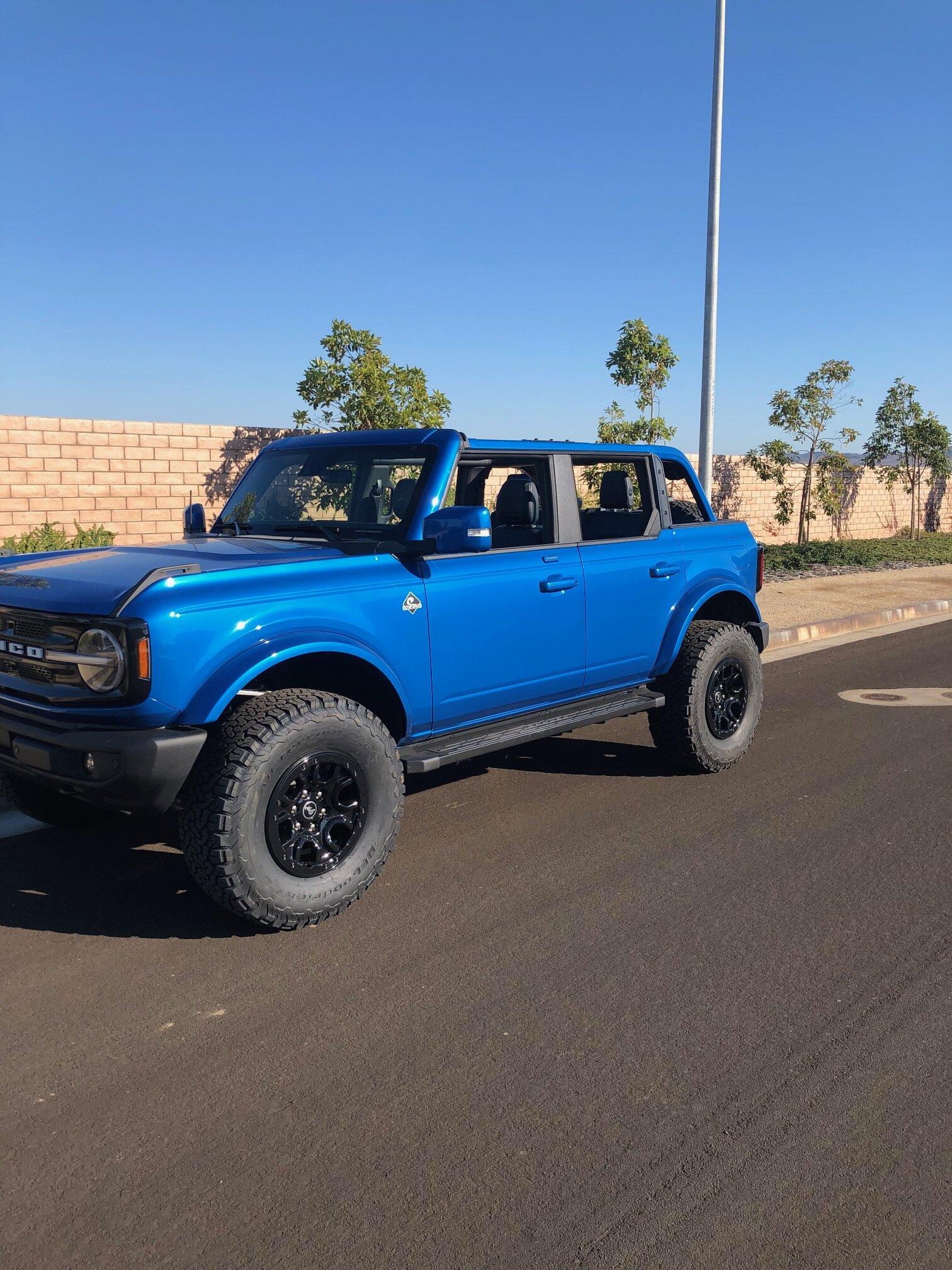

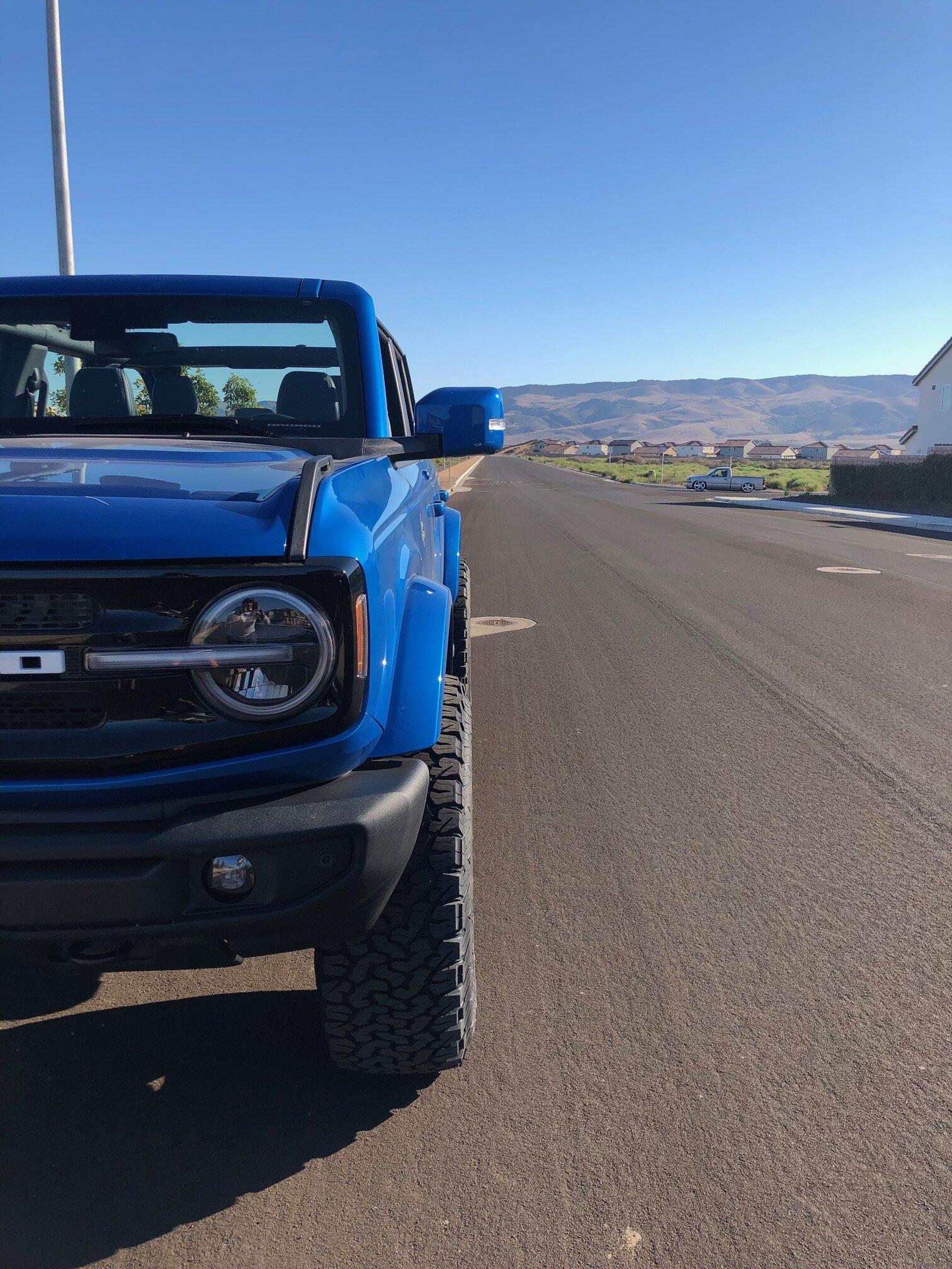

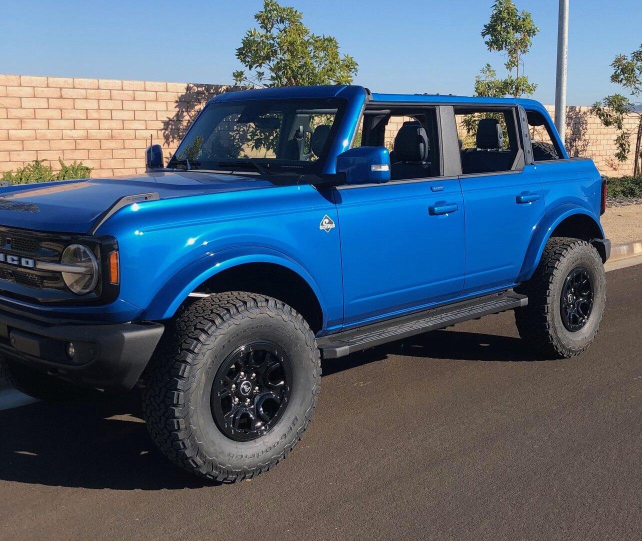

Being a non-SAS OBX, I opted for the full coilover units- as I felt the non-SAS Hitachi coils were pretty soft. Sourced them through Shock Surplus with Labor Day discount for a good deal. Pics:
Ford Bronco Bilstein 6112 suspension kit installed…WOW!  HUGE improvement over stock OBX Hitachi coilovers 9b4e834c-2901-46fc-a3ba-ce2984cb4adc-jpe
Ford Bronco Bilstein 6112 suspension kit installed…WOW!  HUGE improvement over stock OBX Hitachi coilovers bffc1a5d-0c88-43e8-9bca-00bf80042e39-jpe
Ford Bronco Bilstein 6112 suspension kit installed…WOW!  HUGE improvement over stock OBX Hitachi coilovers 915f5e13-c225-434b-91e8-8a2c1b93f200-jpe
Ford Bronco Bilstein 6112 suspension kit installed…WOW!  HUGE improvement over stock OBX Hitachi coilovers d5cb9ecc-5a18-443c-a32e-71502dc5da7d-jpe
Ford Bronco Bilstein 6112 suspension kit installed…WOW!  HUGE improvement over stock OBX Hitachi coilovers 0cf895ff-1209-428c-a85e-d461db41a8ae-jpe

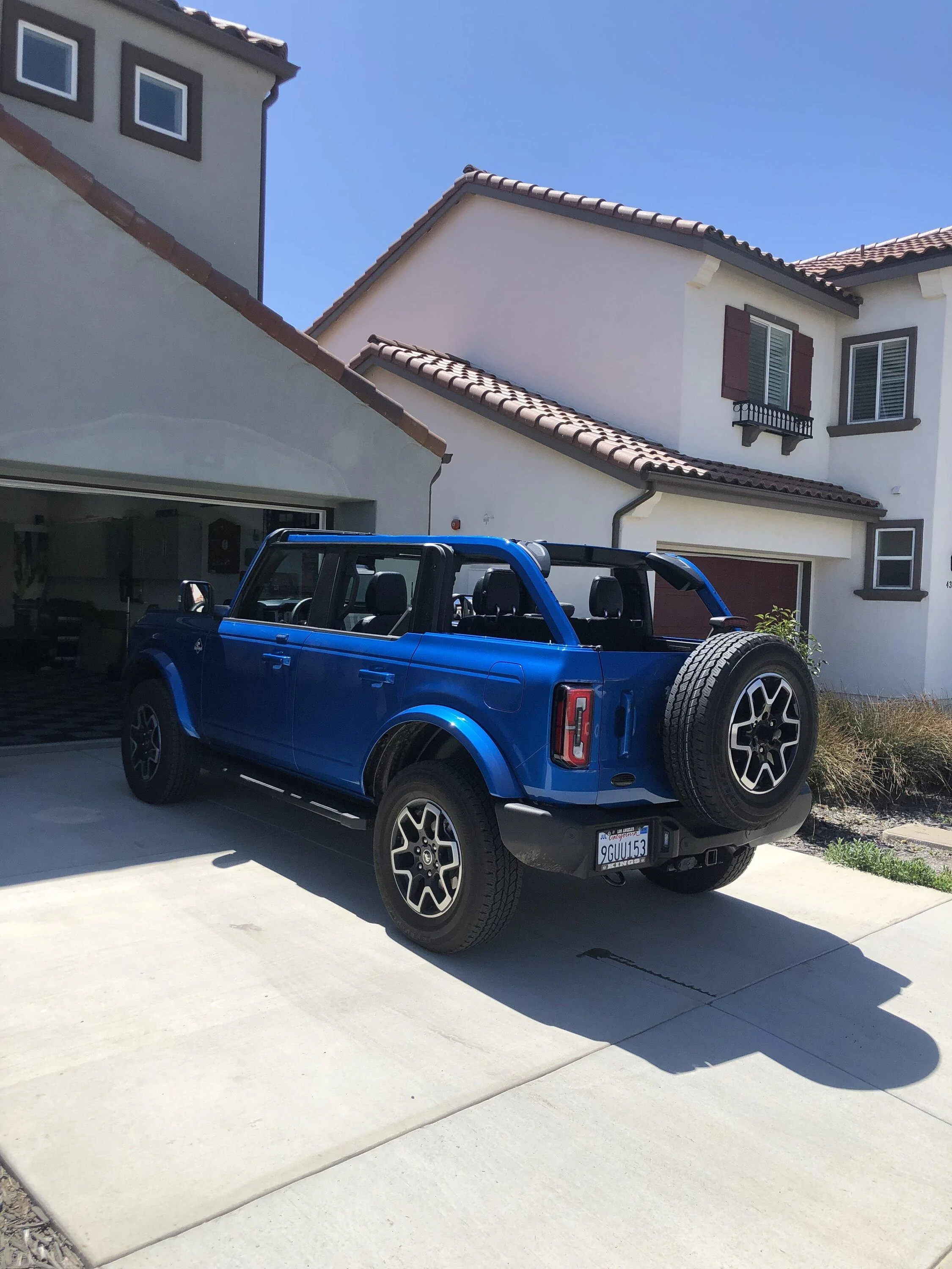

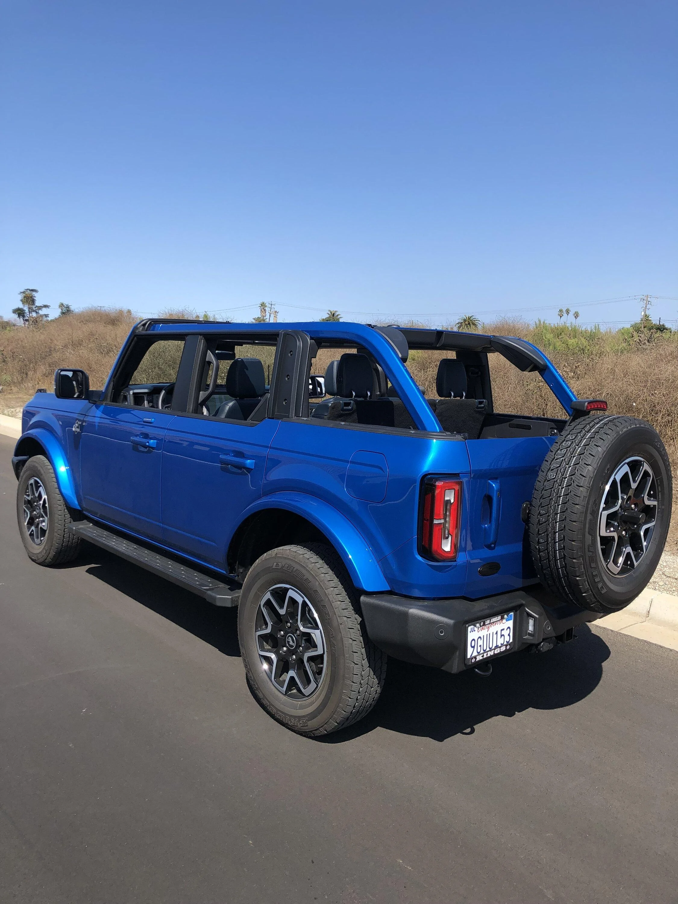

Here’s stock:
Ford Bronco Bilstein 6112 suspension kit installed…WOW!  HUGE improvement over stock OBX Hitachi coilovers img_2929-jpeg
Ford Bronco Bilstein 6112 suspension kit installed…WOW!  HUGE improvement over stock OBX Hitachi coilovers img_2887-jpeg

Here’s stock:
Ford Bronco Bilstein 6112 suspension kit installed…WOW!  HUGE improvement over stock OBX Hitachi coilovers IMG_2929
Ford Bronco Bilstein 6112 suspension kit installed…WOW!  HUGE improvement over stock OBX Hitachi coilovers IMG_2887

OK, so I <finally> have pics of new lift with SASWildtrack wheels and 35s. Huge difference in stance/look & handling. Handles much more solid now w/o all the “wallow & brake dive“ of stock Hitachis/18” tires. rides firmer (but not at all unpleasant/stiff). Much more confidence inspiring. A bit louder and I feel the additional heft of the 35s not so much in acceleration, but requires a tad more brake pedal to stop.
Again, nothing major, just sharing my initial impressions. I“d estimate the 6112s were 60% of the improvement in handling with 35’s accounting for the rest. 6112s are not inexpensive, but well worth it, IMO.
Ford Bronco Bilstein 6112 suspension kit installed…WOW!  HUGE improvement over stock OBX Hitachi coilovers 9B4E834C-2901-46FC-A3BA-CE2984CB4ADC
Ford Bronco Bilstein 6112 suspension kit installed…WOW!  HUGE improvement over stock OBX Hitachi coilovers BFFC1A5D-0C88-43E8-9BCA-00BF80042E39
Ford Bronco Bilstein 6112 suspension kit installed…WOW!  HUGE improvement over stock OBX Hitachi coilovers 915F5E13-C225-434B-91E8-8A2C1B93F200
Ford Bronco Bilstein 6112 suspension kit installed…WOW!  HUGE improvement over stock OBX Hitachi coilovers D5CB9ECC-5A18-443C-A32E-71502DC5DA7D
Ford Bronco Bilstein 6112 suspension kit installed…WOW!  HUGE improvement over stock OBX Hitachi coilovers 0CF895FF-1209-428C-A85E-D461DB41A8AE

Looks Amazing! What clip settings did you use on the shocks?
HotLap
HotLap
Bradley
Feb 18, 2020
661
591
CA Central Coast
2023 Bronco, 2024 HD Street Glide & 2019 Yamaha XSR900
I used clip setting #1 in rear and #2 in front which gave me approx. 1.75” lift in rear and 2.2”lift in front. Front has since settled to approx 2”lift. Keep in mind I’m lifting a non-SAS OBX and had the complete Bilstein 6112 coilover units installed (including Bilstein springs).
