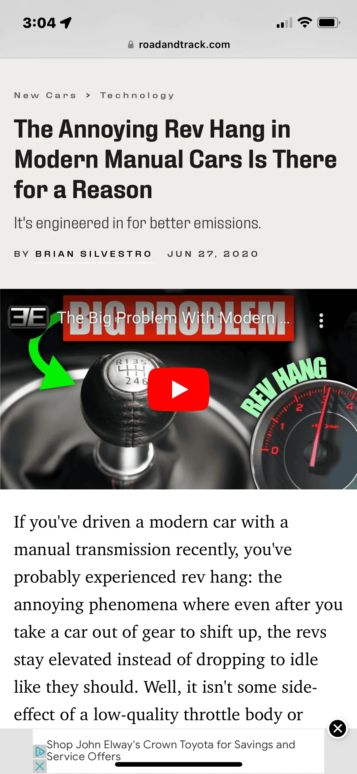

bronco100
Feb 23, 2022
143
202
Colorado Springs
Ford Bronco 2022 2dr
That is an interesting source regarding the emissions aspect. I wonder if it could be converted to drive by cable to get around that.
But still it doesn’t explain how it relates to rev matching. If you clutch in in 4th gear as you state, in order to shift up to 5th, and it takes you half a second to shift, the revs will drop by 500 in that time. So unless you are shifting at 1.5k they aren’t going to go down to 1k as you state. On the 6th gen manual Bronco, when you clutch in, the revs fall by approximately 1k per second. If you are shifting up at a typical engine speed of say, 3k, it would take 2 seconds to let it drop to 1k. Which is about how long I currently hold the clutch in to shift smoothly on my Bronco.
