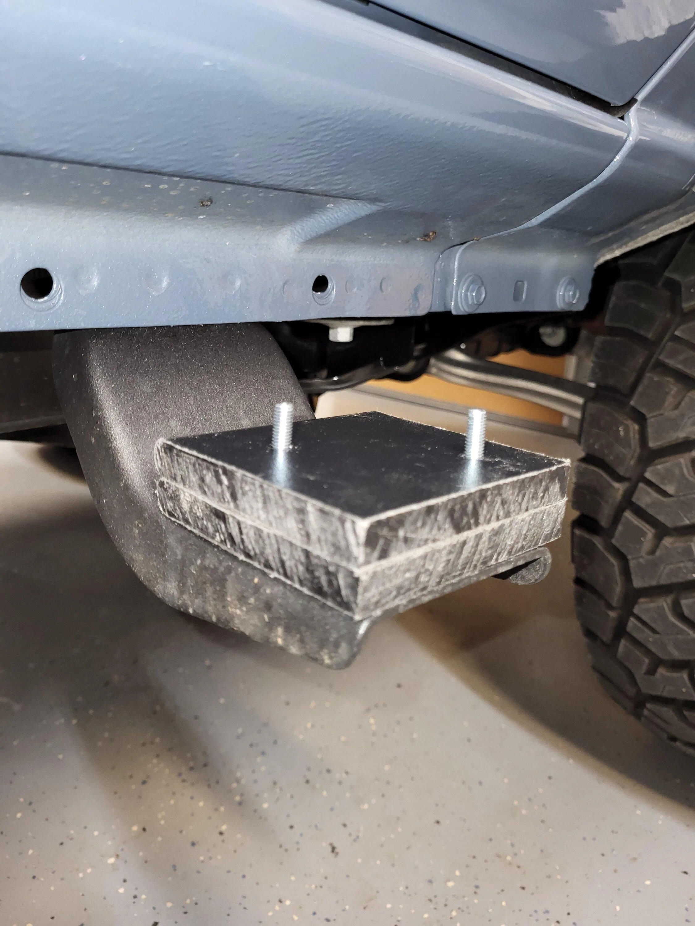

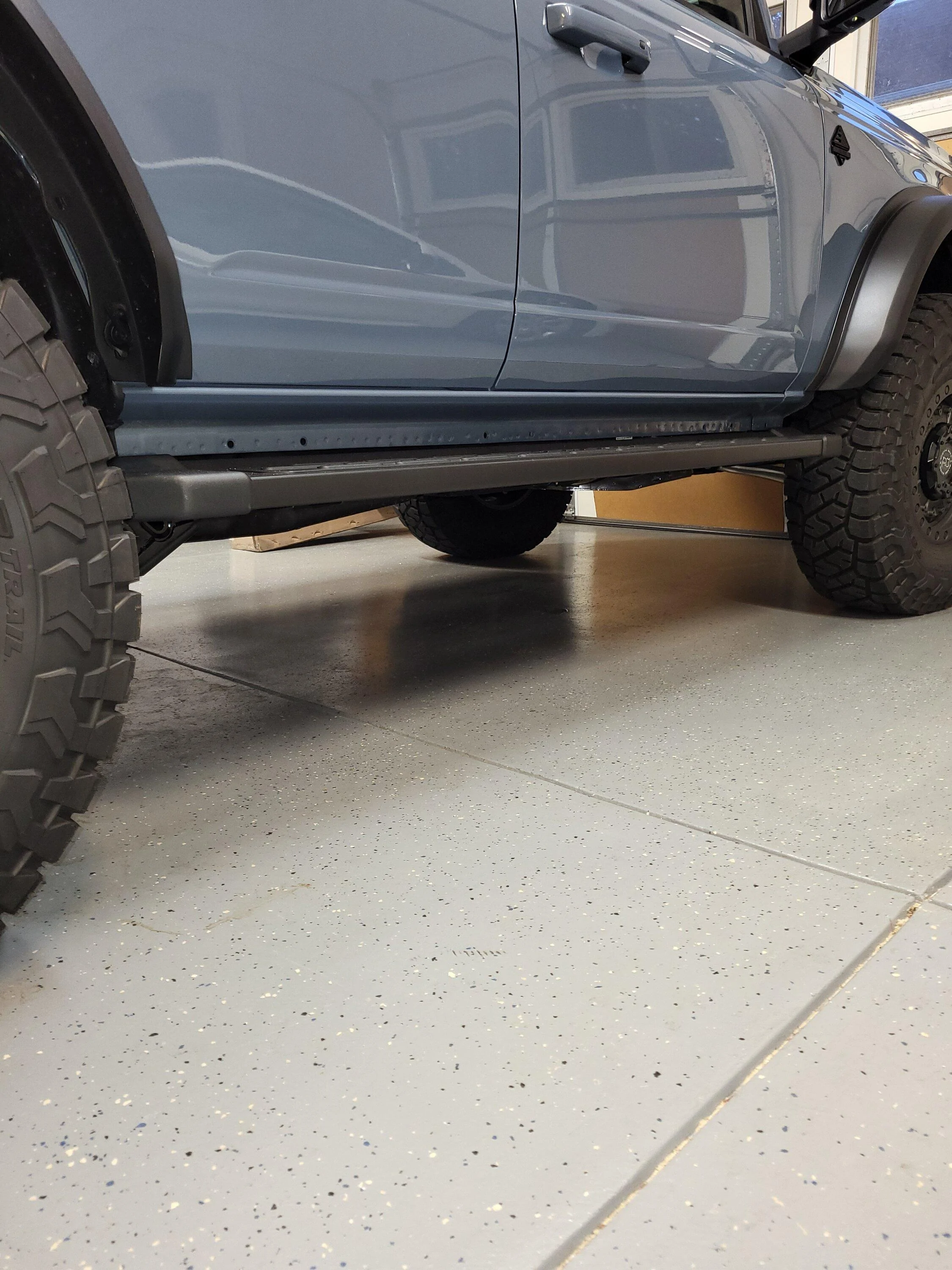

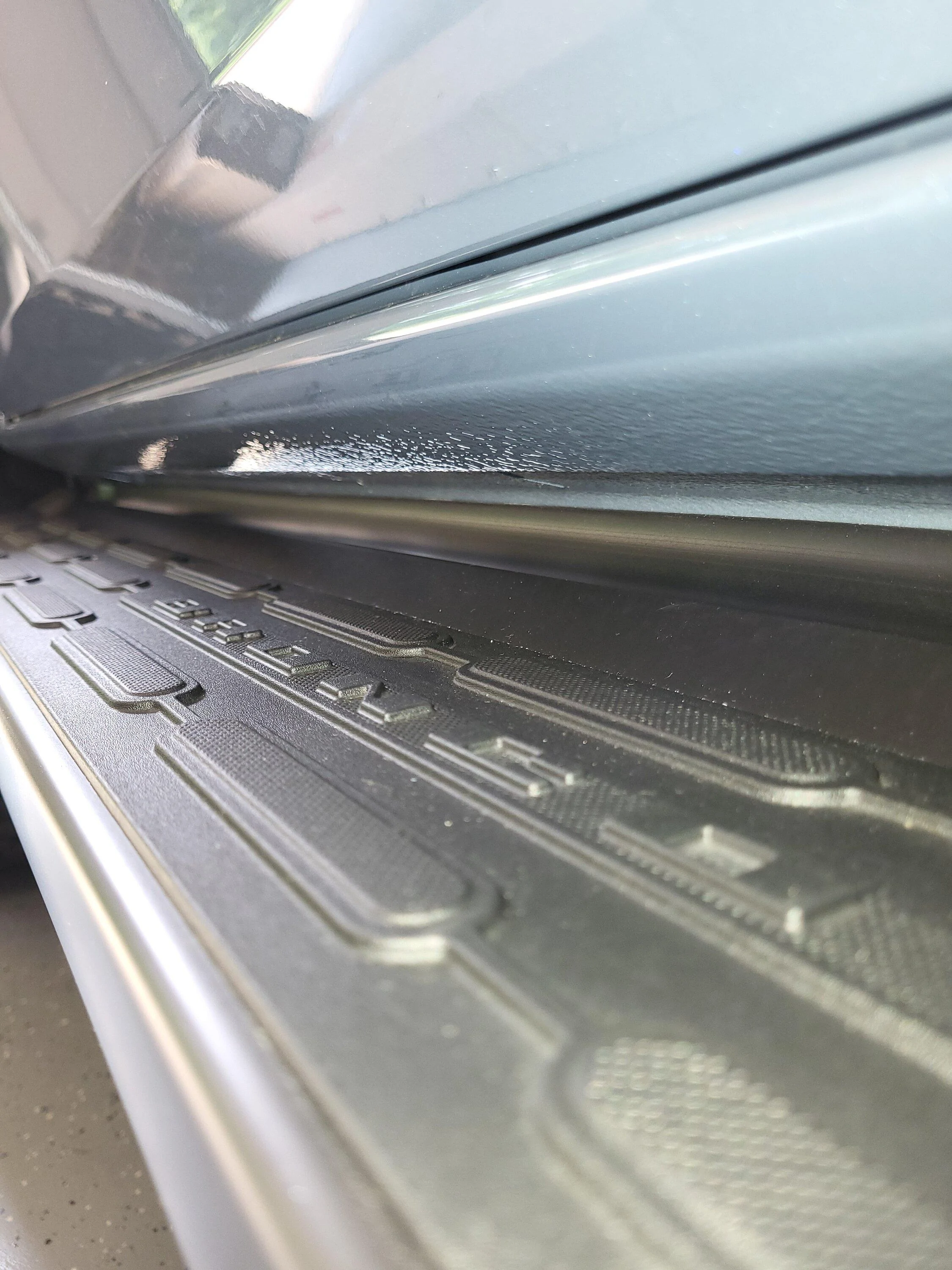

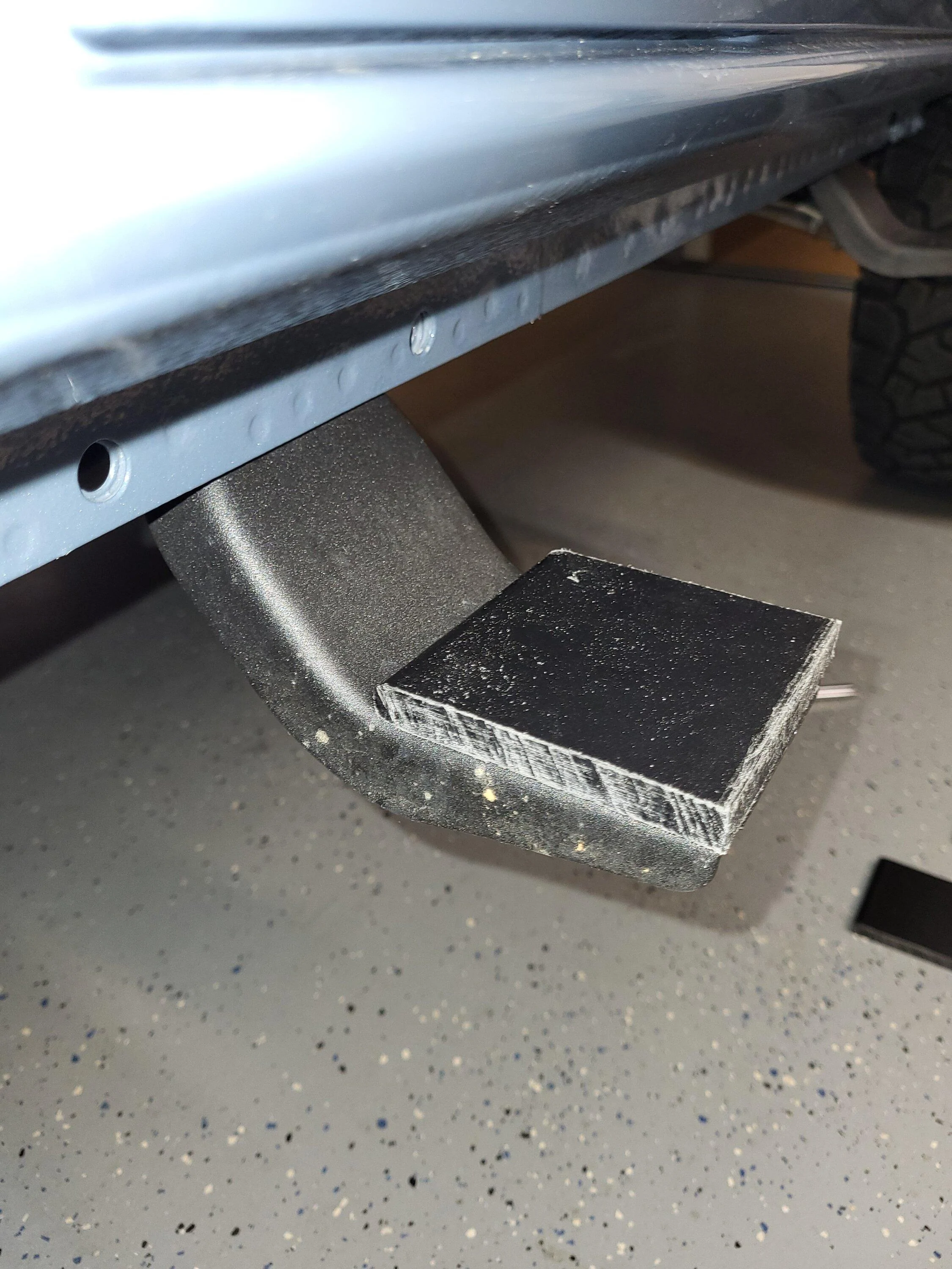

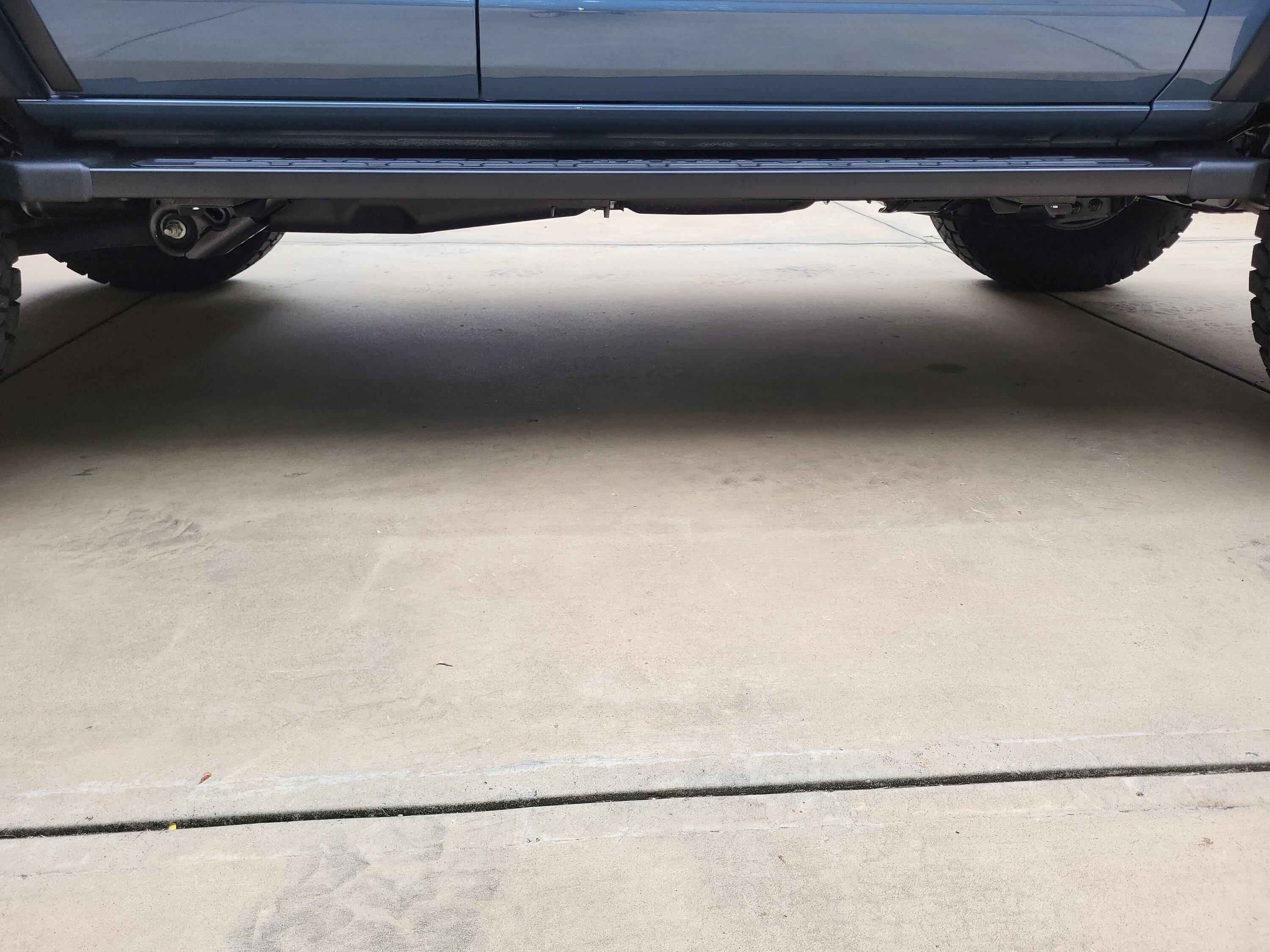

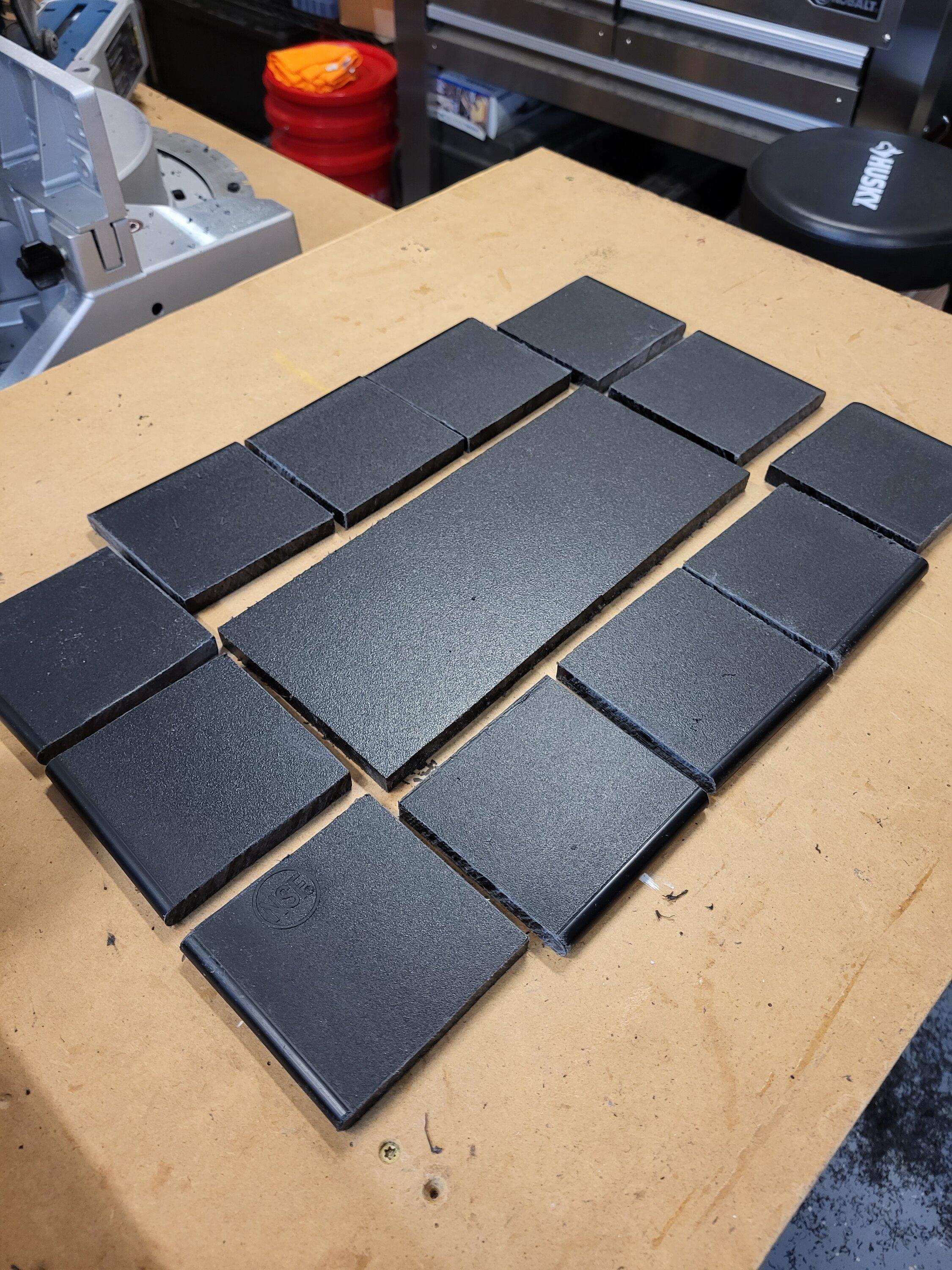

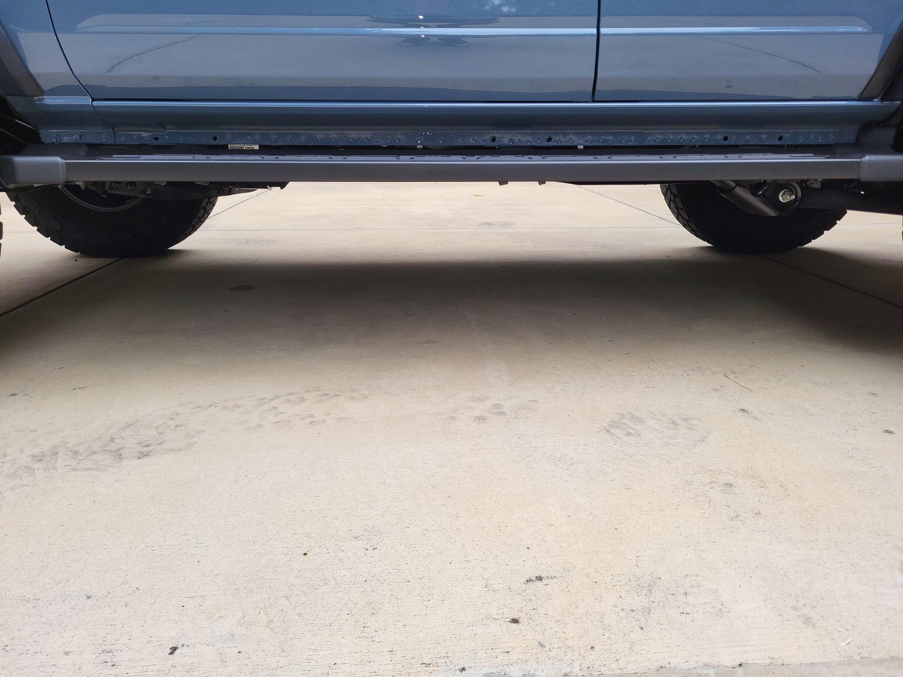

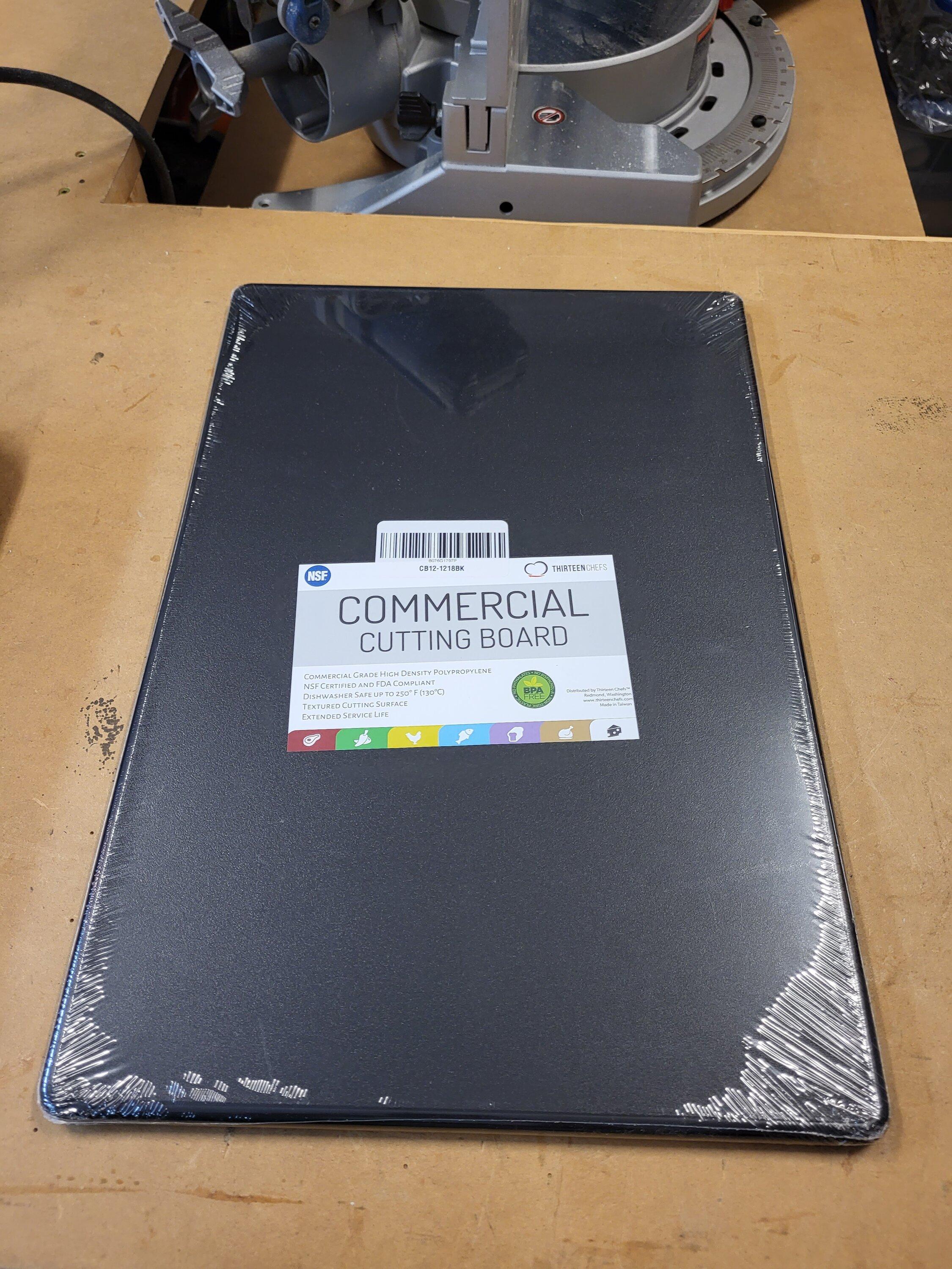

Had been told 37's wouldn't work with factory running boards so I ordered some Go Rhino RB20s. They are still shipping with wrong brackets and was told the right brackets are backordered with no expected date so I'm sending those back. I tried putting back on the factory steps and after sliding them back slightly they worked fine with zero rub. I just didn't like how low they hung down. I knew that body lift pucks were just poly and could hold a whole unibody so I just ordered a $20 professional cutting board to try since it only had to hold a step. It worked fine. 1/2 thick board doubled up raised the factory boards to exactly where the RB20s sat with just a small part of the pinch weld showing. I ordered some $40 one-inch matte black auto trim and put that behind the steps and now I'm happier than if I had the $500 Go Rhino boards because the tapered design of the RB20s left more space open between the flare and step for dirt and mud to come through. If anyone wants to try this themselves and wants some details just let me know. This forum helped me out a ton and I'd love to give back.

Great idea and it looks much better. Do you have any after pictures from a higher angle? Just curious to see if it'll be more difficult to properly step on it.

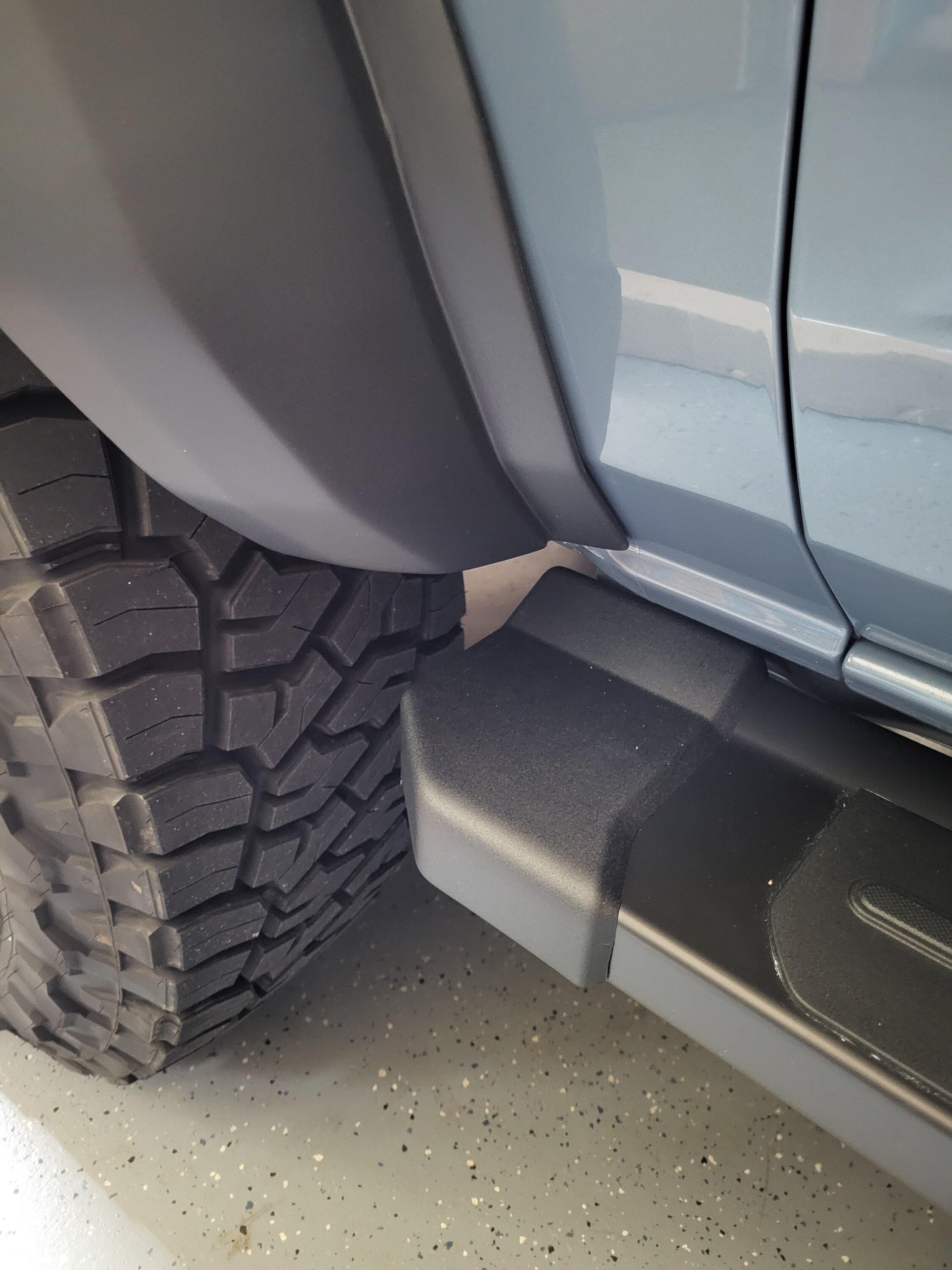

I wear a size 13 shoe and it still works for me. The factory boards are pretty wide. Here is a pic I took to show how small the gap between the flare and board had gotten and it shows better how far the boards still stick out.

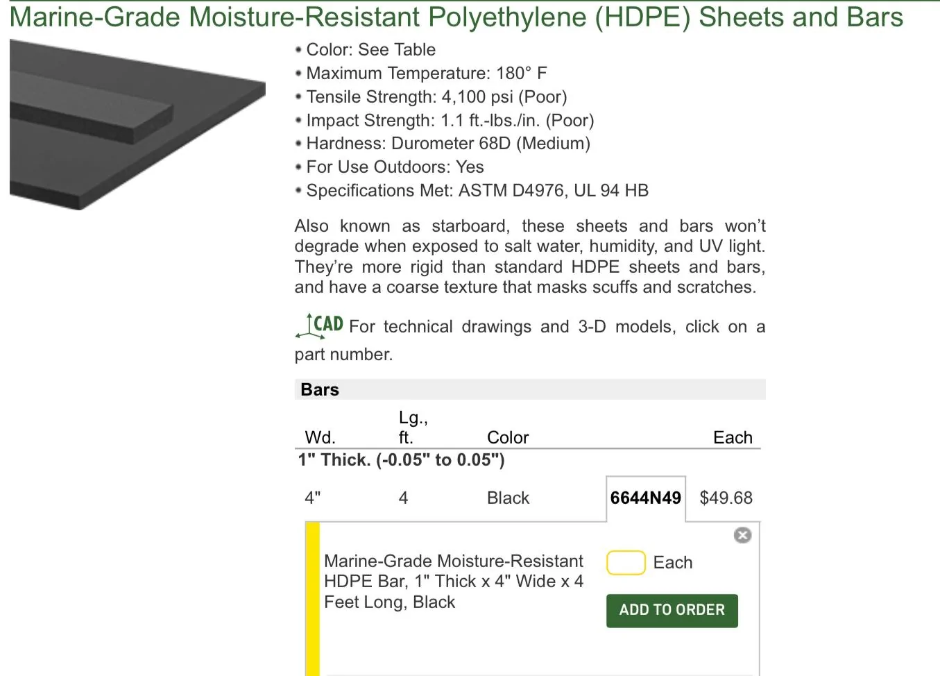

The marine industry has a UV Stabilized plastic boatbuilding product similar to your innovative use of cutting boards. Starboard. https://www.tapplastics.com/product/plastics/cut_to_size_plastic/king_starboard/526

Here is an option for black marine grade material. McMaster-Carr.
When I put in the 18x12.5 board in 1/2 inch with rounded edges it comes back at $39.13 plus $19.29 shipping! I paid $20.12 with free shipping for the cutting board on Amazon. Just letting you know so you don't overpay. Thanks for the other option though
